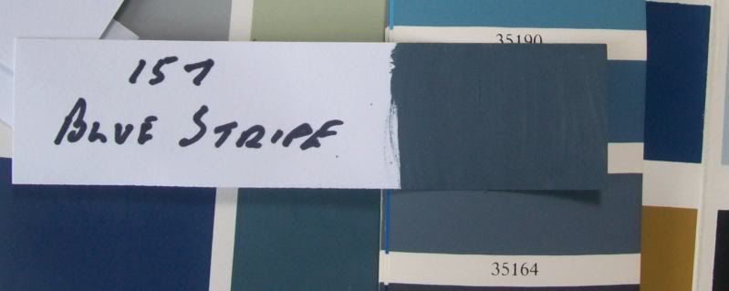

I looked out the oldest tin of Azure Blue I could find in my paint box, which is an early version of 157 rather that the authentic HB13. and since it is a "blue stripe" tin probably dates to when 157 was introduced to the Standard range, which Richard Humm dates at 1988 in his list on the Airfix Collectors Forum. This colour was brushed out and compared to the chips in the RAF Museum book:
It looks nothing like Azure Blue, as we know, but it's also not that close to LMB either. LMB is bluer and less grey than 157. 157 is also markedly darker and greyer than the current BS381c-104 Azure, so it looks like both these theories are wrong at least based on this particular incarnation of 157\HB13. We're still no wiser when it comes to what Humbrol were thinking when they introduced this shade!
Comparing 157 to FS595, the nearest match is 35164:

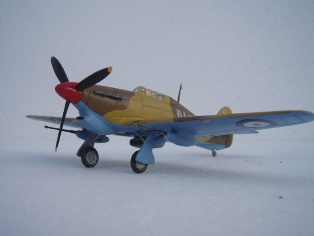

Interesting discussion here, and i too have been looking for a replacement to my Gloy colour azure blue. To me this is the most accurate to that chart as can be seen here on my recent hurricane for the matchbox GB.
This was taken outside under shade so the blue looks darker than in the flesh. If you have hu157 i belive adding some white until you get the match.

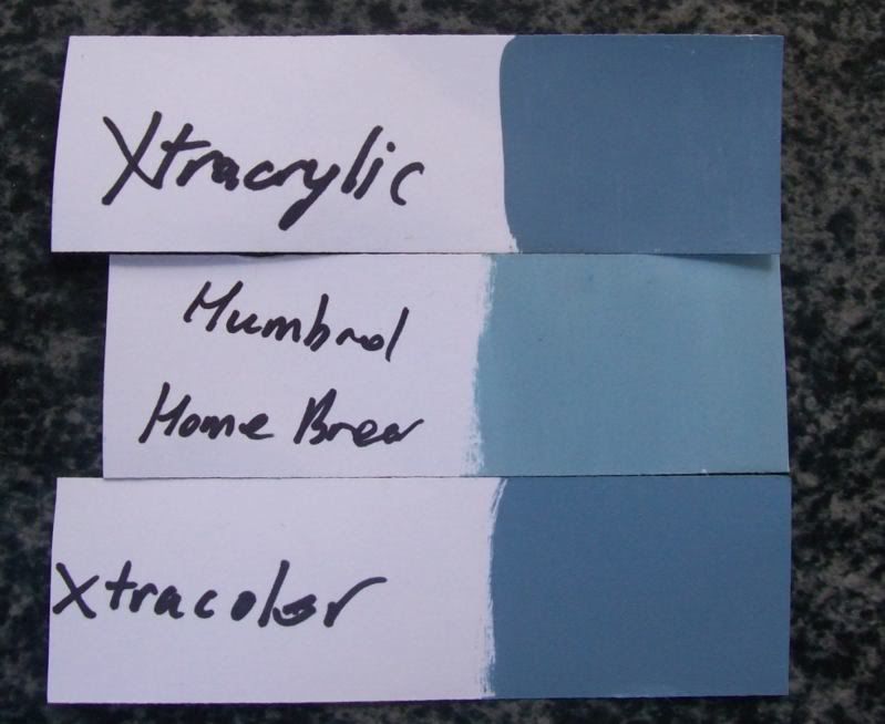

Here's what I got when I tried the mix mentioned by Edgar and Steve:
The result is lighter and brighter than either of the Hannants shades, so heading in the right direction. Compared to the RAFM chip (and acknowledging Nick's points above!) it still looks too grey and not violet enough to me.
This is obviously an elusive shade. I'm wondering if Humbrol white plus 25 Blue is the correct way to start, I'm not sure 25 is strong enough.
John
