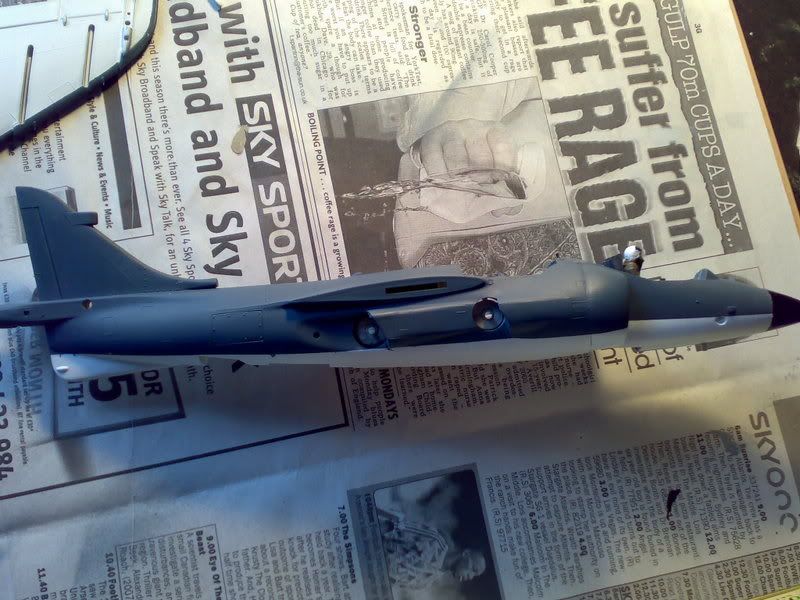

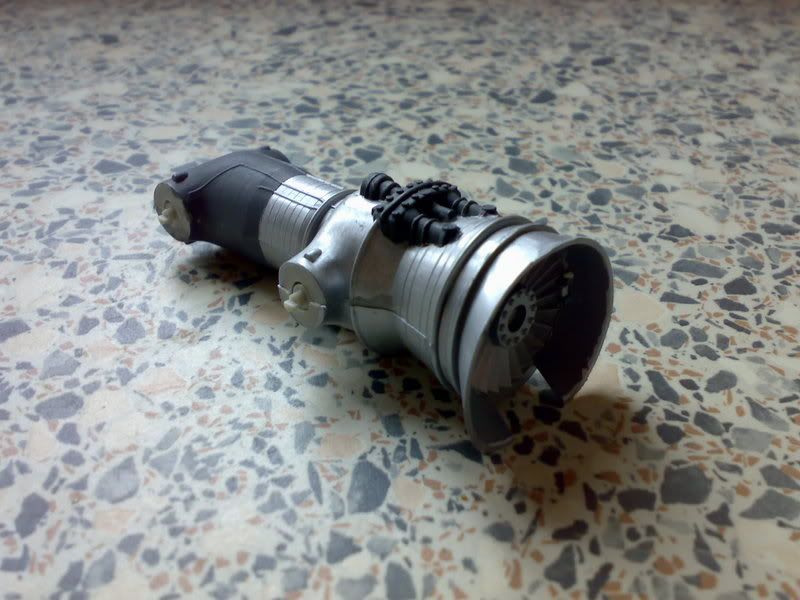

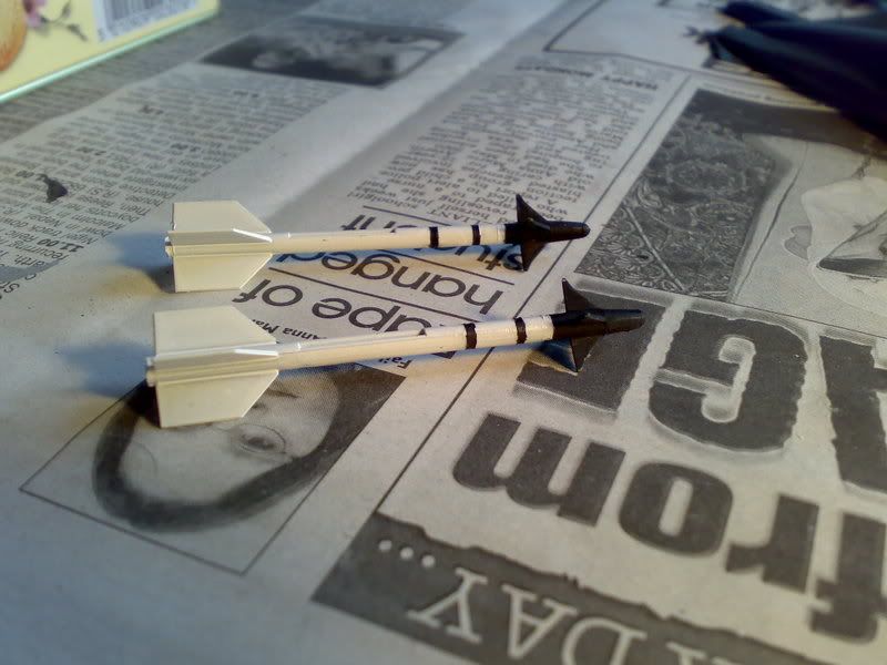

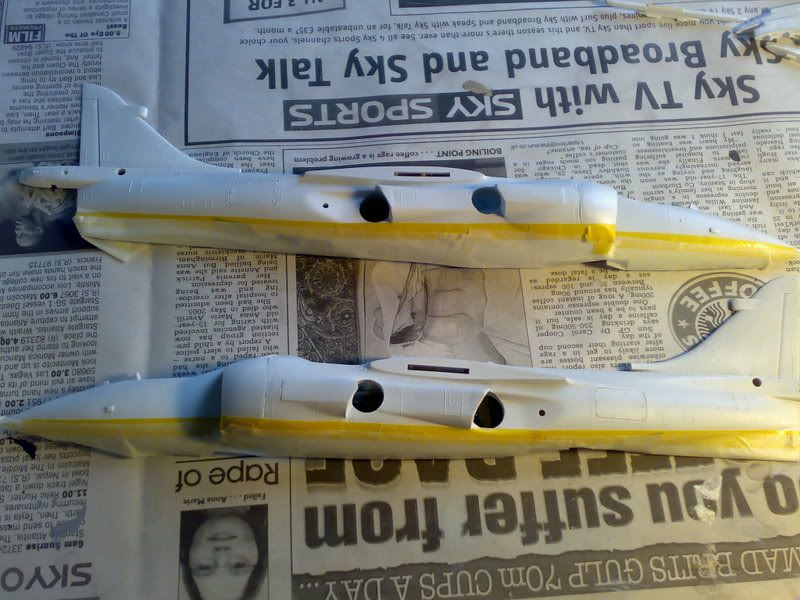

GrahamEM Posted September 29, 2007 Share Posted September 29, 2007 Started this about 3 weeks ago now, sourcing paint was a bit of a problem The jet engine that sits inside of the fuselage, i didn't know kits came like this, there's a non fixed cover that goes on top Masking off white bottom half already sprayed Managed to get the paint the right colour this time 1 part X-3, 3 parts XF-24 for dark sea grey Sidewinders need some touching up but i sprayed them white Is it best to peel off the tape when the paint is dry or when it is still wet ? i just hope i don't peel away the edges when the two colours of the main fuselage meet. Link to comment Share on other sites More sharing options...
Gary West Posted September 29, 2007 Share Posted September 29, 2007 Your a braver man that I Graham - both for attempting that kit and then for painting before you assemble! Link to comment Share on other sites More sharing options...

GrahamEM Posted September 29, 2007 Author Share Posted September 29, 2007 Your a braver man that I Graham - both for attempting that kit and then for painting before you assemble! you got me worried now, is there something i should know, lol the reason i sprayed in two halves was the silver rotor disk that goes at the back of the big side air intakes, i had no way of masking after assembly really Gary. Link to comment Share on other sites More sharing options...

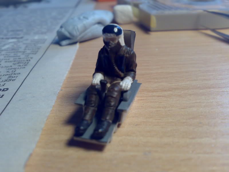

Mike Posted September 29, 2007 Share Posted September 29, 2007 I dont' want to worry you or anything Graham, but there's a man sat in the kit seat I hope ya dont' regret painting it before you glue the fuselage halves together... it could get reet messy when you fill/sand the seams Of course, it's all part of the learning process, but in general, most modellers paint the main parts after assembly. There are the occasional exceptions, but in general that's how it's done. Keep up the good work, cos if your last kit was anything to go by, you'll keep improving in leaps & bounds you got me worried now, is there something i should know, lol the reason i sprayed in two halves was the silver rotor disk that goes at the back of the big side air intakes, i had no way of masking after assembly really Gary. Bits of foam... spraying the intakes the proper color before installing the engine is wise, and then you pack the area with some spongy foam... That way, your precious silvery bits stay silver, and you won't need to touch up the intake trunking where the foam was. Link to comment Share on other sites More sharing options...
GrahamEM Posted September 29, 2007 Author Share Posted September 29, 2007 cheers Mike, i spose i could have masked off just the air intakes and sprayed inside then put together. Link to comment Share on other sites More sharing options...
GrahamEM Posted September 29, 2007 Author Share Posted September 29, 2007 With a bit of touching up i'm quite pleased how the two colours have merged, first time i done this Link to comment Share on other sites More sharing options...
palacefan Posted September 29, 2007 Share Posted September 29, 2007 Bits of foam... spraying the intakes the proper color before installing the engine is wise, and then you pack the area with some spongy foam... That way, your precious silvery bits stay silver, and you won't need to touch up the intake trunking where the foam was. Or tissue, i sometimes wet it and let it dry. Link to comment Share on other sites More sharing options...
