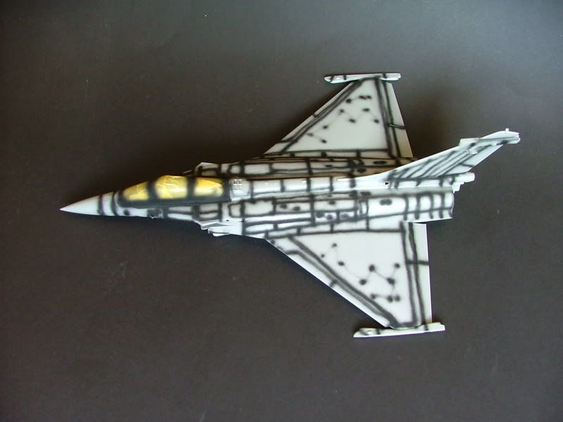

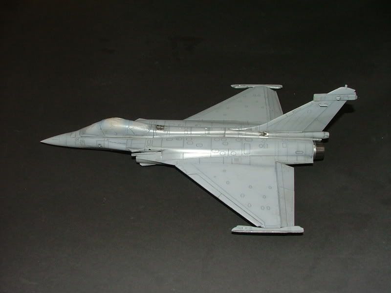

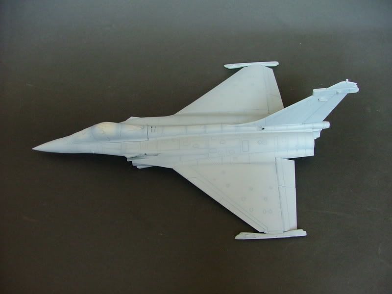

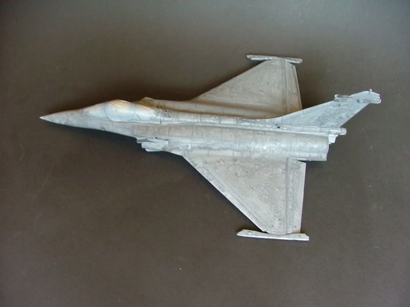

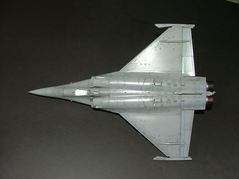

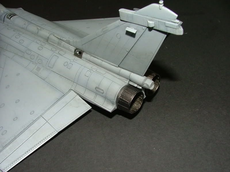

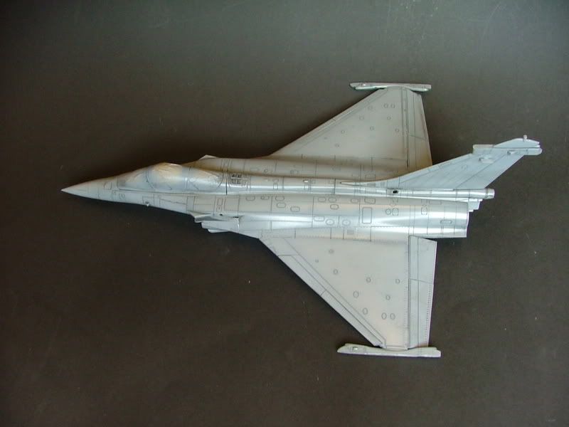

Phil @ Flory Models Posted September 19, 2007 Share Posted September 19, 2007 (edited) HI guys and girls, well I thought there was a lack of Gray aircraft this week so I thought I'd do one. It's the Hobby Boss 1/48 Rafale M. It went together a dream with no filler and just a tiny bit of CA on the intake joins. I'm trying a new weather system and thought I'd share it with you. OK first pre shaded Then a few coats of light ghost grey cut with a little white A coat of future and the wash on The wash had a few drops of future in it to make it stick a bit (This is the first time I've tyred it, so If you do have a go don't blame me if it goes Pete Tong) Wash off and a coat of future on. Sprayed on Alclad Steel and Jet exhaust. You cant see the weathering much in these pics but I'm really happy with the way it's looking More to come Happy Modelling Edited September 19, 2007 by Phil_flory Link to comment Share on other sites More sharing options...
entlim Posted September 19, 2007 Share Posted September 19, 2007 (edited) Nice Phil, was that bubbling I saw in photo 3? Ed Edited September 19, 2007 by entlim Link to comment Share on other sites More sharing options...
Phil @ Flory Models Posted September 19, 2007 Author Share Posted September 19, 2007 Nice Phil, was that bubbling I saw in photo 3? Ed No, it's the Gray wash when it's dry Link to comment Share on other sites More sharing options...
Gary West Posted September 19, 2007 Share Posted September 19, 2007 The detail looks awesome on that Rafale - nice weathering Phil Link to comment Share on other sites More sharing options...
mikeew Posted September 19, 2007 Share Posted September 19, 2007 Great work Phil, those panel lines really pop out with that wash Link to comment Share on other sites More sharing options...

Bobs_Buckles Posted September 19, 2007 Share Posted September 19, 2007 Hello Phil, Is the wash/future mix designed to leave a greater spread of wash over the panels? Nice Job BTW Cheers Bob Link to comment Share on other sites More sharing options...
hatchet Posted September 19, 2007 Share Posted September 19, 2007 Looking good Phil One thing though, not to be a pedantic spoilsport or anything but, what about the chaff/flare dispensers? You can see them here and here next to the flaperons. Of course, if it's a prototype or early production machine, they're not there. Link to comment Share on other sites More sharing options...
Phil @ Flory Models Posted September 20, 2007 Author Share Posted September 20, 2007 Is the wash/future mix designed to leave a greater spread of wash over the panels? My thinking is to have the wash stick to the paint work thus giving the worn dirty look. To be honest it's worked better than I thought But it worked a little to well in a few places and needed to be sanded back to get it off. Looking good Phil One thing though, not to be a pedantic spoilsport or anything but, what about the chaff/flare dispensers? You can see them This is a out of the box job, I was looking at it though and it would be a simple job to do for the next one. Link to comment Share on other sites More sharing options...

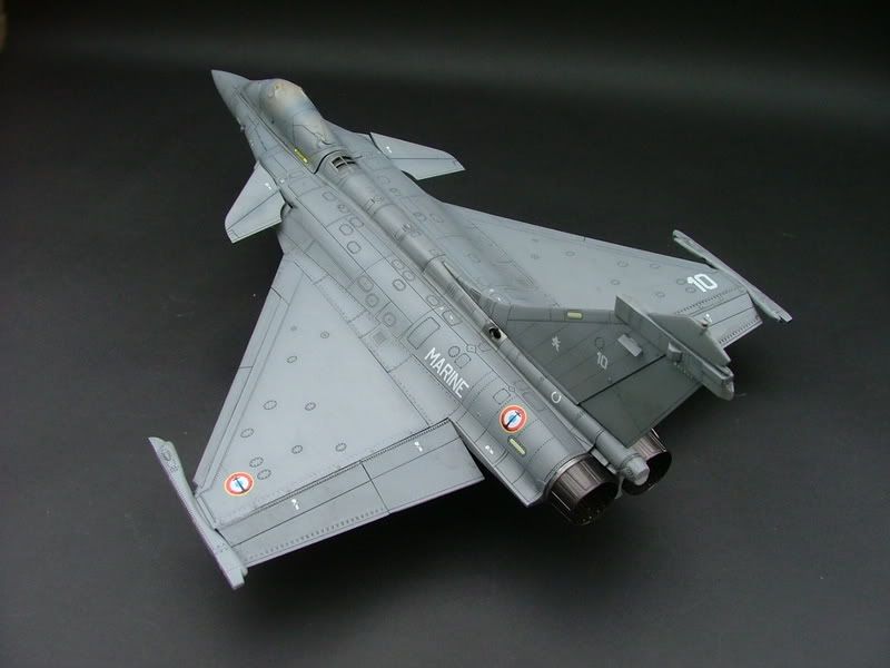

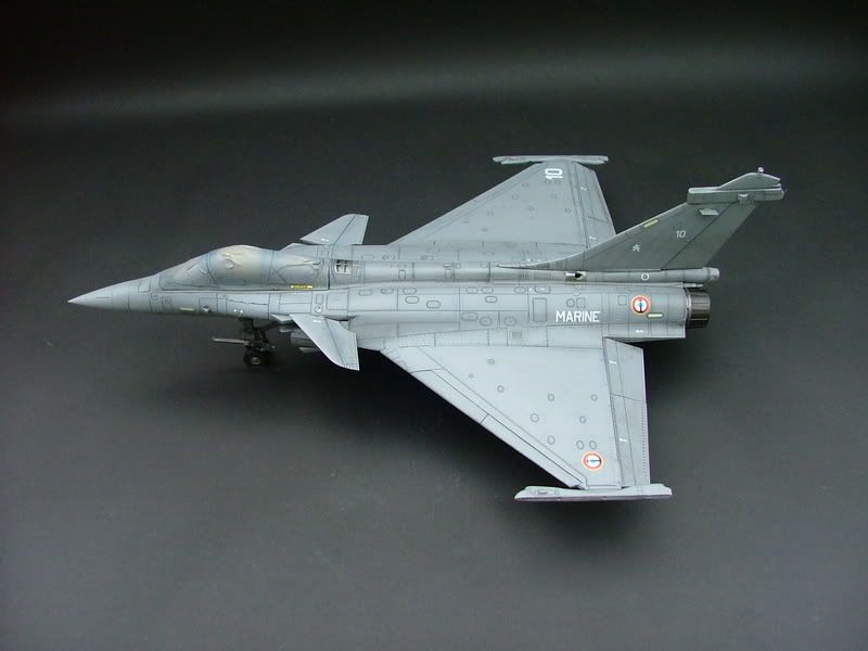

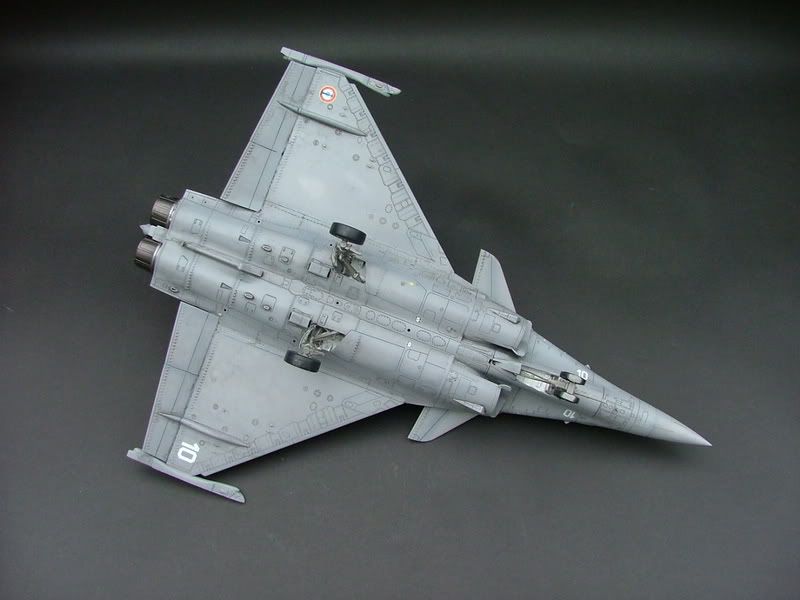

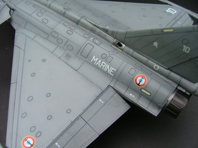

Phil @ Flory Models Posted September 22, 2007 Author Share Posted September 22, 2007 OK, Decaling done and the flat coat on. You can see the weathering better in these pics Next is the weapons load of which there are plenty of options with both types of drop tanks to choose from Link to comment Share on other sites More sharing options...

GrahamEM Posted September 23, 2007 Share Posted September 23, 2007 I've never seen those sprayed on lines in the first pic before, as i'm still wet behind the ears when it comes to modelling i suspect you use a darker spray on the lines before adding the lighter aircraft colour ? Detail looks great Link to comment Share on other sites More sharing options...
Bobs_Buckles Posted September 23, 2007 Share Posted September 23, 2007 I've never seen those sprayed on lines in the first pic before, as i'm still wet behind the ears when it comes to modelling i suspect you use a darker spray on the lines before adding the lighter aircraft colour ?Detail looks great Graham, That my friend is called Pre-Shading. I'm sure Phil will fill you in if you ask. Shady Bob Link to comment Share on other sites More sharing options...
