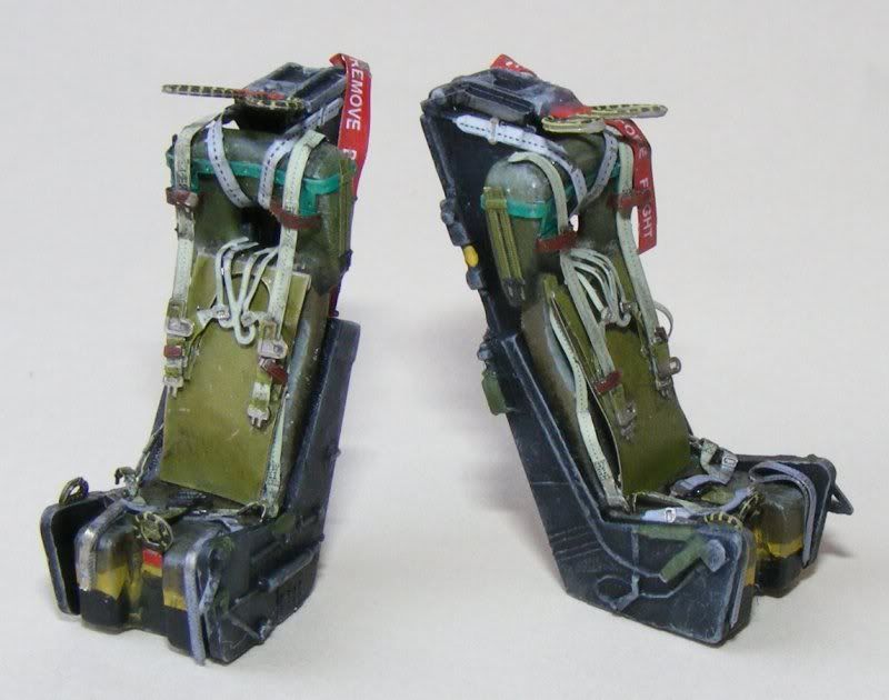

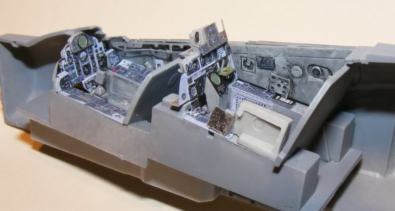

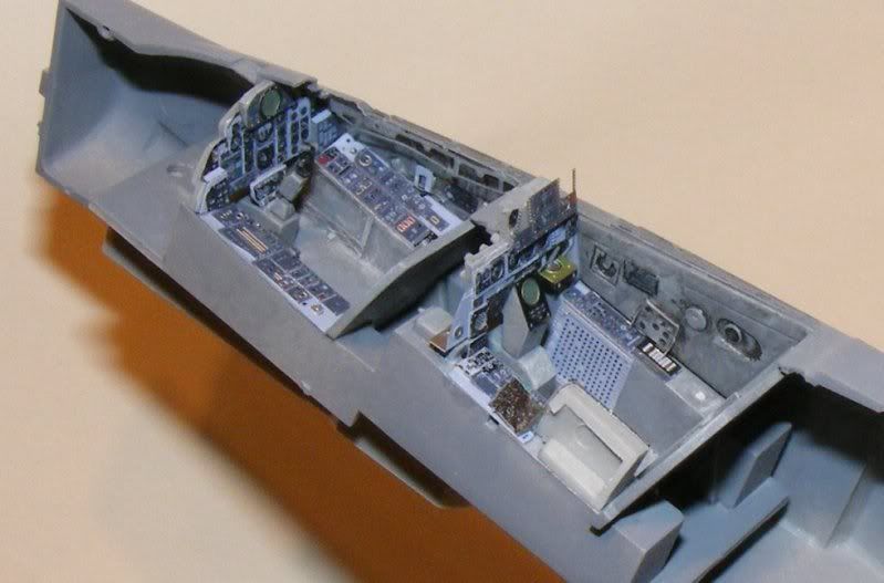

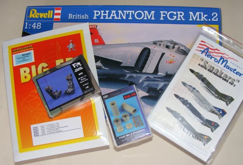

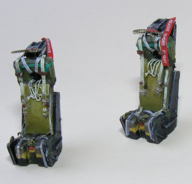

OzH Posted February 18, 2010 Share Posted February 18, 2010 (edited) I picked up a(nother) Phantom for a bargain, at Yeovilton this year. It was one of the Hasegawa FGR.2 boxings, Green and Grey early scheme on the box top. When I got home, I had a look through the other Phantoms in the stash to see what AM bits and pieces I had and decided I wanted to build one - NOW! Looking through them all I decided that I would build the one Revell boxing that I had, (box doesn't look as nice and if I decided to part with them, the Hasegawa kits are worth a little more), which is in fact just a re-box of the lovely Hasegawa kits... I proffed a few bits out of the other box's in the stash and came up with this little lot: As mentioned in Shaun's thread, I'm planning to build her as XV498/U 92 Sqn, Wildenrath, late 80's, as I spent a couple of years there watching these things doing their stuff! I've spent a couple of evenings watching the Winter Olympics tinkering and have so far got to this stage. I've used the Eduard sets, seats and cockpit from the BigEd set, and don't think I'll be useing the Verlinden seats or the Aires cans, the Eduard set takes care of both these area's. The seats are the kit seats with the Eduard etch, I think look great! I recon you could strap a pilot in with this little lot. Edited April 1, 2010 by OzH Link to comment Share on other sites More sharing options...
coolhand Posted February 18, 2010 Share Posted February 18, 2010 Hi, Build looking great so far, love the seats. Just wondering, is this kit still in production? Cheers Link to comment Share on other sites More sharing options...
zero Posted February 18, 2010 Share Posted February 18, 2010 ...... Awesome work mate. Stunning. I wanted to see what the big ed Set was like so I'll be watching this with interest. Getting the pit sorted really is the majority of work on these, Dave Link to comment Share on other sites More sharing options...

avro683 Posted February 18, 2010 Share Posted February 18, 2010 Those seats are awesome Oz. Tony Link to comment Share on other sites More sharing options...

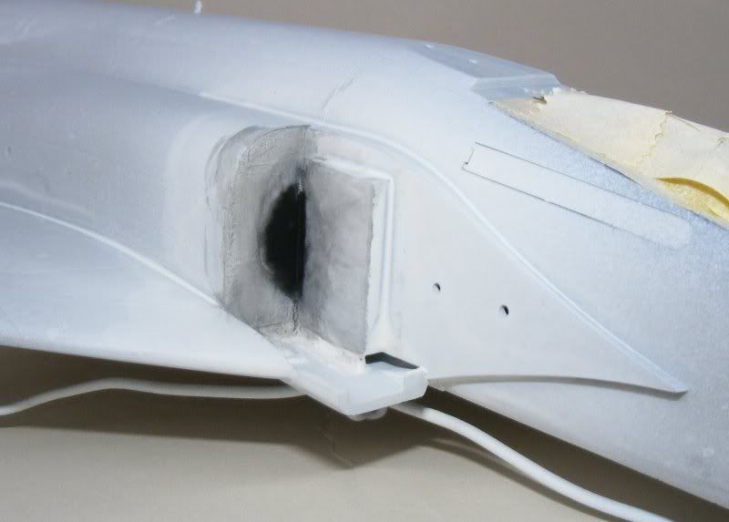

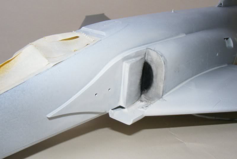

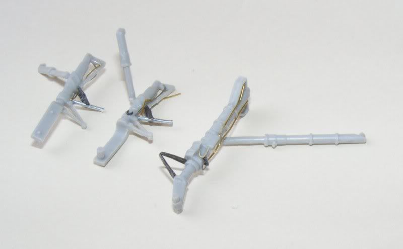

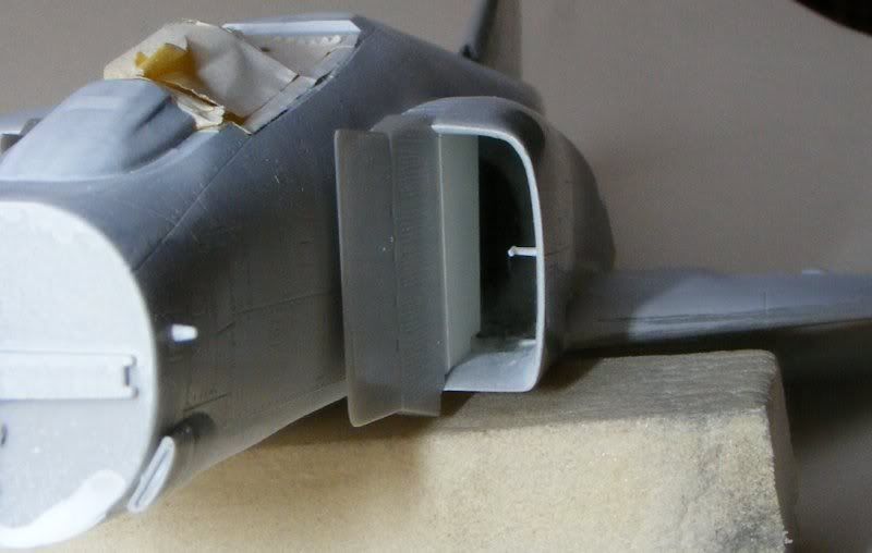

OzH Posted February 24, 2010 Author Share Posted February 24, 2010 Not on the list above, But I have also got the WEEAC Navigator disc on the Phantom, great it is to. One tip that I liked was how to deal with the depth of the intake, I do have some seamless suckers, but was saving them for a special treat... Anyhow, this is what the navigator suggests, paint the ducts on! Not the best photo's, but you get the idea. Works for me! I've done a bit of detail work as well, undercarriage: And empty sidewinder pylon, the original is on the left... Link to comment Share on other sites More sharing options...
Alan P Posted February 24, 2010 Share Posted February 24, 2010 I'm surprised that idea with the intakes hasn't caught on more. I just used it for my Tornado and it works really well. If you want to be really clever, use a printed picture of "down the intake" as your blocker. Good details too! Al Link to comment Share on other sites More sharing options...
Darth Vader Posted February 24, 2010 Share Posted February 24, 2010 Cheers PHaTNesS a printed picture , simple but pure genius Link to comment Share on other sites More sharing options...

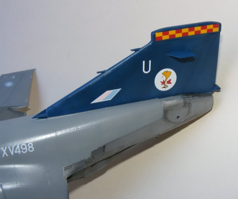

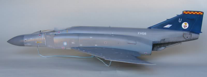

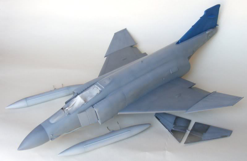

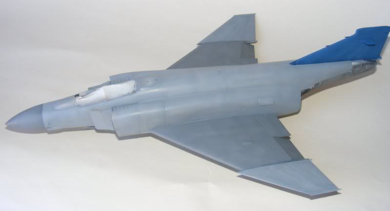

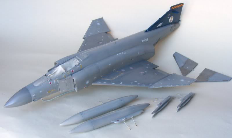

OzH Posted March 8, 2010 Author Share Posted March 8, 2010 Got some paint on... Next.... Decals. Link to comment Share on other sites More sharing options...
AnonymousAA72 Posted March 8, 2010 Share Posted March 8, 2010 Got some paint on... Next.... Decals. Great job Oz...but that blue looks very pale - shouldn't it be RAF Roundel Blue? Link to comment Share on other sites More sharing options...
OzH Posted March 8, 2010 Author Share Posted March 8, 2010 Great job Oz...but that blue looks very pale - shouldn't it be RAF Roundel Blue? It does look pale, just had another look at the model which looks about right, I think it due to the lighthing when I was taking the photo's. Thanks for pointing it out though... Link to comment Share on other sites More sharing options...
AnonymousAA72 Posted March 8, 2010 Share Posted March 8, 2010 It does look pale, just had another look at the model which looks about right, I think it due to the lighthing when I was taking the photo's. Thanks for pointing it out though... Yes, I'm sure its fine. I was just comparing it to the picture at the top - roundel blue is of course a dark blue! Link to comment Share on other sites More sharing options...

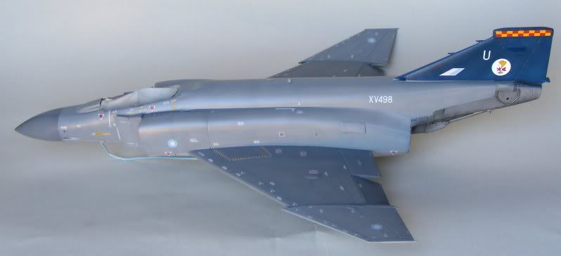

OzH Posted March 10, 2010 Author Share Posted March 10, 2010 After a second and third look at the tail, I decided to darken it up a bit. I airbrushed a thin coat of Tamiya Smoke and I have to say, I think it looks a better! I've also been decalling...... two nights work: Link to comment Share on other sites More sharing options...
bexwh773 Posted March 10, 2010 Share Posted March 10, 2010 Oz, Nice to see you working on a Phantom, and this one looks cracking. Thanks for the info on the Big Ed set, I think I'll be adding that to my collection, especially as it does away with the need for any other AM bits. Love the office and the seats, especially as theyre the kit ones Bexy Link to comment Share on other sites More sharing options...
AnonymousAA72 Posted March 10, 2010 Share Posted March 10, 2010 After a second and third look at the tail, I decided to darken it up a bit. I airbrushed a thin coat of Tamiya Smoke and I have to say, I think it looks a better! That does look a lot better Oz, coming along nicely!! Link to comment Share on other sites More sharing options...

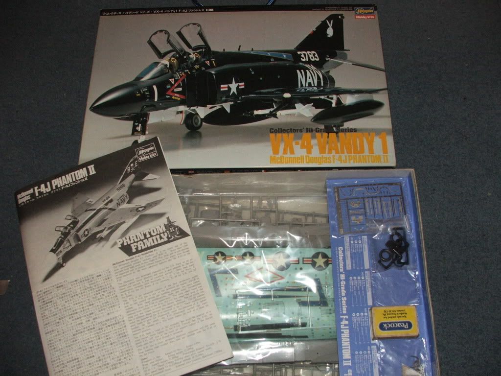

RobMac Posted March 11, 2010 Share Posted March 11, 2010 Very very nice indeed Oz! I do like the RAF Spooks. I have two in my stash, one the Revell kit and the other is this little beauty:- This is one kit I am looking forward to building................eventually Link to comment Share on other sites More sharing options...
