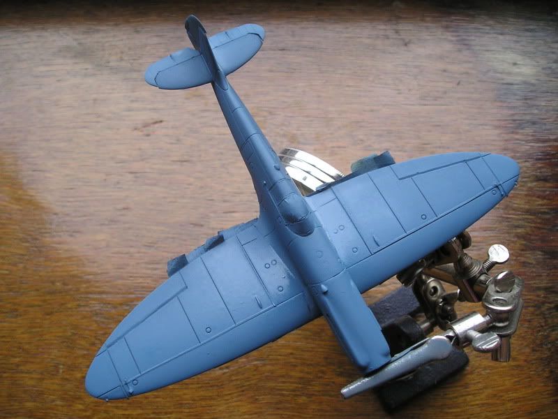

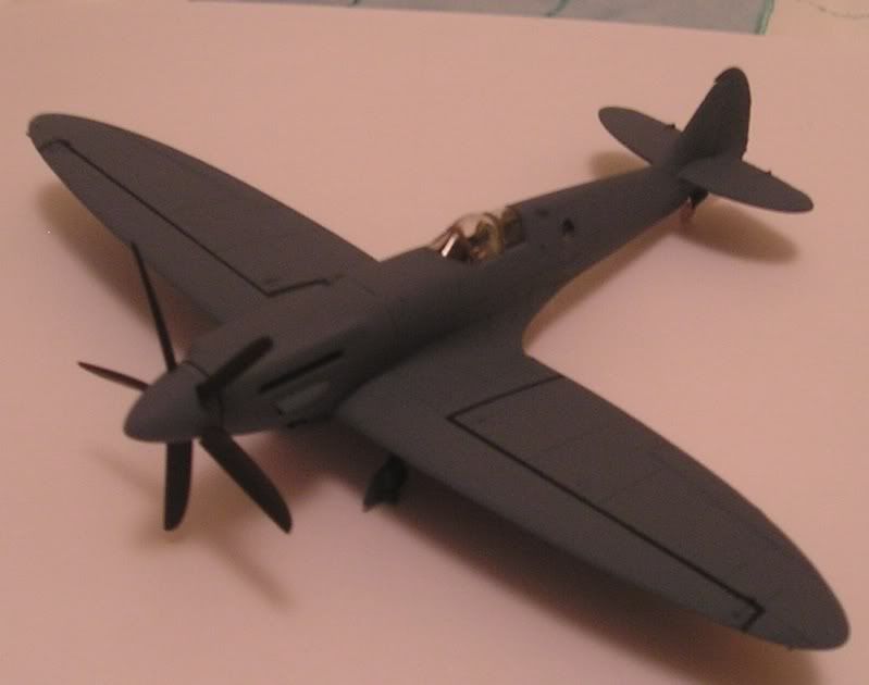

Col. Posted December 23, 2010 Author Share Posted December 23, 2010 Here's the photos of paint progress so far. Did a little more work on the u/c last night but nothing worth showing. Link to comment Share on other sites More sharing options...

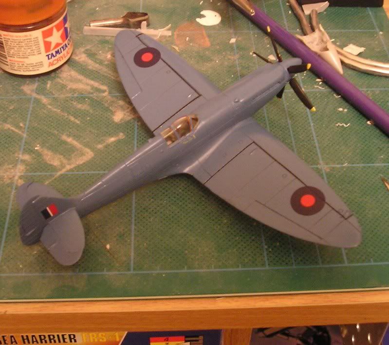

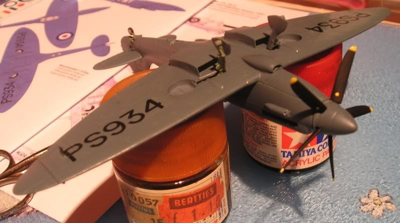

Col. Posted December 27, 2010 Author Share Posted December 27, 2010 (edited) Decided to concentrate on one at a time in the hope I'd get one finished before this year is out, this also gets around the problem of cold temperatures in the garage and the effect on spraying since I already have the paint on one, so PS853 has been set to one side. The other one - can't decide on a serial for her yet, had a little more detail added to the u/c legs then a representation of the small mesh FOD screen that protects the left cowl air intake made from clear plastic. After a few minor touch-ups a coat of Future was applied and everything is drying now. Will post a photo in the morning once daylight arrives then think about what markings to apply. *Edit* Went with PS934 from the Freightdog Models sheet Post War RAF Spitfires Edited December 28, 2010 by Col. Link to comment Share on other sites More sharing options...

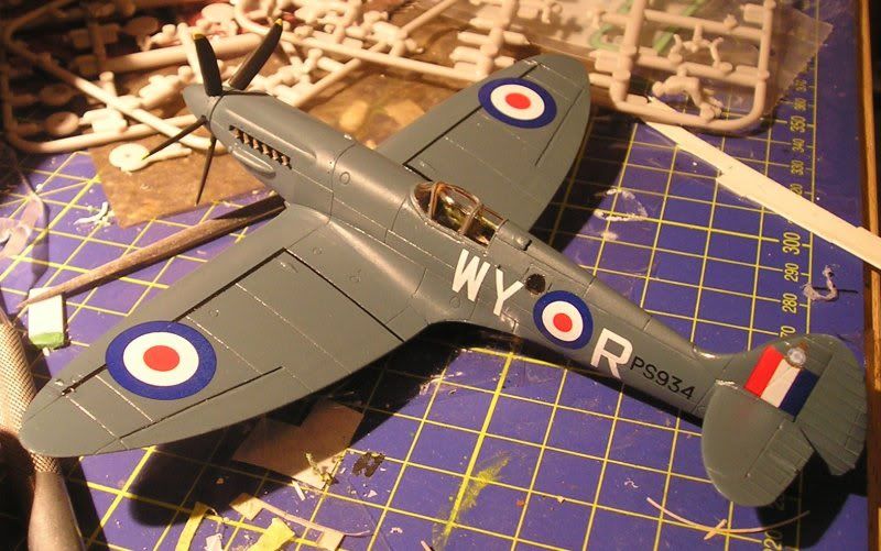

Col. Posted December 29, 2010 Author Share Posted December 29, 2010 All the decals are on, including a fiddly three-part squadron badge on either fin that truly tested my patience, and the exhaust stacks are also added. These were painted matt black then dry-brushed with progressively lighter browns until finishing with a cream on the edge of each to represent the heating effects. The Freightdog decals are good quality and conform well to surface detail and panel lines with a bed of Future but the separate red roundel centres and that three layer squadron badges did annoy me slightly. Perhaps that was, however, more due to my lack of skill than any fault of the decals. Link to comment Share on other sites More sharing options...

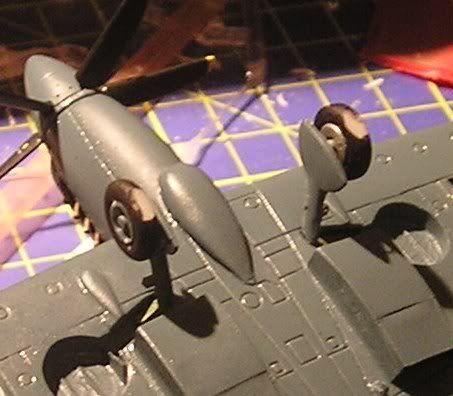

Col. Posted December 29, 2010 Author Share Posted December 29, 2010 Thanks gents. Was about to say all I need to do is a final coat of Future then attach the brake pipes and main wheels but noticed I've forgoten to represent the fuel filler cap in front of the windscreen Will have a think and decide if it's worth trying to do something without causing undue damage. Link to comment Share on other sites More sharing options...

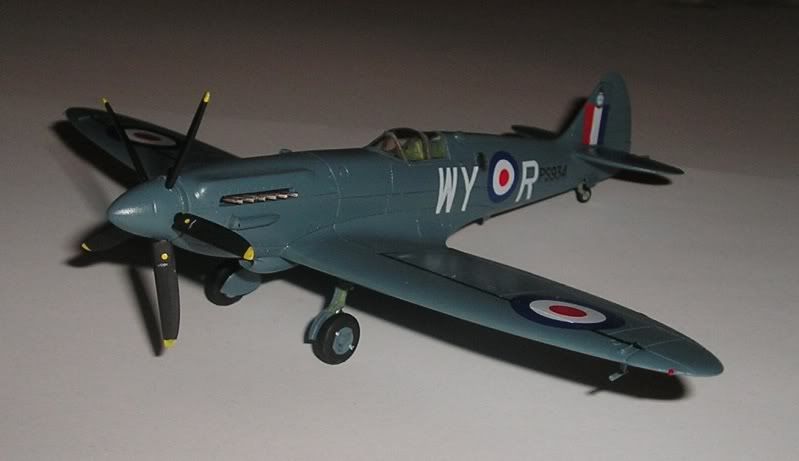

Col. Posted December 30, 2010 Author Share Posted December 30, 2010 Got the brake lines and wheels on last night. Then did a little more detail painting and a final coat of Klear/Future since I was up early because Fiona started back at work today. Be a couple days before I get a chance to take better photos during daylight hours but calling this one done. 1 done - 1 to go Link to comment Share on other sites More sharing options...

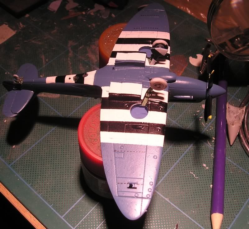

Col. Posted January 1, 2011 Author Share Posted January 1, 2011 Loaded the airbrush with a mix of Humbrol 230 and old MC12 then pointed it in the general direction of PS853 this morning. Happy enough with the colour when comparing it to photos of the Rolls Royce-owned machine but really need to improve my airbrushing techniques. Link to comment Share on other sites More sharing options...

Col. Posted January 1, 2011 Author Share Posted January 1, 2011 (edited) Thank you Ed, hope my experiences and mistakes can help others as they work on what is as you say a nice kit with plenty of potential to build either from the box or with added detail, will you be starting yours soon and what do you have planned for them? *Edit* Forgot to mention a little of the white on the 'invasion stripes' has pulled away with the masking so next task is to touch in and tidy up that areas. A combination of inadequate surface preparation and poor attention to the edges of the tape has made for more work than should be necessary. Edited January 1, 2011 by Col. Link to comment Share on other sites More sharing options...

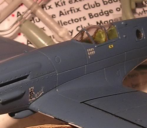

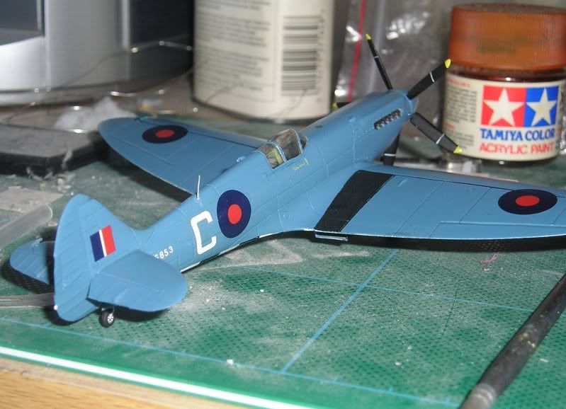

Col. Posted January 5, 2011 Author Share Posted January 5, 2011 Got most of the detailed markings painted on yesterday. Link to comment Share on other sites More sharing options...

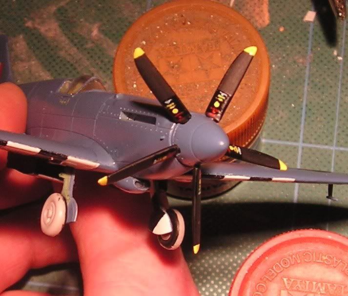

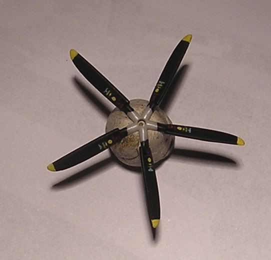

Col. Posted January 9, 2011 Author Share Posted January 9, 2011 Got the wheels and brake-lines on along with a small aerial behind the rear camera port; ...then the prop and spinner plus a small part that projects out of the cowling. While painting on Klear for the first decals I coated the prop stencils at the same time as they are glossy against the otherwise matt black blades; ...then got the main national marking decals on from the Airfix sheet; Link to comment Share on other sites More sharing options...
Inverted Posted January 10, 2011 Share Posted January 10, 2011 ooo looking nice! Did you hand paint those markings around the canopy and cowling? If so... u must be mad! looks great though..... Link to comment Share on other sites More sharing options...

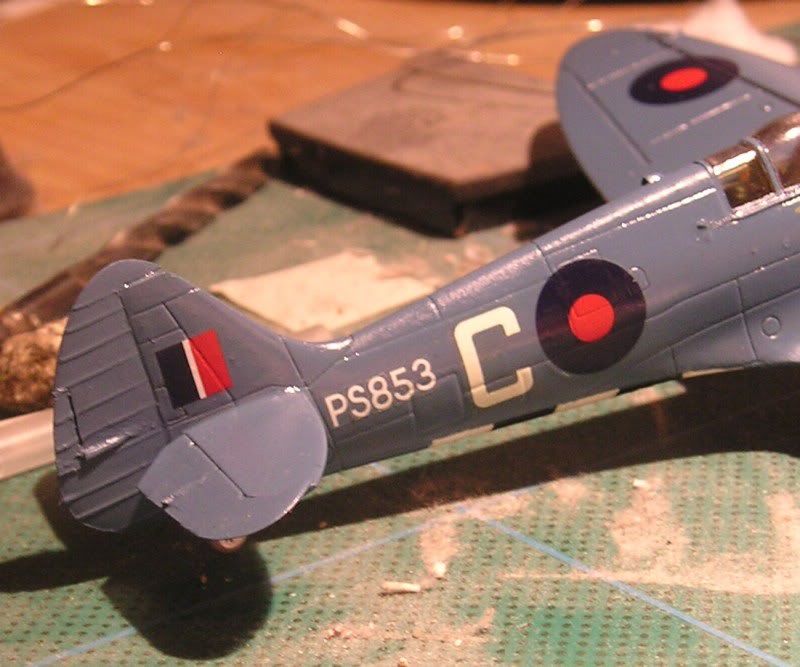

Col. Posted January 11, 2011 Author Share Posted January 11, 2011 Thanks Chris, I think All the small markings were indeed hand-painted. Spent ages looking for a suitable size and shape of white 'C' for beside the fuselage roundels before cutting two out of some '0's on a 48th scale Hasegawa RN Phantom sheet. All going well until I used too large a size for the fuselage serial codes so looks like I'll have to strip them off and try again. Teach me to keep the references within sight Get that sorted and she's almost done! Link to comment Share on other sites More sharing options...

Col. Posted January 12, 2011 Author Share Posted January 12, 2011 Thanks Jamie very nice of you to say so. Decided the serial decals needed to change otherwise I'd never be happy with it so out came the sharp knife. Before; After; Next objective is the 'ROLLS-ROYCE' title ahead of the cockpit but not sure how to source the correct size and font as it's a little smaller than my decal stock covers. Link to comment Share on other sites More sharing options...
