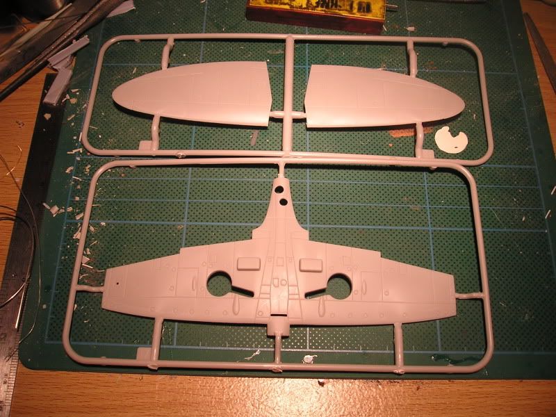

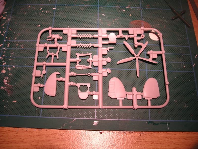

Col. Posted January 19, 2010 Share Posted January 19, 2010 Was given the Airfix BBMF box-set at Christmas and thought the Spitfire XIX would make for an interesting out-of-the-box build while hacking at the same company's 48th Sea Harriers. Then I had a look at the IPMS Stockholm walkaround and seen TonyT's photos... Anyway, enough excuses, here's the sprue shots. Link to comment Share on other sites More sharing options...
hazza Posted January 19, 2010 Share Posted January 19, 2010 the only problem i have found with this kit is the thick sprue gates, especially on the prop, nice kit though and cannot wait to see more. Link to comment Share on other sites More sharing options...

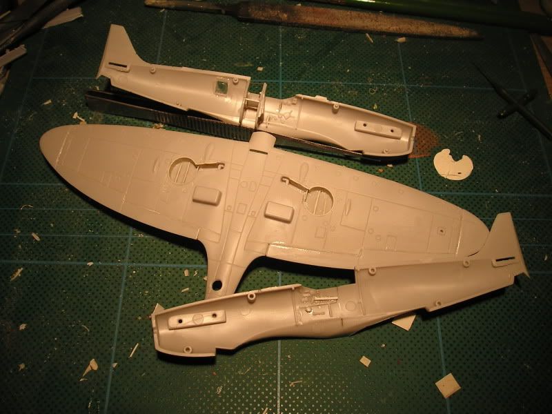

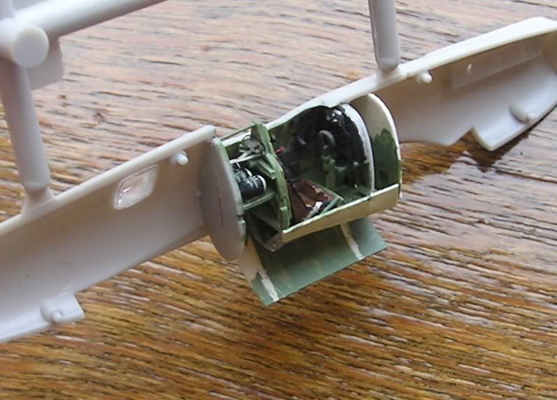

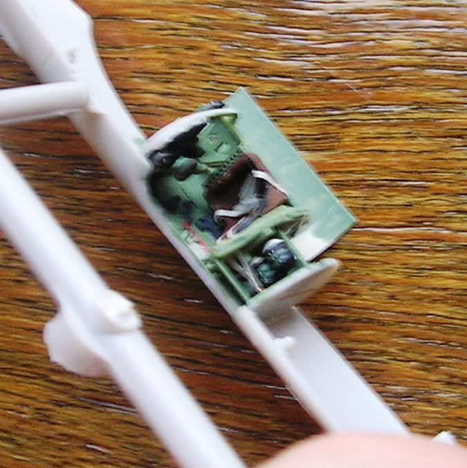

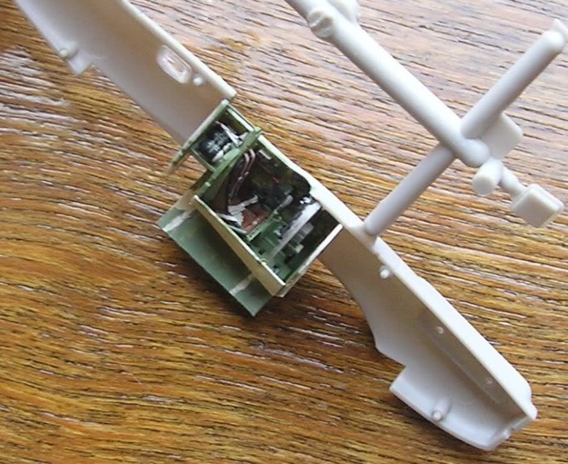

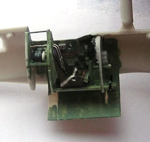

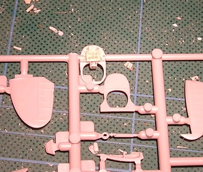

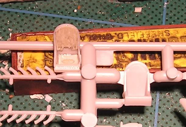

Col. Posted January 19, 2010 Author Share Posted January 19, 2010 While the detail included as standard is quite nice I couldn't leave it alone and had to start butchering the poor thing. First up, a few minor additions to the cockpit sidewalls. Then the seat. Cut the base out and added a new one after thinning and modifying the sides then made a new seat cushion. Also cut off the lower part of the locating lag to allow the seat the sit lower in the cockpit. With hindsight I may be quicker scratch-building one for the second kit. The instrument panel is blank so drilled holes in a couple pieces of thin plastic card to dress it up a little. It's also had the lower part of the framework cut down to help get a new cockpit floor located later and the compass added. Final shot for tonight is the wheel-wells, although I've made a mistake in boxing in the leg bays when these were partially open and contain the retraction mechanism. Was going to leave it there but may have another crack at it if I can figure out a way to do it without splitting the wing open again. Link to comment Share on other sites More sharing options...

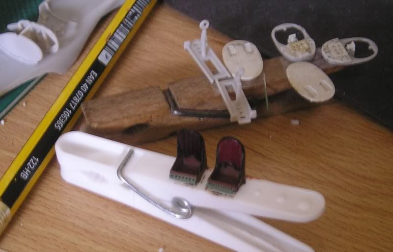

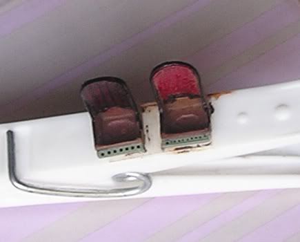

Col. Posted April 15, 2010 Author Share Posted April 15, 2010 Made little progress over the last few days but here's the seats so far. The photos in Tony's walkaround were the basis for these although I've gone with one brown and one black backrest cushion since there seemed to have been a choice of colours. A few other cockpit components are ready for paint but I'm tempted to re-do one to represent a modern BBMF example as contrast. Any reports on how the Airfix decals perform? Link to comment Share on other sites More sharing options...

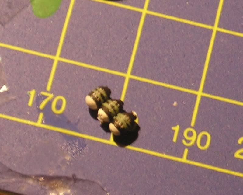

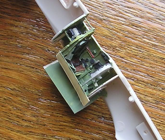

Col. Posted November 6, 2010 Author Share Posted November 6, 2010 (edited) Got a set of air bottles finished to fit behind the seat in one of the kits. They are now in place but will take a daylight photo in the morning as I doubt artificial light will show them well installed in such a small area. Also found the control columns needed shortening by a millimeter to fit well in relation to the instrument panel. Working on the seatbelts now. Have chosen to do one as a standard service machine and the other as a preserved example so there are a few differences within the two cockpits worth recording. Edited November 7, 2010 by Col. Link to comment Share on other sites More sharing options...
Col. Posted November 7, 2010 Author Share Posted November 7, 2010 Woke up early this morning so finished the seatbelts and got the panel and control column structure fitted. The column needed shortening by about a millimeter to look right in relation to the panel. Hopefully get the other one up to this point later today. Link to comment Share on other sites More sharing options...
Col. Posted November 11, 2010 Author Share Posted November 11, 2010 Calling the cockpits of both finished and taken a few shots before closing the fuselage. Was thinking about lightly detailing the camera bays but it seems nothing will be seen unless someone takes a magnifying glass and a torch to the fuselage side window. With any luck I'll be able to reach anyone trying that trick and deliver a good slap for their troubles before they get a chance to see inside... First two are the modern machine. No camera control box on the instrument panel and a cluster of radio gear behind the pilot who is supplied with a modified seatbelt. Now it's 'older' sister. More equipment on the sidewall where the entry door on non-pressurised machines would be and three air bottles behind the pilot. Both needed an extra strap of thin plastic to complete the curved cockpit floor as I measured too narrow a piece to join the starboard side. Hopefully the next photos will show the main airframe components all together and Spitfire-shape. Link to comment Share on other sites More sharing options...

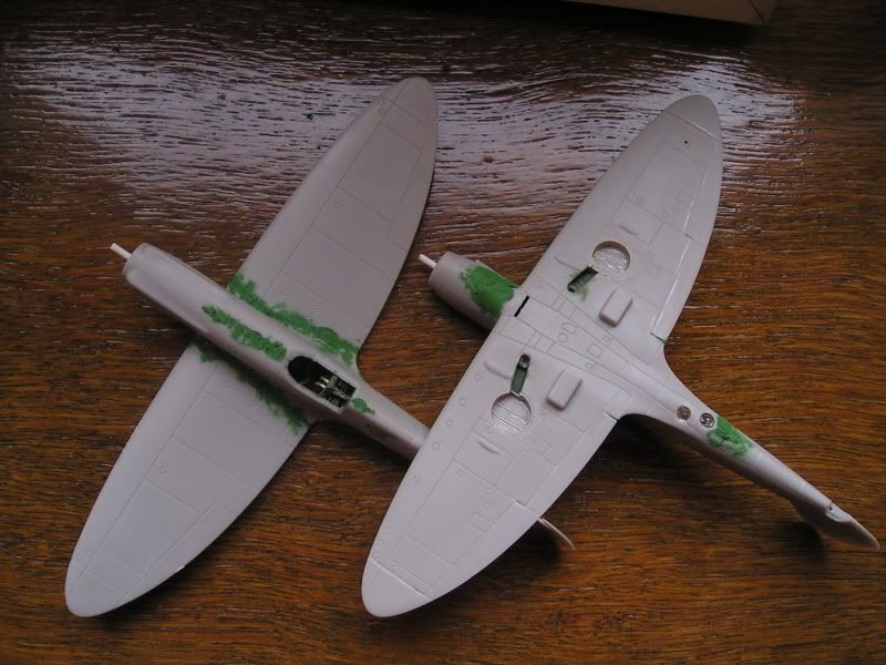

Col. Posted November 14, 2010 Author Share Posted November 14, 2010 Got the fuselage halves mated and wings on. Also added the rudders and started modifications to the propellers and spinners to make painting a bit easier in that area. Filler added where the fit isn't perfect. Wing roots were the worst areas but once this is all smoothed down I'll start detailing the airframe. Link to comment Share on other sites More sharing options...

Col. Posted November 16, 2010 Author Share Posted November 16, 2010 Thanks Nick, nice to know someone is interested, alas not much progress to report over the last few days. Filler rubbed down and re-done in a couple areas then the carburetor intake scoops hollowed out to look more accurate. Once there's more interesting stuff done I'll continue the photo updates. Link to comment Share on other sites More sharing options...
