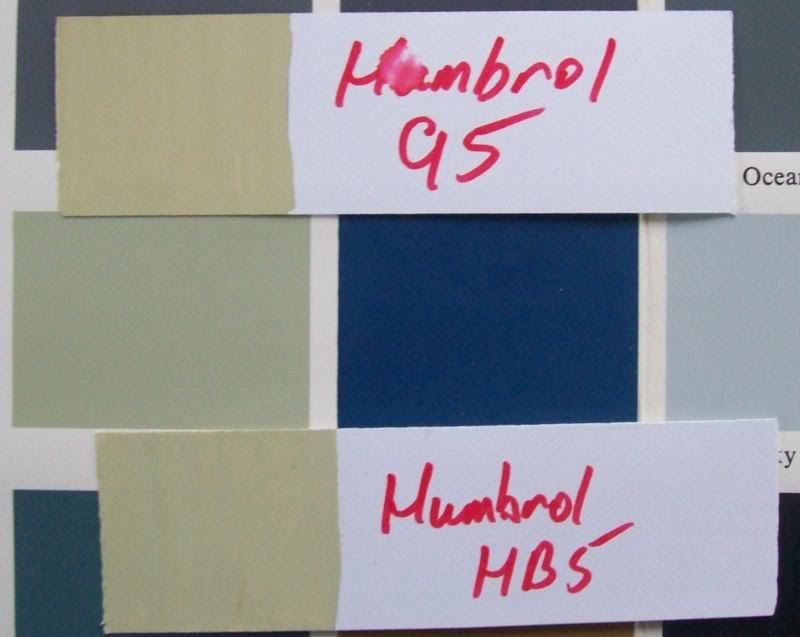

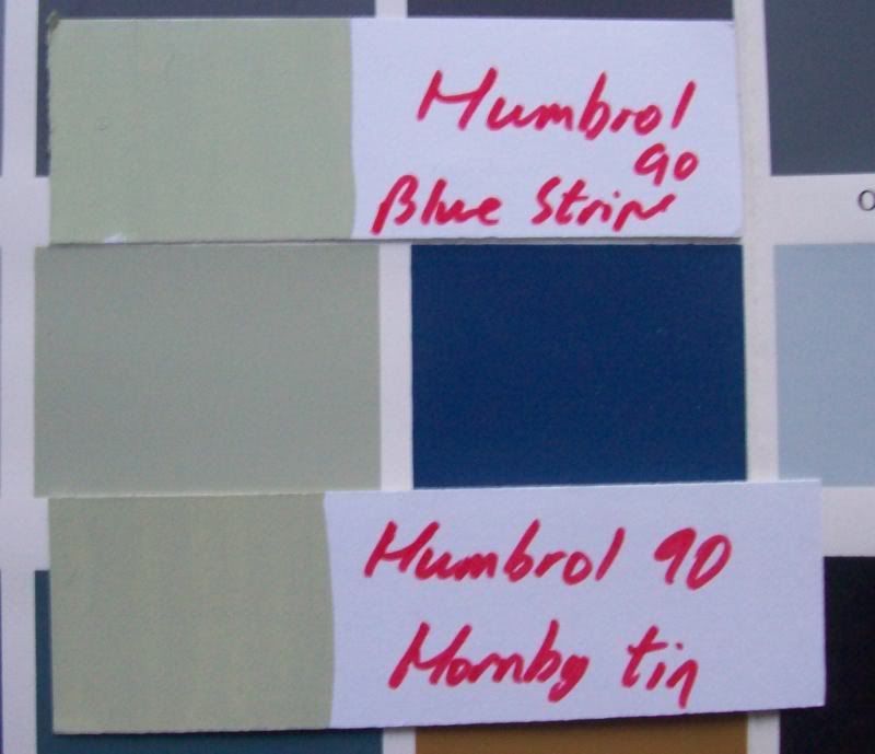

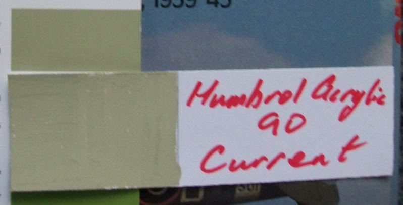

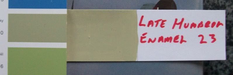

John Posted December 28, 2009 Posted December 28, 2009 (edited) A couple of years ago I brushed out some proprietary Sky model paints. I’ve been meaning to do a more comprehensive brush-out ever since, and this week I finally got enough time to have a go. I trawled the deepest recesses of my paint store and came up with a fair selection of current and older “Skys”, or colours recommended as Sky.I brushed out samples onto white card and compared them to the colour chip in the RAF Museum book and a current copy of BS381c. The shade of Sky in the RAFM book is a bit lighter than the current BS381C:210 colour which may support the theory that modern Sky is different to the WWII shade, but frankly there isn’t much in it:First of all, Humbrol 90 Beige Green. This has been the shade of choice in Airfix kits for some considerable length of time and, on going through my stock, I found I had examples of this colour as follows:Humbrol 90 enamel in a 1980s “Blue Band” tinHumbrol 90 enamel in the current Hornby tinHumbrol 90 acrylic in an original 1980s “Hobby Acrylic” potHumbrol 90 acrylic in the current Hornby potThere’s no doubt that this shade has varied a bit over the years:Compared to the RAFM book, 90 holds up well as a substitute Sky. These are enamels:and these are acrylics:In particular the current Hornby enamel and acrylic match up very well indeed, with the current acrylic being just a touch darker than the enamel. That makes the enamel a touch pale compared to BS381c:210, but of course that’s maybe not a bad thing.I also found 3 tins of 23 Duck Egg Blue. Again, this has gone through a few changes over the years:These are all enamels as this colour has never, as far as I know, been included in any Humbrol acrylic range. The oldest tin I have is a 1970s “Grey Stripe”, which hadn’t been opened until I did these brush-outs. One thing that you can tell straight away is that this colour isn’t blue! This is my oldest sample compared to the AM Sky Blue chip in the RAFM book:It’s actually currently very close to 90 and, therefore, close to the RAFM chip:Other Skys are these:Xtracolor and Xtracrylic:Both are a tad dark for the RAFM chip, but very good for 210.Gunze and Tamiya:Tamiya is too dark for the RAFM chip, and the Gunze has a somewhat Buff/Yellow cast to it.Aeromaster Acrylic:Aeromaster is a slightly stronger version of the Gunze shade.A couple of blasts from the past, Humbrol HB5 Sky and 95 Concrete:Moving on to BS381c, the Hannants paints are very good matches, as we would expect:Both Humbrol 90 and 23 are reasonable:Tamiya is almost spot-on:I would, therefore, have no hesitation at all in using Humrol 90 in either enamel or acrylic for WW11 Sky. It’s comfortably in the ball-park compared to the RAFM chip. I would also be happy to use 23. For BS381c:210, I’d probably use the Hannants colours, but the Humbrol colours are definitely close enough for Government work!Apart from those, Tamiya needs lightened and Gunze needs the yellow caste killed a bit, but they’re all usable.John Edited August 30, 2015 by John 4 1

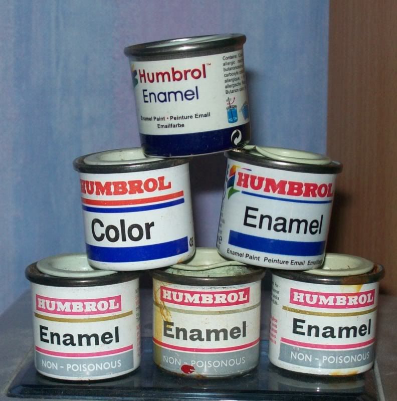

Scooby Posted December 28, 2009 Posted December 28, 2009 What markings on the container tell you if you have original form?

John Posted December 28, 2009 Author Posted December 28, 2009 John,A very interesting series of comparisons. My monitor shows that the Humbrol 90 Hornby Tin, the 90 Acr. Origonal and Late 23 are as close as I would ever want to get. Also, Xtracolour X7 and Xtrcrylix 1007 are good, as is the Tamiya XF-2. I've got most of these somewhere. I wonder how the WEM Sky compares? I'll give it a try. Thanks again. Trubbie. I'm afraid I don't have any WEM paint at all, so I can't comment objectively but it does have a very good reputation. Maybe I should order a couple of tins for research purposes! John
John Posted December 28, 2009 Author Posted December 28, 2009 What markings on the container tell you if you have original form? These are some of the tins I used in this exercise. The lower 3 are "Grey Band", from the late 1970s/early-mid 1980s. The middle left is from the mid 1980s and the middle right is later again. The one on top is a Hornby tin. You can tell the most recent Humbrol paints as they have Hornby's Margate address on the tin, rather than Humbrol's Hull address. John

Spitfire31 Posted December 29, 2009 Posted December 29, 2009 Great work with this comparison – many thanks! The next time, you might consider using manually set white balance (set while pointing the camera at a white or neutral grey card or paper) and also locking the exposure (keeping the lighting unchanged, of course) so that it's consistent over the range. Some of the pics have a bluish or cyan tinge which is probably an effect of using automatic white balance, which is generally not dependable for exacting work like colour comparison. Thanks again for all your work! Humbrol 90 or Xtracolor it is. Best, Joachim

John Posted December 29, 2009 Author Posted December 29, 2009 So to totally confuse people again, Old 90 according to Edgar, is actually RAF Interior Green. It was switched to Sky in later releases. Actually, looking at my samples I don't think 90 has changed all that much over the years. It was introduced when Humbrol expanded their Standard colour range in 1978 and I don't think my earliest example is much older than that. Of course there will have been different production batches over the years which will have varied a bit in colour. John

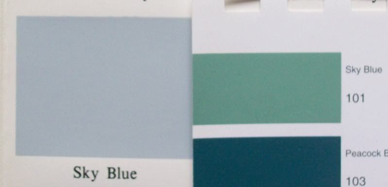

Jens Posted December 29, 2009 Posted December 29, 2009 Humbrol used to do Gloss Eau de Nil as colour number 1, but there's nothing close in the current range. CompuColor had it in the 1980s as well. Colour 13 (I think) was Gloss Sky Blue (the BS381 shade, rather than AM Sky Blue) but both these shades had gone from the range by (?) the early 1970s. Thanks John, I'll have a look in my father's stash of old Humbrol paints then. How big is the difference between the BS381 Sky Blue and the AM Sky Blue? There used to be a Humbrol colour called 97 Eggshell, which was discontinued about 15 years ago. I may have a pot lying around, but my memory is that it came out a pale blue shade. I'll have a rake!John I have a tin of 97 Eggshell which I have used on my PR Type A Spitfire: The picture shows the colour as it looks IRL - at least on my screen. Regards, Jens

John Posted December 29, 2009 Author Posted December 29, 2009 Thanks John, I'll have a look in my father's stash of old Humbrol paints then. How big is the difference between the BS381 Sky Blue and the AM Sky Blue?I have a tin of 97 Eggshell which I have used on my PR Type A Spitfire: The picture shows the colour as it looks IRL - at least on my screen. Regards, Jens This is AM Sky Blue against BS381c:101 Sky Blue, and you can see that they are completely different shades: I think the original 1930 shade may have been a bit lighter but Mike Starmer has my copy of the 1930 standard at the moment, so I'm working from memory here. I like the 97 Eggshell finish! Looks like another contender for the Sky crown. That means that in the mid-1990s, Humbrol had 4 different paints out that were there or thereabouts for Sky. John

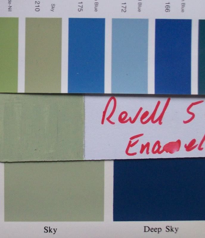

John Posted December 29, 2009 Author Posted December 29, 2009 Here's another competitor - Revell Matt 59: Again, well within the ballpark. John
