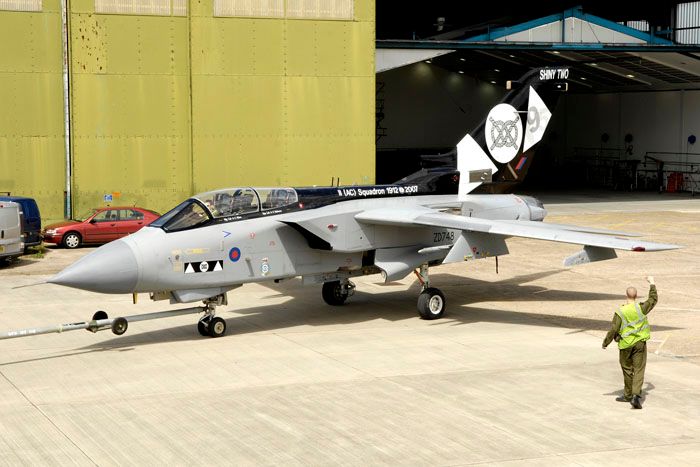

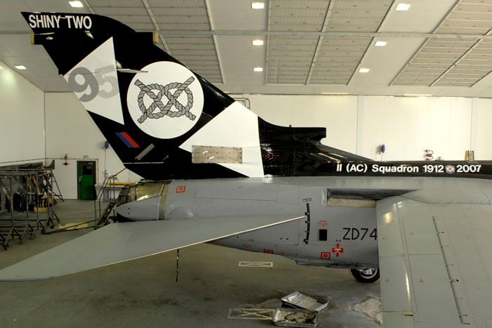

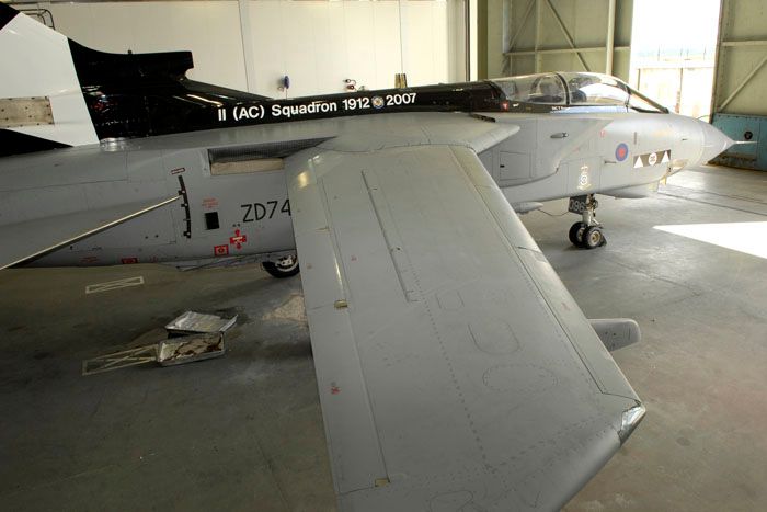

zipper Posted December 4, 2009 Share Posted December 4, 2009 (edited) Muzz, A superb build bud, I have a soft spot for the old Tonka after being with them at Marham. I'd go for "Shiny Two" for your colour scheme, mind you I would say that as I designed her When she first rolled out Both below are just before she rolled out Keep up the good work and I'll be watching this one Edited December 4, 2009 by zipper Link to comment Share on other sites More sharing options...

Muzz Posted December 5, 2009 Author Share Posted December 5, 2009 Cheers for the pics Zipper, a very shiny looking example!! I'll add that one to the possibles. Was wondering if you or anyone else can tell me if the undercarriage bays are the same colour as the undercarriage itself, thought there might be the possibility of light grey legs and white bays? Link to comment Share on other sites More sharing options...

zipper Posted December 6, 2009 Share Posted December 6, 2009 Cheers for the pics Zipper, a very shiny looking example!! I'll add that one to the possibles. Was wondering if you or anyone else can tell me if the undercarriage bays are the same colour as the undercarriage itself, thought there might be the possibility of light grey legs and white bays? Hi Muzz, Not a prolem with the pics, I will find out for you about the legs and let you know. zipper Link to comment Share on other sites More sharing options...
zipper Posted December 7, 2009 Share Posted December 7, 2009 (edited) Muzz, Legs and U/C bay are the same colour - white and thats come from the guys at Marham. Edited December 7, 2009 by zipper Link to comment Share on other sites More sharing options...
