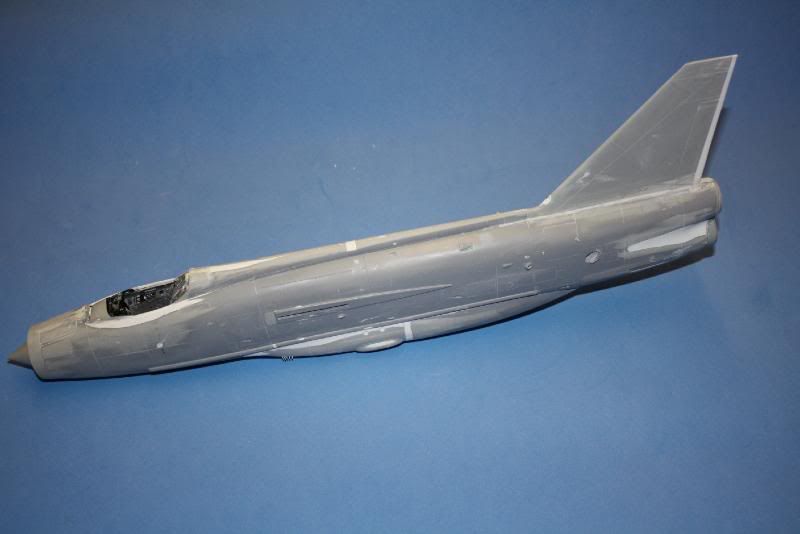

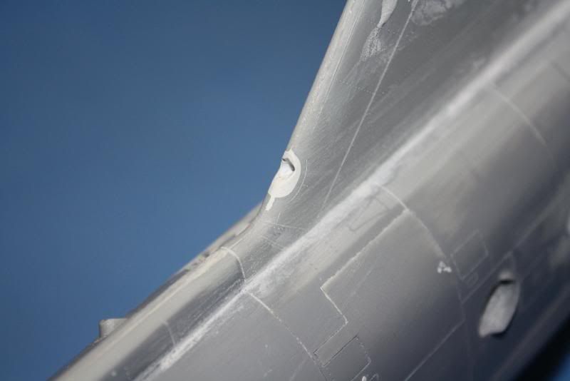

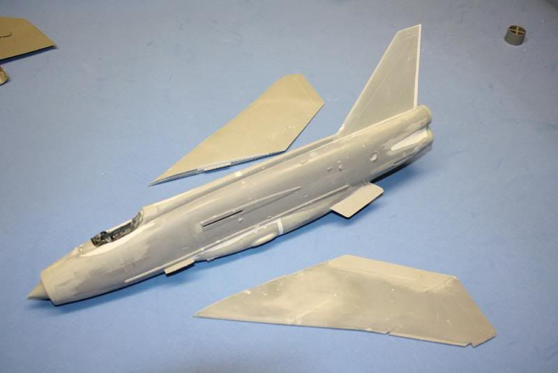

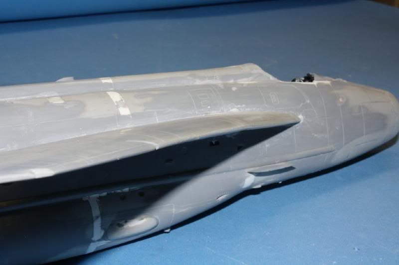

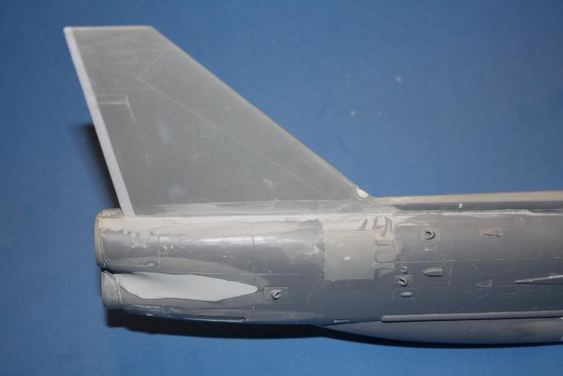

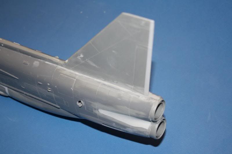

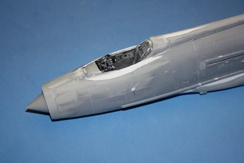

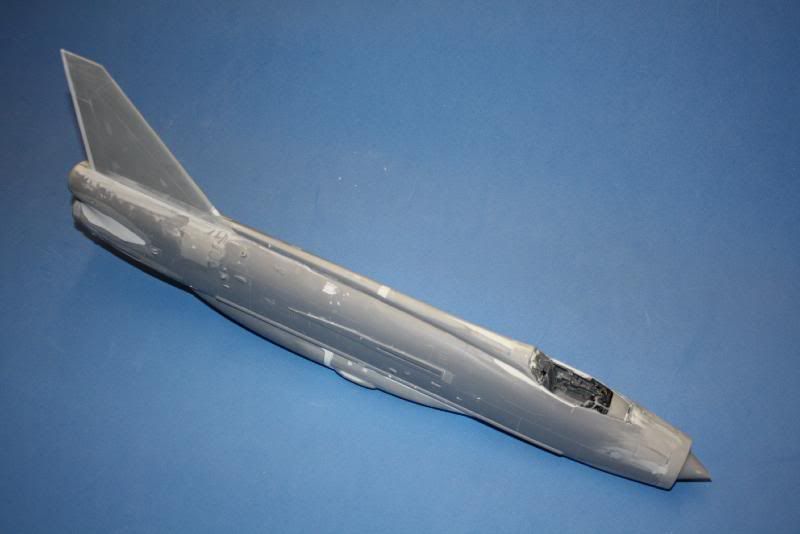

AnonymousAA72 Posted November 2, 2009 Author Share Posted November 2, 2009 Getting to the stage where I'm going to have to start tackling the wings..... BUT for the moment - here's where I am with the fuselage. Almost (but not quite) there. Nose section - you can see where I've rescribed here. Also The nose ring has been reduced in depth! If anyone of you are brave enough to tackle this kit, and even if you make no other modification - this is a MUST!!! Three views of the fin modification, the rear extension is evident Also, you can see how I've amended the intake on the fin's leading edge. Some plastic tube and milliput reduced the hole. I've also moved the fin forward. The angle of the fin and spine should be inline with the airbrake. Next phase will be a bit of cleaning up, add the various antennae/fuel dumps spine intake, AC Beacon and maybe the modified strakes. Then mask the cockpit and get the Halford's out!! Then the wings!!!!! Link to comment Share on other sites More sharing options...

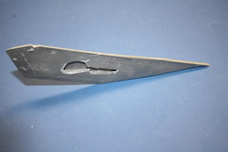

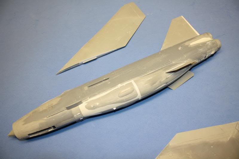

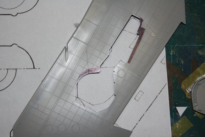

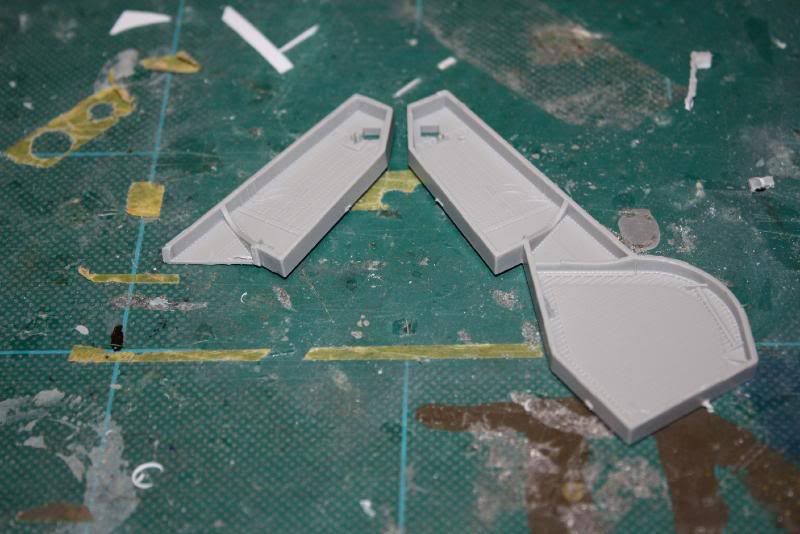

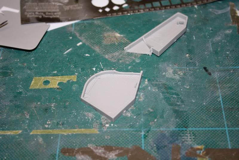

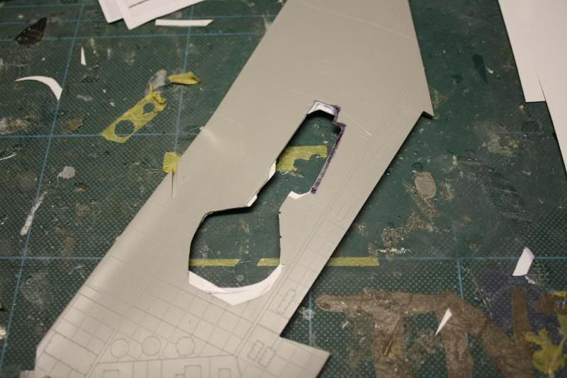

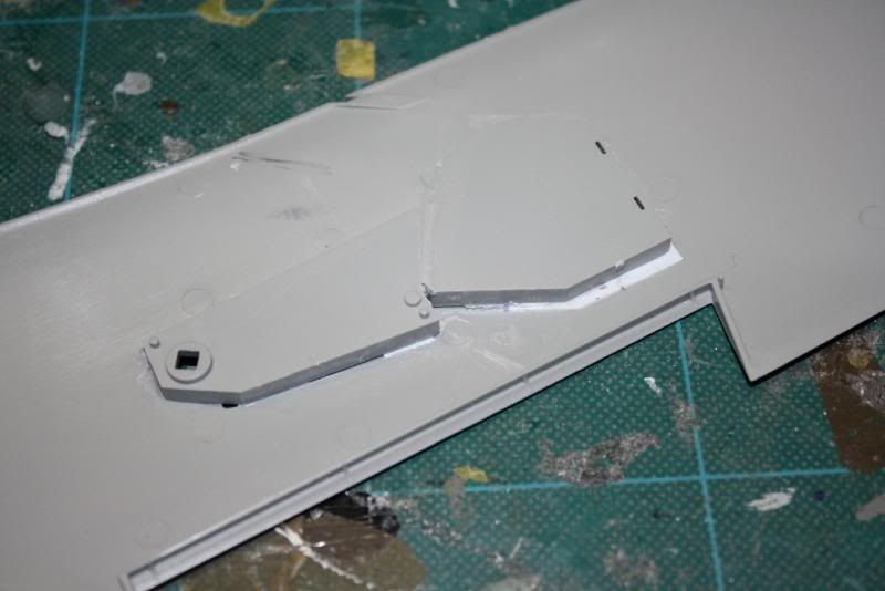

AnonymousAA72 Posted November 7, 2009 Author Share Posted November 7, 2009 As its a bit quiet - everyone having buggered off to Telford - I thought I'd get cracking on the wings.. Now overall they don't look that bad - the plan view looks quite accurate - which is nice! Downside is that the wheel wells are in the wrong place and are the wrong shape - luckily though it seems that the gear location point is in the correct place. Additionally - The Lightning wing - particularly the F2a/F6 kinked wing had a very complicated shape - viewed from the front and the rear Airfix's 1/48th kits can be built to represent this - as can Trumpeter's- I hope!! Visible here is the extent of the problem - I've highlighted the areas that will need removing - you can see where the doors should be from the drawing below. I've added internal plastic card formers to correct the shape of the aperture - I'll tidy this up later with more plastic card and milliput The gear bay itself is too long. I've separated the wheel bay from the gear bay - Compare this to the picture above and you can see I've removed a couple of mm from the gear bay And internally - the now two part bay is re-united! Next stage is to tidy everything up - milliput, prime and deal with the divots and try to bend the wing leading edge into shape!! Link to comment Share on other sites More sharing options...
Skii Posted November 7, 2009 Share Posted November 7, 2009 Brilliant stuff Bill, you are really bringing this kit up to scratch Link to comment Share on other sites More sharing options...

bigbadbadge Posted November 7, 2009 Share Posted November 7, 2009 Crikey Bill that's some work you are doing there, looking fab though. Can't wait to see this one complete. All the best Chris Link to comment Share on other sites More sharing options...
zero Posted November 8, 2009 Share Posted November 8, 2009 Bill I have decided your a very sad man, with far to much time on your hands LOL Mate, this is turning in to an awesome build and correction Journal for the trumpeter kits, I just have to keep coming back to see what you have corrected Next. Awesome work mate, Can't wait to see the finished result, and it would be great to see this one side by side with a out of the box build. Dave Link to comment Share on other sites More sharing options...
AnonymousAA72 Posted November 8, 2009 Author Share Posted November 8, 2009 Trumpeter's plastic bends pretty easily, so I suspect you'll be able to get the F6 camber without too much trouble.Andy Don't you beleive it Andy! The plastic IS very pliable - but its almost rubbery - in that it bends itself BACK to its original position! Luclily Trumpy haven't done that bad a job on the camber, but its the kink they've missed. I'll post some pic's tomorrow - but both wings are built - I need to sand down the milliput used to fill the gaps around the wheel wells..... Bill I have decided your a very sad man, with far to much time on your hands LOL Mate, this is turning in to an awesome build and correction Journal for the trumpeter kits, I just have to keep coming back to see what you have corrected Next. Awesome work mate, Can't wait to see the finished result, and it would be great to see this one side by side with a out of the box build. Dave Cheers Dave - my follow up will be a Phantom FGR2 in 1/32nd........ Crikey Bill that's some work you are doing there, looking fab though. Can't wait to see this one complete.All the best Chris Cheers Chris Link to comment Share on other sites More sharing options...

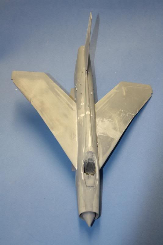

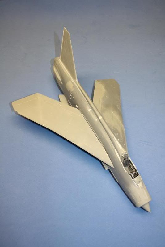

AAbshier Posted November 10, 2009 Share Posted November 10, 2009 Wings have been "clipped" in place Does it look like you'll get a good join on the wings without internal bracing in the fuselage? What about sagging or bending upwards? I'm very happy I put the bulkheads in mine, but if you think the model will be OK without, I want to mention that in my build review. Andy Link to comment Share on other sites More sharing options...
AnonymousAA72 Posted November 10, 2009 Author Share Posted November 10, 2009 Does it look like you'll get a good join on the wings without internal bracing in the fuselage? What about sagging or bending upwards? I'm very happy I put the bulkheads in mine, but if you think the model will be OK without, I want to mention that in my build review.Andy I hope to have the wings on tonight Andy, so I'll let you know. Problem I had was that Trumpeter's wings were far too straight they need some anhedral so a shim of plastic card will be required on the upper wing to provide this. They will need to be fixed and I wished I'd put in an additional bulkhead - but from what I've seen thus far I doubt if there will be that much of a problem! Link to comment Share on other sites More sharing options...

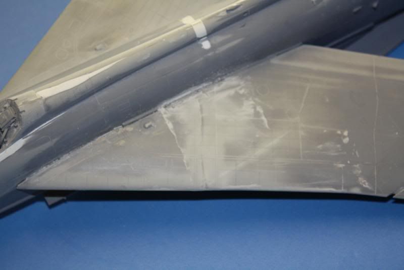

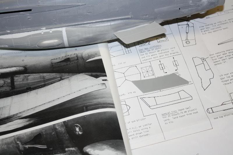

AnonymousAA72 Posted November 24, 2009 Author Share Posted November 24, 2009 (edited) Blimey!!! Not much progress over the last two weeks!!! So here's an update... Serious problems with the wings! Not surprisingly Trumpeter have well and truly screwed this one!!! Apart from the undercarriage bay issues high-lighted previously, they've totally missed the wing shape - on the leading edge - the real wing kinks in two distinct places AND if you stick the wings on as they are they have no anhedral whatsover!! Lightning wings? Not as we knew them!! So yet more surgery.... I managed to bend the starboard wing sufficiently...the inner kink is visible. I've also added a thin plastic card spacer on the wing mounting edge to provide the initial droopy angle... Both wings on - still not 100% right - some more teasing into place required... ..OOPS!! The Port wing was very reluctant to retain its new "bent" shape(?) - eventually the portion being bent - snapped!!! You can see the initial repair job here... The plastic rod sprues I inserted did help. As noted elsewhere on the other builds - Trumpeters plastic is very soft - one of the reasons the wing snapped - its almost rubbery!!! However since these pic's were taken I've filled and sanded the gaps - plenty of MekPak and then Superglue - the joints are as solid as a solid champion in the solid world cup - help in Solid City!! So...next job will be to ensure the surface is good enough for alclad........... Edited November 24, 2009 by Bill Clark Link to comment Share on other sites More sharing options...
AAbshier Posted November 25, 2009 Share Posted November 25, 2009 Now I know one thing I'm thankful for on this upcoming U.S. Thanksgiving holiday: that Stevens Int'l sent me the F1A/F3 to review instead of the F6! Holy crap.....the wings are wrong also? No one could have predicted that Trumpeter would have blown it on this airplane. So...next job will be to ensure the surface is good enough for alclad........... You're going for NMF? What squadron? I just got Alclad on my wings and horizontal stabilizers, so I beat you to it. Of course, I have non-cambered leading edges and I kept my wheel wells at stock length, so I saved myself some time! Andy Link to comment Share on other sites More sharing options...
