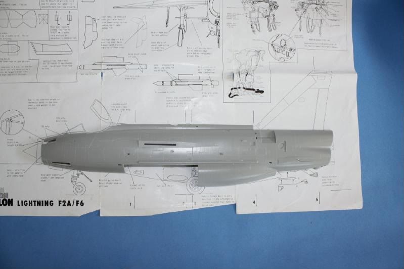

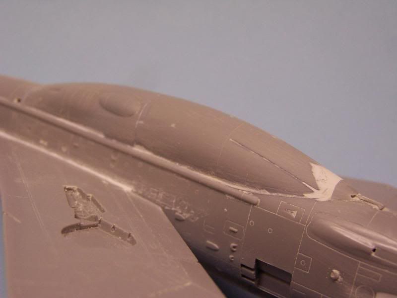

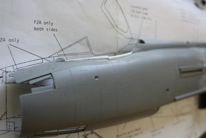

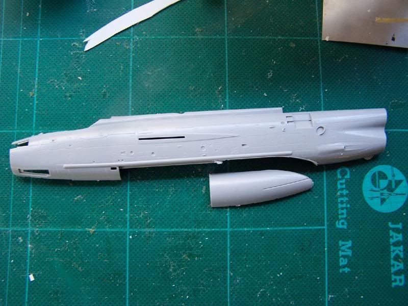

AnonymousAA72 Posted October 1, 2009 Author Share Posted October 1, 2009 (edited) Just a quick update... decided to tackle the cockpit area...the sills are too low as is the fuselage and windscreen mount. The windscreen itself doesn't look too bad, but I will need to remove a wedge on the lower edge - when its time to fit it. One of the problems with the canopy is that it appears to be too bulbous. By removing some clear plastic from the lower frame MAY improve it..along with beefing up the spine behind the canopy.... Anyway..I used plastic card to raise the fuselage slightly And faired it all in with Milliput All a bit "Heath Robinson" at the moment!! This may throw out the internal dimensions - I have a feeling I may need to do something there as well - but thats a bridge I'll cross when I get to it!! Edited October 1, 2009 by Bill Clark Link to comment Share on other sites More sharing options...

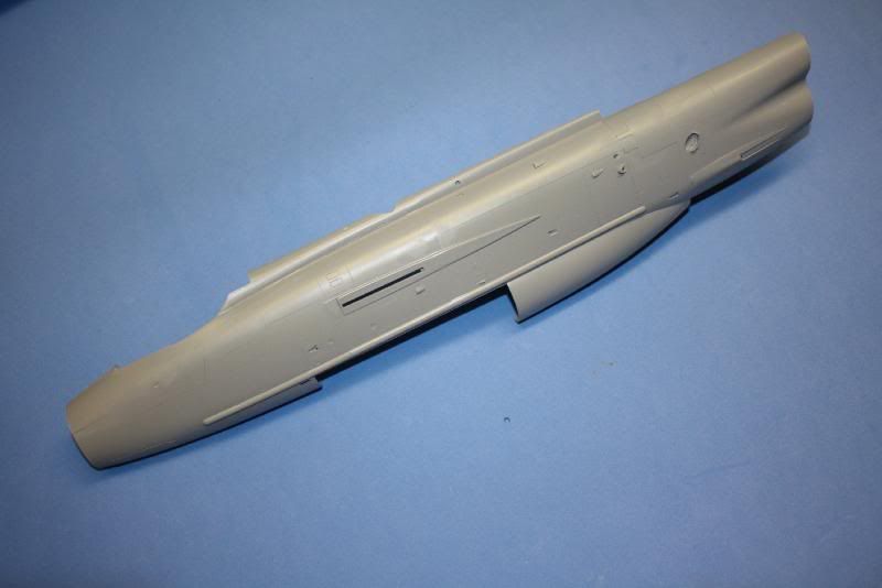

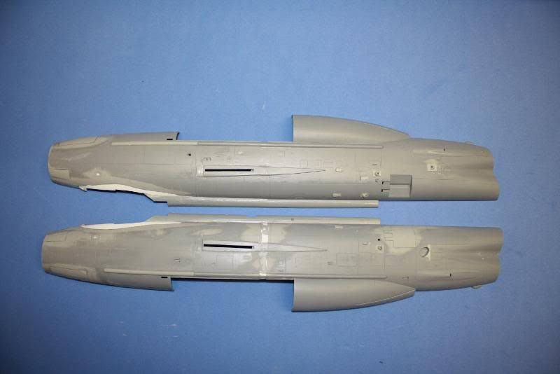

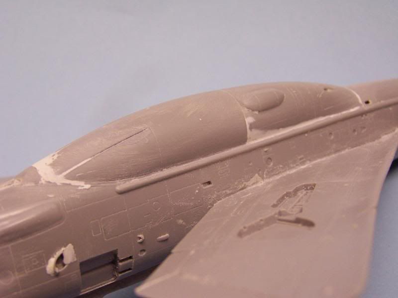

AnonymousAA72 Posted October 3, 2009 Author Share Posted October 3, 2009 Crikey Bill, that's a lot of work, fantastic to view though, keep it up and thanks for sharing.All the best Chris I'm enjoying this - at the moment anyway!!! A bit of an update - started to add some of the bumps and lumps to the fuselage halves - in between sanding and Halford-ing! Here we see the two halves with most of the intakes and vents added - still to add the airbrake. Some of the vents were poorly fitting... Showing the ammendment to the canopy sills Another coat of Halfords.... Link to comment Share on other sites More sharing options...

AnonymousAA72 Posted October 3, 2009 Author Share Posted October 3, 2009 Looking great Bill. I wish i had have found all of this out before i built mine! Well at least i know what to do on my next one. Well, I thought that you were mad completely stripping down your F6!! BUT at least you've managing a great salvage job!!! I will try a 92 Sqn F2 next (have you seen the latest Model Alliance sheet?) just to see how and where the 5mm plug will fit with the small belly tank. I've been looking at the wings today, and in particular the wheel bays. Apart from being the wrong shape, they are too long! Now that with the additional length of the undercarriage has the alarm bells ringing! I'm now worried that the undercarriage location MAY be in the wrong place! If thats the case then they may be too narrow - too close together? I haven't measured anything yet, but I'll check that tomorrow. It also got me looking at the nose gear door is also too long - which MAY also mean that the nose leg's location point its in the wrong place- too far back!!! In comparison with the Echelon drawings it also seems that the panels for the upper nose aden cannon (and blanking plate for the F6) are a bit too low. Thats going to make the Anti-glare panel above it appear too deep and the cannons (IF building the F2A) too far down. All of this will along with the bulbous canopy and intake ring will have a knock-on effect in making the nose area look wrong! I don't think any of this will cause major problems.....(He added with fingers crossed!!!) Link to comment Share on other sites More sharing options...

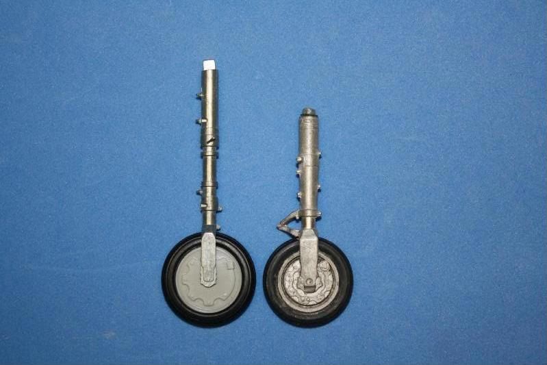

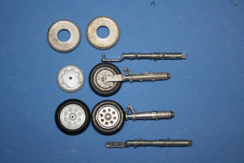

AnonymousAA72 Posted October 12, 2009 Author Share Posted October 12, 2009 (edited) Time for an update - was working on the dreaded 12-8 shift last week, so couldn't come out to play I'm afraid (well not with my Lightning anyway!). Just a few shots here of what we discerning Lightning freaks are up against here!! Trumpeter's undercarriage is PANTS!!!! From L to R: The two white metal Tyres are from Flightpath's set for the Echelon kit. The hubs and brake discs would be made up from laminated photo etch. In the middle are Echelon's legs and wheels and them long gangly things on the right are Trumpeter's "interpretation"!! Not content with ONE insult, they've included both white metal AND plastic legs! Below this are the wheel hubs. The censor's have censored my comments here....... And just in case you missed it above! Trumpeter's wheel and vinyl tyre is shown next to Echelon's Edited October 12, 2009 by Bill Clark Link to comment Share on other sites More sharing options...

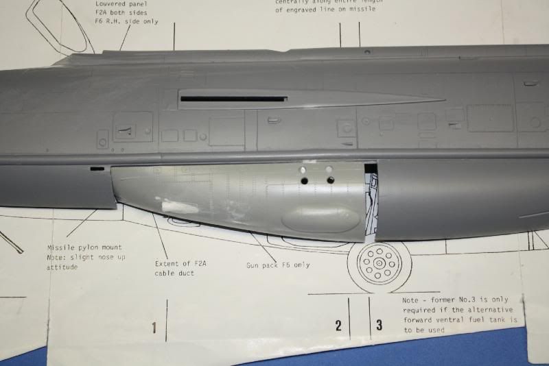

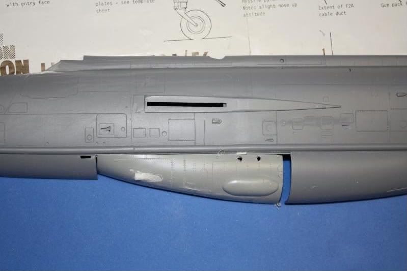

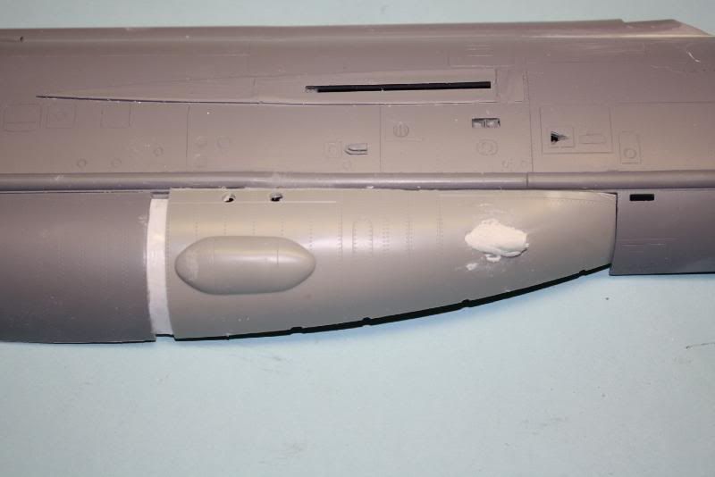

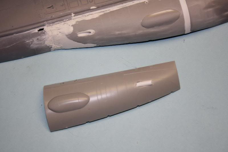

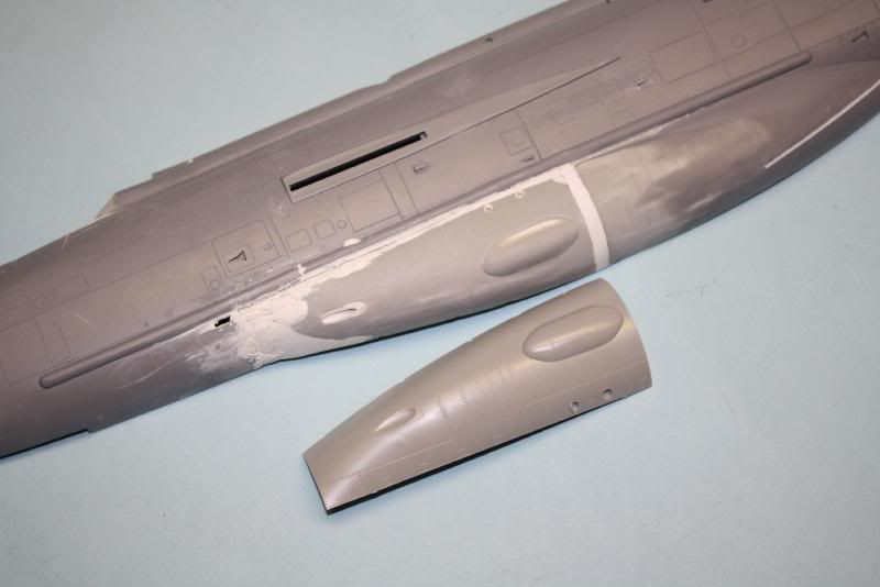

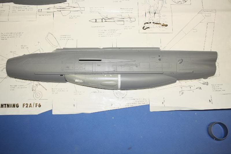

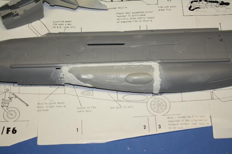

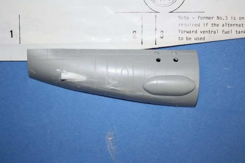

AnonymousAA72 Posted October 12, 2009 Author Share Posted October 12, 2009 A bit of butchery... As you will have gathered by now, Trumpeter's belly tank is all over the place! I decided that I'd add the forward cannon/tank pod a half at a time, rather than adding the section as a whole to the fuselage. I had originally planned on bending the plastic upwards and inwards as I had with the portion of the rear tank. This wasn't practical, so I decided to remove the top 4mm from the section......keep up at the back, it'll all make sense soon....(I hope!) You'll note that I've added a section of plastic tube for the aden port. I'll chop this back later, fill and sand, fill, sand and file. I'll also need to to a fair amount of rescribing AND I need to add the cannon muzzle's over the troughs - muzzle troughs - already! I've drilled put the two outlets below those on the kit which will be lost later - you can see the line where the plastic needs paring back to... I've tentatively added the front section here And here I've started the gap filling process... Tomorrow night I'll be mostly sanding this lot down - then tackling the other side.. Cheers - Bill Link to comment Share on other sites More sharing options...

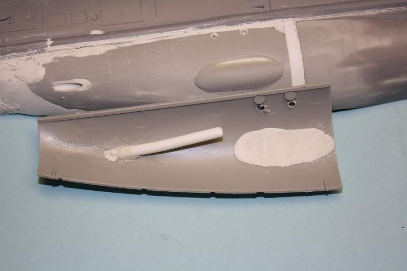

AnonymousAA72 Posted October 12, 2009 Author Share Posted October 12, 2009 Last one for tonight. I've sanded back the tube for the cannon trough, and added some Milliput, the cannon bulge looks too big, so I've filled it from the back with milliput - superglued into place. If necessary I can re-profile the bulges from the front - I'll need to check a load of photo's before I start to tackle that one though Thanks for looking - feel free to add any comments......any suggestions? Cheers! Link to comment Share on other sites More sharing options...

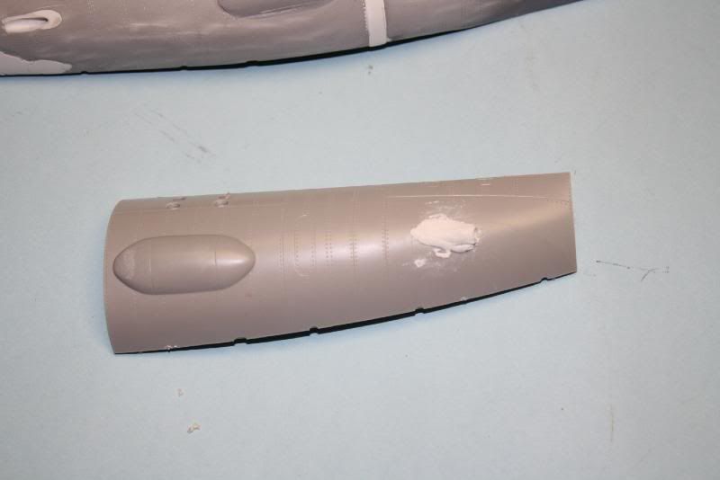

AnonymousAA72 Posted October 13, 2009 Author Share Posted October 13, 2009 A bit more hacking away tonight...The cannon bulge is waaaaay too bulky. I had applied some milliput and superglue to the inside of the bulge, and tonight filed and spraped and sanded it into a more acceptable shape. The other half is next to it for comparison I opened up the cannon port... ...added some plastic tube... ....and then some milliput... Here's the inside showing the cannon "tube!" and the milliput And the section in place - it was a better fit than the other side. Constant checking against the plans helps...still not certain what to do regarding the fin. It certainly is smaller than Echelon's plans, so will need enlarging. That shouldn't be a problem as I'd use a rectangle of plastic card wedged and glued in between the two fin halves and then apply plastic card and filler on the outside. She's getting there, and I'm quite pleased with progress! I am thoroughly enjoying myself as well!! Aim is to get the fuselage together this week - and then on to the wings. I'm still hoping for an all metal finish, I'll be using some Alclad - well quite a lot actually!! The most likely candidate is XR753/"A" of 23 Sqn, with white fin and spine, though I've always liked 5 & 11 Sqn schemes. I could do one of those in all over NM with white spine section.....but this all depends on how good the surface is after I've lost them goddam divots!! AND before anyone argues the toss - they are NOT apparent on NMF, and only hidden by paint on camouflaged aircraft as I read in another WIP elsewhere! Granted some are noticeable - particularly on individual panels but Trumpeter have NOT got it anywhere near right! That said its up to each & every one of you to make your own choice! If rivets/divots float your boat - then let it do so!!! Plan B will be a camouflaged F6 of 5/11 Sqn..... We shall see! Link to comment Share on other sites More sharing options...

AnonymousAA72 Posted October 17, 2009 Author Share Posted October 17, 2009 That Belly Tank!!! A year or so ago I started to build Trumpeter's 1/72nd scale Lightning F6. That has similar problems to the 1/32nd scale kit in its bloated belly tank. On that occassion I removed the WHOLE of the rear portion of the tank - remove a couple of mm and re-glued it on - I'm just wondering now if I should have used that method on my 1/32nd scale Lightning??? Not that my current method hasn't worked okay - well, so far anyway - I still have to glue the fuselage together.....but it may have been an easier option to build the whole tank up as a one-piece unit......just a thought? More than one way to remove the fur from a feline - and all that.... Here are a few pic's of that 1/72nd scale effort (which I still haven't finished BTW!!!) Link to comment Share on other sites More sharing options...
sonofjim Posted October 17, 2009 Share Posted October 17, 2009 totally removed the belly tanik on mine Bill it worked a treat also tackling the gun pack tonight Link to comment Share on other sites More sharing options...
AnonymousAA72 Posted October 17, 2009 Author Share Posted October 17, 2009 totally removed the belly tanik on mine Bill it worked a treat also tackling the gun pack tonight Don't forget the photo's............... Link to comment Share on other sites More sharing options...
