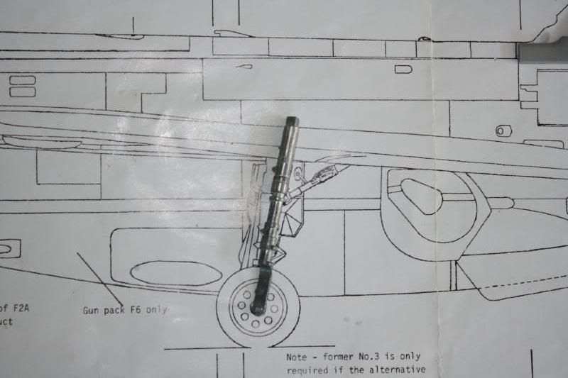

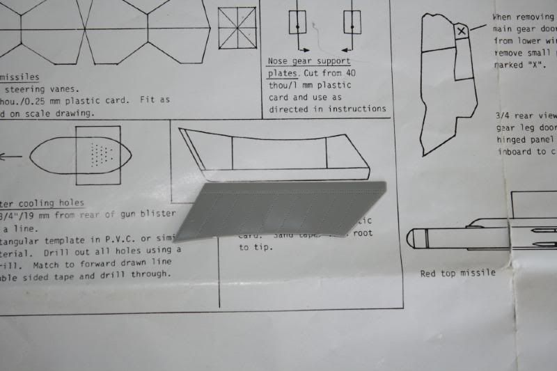

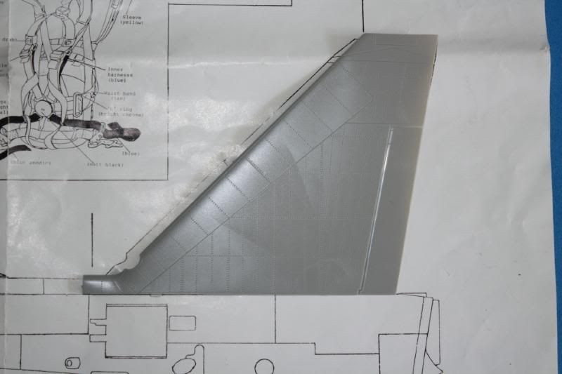

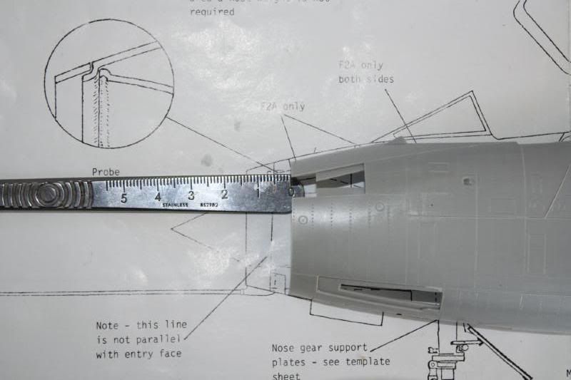

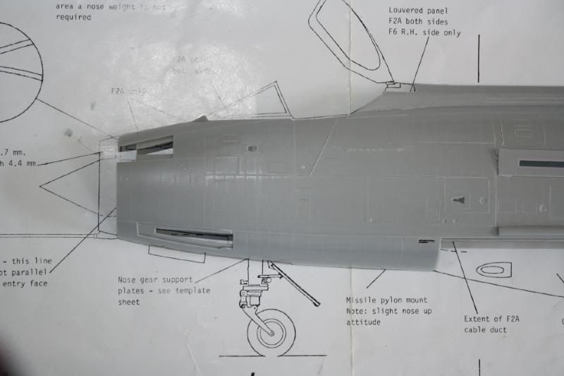

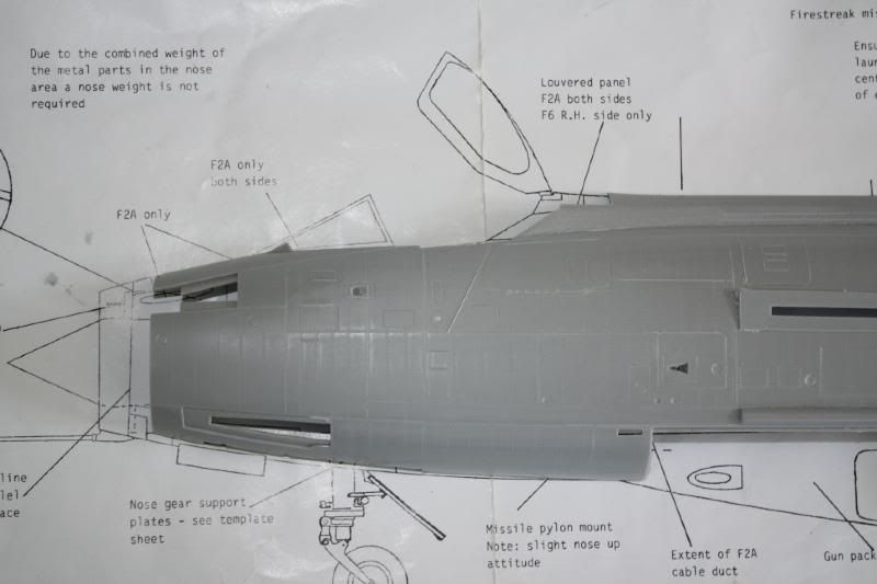

AnonymousAA72 Posted September 25, 2009 Share Posted September 25, 2009 Right, from the off-set.....IF I'm about to suck the pleasure out of your hobby, read no further....... For those that do want to know what I've found, then read on - you can then decide what, if anything, you want to do with this information!!! I never planned on modelling Trumpy's Lightning, I have an Echelon F6 waiting for its slot in the paint shop, and another yet to be started - BUT, thanks to the generosity of someone on here - I had one delivered to me last week. I have been critical of the kit - and shame on me - this was based on photo's of the plastic and the built model. With the kit in hand I could give it a better once over, using whatever books/plans I had. Now, I make no claims that what I've found, from these various sources, or what I'm about to find as I build this model are 100% correct(!), its just my interpretation of that info. I had to hand Echelons instructions and a 1/32nd scale side view of the fuselage. This kit is acknowledged by most, as being incredibly accurate - and it certainly looks like it. The side view matches the plastic in the Echelon kit, so I'm assuming that its correct. Any amendments I make will be based on that initially.... First of all a general shot of the fuselage half against the plan... Immediatelly apparent is that Trumpy's fuselage is TOO SHORT!!! By approx 5mm. This photo was with the rear end lined up... Also noticeable here is the gap at the cockpit sill and windscreen...which goes some way to explaining the rake of the windscreen and the bulbous nature of the canopy maybe? Moving the fuselage half forward then everything lines up quite nicely! AND.. the reason the inatke ring is so deep? To compensate for the short fuselage!! Moving on..... The fin! Its too small!!! I've lined this up against the rear end of the fin, and this shows (a) the fin is too high, (b.) the intake is too large and of course (c.) the fin is too small! Luckily t hough, this discepancy seems to be at the rear end. The rudder is too small - I reckon that this could be corrected by removing the part of the spine at the front (which is too high anyway) and adding a section of plastic card to the rear. Comments have been made about the undercarriage units....they are too long! Here's the white metal leg The kits strakes are poorly shaped and at the wrong angle. The forward edge should be higher up the belly tank. The Firestreaks and Red Tops look really nice!! Thats all the pic's for now. I'll most likely continue this as an "In Progress" build...so if you want to know how I attempted a fix - it'll be there!!! Will I chop the fuselage up and add a 5mm spacer? Most likely!!! Also.....I've not had a chance to see how accurate the wings or tailplanes are, BUT initial thoughts are (and based on my being built Echelon F6) that they seem quite accurate. The wings have no discernible leading edge kinks - a little gentle bending of the wings should solve that! The belly tank is far too big. I'm going to reduce that by bending the plastic inwards and removing a sliver so that it fits the other side okay! The Aden cannon bulge is far too big!!! Not had a chance to assess the cockpit or seat yet!!! Link to comment Share on other sites More sharing options...

andym Posted September 25, 2009 Share Posted September 25, 2009 Excellent stuff! Do you reckon that the 5mm spacer should be added to the fuselage in line with the edge of the cutout for the belly tank? Also I'll be interested how you plan to deal with the "holes" that festoon this kit. Regards, Andy Link to comment Share on other sites More sharing options...
gunpowder17 Posted September 25, 2009 Share Posted September 25, 2009 Fantastic Bill. The fuselage being 5mm short explains alot. Its a shame as when built theres something that just doesnt look right. Ive tried but mine will probably sit around unfinished for quite a while. You really cant beat the Echelon one! Link to comment Share on other sites More sharing options...
avro683 Posted September 25, 2009 Share Posted September 25, 2009 I presume that these shortcomings apply to the F1a as well. If that's the case fair enough but I will build mine OOB apart from possibly the seat and keep the results to myself. Tony Link to comment Share on other sites More sharing options...
AnonymousAA72 Posted September 25, 2009 Author Share Posted September 25, 2009 Excellent stuff! Do you reckon that the 5mm spacer should be added to the fuselage in line with the edge of the cutout for the belly tank?Also I'll be interested how you plan to deal with the "holes" that festoon this kit. Regards, Andy Hi Andy, The spacer will be in front of the belly tank cutout - in between some panel lines so its relatively simple to hide the plug (thats the current pan anyway!) I can then add the cannon pack forward and add an additional spacer at the join. As for the holes - plan is to scribe and deepen the panel lines I want to keep and give it repetitive coats of Halford primer - sanding down inbetween! Link to comment Share on other sites More sharing options...
AnonymousAA72 Posted September 25, 2009 Author Share Posted September 25, 2009 Fantastic Bill. The fuselage being 5mm short explains alot. Its a shame as when built theres something that just doesnt look right. Ive tried but mine will probably sit around unfinished for quite a while.You really cant beat the Echelon one! An additional problem is the lack of depth to the canopy sill. This makes the canopy look to bulbous, additionally the spine is too straight -its too high at the fin end and too low at the canopy end. I'm going to raise the level of the canopy sill and windscreen, and see what effect that has. In all honesty you can probably ignore the 5mm - but raising the sill and altering the spine and fin will help. Another thing I've noticed - the antennae pack in the spine is a bit too far aft.... I presume that these shortcomings apply to the F1a as well. If that's the case fair enough but I will build mine OOB apart from possibly the seat and keep the results to myself.Tony I don't know Tony, though I think I'll get myself one day soon....... Link to comment Share on other sites More sharing options...
