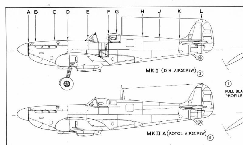

Nick Millman Posted September 17, 2009 Share Posted September 17, 2009 (edited) The plans are those drawn by Alfred Granger, MISTC, and are taken from Aerodata International No.2 'Supermarine Spitfire I & II' published by Vintage Aviation Publications in 1977. The Aerodata series of books were much imitated but IMHO never equalled for packing so much useful modelling data into such a slim booklet. IIRC the old Hasegawa 1/72nd Spitfire I also suffers from a short nose? Edited September 17, 2009 by Nick Millman Link to comment Share on other sites More sharing options...

Byron Boyd Posted September 23, 2009 Share Posted September 23, 2009 The plans are those drawn by Alfred Granger, MISTC, and are taken from Aerodata International No.2 'Supermarine Spitfire I & II' published by Vintage Aviation Publications in 1977.The Aerodata series of books were much imitated but IMHO never equalled for packing so much useful modelling data into such a slim booklet. IIRC the old Hasegawa 1/72nd Spitfire I also suffers from a short nose? You know, I have Aerodata International No.2. I had actually pulled mine out a day or so before this post to look at the AA (Absolutely Awful - according to some) Tamiya Spitfire in 1/72, and I have to tell you, what I saw did not look like the picture on the website. Lengthwise, my Tamiya Spitfire Mk I was absolutely spot-on with the plan, and not short at a bit. Now, I will admit that I have the version bundled together with the Bf-109, Hawker Hurricane, P-51, P-47, FW-190, etc..., published by Squadron in the early '80s. I'm wondering if Squadron reduced the size ever so minutely, and if so, whether the folks at Tamiya and Hasegawa might have used that version in their the production of their kits. It would still represent incomplete staff work, but it could be a viable explanation of why we keep getting short nosed Spitfires... Also, I should point out that if you pulled the test shot Mk I off of the plan of the Mk II (with Rotel propeller), you will note that the propeller backing plate on the Mk II is easily 2 - 3 times longer that the similar item on the Mk I drawing. As the test shot comes up the edge of the spinner front, this would imply that perhaps the new item is a bit too long in the nose, although this is admittedly a whole lot easer to fix that the short nose problem... Byron Link to comment Share on other sites More sharing options...

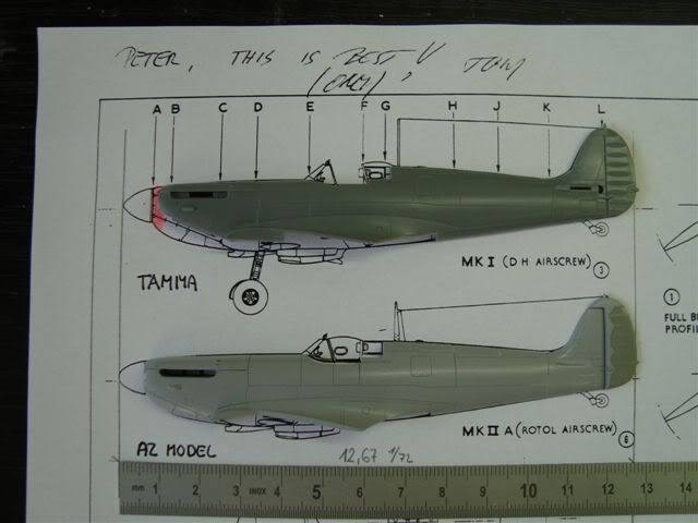

AnonymousA667 Posted September 23, 2009 Share Posted September 23, 2009 I'm wondering if Squadron reduced the size ever so minutely, and if so, whether the folks at Tamiya and Hasegawa might have used that version in their the production of their kits. It would still represent incomplete staff work, but it could be a viable explanation of why we keep getting short nosed Spitfires... The drawings in my copy are quite close to 1/72 scale, very slightly under-size. The scale span works out at 11160mm whereas the book itself quotes 11227mm, so there is a scale difference of 67mm (about 2.75" in old money). peebeep Link to comment Share on other sites More sharing options...

Nick Millman Posted September 23, 2009 Share Posted September 23, 2009 (edited) "You know, I have Aerodata International No.2. I had actually pulled mine out a day or so before this post to look at the AA (Absolutely Awful - according to some) Tamiya Spitfire in 1/72, and I have to tell you, what I saw did not look like the picture on the website. Lengthwise, my Tamiya Spitfire Mk I was absolutely spot-on with the plan, and not short at a bit." You know, I have Aerodata International No.2. And I have to tell you, what I see looks exactly like the picture on the website. Nevertheless here is a direct comparison of the website image with a scan from the book to demonstrate that I am not deluded, deliberately lying or have crap powers of observation. The two additional vertical lines appear to have been added to facilitate the ruler measurement but other than that there are plenty of points of identical correlation in appearance, layout and typography to lead me to conclude the plans are one and the same and/or that the plans used by AZ are identical copies. I won't list them all as I think they may just be obvious. What d'ya think? Edited September 23, 2009 by Nick Millman Link to comment Share on other sites More sharing options...
AnonymousA667 Posted September 23, 2009 Share Posted September 23, 2009 What d'ya think? Never did like the Tamiya kit. The fuselage above the centre section and around the cockpit just doesn't look right and according to these drawings (which scale out correctly for length) is demonstrably short. This new AZ kit looks very promising. peebeep Link to comment Share on other sites More sharing options...
Byron Boyd Posted September 24, 2009 Share Posted September 24, 2009 (edited) You know, I have Aerodata In"ternational No.2. I had actually pulled mine out a day or so before this post to look at the AA (Absolutely Awful - according to some) Tamiya Spitfire in 1/72, and I have to tell you, what I saw did not look like the picture on the website. Lengthwise, my Tamiya Spitfire Mk I was absolutely spot-on with the plan, and not short at a bit."You know, I have Aerodata International No.2. And I have to tell you, what I see looks exactly like the picture on the website. Nevertheless here is a direct comparison of the website image with a scan from the book to demonstrate that I am not deluded, deliberately lying or have crap powers of observation. The two additional vertical lines appear to have been added to facilitate the ruler measurement but other than that there are plenty of points of identical correlation in appearance, layout and typography to lead me to conclude the plans are one and the same and/or that the plans used by AZ are identical copies. I won't list them all as I think they may just be obvious. What d'ya think? Nick, I think that your highly selective quotation of my comments allows you to 'rise up in righteous anger', as it were. Had you quoted my second paragraph, which stated that my version of Aerodata International, Vol 2 was bound as part of a six-volume set published by Squadron/Signal in 1980, and speculated that mine could very well be just marginally shrunken, you would had to have been a bit more civil with your reply. I think that you should seriously consider relocating to the States - you could have an absolutely brilliant career as a journalist at any of our mainstream outlets, since intellectual honesty seems to have been largely dropped from the required journalistic skill sets here. Honestly, I don't know you at all, and I am too unfamiliar with AZ Models to be willing to accuse either you or them of being "deluded, deliberately lying or have crap powers of observation." In fact, I did not level any of those accusations against either of you. I believe that the only thing I said was that mine must be a bit smaller than the ones AZ used. I've no idea at all whether my copy is typical of the production run, or a 'one off' bad copy. I thought that your proof that the plans AZ is using are the Aerodata International plans was somewhat spurious. I had already recognized the plans in the AZ photo as being the Aerodata plans ("You know, I have Aerodata International No.2. I had actually pulled mine out a day or so before this post[/i] to look at the AA (Absolutely Awful - according to some) Tamiya Spitfire in 1/72...") My third comment was yet another subtle hint that I was already aware that the plans in the AZ photo were the Aerodata International plans. No further proof was required. So, did you have a point, or were you simply manipulating my comments to justify your not-so-subtle hint that I might the one who's either deluded, deliberately lying, or have excremental powers of observation? That's what I think. Warmest regards, Byron Edited September 24, 2009 by Byron Boyd Link to comment Share on other sites More sharing options...

Nick Millman Posted September 24, 2009 Share Posted September 24, 2009 Byron It is quite possible that the plans on the website are a scan or photocopy of the original and that therefore the Tamiya Spitfire may appear differently against those plans, my plans or your plans, those three perhaps not being identical for various reasons. My response was predicated on an interpretation of your first paragraph as suggesting the source of the plans were not Aerodata No.2 which is why I quoted it. Your subsequent post makes it clearer you were only referring to the appearance of the Tamiya fuselage against the plans (I think) and I thank you for it. I was certainly not suggesting that you were "deluded, deliberately lying or have crap powers of observation" but was referring only to myself in the context of how I had interpreted your first paragraph as being in doubt about the origin of the plans. I am glad you agree that the plans did indeed originate from Aerodata No.2. I have not checked the Tamiya fuselage against the Aerodata No.2 plans but will now do so out of curiosity to see if there is the same difference suggested by the AZ image. Equally warm regards Nick Link to comment Share on other sites More sharing options...
Bazza Posted September 24, 2009 Share Posted September 24, 2009 (edited) Never did like the Tamiya kit. The fuselage above the centre section and around the cockpit just doesn't look right and according to these drawings (which scale out correctly for length) is demonstrably short. This new AZ kit looks very promising.peebeep Hi,Mate !! You're not the only one hankering,for those AZ Spits !! (or having a copy,of "Spitfire Porn".... ) I really hope they are worth my hard-earned moolah !! Cheers,Bazza. BTW i thought Dougie Bader's Spit was a mark Va,as opposed to Mk IIa ??.... Or did he have more than ONE A/C ?? Only one thing for it........ "EDGAAARRR !!??" Edited September 26, 2009 by Bazza Link to comment Share on other sites More sharing options...
Byron Boyd Posted September 24, 2009 Share Posted September 24, 2009 Nick, Ah, yes. English, our "common" language. I apologize for any confusion my first set of comments might have caused you. Yes, you have now correctly interpreted the nature and thrust of my comments, ie, my Tamiya Spitfire fuselage atop my copy of the plans vs. AZ's Tamiya Spitfire fuselage (which I consider a common reference factor) atop their copy of the same set of plans. Although prior to this string I had assumed that my set of plans were accurate, one look at the AZ photo told me that something was not right. Because my set of plans are not the original, standalone copies from the original publisher, my initial assumption has to be that my set of plans are in error, not AZ's. However, the last week has been way too hectic to allow me time to actually sit down with the micrometers to verify this. My second comment was intended to be a more light-hearted way of pointing this out. Again, my apologies for any miscommunication on my part. I stand by my third comment, though. Assuming that AZ possesses the 100% accurate set of plans, if you take the AZ test shot fuselage off of the Mk II profile, and put it over the Mk I profile (a true apples to apples comparison), it's going to be a tad long, pure and simple. Still a very pretty offering, and it won't stop me from buying one or two... Cheers! Byron Link to comment Share on other sites More sharing options...
