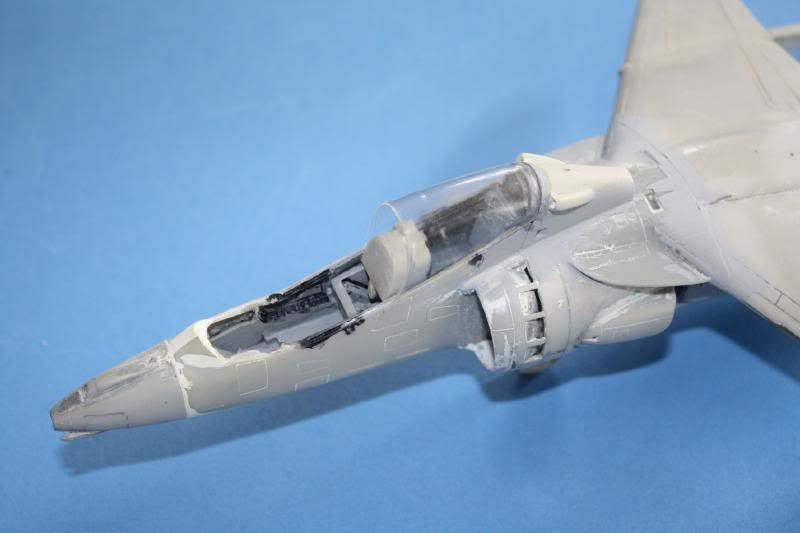

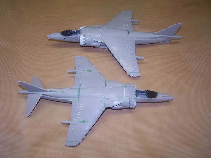

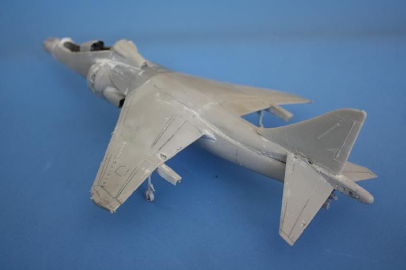

AnonymousAA72 Posted September 7, 2009 Share Posted September 7, 2009 Back in September 2006 I took this photo..... It shows two Hase Harrier GR7's being built. Only one of these actually managed to get finished. The upper one with 65% LERX's The lower GR7 ws due to be painted in 1 Sqn's Arctic colour scheme - and I had slapped paint on it - but it wasn't one of my better paint jobs! So, a month or so ago I decided to strip the paint off - with a view of re-painting her. Whilst doing so, Mrs Clark asked me why I was spending all that time stripping paint off when I had other Harriers in the stash! I did start to explain that I'd added 100% LERX's and then decided better of it! I did though tend to agree and then took the decision to convert her into a T10, using the Alitaliene conversion..I have saved the 100% LERX's - I'll start my GR7 (or GR9) after I've finished this one! So here we are three years on ....... Link to comment Share on other sites More sharing options...

NG899 Posted September 7, 2009 Share Posted September 7, 2009 Hiya Bill, Looking good so far! Any chance of her being ready for the SIG display at SMW this year, or do you have other plans for her at the show? I hope the CD of 20 Sqn pic will be of use... Cheers, Nick Link to comment Share on other sites More sharing options...

AnonymousAA72 Posted September 7, 2009 Author Share Posted September 7, 2009 (edited) Hiya Bill,Looking good so far! Any chance of her being ready for the SIG display at SMW this year, or do you have other plans for her at the show? I hope the CD of 20 Sqn pic will be of use... Cheers, Nick Hi Nick, I'll try my best! Big problem is that I am due to be working on both the Saturday and Sunday of SWM, so it looks highly unlikely that I'll get up there - unless I can swap shifts with someone! If I can't make it, I'm sure I'll find someone to ferry them up!! I've yet to reply your e-mail regarding SWM, but I'll do so over the next day or so....I have a few 1/72nd scale models gathering dust in the loft!!! The CD is very uselful! I also have Mark Atrill's book - so I have no excuse for not getting it right!! I had thought about doing my T10 as BAe's ZH653 in the all over Medium (Lichen) Green, though looking at pic's on Airliners.Net the colour looks a lot greyer than I remember Lichen Green being.. any thoughts? Edited September 7, 2009 by Bill Clark Link to comment Share on other sites More sharing options...

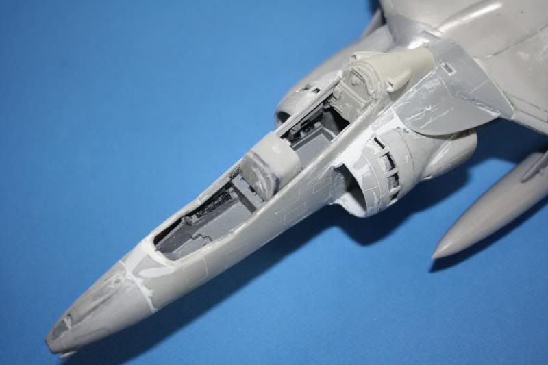

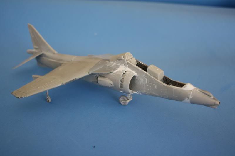

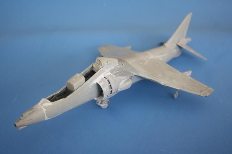

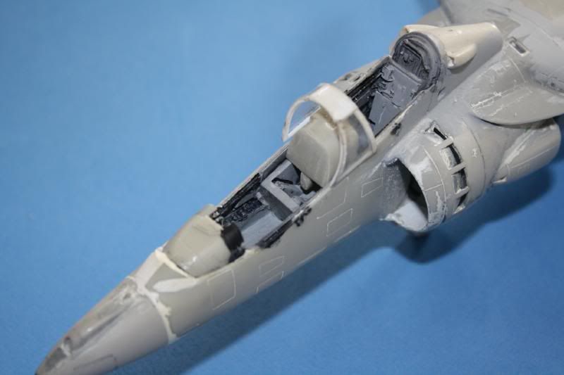

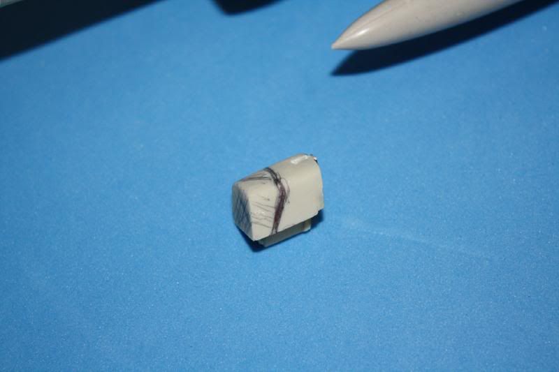

AnonymousAA72 Posted September 9, 2009 Author Share Posted September 9, 2009 (edited) Right, If its okay with Shaun, I'd like to post some pic's of MY T10 on MY thread!!! (Only kidding Shaun, you post 'em on here if you like.........) Right, we identified earlier that the central consul was too big and the wrong shape... Here it is with my estimation of the resin that would need to be shifted ...and here in place on the cockpit shelf I've removed a big wedge here The canopy sections have been separated - here I;m trying th e rear hood for fit/size ..and here's the all important centre section. I've added plastic strip reinforcement and I'll do this to the canopies as well. Its only placed on the shelf at the moment - no glue involved yet as I have to add some internal details first. I'll hide that gap where the consul was meant to go later Theres a big piece of material on the real thing pegged to the blast screen bulkhead - no doubt covering wires and stuff!!! The internal blast screen can be made from clear plastic card and joined to the front of the central glazing section.... ..thats the plan so far anyway!!! Edited September 9, 2009 by Bill Clark Link to comment Share on other sites More sharing options...
Shaun Posted September 9, 2009 Share Posted September 9, 2009 (edited) Great work on the IP panel. I'm going to watch how you tackle the canopy area and will hopefully pick up some good tips Shaun. Edited September 9, 2009 by Shaun Link to comment Share on other sites More sharing options...
Talon Posted September 9, 2009 Share Posted September 9, 2009 (edited) Bill, You may not be aware, but the forward windscreen is different from the single seater and needs modifying. I am nearing completion of my TAV-8B build and when you think about it's really quite obvious, as the single seater slides backwards, so the trailing edge of the windscreen is a right angle. The side opening canopy on the two seater would not open if this were the same, so the forward end of the canopy becomes the right angle.. Have a look at this I made for comparison and look at the angles at the rear of the windscreen (two seater on the left and single on the right and both images taken square to the fuselage). I modified mine by measuring up the windscreen scale distance using the image and then removing a wedge from the rear. The Alitaliane canopy is too long anyway (as is their cockpit opening), so you should have extra canopy to play with. I ended up shoehorning a pair of Aires cockpits into mine for some very nice detail, however, there are no canopy opening hydraulic pistons which need to be scratchbuilt (they are quite prominent). Nick, Will send you a PM as I have one of the Alitaliane T.10 sets for disposal. Craig. Edited September 9, 2009 by Talon Link to comment Share on other sites More sharing options...

AnonymousAA72 Posted September 9, 2009 Author Share Posted September 9, 2009 Bill,You may not be aware, but the forward windscreen is different from the single seater and needs modifying. I am nearing completion of my TAV-8B build and when you think about it's really quite obvious, as the single seater slides backwards, so the trailing edge of the windscreen is a right angle. The side opening canopy on the two seater would not open if this were the same, so the forward end of the canopy becomes the right angle.. Have a look at this I made for comparison and look at the angles at the rear of the windscreen (two seater on the left and single on the right and both images taken square to the fuselage). I modified mine by measuring up the windscreen scale distance using the image and then removing a wedge from the rear. The Alitaliane canopy is too long anyway (as is their cockpit opening), so you should have extra canopy to play with. I ended up shoehorning a pair of Aires cockpits into mine for some very nice detail, however, there are no canopy opening hydraulic pistons which need to be scratchbuilt (they are quite prominent). Nick, Will send you a PM as I have one of the Alitaliane T.10 sets for disposal. Craig. Hiya Craig, long time no parlez!!! Thanks for that - I hadn't really noticed the different wind-screens...I will use the vac-formed canopy as supplied cut back. I'll probably crash mould a new forward hood. Cheers Link to comment Share on other sites More sharing options...
AnonymousAA72 Posted September 9, 2009 Author Share Posted September 9, 2009 Great work on the IP panel.I'm going to watch how you tackle the canopy area and will hopefully pick up some good tips Shaun. Thanks Shaun, take a look at Talon's/Craig's post - some interesting stuff on the canopy. Can you re-post your pic's please? If not on here, then on a new post maybe? Cheers Bill Link to comment Share on other sites More sharing options...
