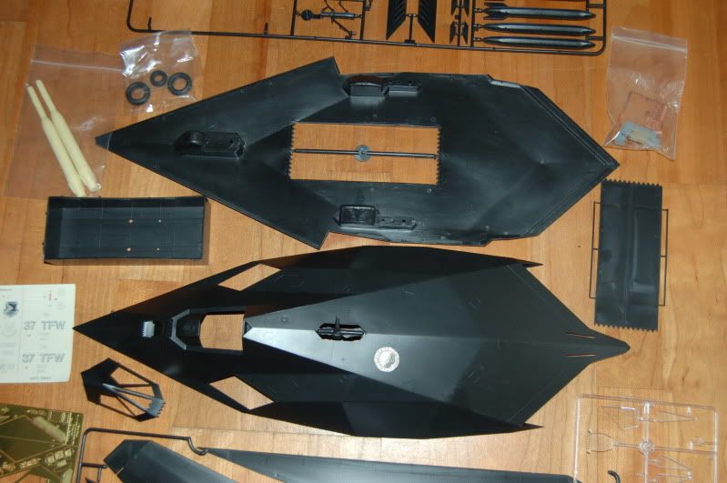

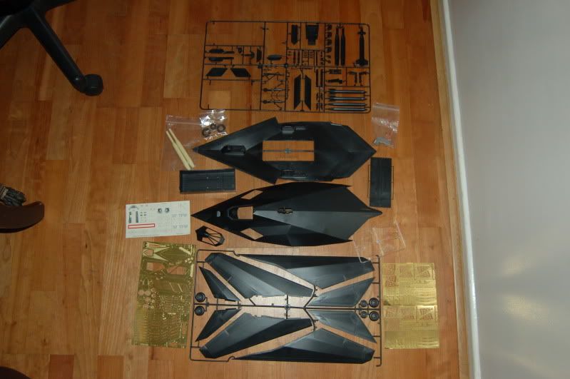

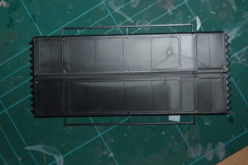

Phartycr0c Posted August 31, 2009 Posted August 31, 2009 So folks.. following completion of my buds F16, Im making a start on Revells 1/32 F117 Nighthawk of the 37th TFS as utilised on the opening night of Gulf war 1. The kit itself is probably More than basic and its faults and forboils have been more than pointed out on many occasions. There are shape issues together with detail issues. This beastie will be built with the addition of the Flightpath detail set which im hoping will enhance the overall kit although im aware that it will not totally correct her. (see im growing fond of it already) I'm building this because the 117 has now retired and I thought it would be summat different. At least its NOT an Airfix F3! This is whats in the box. Not including (obviously) the Fp kit..... Look at all that brass! 20p piece to indicate the size of the problem! First thing for me to tackle is the incorrect opening of the bomb bay doors. The kit has em opening from centre out wheras in reality they open from the outside towards the centre. In addition, as its such a large bay, i will be detailing it up somewhat. The doors themselves Wish me luck!

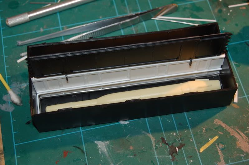

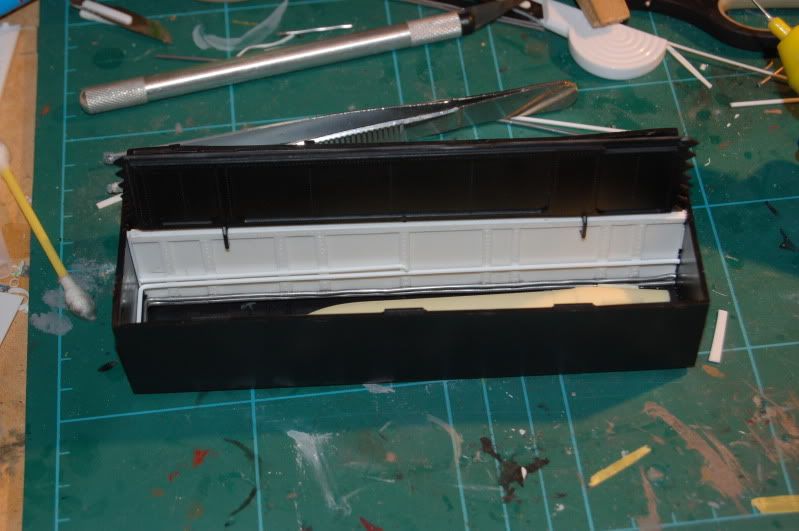

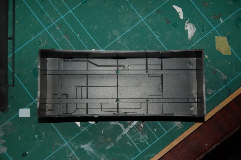

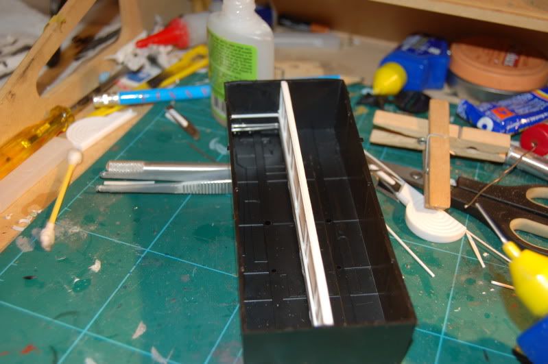

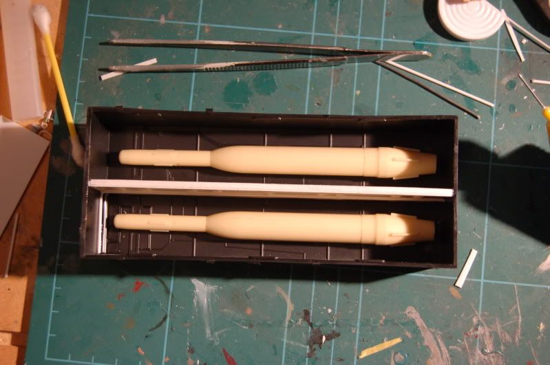

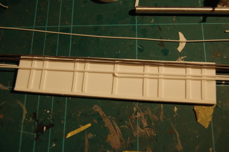

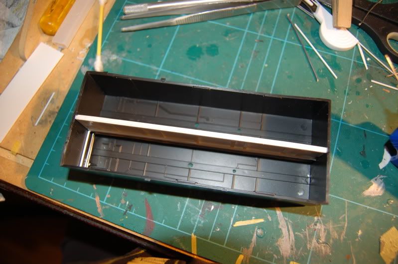

Phartycr0c Posted September 1, 2009 Author Posted September 1, 2009 I've got the Cutting Edge "Stars n Stripes" decals for this kit and an Aires resin Bang seat that are up for grabs. Just off loaded the kit on evilbay along with the flightpath set. M8, ill definitely take the decals but I already have a resin seat for this Pm inbound. Ok a little work done around the bomb bay which as i said is completely devoid of detail. Not only that but the doors are depicted as opening from the centre out when this is wrong. In order to chuck in a little detail, and in the absence of some completely clear bomb bay detail photos, I have cobbled together a central bulkhead and a little piping which will be used to mount the doors. Now as a result of adding the bulkhead I have obviously reduced the space available, therefore I couldn't resist a little test measure of these superb resin GBU's notwithstanding, when finished will be hanging off the extended trapeze pylons. and now a quick mock up of the door setup....... I will be adding some further hinge and hydraulic actuator detail later. Iv'e also got a couple of brass vents left over from another build which will be going into the bays if they can fit after the trapeze pylons are done. Anyhow that's all for now some more tomorrow hopefully.

Phartycr0c Posted September 2, 2009 Author Posted September 2, 2009 That's great guys Ta very much. The flightpath trapeze pylons will cover a multitude of sins so im pretty much guessing at what's in there so having a couple of references to get it something like would be most useful.

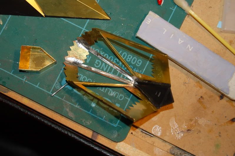

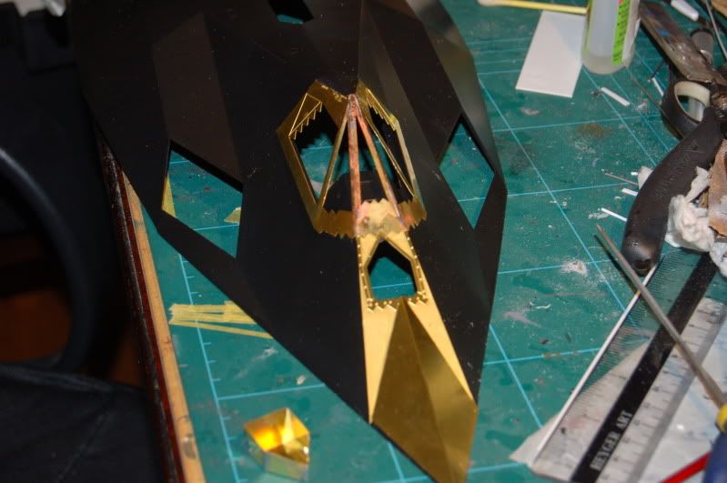

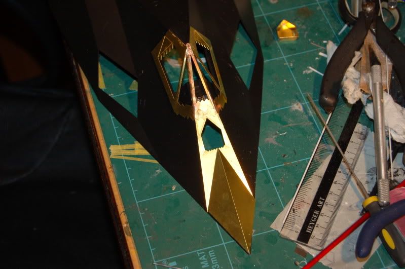

Phartycr0c Posted September 2, 2009 Author Posted September 2, 2009 Here is a small update. Ive started the job of "working the brass". Its obvious that my experiences with the Flightpath Tornado kit has paid dividends. I was absolutely dreading construction of the three piece canopy but i got the iron and flux out and had a go.. Superglue was in reserve. Well I nailed the joints almost first time. At that point I went into shock and partook of a scotch. Following that revelation I had a go at the Flir box and cut away the front of the old oversize flir. Already the Flightpath kit has made a massive difference to the shape of the front end. Next is the nightmare of the completely mis shapen intakes. Major surgery here we come!
