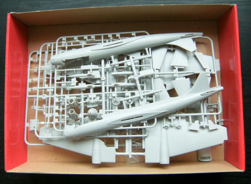

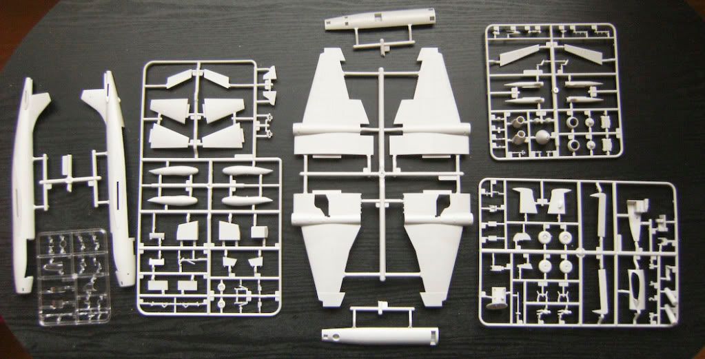

Sprues

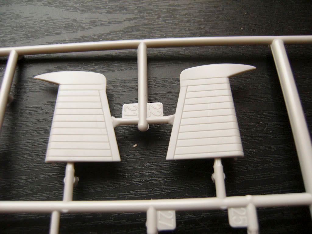

Oh dear still the rubbish rudder that's on the 1:48

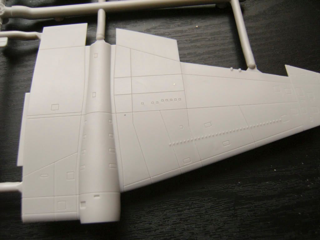

Close up of the wing
Fuselage front, rather deep and broad panel lines. I have also heard that some panels are wrong?

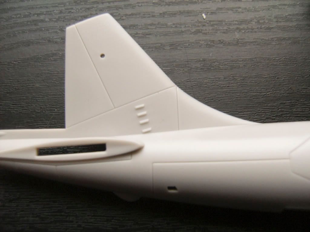

Tail, Airfix still haven't got this right, the root flare is too long, in scale its nearly 600mm too long. However there does seem to be some 'meat' in the base of the leading edge to work with so maybe it can be sanded back?
I'm glad to see that the tail leading edge 'bullet' is separate allowing for correctness if you want to build an early version. In the same light Airfix have included both the old and new tail cones.
So far I'm impressed, with a little extra work I think this will build up to a reasonable model

Thanks very much for posting these pics of your kit and best of luck with the build. I'm grateful for the large pics as yours are the first to show whether the wings have the vortex generators or not; they clearly do..... You've also identified many of the good features of the kit, such as the tail bullet fairing. Nice. Now, when do they make it down here?

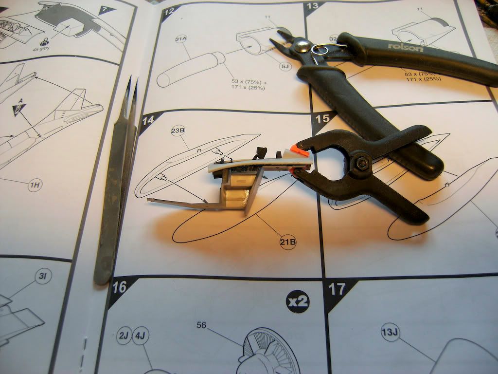

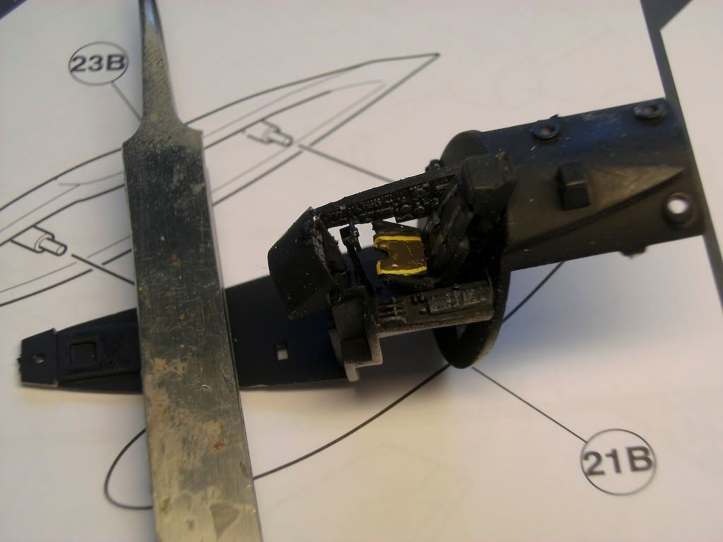

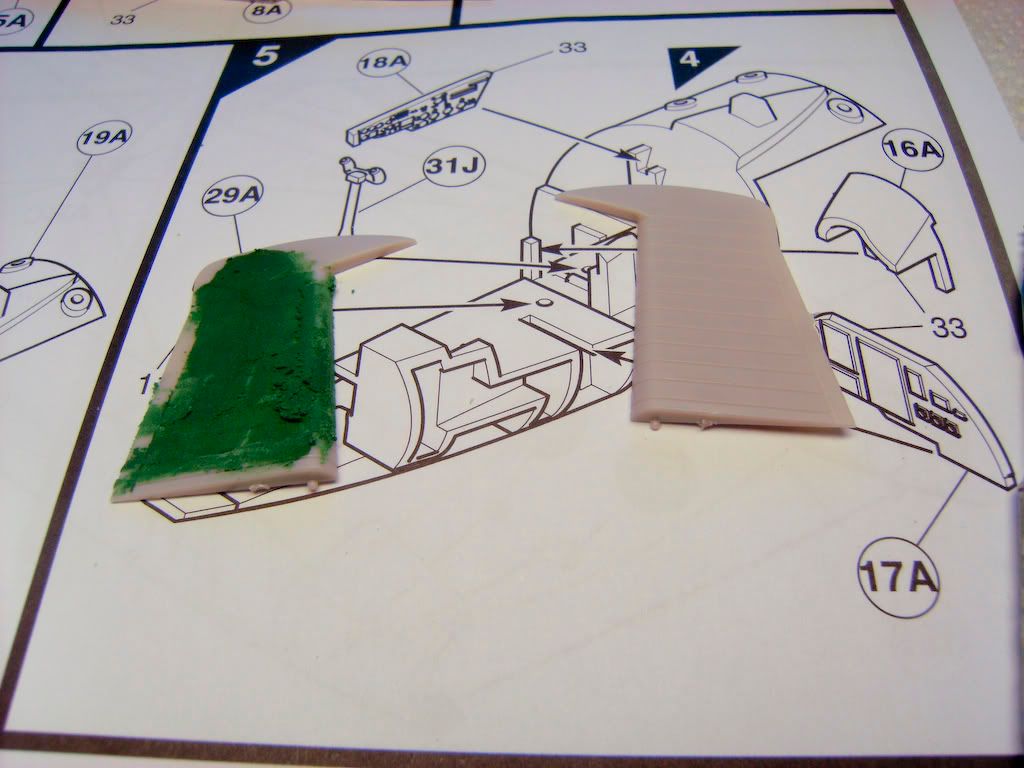

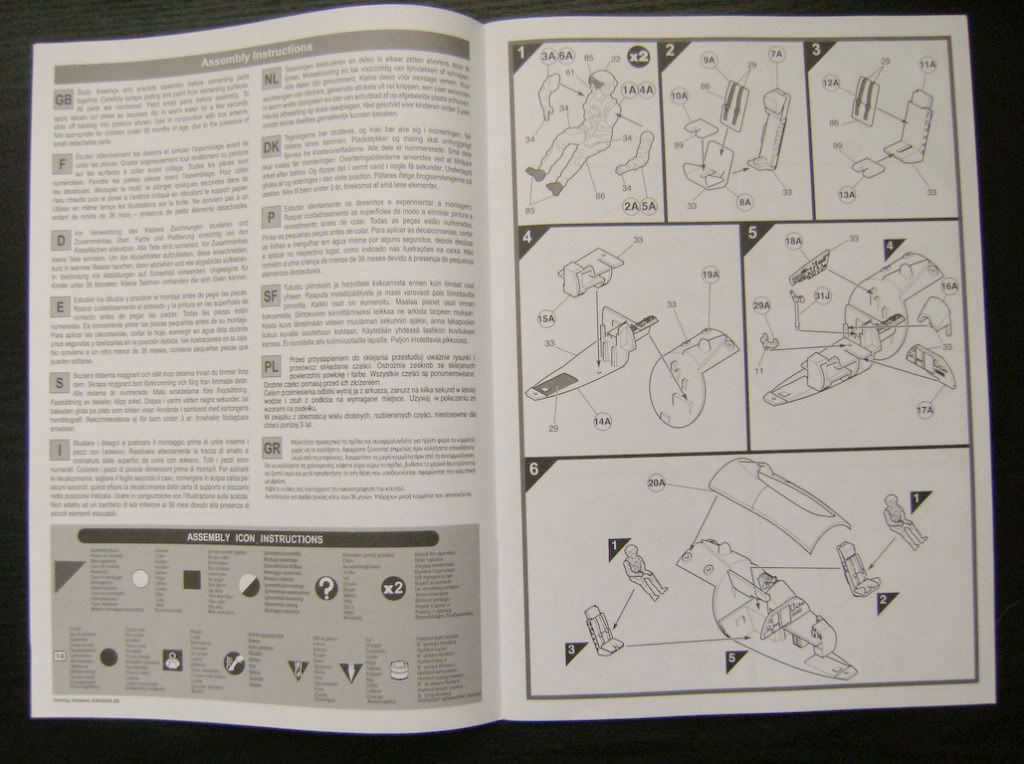

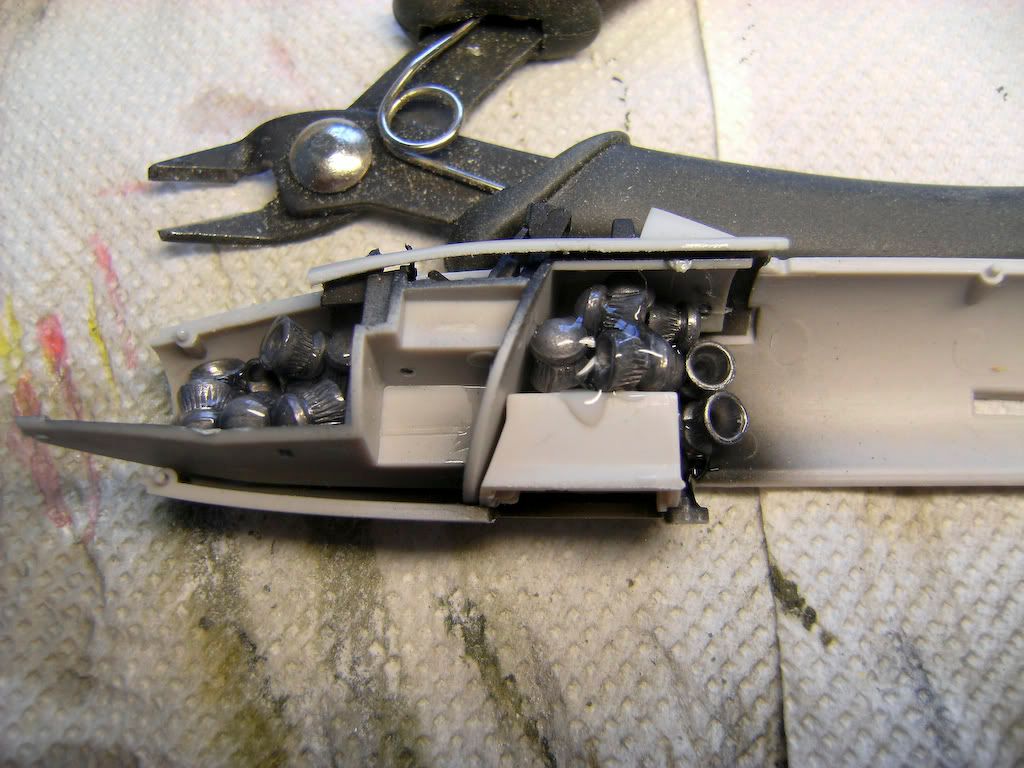

Starting on the cockpit, part 15A can be left out as it's not needed on a PR9 and you can use the space for extra nose weight. The only think this part does on this kit is mount the rudder pedals. So unless you have a dying need to do so leave it out Also leave ou the second seat again it's not needed as Airfix will have you mount it in the wrong place anyway. Basicly it's airfix being cheap and supplying a B(I)8 cockpit!
Also in stage 9 of the instructions Airfix will have you drill out three holes in part 1H the port fuselage halve. These are for the 'towel rail' antenna. If you drill them they come out in the wrong place!
Anyway on with the pics
Cockpit done
You can see below by leaving out part 15A you have a load more space for extra nose weight.

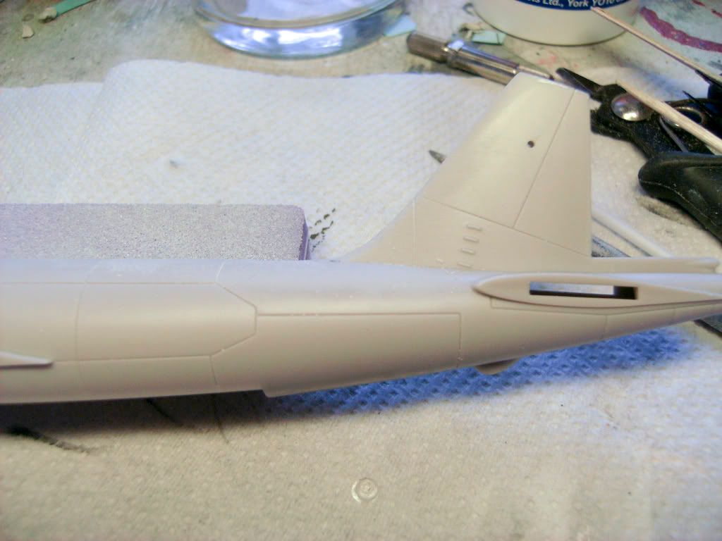

This afternoons update.
Cockpit in and nose weight added

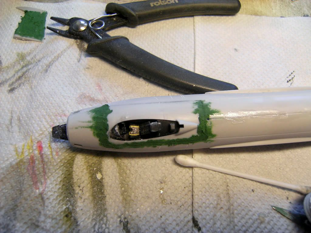

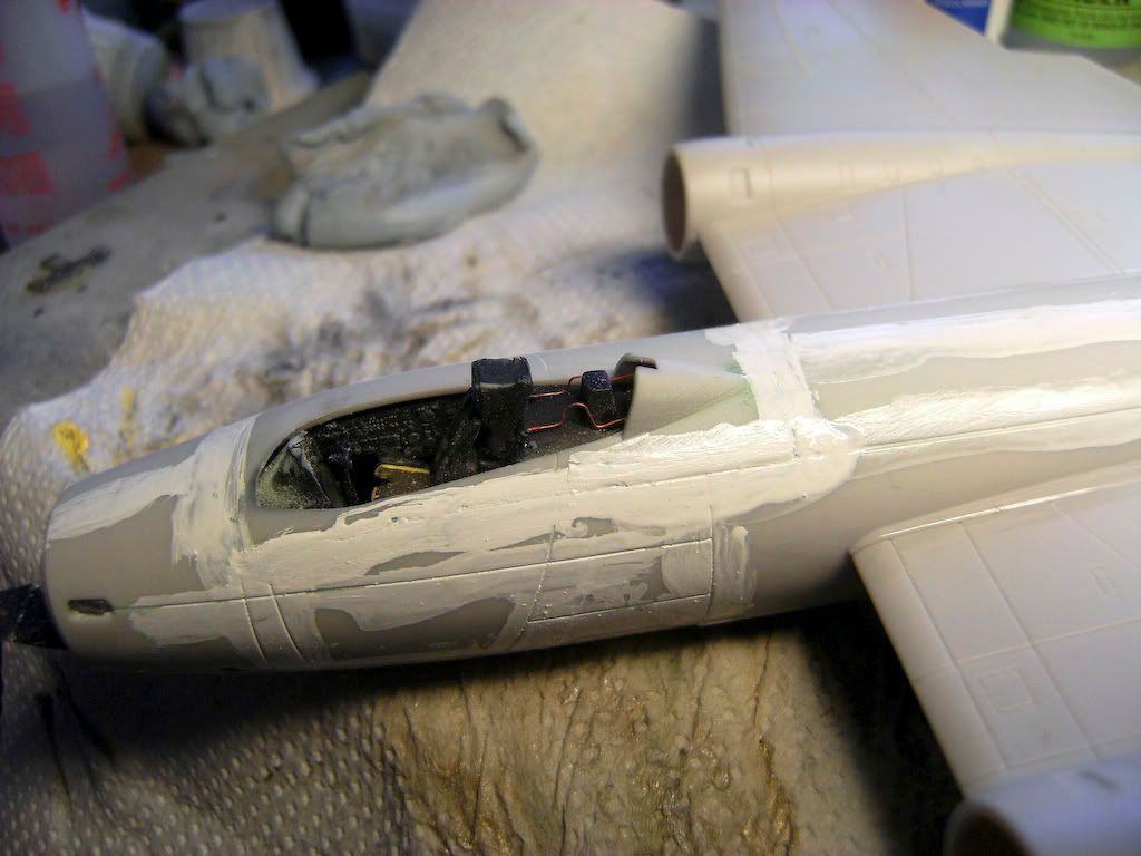

Fuslage halves together and the first problem, I don't know if everyones kit is like this of I got a bad one, but the cockpit top is too small. Anyway I stitched it in place with CA and then added a little squadron green. The rest of the fuselage fits well with very little sanding needed on the seams.

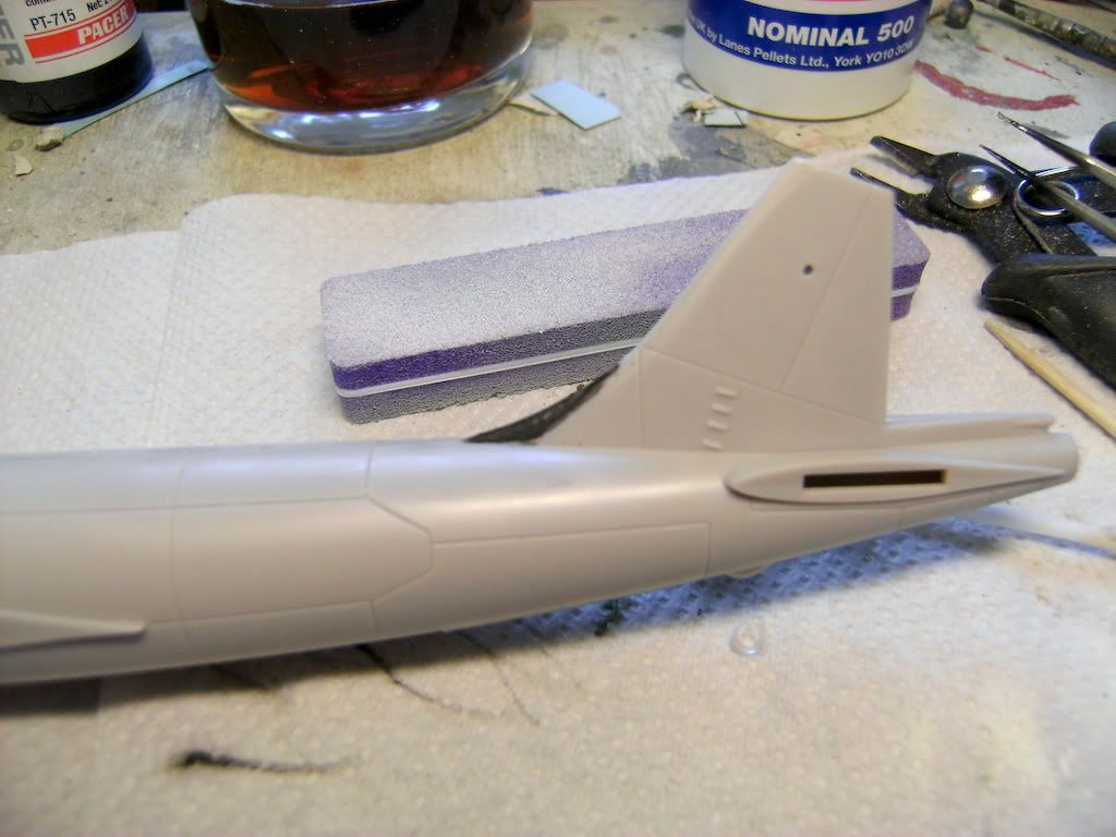

Rudder now filled and sanded down.
The black area is roughly how much Airfix have got the tail wrong
And re-profiled
More tomorrow...

Great progress, Mish.
I like the re-profiling of the fin's leading edge; looks spot on. How did you know how much had to go?
Andrew.

By studying photos and being trained as an engineer :)
Share this post
Link to post
Good-o. I'll attempt mine (when I get it) via the same method - the first part, not the second. Ta.
Andrew.

Very nice work Mish! The fin turned out great!
Cheers,
Håkan

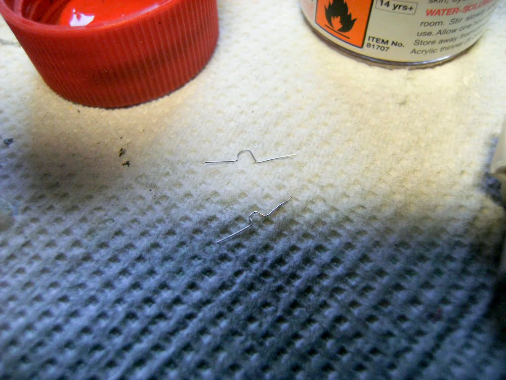

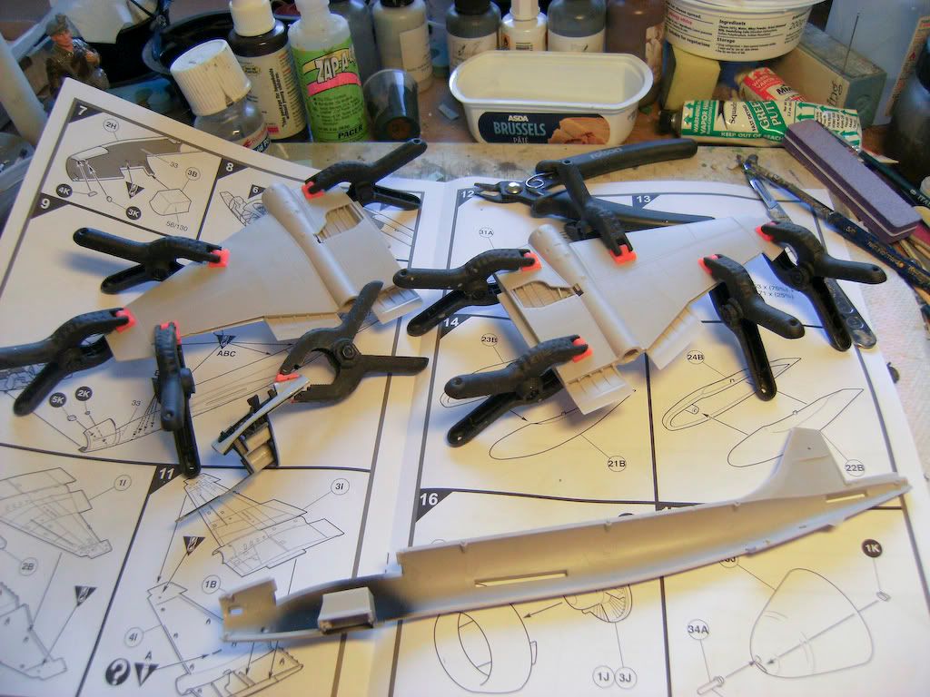

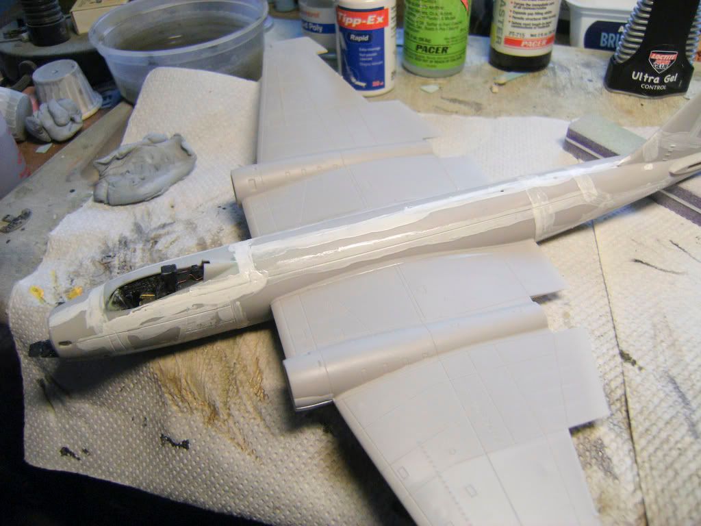

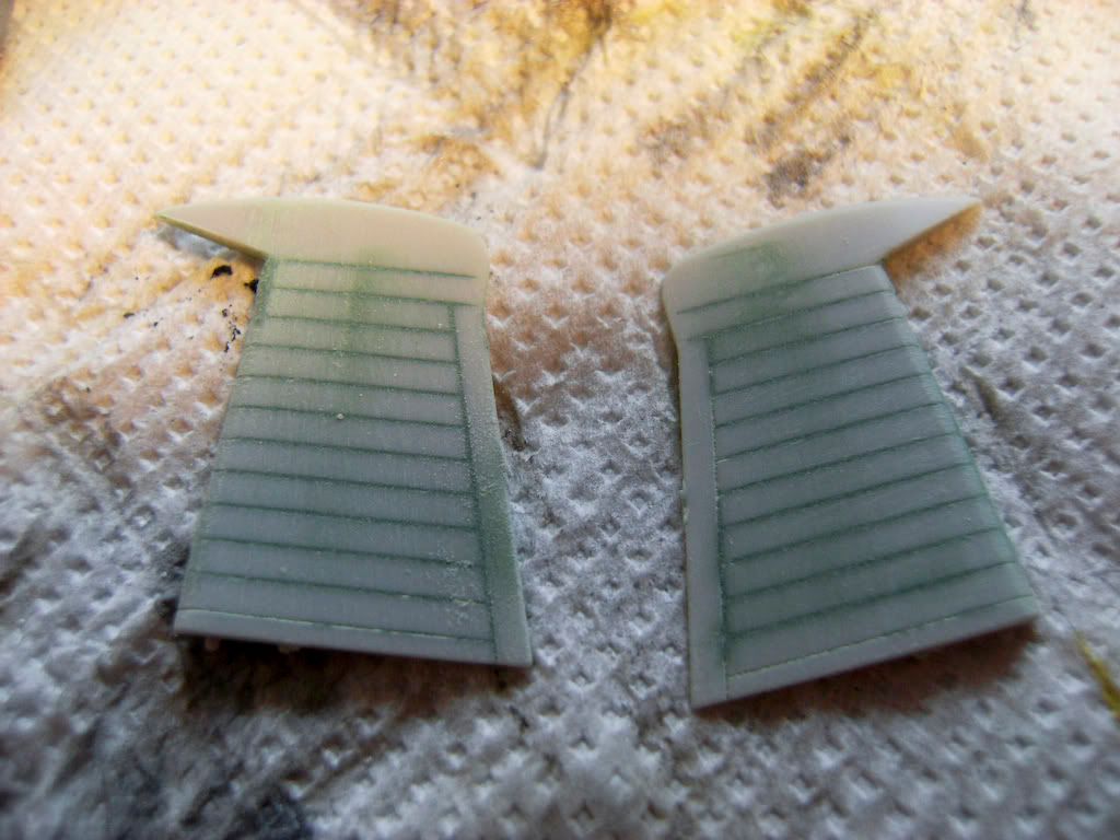

Anyway on with this afternoons efforts. The wings are one and an excellent fit. There are two small sink marks on each wing that are over the fat locating pins inside the wing half. These don't show on the photos. they only need the thinst scrapes of filler/surfacer to fill.
My research shows that early PR.9's were fitted with MB 2CS seats, now these has two red wires running from the seat head box into the rear of the cockpit. I've scratched these from some 5A fuse wire.
And fitted
I've also added some 'tipex/snowpaint' to the rather deep panel lines to try and tone them down a bit. I really don't want to fill them and loose them all together or rescribe them all. I'll see how this goes.

Nice work Mish! Hope the tipex does its trick!
Cheers,
Håkan

Maybe I should do that too, as I can't buy MrSurfacer locally either!

Håkan I'll post a photo in my build report later I had a quick look at the model before going to bed last night and the Tipex and some sanding appears to have worked well, of course I won't know till I get some paint on her.

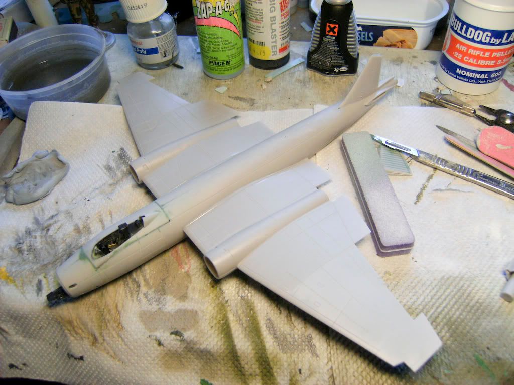

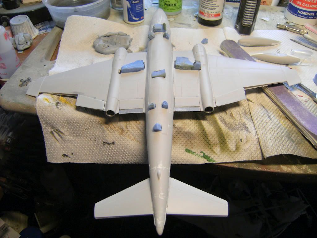

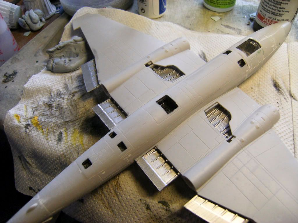

A bit more done this morning.
Got the camera bay in. I had to sand it to fit and the 'stitch cement it' in place with CA before sanding and filling with CA

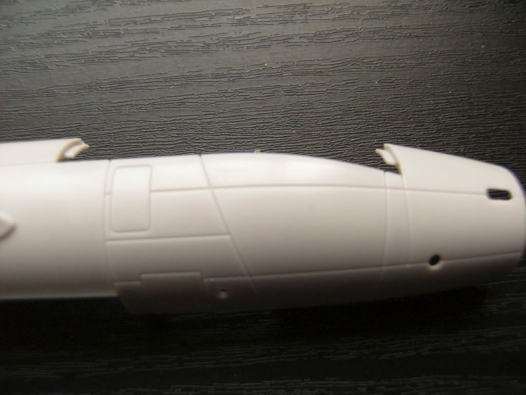

Now I'm no Canberra expert but these look plain wrong

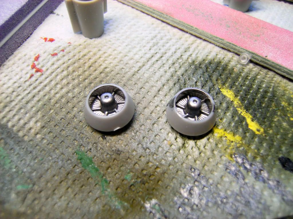

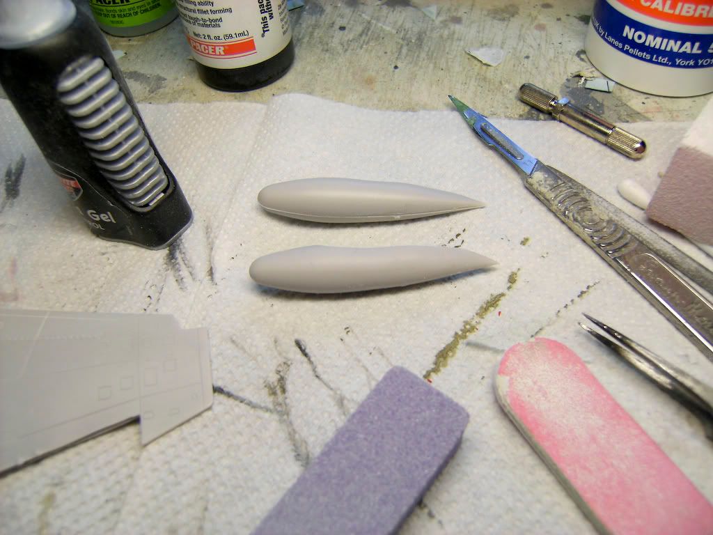

And these tanks don't look quite right in profile, especially to the rear.
I've blue tacked the flaps in place and bunged up any holes with foam from an old sanding sponge. Got some tidying up to do around the intakes and jet pips and a bit more masking then I'll start spraying.
