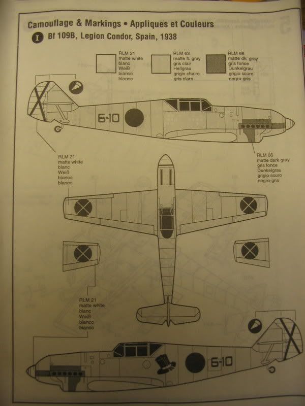

Doug Rogers Posted March 31, 2009 Share Posted March 31, 2009 (edited) Hi all, this is my GB entry, going to be building it OOB. The instructions show it to be painted in RLM 63 Grey, but what do the team think, as I've seen many builds of these early Messerschmitts in silver? Should be a relatively quick build, for me anyway! Edited July 8, 2009 by Doug Rogers Link to comment Share on other sites More sharing options...

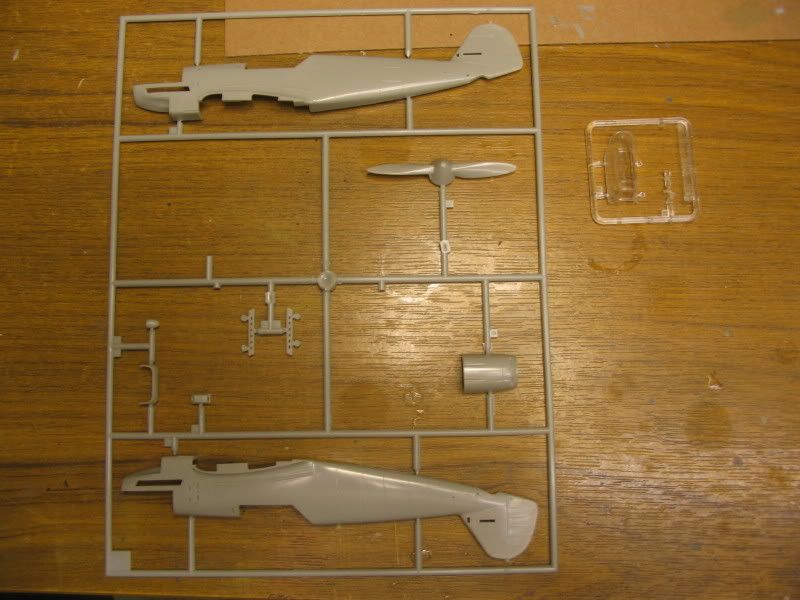

AnonymousFO98 Posted March 31, 2009 Share Posted March 31, 2009 we want sprue shots know what you mean- the symbols are a bit incongruous. the top hat is one that has always had me baffled- any ideas why it was used Doug? Link to comment Share on other sites More sharing options...

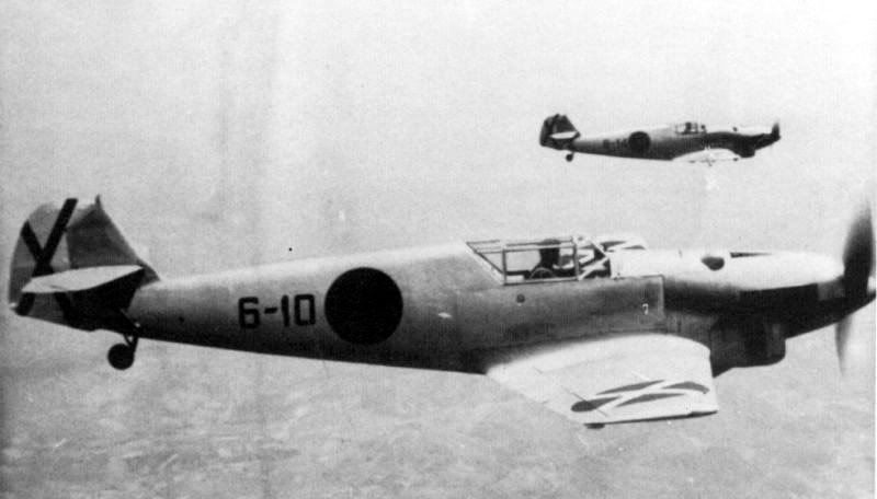

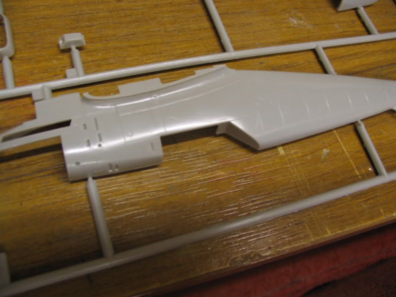

Doug Rogers Posted April 2, 2009 Author Share Posted April 2, 2009 I can't find out the significance of the Top Hat markings, other than they were for the 2nd Staffel of J/88. 1st Staffel apparently had a couple of eyes looking skywards, and the 3rd Staffel had the Mickey Mouse symbol. Found this nice pic on the interweb A couple of sprue shots as requested, quite nice detail actually, for a cheap old stash sitter. I'd already cut out the Balkankreuz markings for an Airfix 109F. As far as I can make out the paint finish was a sort of greenish grey protective paint layer over a bare metal finish, so I may paint it silver first, then try and mist a custom mix over it. Link to comment Share on other sites More sharing options...
AnonymousFO98 Posted April 2, 2009 Share Posted April 2, 2009 Thanks Doug looks pretty neat with afair amount of detail colours are quoted as RLM63 or 02 over 65 does the decal sheet have the kill markings for the fin 9which i note are absent on your pic) also there was a legend "ALTERUM" (antiquity) in white on the cowling Link to comment Share on other sites More sharing options...

blimp Posted April 2, 2009 Share Posted April 2, 2009 hi doug , just a quickie - the photo shows 6-10 in it's original form , light grey overall with small codes behind the black disc , oversized discs on the wings , extending over the aielerons . when it was fitted with the metal hamilton propeller it would have been repainted , probably in grey green and blue . it went to the spanish after the war , when it bore the 'kills' and 'antique' legend , - it was an old 'un ! Link to comment Share on other sites More sharing options...
Doug Rogers Posted April 3, 2009 Author Share Posted April 3, 2009 Ah, OK so when this model was actually depicted it would have been in overall RLM63 then, as per the colour call outs on the instructions. Guess I should have had more faith in them. Link to comment Share on other sites More sharing options...

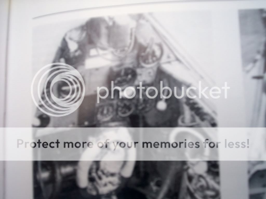

blimp Posted April 3, 2009 Share Posted April 3, 2009 (edited) hello doug , yes , the call out is right . but the black discs seem a little small , the prop had grey blade 'cuffs' & spinner . oh , the band on the top hat was red as well . - picky , picky, picky ! - i dunno , black and white photos , and all those *@!#% grey paints ! ARGGHHH! heres an early cockpit photo , complete with cocking handles for the two machine guns . the red baron would have felt right at home . Edited April 3, 2009 by blimp Link to comment Share on other sites More sharing options...

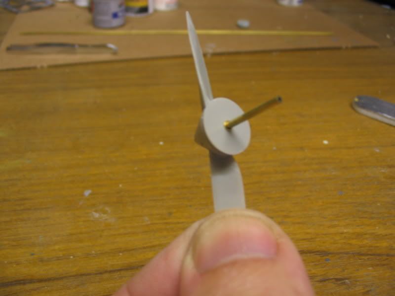

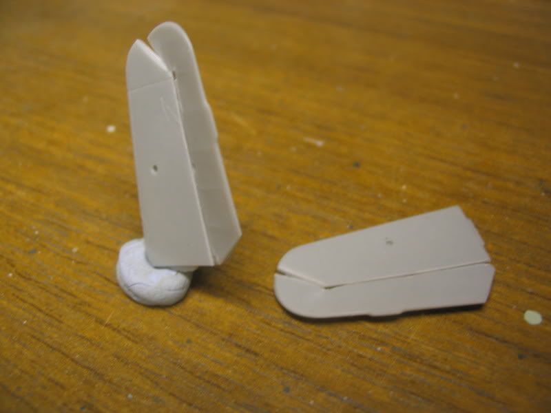

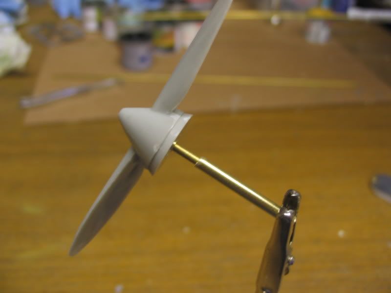

Doug Rogers Posted April 10, 2009 Author Share Posted April 10, 2009 Just got time for a quick update, got some prep work done on the prop, elevators and tailwheel. Decided to have a go at installing a brass prop shaft and sleeve, I've done it before on a couple of Spitfires, but not for a while. First source some 1/16in and 3/32in brass tubing, in theory the smaller should slide nicely inside the larger but worth checking before you purchase. Cut about an inch of the 1/16in tubing and test for fit in the hole in the spinner plate. The hole in mine was slightly too large, so I sleeved it out with a shim from the 3/32in tube, and fixed with a drop of CA glue. Check for balance when dry... oh OK...I just like to see it whizzing round really Then cut a similar length of the larger 3/32in tube for the fuselage nose insert Cut and dropped the elevators, just needs a bit of clean up Discovered the taiwheel, which comes moulded into one of the fuselage halves, had snapped off, so drilled and inserted a pin ready to fit when the fuselage is done later. That's all for now, dashing off to a Birthday party, see you later. Link to comment Share on other sites More sharing options...
