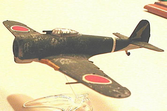

CPNGROATS Posted February 22, 2009 Share Posted February 22, 2009 (edited) A. I esp. like your paint chipping and the subtle dirt/grime weathering...Part of the "character" of WWII japanese a/c is the paint peeling tired look they had..I've attached a pic. of a vintage Revell 1/72 Ki-43 build with the tired look... Cheers, ggc Edited February 22, 2009 by CPNGROATS Link to comment Share on other sites More sharing options...

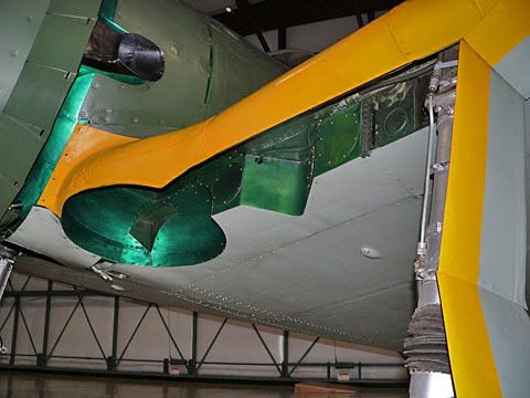

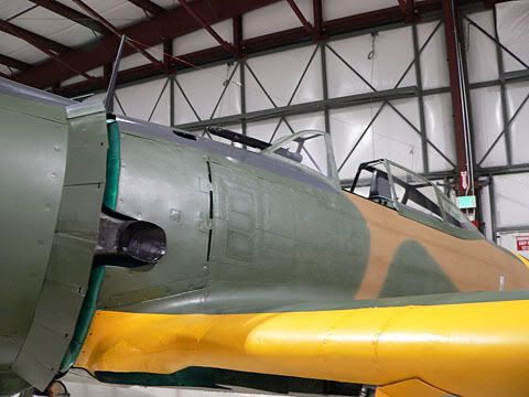

Nick Millman Posted February 26, 2009 Share Posted February 26, 2009 (edited) A lovely model and a refreshing choice of markings. The only criticism - and it is a very small and pedantic one - is this. The topmost fairing on the undercarriage leg was not a right angled flap and not as thick as the kit part. It was a very thin piece of metal hinged to the top of the middle fairing. As the undercarriage leg compressed the top fairing depressed outwards against the lower surface of the wing, the edge maintaining contact with it. When the weight was lifted and the undercarriage extended this fairing folded back into a more upright position ready to close against the undercarriage well as the leg retracted. On the ground, bearing weight, the fairing should be connected from the top of the middle fairing to the lower surface of the wing with no gap. The bottom fairing on the Ki-43-I did not slide up over the middle fairing but hinged outwards as the oleo compressed (the fairing slides up on the Ki-43-II). On the Ki-43-I the top of the bottom fairing was hinged to the bottom of the middle fairing. These photographs of s/n 750 show it. That in no way detracts from a beautiful model btw. On Hayabusa models I replace the kit fairings with thin plastic card. Edited February 26, 2009 by Nick Millman 1 Link to comment Share on other sites More sharing options...
timbo33 Posted February 26, 2009 Share Posted February 26, 2009 Now that's a plane that's seen some action. It's a tricky technicque emulating the flaking/wear of paint, especially on Japanese aircraft where a lot of the paint fell off!!! Link to comment Share on other sites More sharing options...
Antoine Posted February 26, 2009 Author Share Posted February 26, 2009 (edited) Thanks a lot everyone. A lovely model and a refreshing choice of markings.The only criticism - and it is a very small and pedantic one - is this. The topmost fairing on the undercarriage leg was not a right angled flap and not as thick as the kit part. It was a very thin piece of metal hinged to the top of the middle fairing. You're absolutely right, I didn't know that. I have to admit that I've focused much more on the paint, than in the general accuracy of the model. The only error that I've noticed by myself is the presence of the landing light, which is not correct for a I (Only for late II and the III serie) I've also heard of a false representation of some constructions lines between the wing and the fuselage, but I didn't pay attention to that. I'll try to remember that next time I build one, as it's a very interesting aircraft. By the way, where does the aircraft shown on your pics comes from? Edited February 26, 2009 by Antoine Link to comment Share on other sites More sharing options...
Nick Millman Posted February 26, 2009 Share Posted February 26, 2009 Antoine, it was nitpicking on my part and in no way detracts from a very fine build. The aircraft in the photographs #750 was an 11th Sentai machine found hidden four miles from Vunakanau Airfield, Rabaul by Sqn Ldr Denys Hamilton and party in September 1945. The aircraft was in the hands of an Army repair unit. It was subsequently crated up and sent to Australia in December 1945. It was in the possesion of the Australian War Memorial Museum until 1953 when it was sold to R G Curtis. From 1962 until 1980 it was owned by Sid Marshall. In 1985 it was sold to Col Pay at Bankstown Airport NSW. Eventually in 1993 it was purchased by the Alpine Fighter Collection in NZ and completely restored to its original colour scheme and markings. This aircraft is now in the possession of the Flying Heritage Collection at Paine Field, Washington, USA:- http://www.flyingheritage.com Link to comment Share on other sites More sharing options...

Antoine Posted February 27, 2009 Author Share Posted February 27, 2009 Thanks for the linky, Nick. Link to comment Share on other sites More sharing options...
