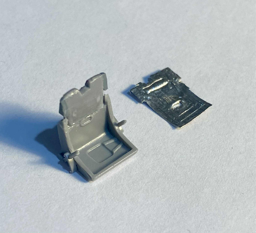

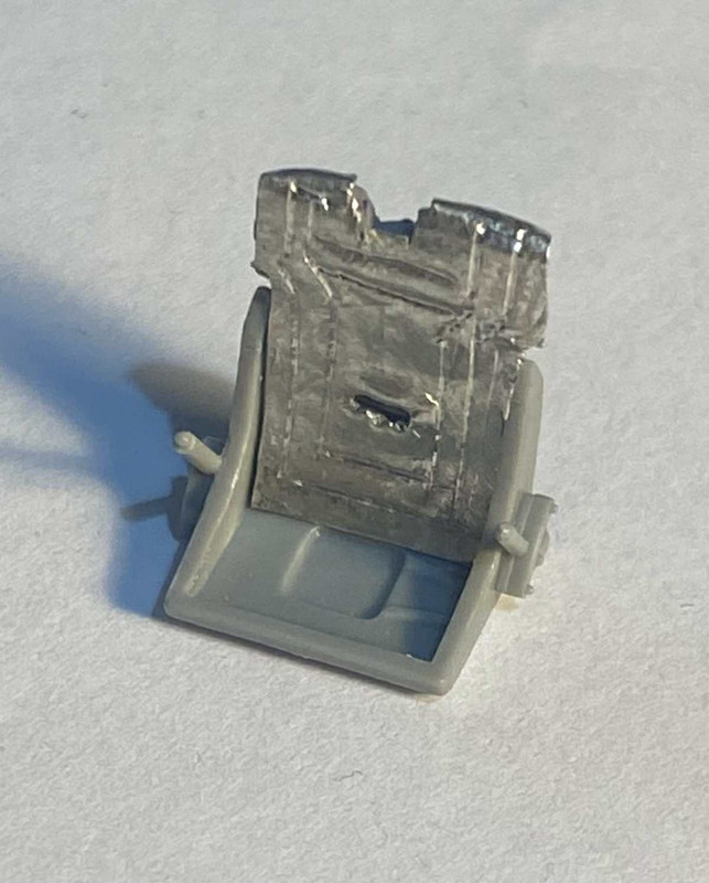

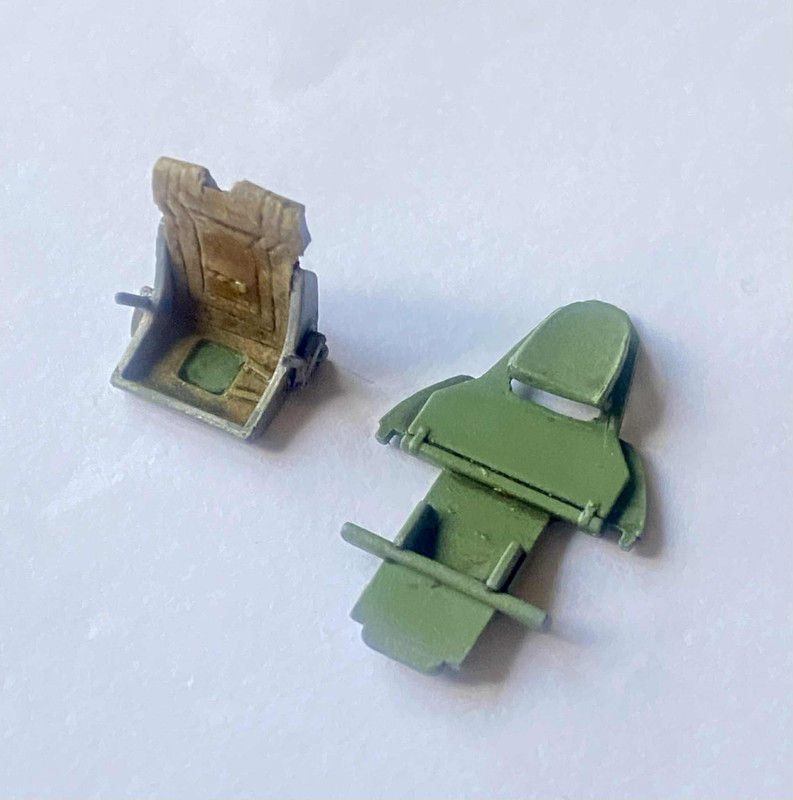

I have a pilot's seat... I rebuilt the back using the surplus-to-requirement seat from my Corsair build, and added a couple of tiny slivers of styrene at the sides to represent how the seat "flares" at the top. It isn't quite tall enough in proportion due to how it's mounted on part J13, any taller and it would foul the head armour, but it gives at least a sense of the unique shape of the seats in the Finnish Hurricanes (reminder to self: closed canopy, therefore largely invisible.) The shiny bit next to it (pic 1) represents the leather padding on the seat back, which will be appropriately painted up and glued in place as in pic 2. I had a go at scoring the padding pattern per the photograph further up, we'll see how it looks with some primer on it. This is cunningly fashioned from the foil from the neck of a bottle of very decent Tobermory 12-year-old single malt that I've been looking for an excuse to open since I visited the Isle of Mull in August. Slàinte! 🥃
Touch wood, that's the trickiest part of the build out of the way.

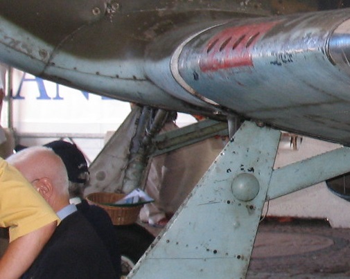

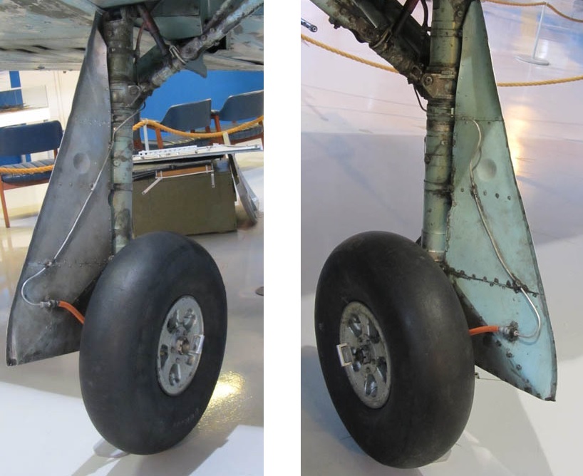

Posted (edited)

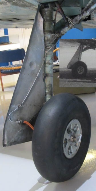

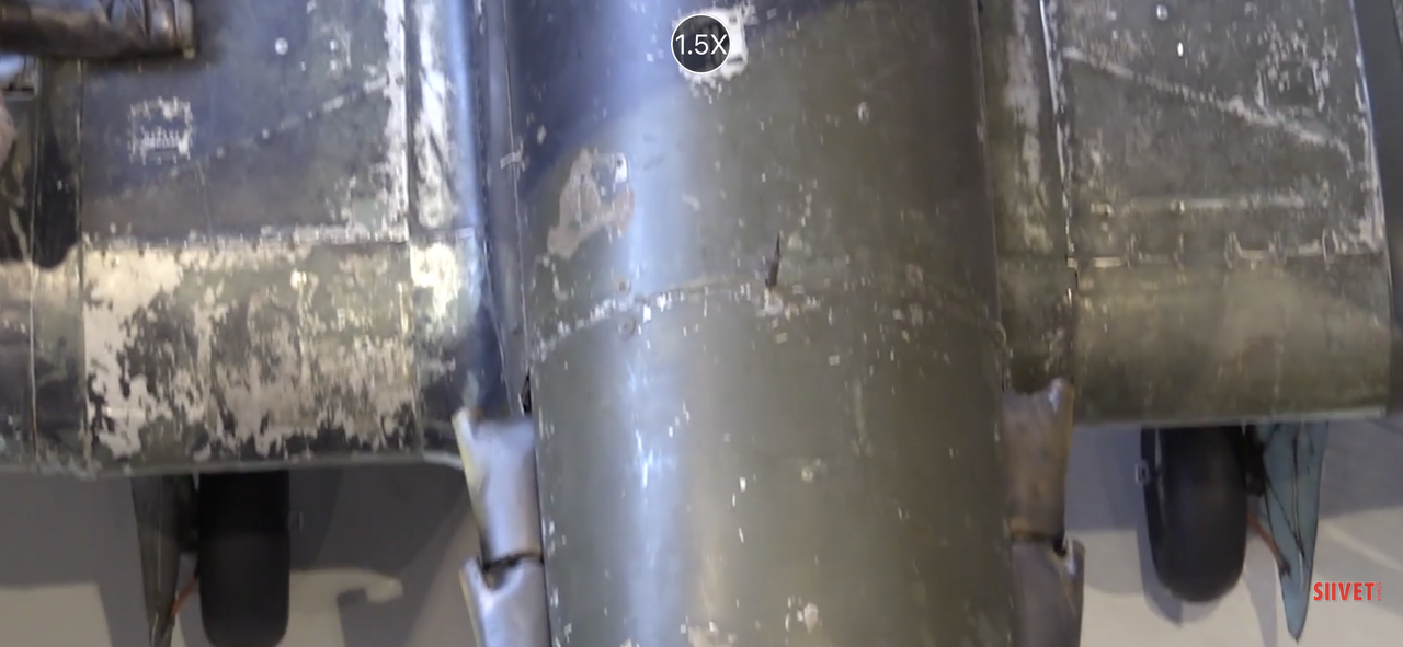

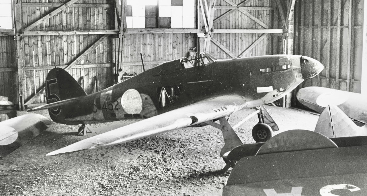

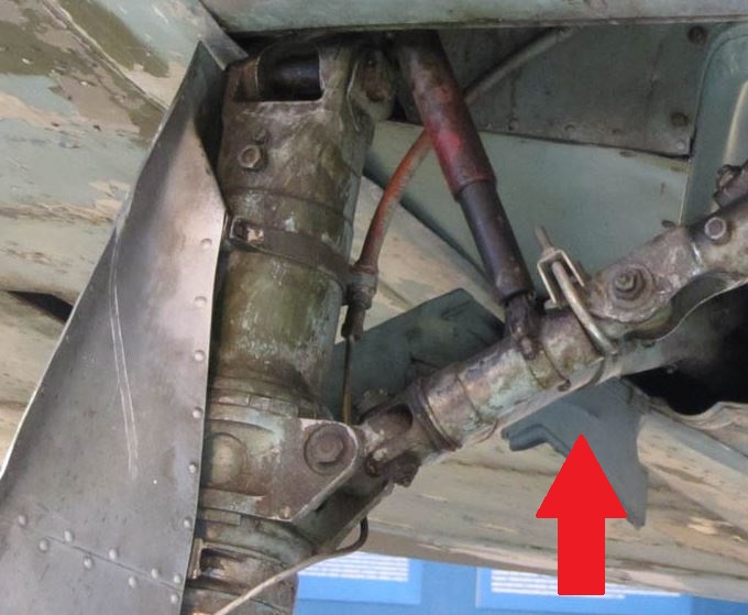

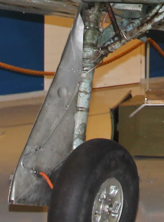

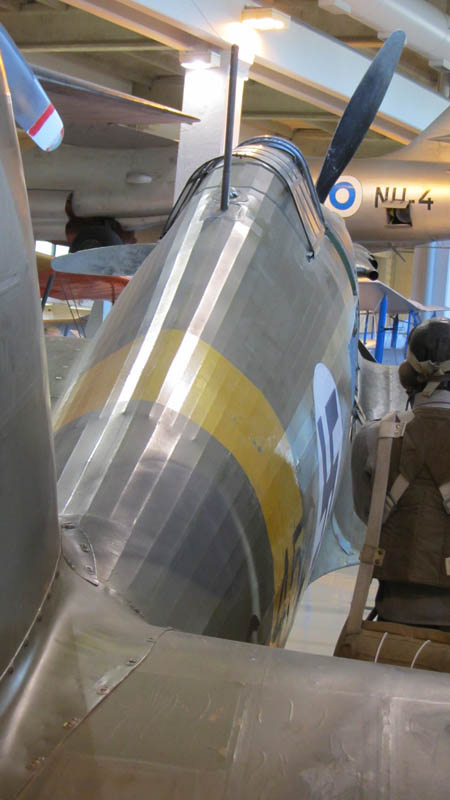

OK, I've been mulling over the question of the bare metal starboard inner wheel fairing, and this is where I'm at.
Here's a "then and now" photograph of the same part of the plane, and being black-and-white it's impossible to tell whether it's blue or bare metal but FWIW they look the same:
However... I have come to the conclusion that this isn't a replacement fairing at all. It appears that a repair has been made (probably following the "hard landing") to the original fairing after it was painted blue, using an unpainted inner panel taken from another aircraft, my money being on it being one of the Hurricanes that didn't survive long enough to get the new Finnish paint job and was still in its "delivered" scheme. This is based on the fact that the outer fairings are the same colour and exhibit similar amounts of wear and tear, and this image:
Note that the aft part of the fairing appears to be light blue, not metal.
Edit: clearer still in these pics:
So, I'm going to need to partially repaint one of the wheel fairings to represent this.
Some great sleuthing here Nick, that definitely sounds plausible!
9 hours ago, Nick McV said:
It gets in your head, this stuff, doesn't it?
:banghead:
Yes, yes it does!
It also looks to me as though the undercarriage leg, while chipped and weathered, may have been painted light blue as well.
AW
  • Agree 1
AW
They are indeed, as well as the wheel wells, though as you say some heavy wear and tear there. I've already painted both light blue, but down the track there will be some weathering to do.
  • Like 2

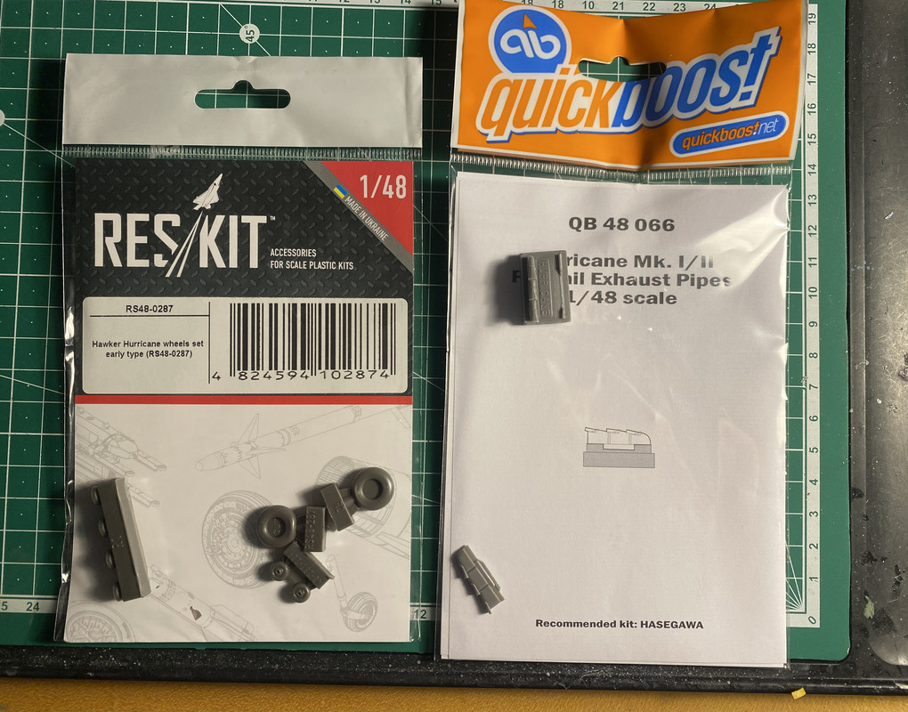

Couple of bits of aftermarket have arrived: five spoke wheels, and some exhaust stacks which are a great improvement on the kit originals (IMHO a decent set of exhaust can really lift a model).
I've also ordered some etch seatbelts, through the ones I've ordered are "suitable for Airfix kit". I'm sure they're compatible with any kit really, but I'll probably save them for when I do actually build my Airfix Hurri, I've found a couple of Eduard Spitfire colour PE's in the spares box and I'm sure the harness from one of them will do the job here.

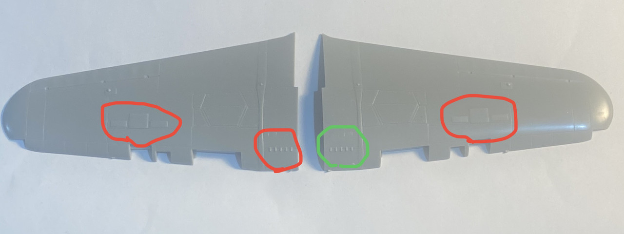

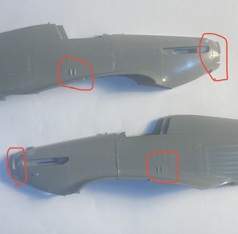

While I'm waiting for cockpit bits to dry there's a bit of fettling on the outside I can be getting on with.
On the fuselage, the "lip" on the nose needs to come off, this being a feature of Mk II Hurricanes I believe, but not the Mk I. "Be careful not to remove it too much" say the instructions, helpfully.
Also, I don't know what those two little nubbins on both sides of the fuselage below the cockpit are, but they're not present on HC-452.
On the wings, there are three strengthening plates(?) on each wing that need to come off (again, pointed out in the instructions). And near the wing root on each wing there is a row of five little fishplate things. On the real thing they are present in the port side, but not the starboard.

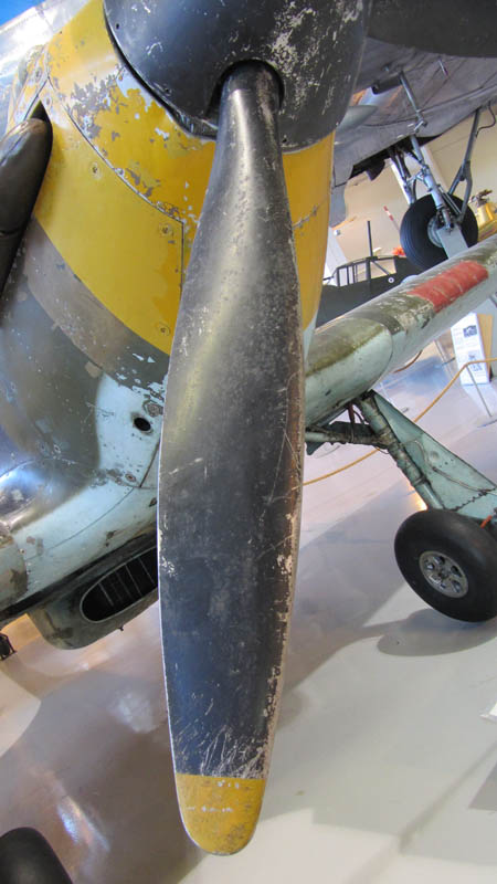

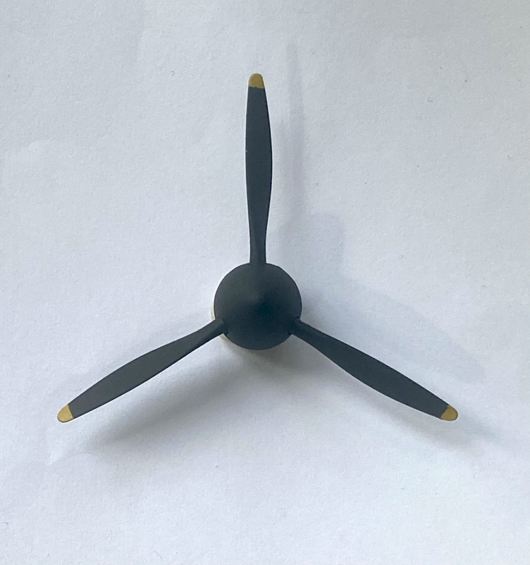

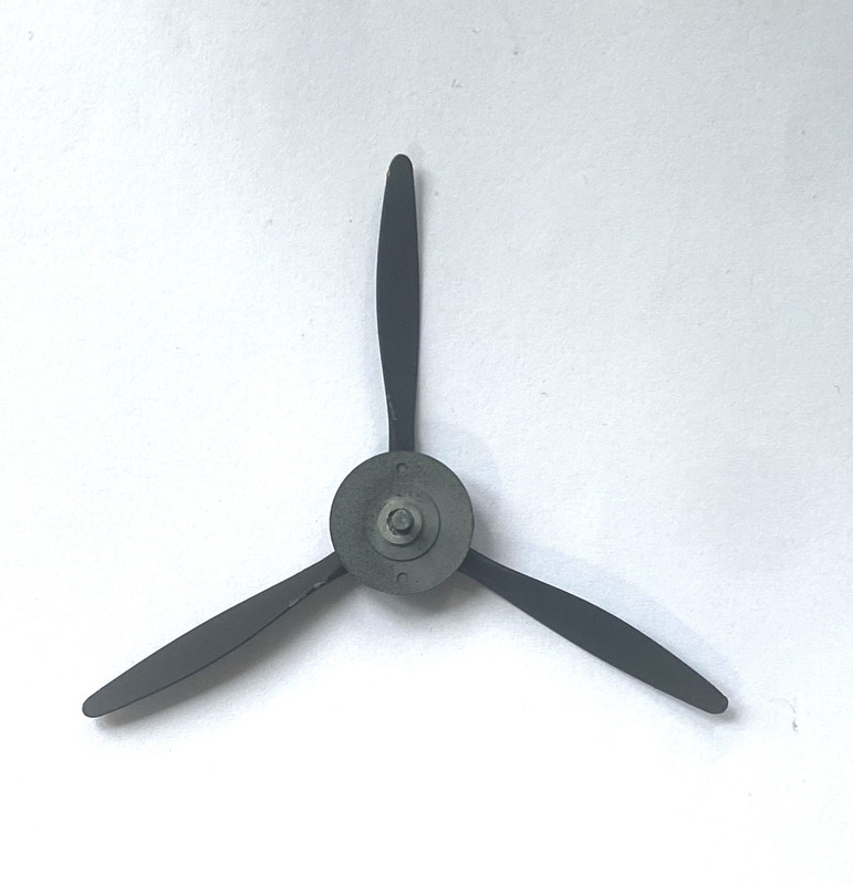

I've got the prop painted up:
(I knocked up a little spacer around the prop shaft - there's a noticeable gap between spinner and fuselage nose on the real thing.)
Another quirk of HC-462 is that the propeller tips are painted yellow only on the front of the blades, while the reverse remain all black:
While this photo shows HC-452 in storage after the war without a prop (or engine, or glazing!)...
...I'm pretty sure it's the original (or possibly one from another Finnish Hurricane? See below), from looking at these pics from her time in service:
It's something I haven't seen before, and I wonder if it's a feature specific to the Finnish Hurricanes. Here's HC460, apparently with the same all-black reverse blades:
But here's HC-464, yellow tips front and back:
So either the restoration team had the original prop, or a similar one from another Hurricane, or they sourced one and showed great attention to detail in painting the tips of the reverse blades black, which seems unlikely somehow.
It's also something that appears to be routinely missed in builds of HC-452, so I am feeling a tiny bit pleased with myself.

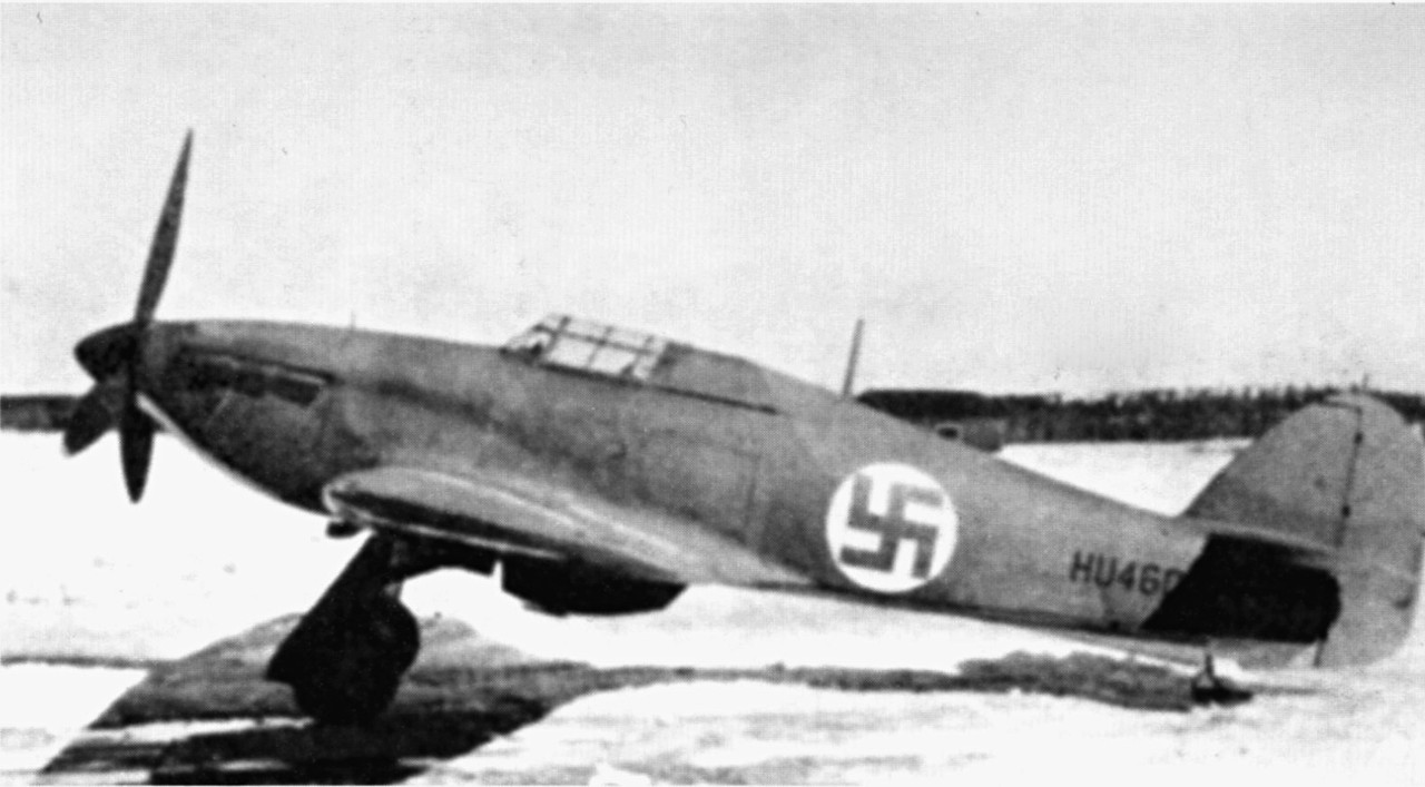

Look very closely at HU460, it has a yellow.  The pic of HU452 is in shadow.
No, they are not black,  look again
909153-A9-C5-E0-44-CF-96-D8-57-E15-B3677
what you are seeing is bare metal.   Note the blade to the right has black paint for about 2/3. the other blade looks more worn.
It's a detail pointed out ages ago by @Work In Progress  who is a pilot.
Blade wear occurs on the back of the blade, down from the tip.  You get the odd ding on the leading edge,  but the front can be nearly pristine and the back a 1/3 or more bare metal (see Corsair pics in link)
It's one of those  'once you know' details,

2 hours ago, Nick McV said:
Well, that was No Fun At All.
it's done.  Note that the internal framework is painted aluminium if you have not already spotted that.
HTH
This is most enlightening, thank you. How (or indeed if) I will represent this is anyone's guess, I've already painted them black.
Yeah, I spotted that. Trust me, I've spent more time than is healthy looking at pictures of this aeroplane 😁. Update tomorrow.
Cheers
Nick
Repaint rear blade  about 1/3 with aluminium paint, and dry brush black,
Or as already painted, hard dry brush aluminium paint, down from tip, reducing the amount of aluminium paint.
Or, have you got a silver artist pencil, like Prismacolour?  that would work I think.
Practice on something else first, the blade wear also depends when you are
The ones I link/show are from desert or Corsair, crushed coral, both are very abrasive,  so less blade wear in Finland.
HTH
This works on most black paints that we use providing they are matt or satin. You can smudge it with a finger to create a graduated effect. It's the sort of thing to try on a few old bits of sprue before you do it on a prop blade - though of course you can always strip and re-paint if you get it wrong,
  • Thanks 2
I do indeed have one of those silver pencils, which I use for chipping, especially on the leading edges of propeller blades. I have plenty props in the spares box, I'll spray one of them up and experiment with both methods before letting rip on HC-452's prop (which is spray painted matt black).

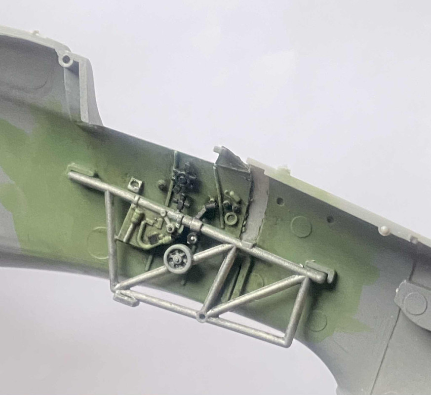

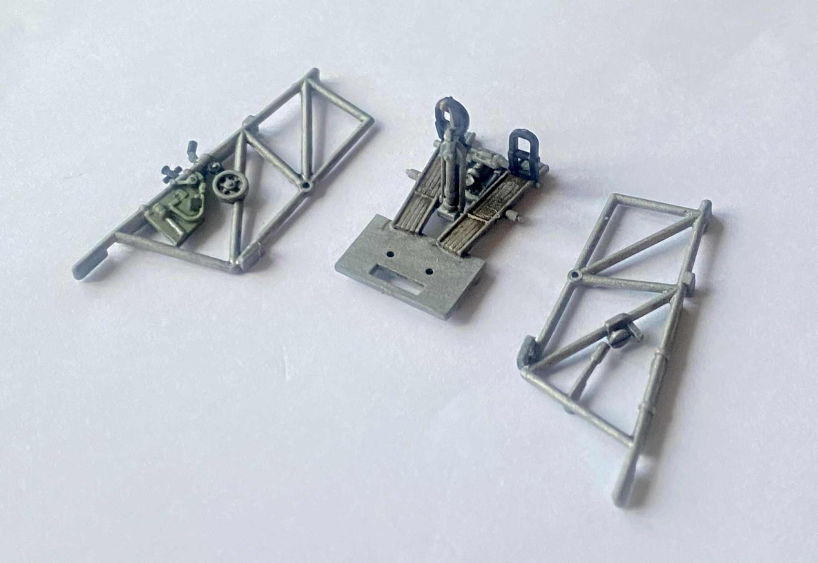

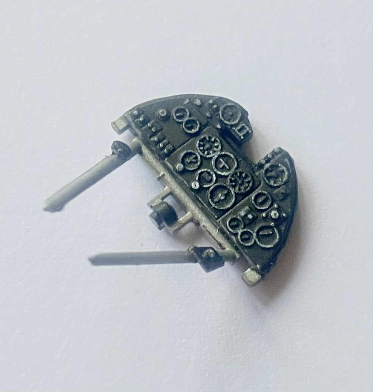

The rebuilt pilot's seat just needs some seatbelts before mounting on the modified bulkhead with the custom Finnish head armour. The Whisky foil padding turned out okay I think.

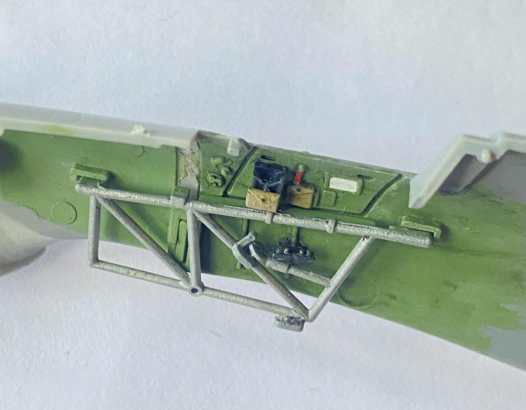

Here's the floor with control column and pedals, and the cockpit framework, which (unusually) is bare metal in this Hurri, albeit with a kind of "shelf" at the top in interior grey/green, as the sidewalls. The panel on the port one (aft of the trim wheel) has a little more going on than the real thing, but I just painted it up.
I decided to dry-brush the instrument panel rather than use the decal, which would probably have looked a bit garish. This is more subtle I feel.
Port sidewall. The framework isn't glued in, it's just sitting there for effect.

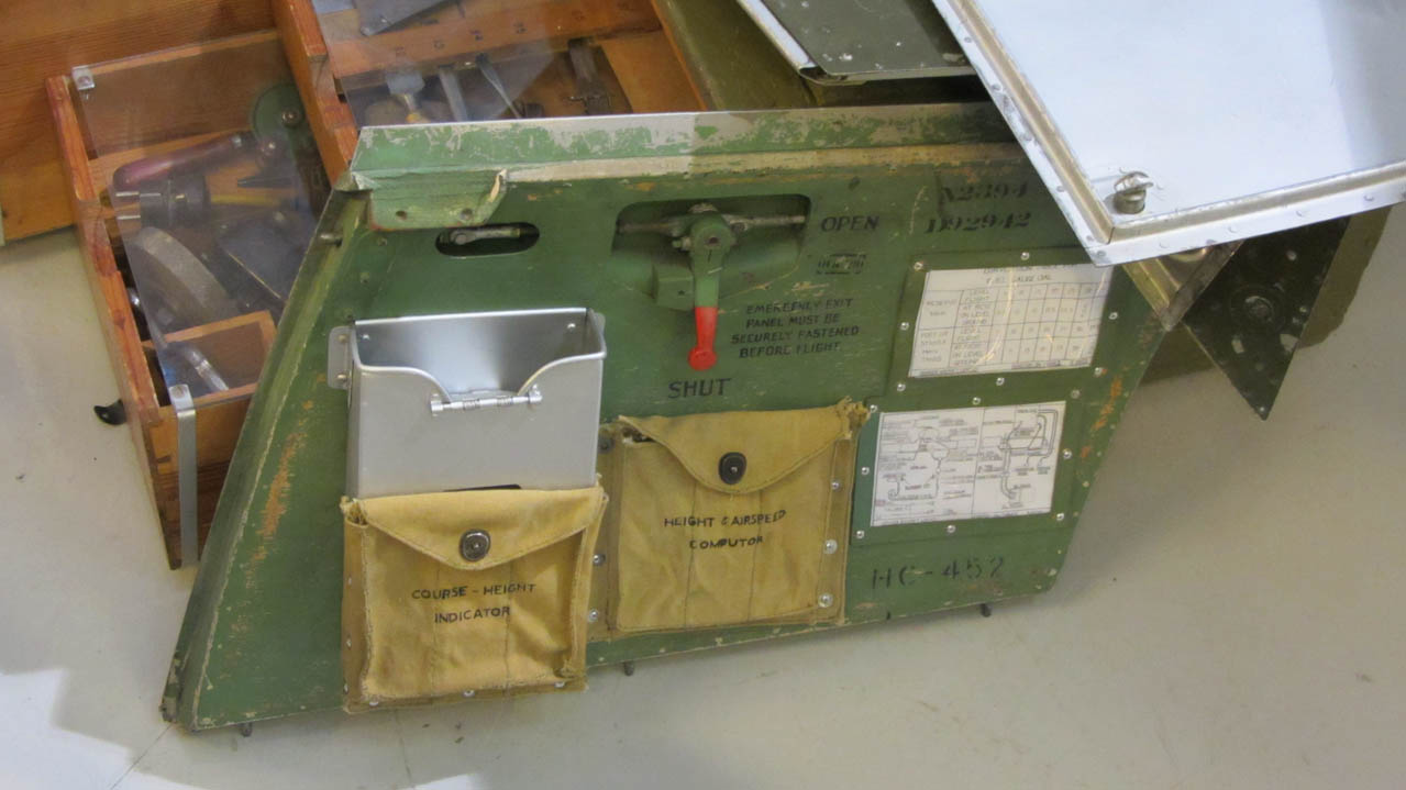

Starboard sidewall. I went to town a bit on this, trying to capture the essence of the real thing:
The two pouches and the map holder were made and added by the restoration team. The kit moulding has one of the pouches, the one on the right, the one on the left (which sits on the front of the map case) I knocked up out of Tamiya tape. The new map case appears in bare metal, I had a look at a few period pictures of Hurricane cockpits and saw some in grey/green, others in black. I went with black just for a bit of contrast. The upper framed diagram thing I represented with a tiny silver of white decal; I considered doing something to show the lower one, but decided against it - that would just be a faff too far.
I'm going to have day off today, but will add those seatbelts and stick it all together in the next couple of days, we'll see how it looks, then hide it all away forever...
I know, I know! These are vents for Trop versions.
  • Thanks 1

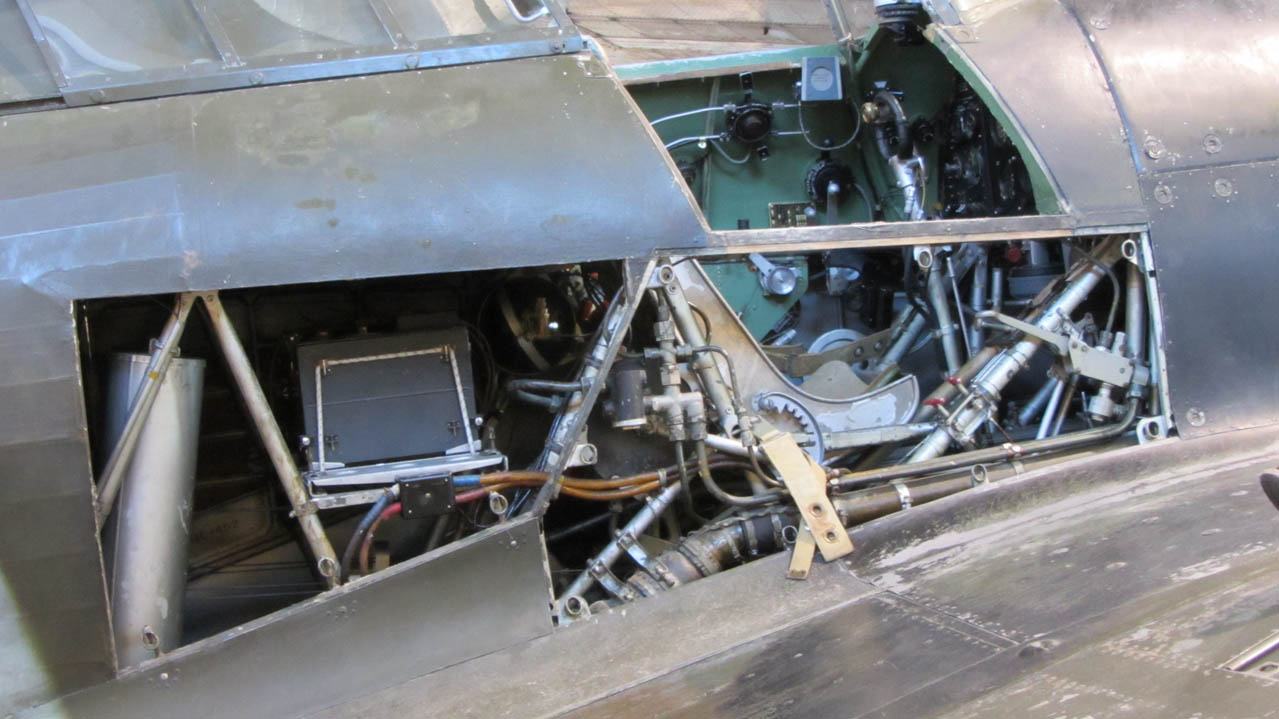

Not bare metal.  Painted aluminium dope.  Standard for most Hurricanes.   Note the inside of the metal panels below the cockpit is also painted aluminium.
Just visible behind trim wheel , you can also see the aluminium paint chipped off the seat
note the black bits in the framework are Mk.II bomb switches
HTH
  • Thanks 1
That's interesting. I was casting my eye over my Airfix Trop kit earlier for comparison's sake and they are absent from that one!

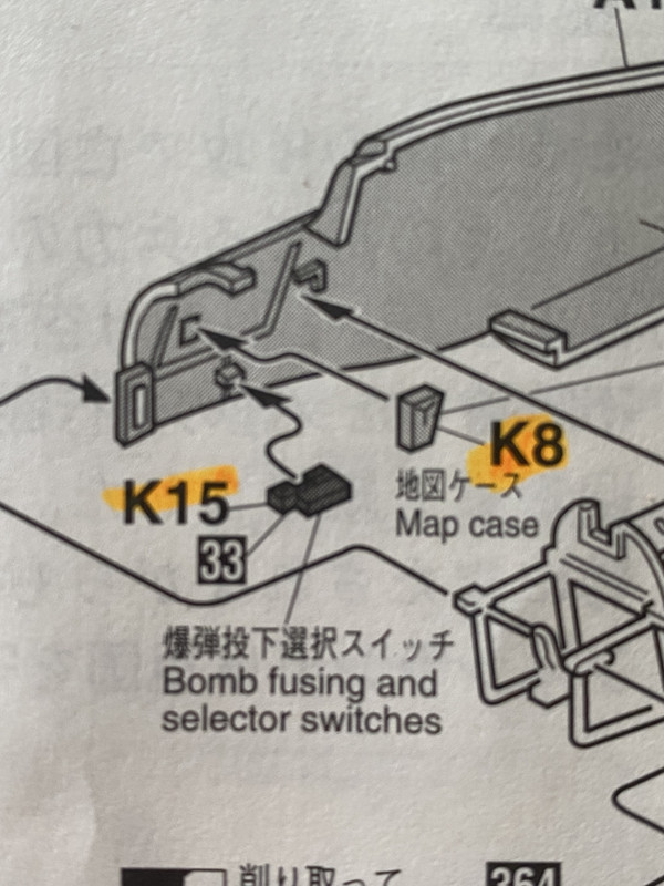

That is to say, they shouldn't be there. Gaaah.
In fairness to Hasegawa:
 No bombs = no switches I guess.
It's funny how having the actual aircraft as source material throws up as many questions as it answers, compounded by photos of the plane at various stages of its career. And casting around for photos my Corsair build for the Tamiya GB has already generated all kinds of ifs, buts and maybes. I'm thinking of proposing an "ignorance is bliss" GB. You can build anything you want, as long as you refer only to the instructions that come in the box, any other source material or research strictly forbidden. Just enjoy the build and looking at whatever comes out of the other end. Perhaps not one for you, Troy. 😉
