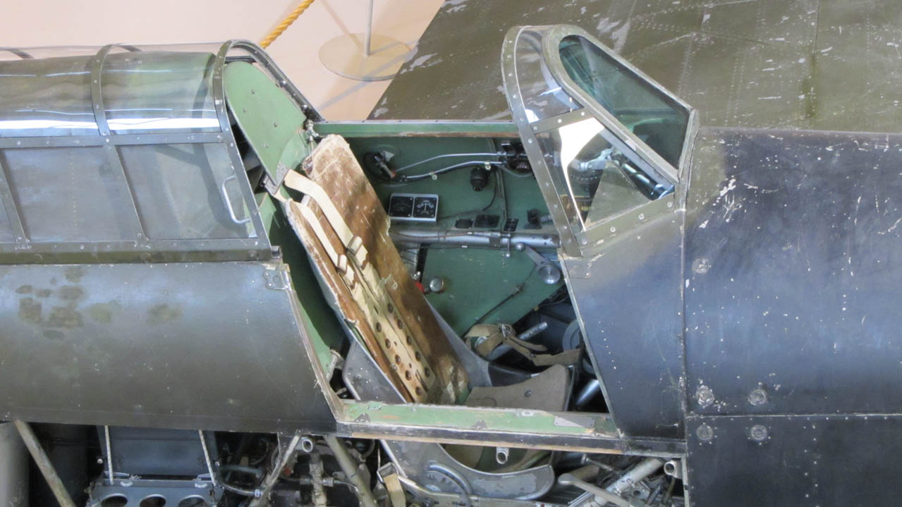

On 26/09/2025 at 08:42, Nick McV said:

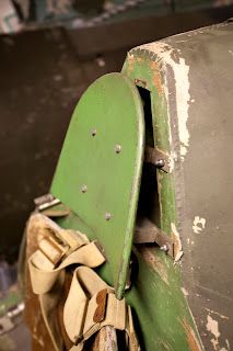

Of immediate interest is the pilot's seat, which doesn't look much like any other Hurricane pilot's seat I've seen, or anything like the one in the kit for that matter. Here's a pic of a seat I presume from another Finnish Hurricane, next to a standard Hurricane seat (? - I wonder where that one came from?)
ask the museum, they have always been very helpful, I think the Finns really appreciate it when other people are interested in their history.
Re the armour.  Finnish made.
A blog on the HC-452  restoration, very interesting and has a lot of details I've not seen elsewhere
http://hurricanehc-452.blogspot.com/2011/10/toinen-visiitti.html
"This week the team has worked with the seat and with the canopy. The plane didn’t have any armored shielding when it arrived in Finland. I can only imagine what it would have been like to fly into a storm of bullets without any armor plating, no thanks! After some demands from the pilots the Hurricane’s seat was soon after arrival fitted with 10mm steel plates. The seat was covered with these plates which protected the pilot from small calibre bullets. When the guys disassembled the seat to pieces they discovered the original fitting pieces of the armor plates in question. Quite probably these were made on the spot using Finnish pinewood. The shape of the fitting pieces had been perfected with an axe. You can’t even compare rudimentary World War Two maintenance standards with present day factory quality control. Actually it would be interesting and possibly even fun to put a seat of a Hurricane right next to seat taken from Finnish  F-18 Hornet and compare these two :)"
The brown looks to a cloth or leather cover.

Hurricane Mk I HC-452 was there partly dismantled for some preservation and cleaning work. Paints on the aeroplane are original with few exeptions. Cockpit starboard panel has reportedly been painted after some repairs and quite likely the swastika markings have been repainted. They were - or should have been - overpainted after the war when the change for the current FinnAF cocade was made. The overpainting was done also on planes which had been written off, there is photographic proof of that."
"Finnish Hurricanes arrived without the seat armour and got it only later in their career. The colour of the installed Hurricane armour looks to be British Interior Green, but it's pedigree is unknown to me as is the origin of the armour (British or Finnish-made?)."   Finnish is the answer.
Being painted in standard interior green this was surely factory fitted,
The colour is a puzzle, but the Finns may have got some British paint, or just mixed it to match....   anyway
 and installed

-- Aluminium seat and tall seat armour are from Brewster.
- HC seat back is covered with brown leather.
I have seen some of the restoration blog, with photos of a chap working on this. The steel map holder thing and the "course-height indicator" pouch beneath it were newly remade and added to the panel.

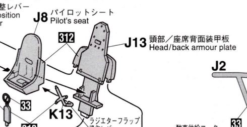

After two pages of research, speculation and conjecture I hope to be able to show some actual modelling soon! I've started painting up the interior anyway.
I'm going to have a go at adapting the pilot's seat to the kit to resemble the one on the actual airframe, and also look at reproducing that "aftermarket" armour plate behind the pilot's head. The piece in the kit (J13) represents what I guess was the "standard" armour plate for the Hurricane that would protect the pilot from the head downwards:
It's hard to see exactly what's going on in the walkaround photos/video because the canopy is in the way, but I've turned up this pic on the restoration blog which shows pretty clearly how the "aftermarket" armour plate behind the head is fitted:
I think my best bet is to very carefully drill/file out an aperture in the existing part, then scratch build a new armour plate to mount on the "frame" that's left. Should be an absolute doddle, he says, reminding himself that a few few posts ago he said "regarding accuracy I'm not going to drag myself over hot coals with this one"...
Cheers

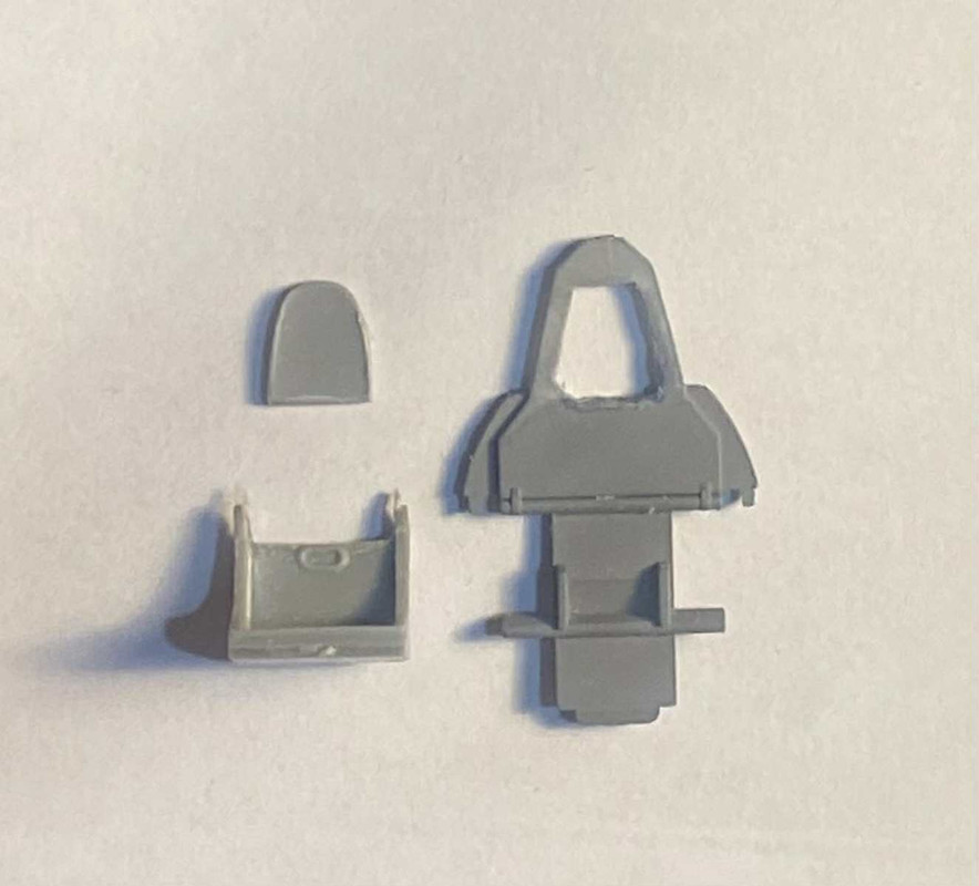

Good lord, some actual modelling! It's not much to look at, but it's a start: I've removed the upper section from the pilot's seat and reshaped and repurposed it so it will now be the head armour, and opened up the aperture in part J13, over which said head armour will be mounted. Didn't even have to drill it, just patient use of a sharp knife and needle file. Now I need to rebuild the seat to the taller/more rectangular shape we see in our Hurricane. It doesn't really matter if it's a bit scruffy as I plan to recreate the leather padding with painted foil which will be placed over the seat back. Here we gooooo!

In other news, I rebuilt the pilot's seat last night but didn't have time to take a pic, and the SBS decals sheet and other aftermarket bits have arrived.

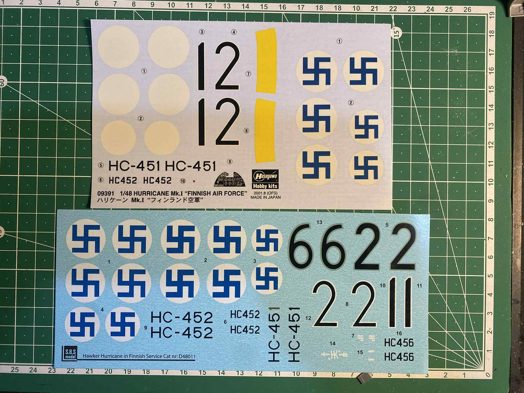

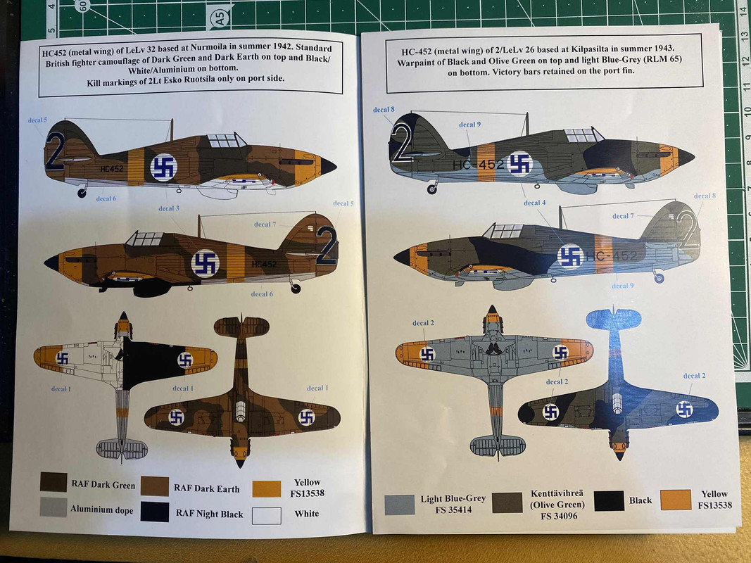

So, here is that SBS decal sheet, with the kit original for comparison:
The only decals I'll be using from the kit sheet are the instrument panel and the "red cross" (which hides a unique little surprise, more on that later!)
Quite apart from the infamous "Hasegawa White", the kit decals are a bit of a train-wreck, accuracy-wise:
  • The dimensions of the swastikas are all wrong; maybe they took their lead from the "wrong" overwing roundels as painted on at Bristol factory before delivery (which was corrected when HC-452 got her new paint job), but the fuselage swastikas look decidedly spindly too. The SBS sheet covers all bases in this respect.
  • While the callouts on the instructions say that the model can be painted either in RAF dark green/dark earth/"duck egg green" i.e. sky (the latter being wrong in any case as the Finnish Hurricanes never had sky undersides) or the Finnish green/black/blue scheme, the small HC452 serial and the tactical "number 2" markings in that "non-pointy" style will only work for the former. In that case, however, the border of the number two should be blue/grey (as seen on the number 5 on the rudder that HC-452 now has), not (Hasegawa) white.
  • The kill markings on the tail aren't represented at all, although they would have been there at least some of the time if painted in the RAF scheme, and all of the time if painted in the Finnish scheme.
  • As mentioned further up, HC-451/black 1 was a fabric-winged Hurricane and can't be represented accurately with this kit anyway, so the inclusion of that decal option is a duff call by Hasegawa.
So I doff my cap to SBS, I think I've gone about as deep into this as I can and it looks like their decals are 100% on the money, where HC-452 is concerned anyway.

- the seat armour was installed inside full original seat. I think it fits to the model better with the cut-down seat so all is fine 🙂
I've done some further work on the seat this evening, it's not possible to make it tall enough without it fouling the head armor plating, but at least I'll have a representation of its overall shape.
