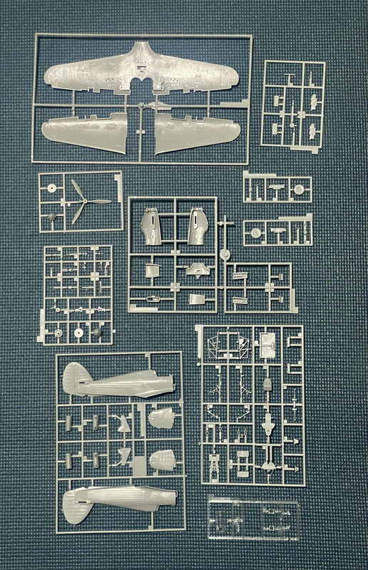

Morning all,
Here's the obligatory sprue shot (the wings are being shy), I'm sure this one will have been aired many times on these pages by now.
I did a bit of snipping and trimming last night to get started. I had thought to go with some prepainted etch for the cockpit but there is no open canopy option so it won't be that visible and the moulding is pretty well detailed as is, I'll just have to knock up some seatbelts. In fact I was in danger of getting click-happy with the aftermarket, at one point my basket on Hannants added up to more than three times what I paid for the kit which is just a bit silly, and that's not even including an Eduard canopy mask which I'm unable to find anywhere, in this country at least (they have the plastic Montex type but I'm not a fan of those). It's likely that I'll go with aftermarket decals to address the issue of the "Hasegawa white", and I'll probably pick up some resin 5-spoke wheels and exhaust stacks. I've found what I'm pretty sure is a Spitfire De Havilland spinner in the spares box.

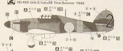

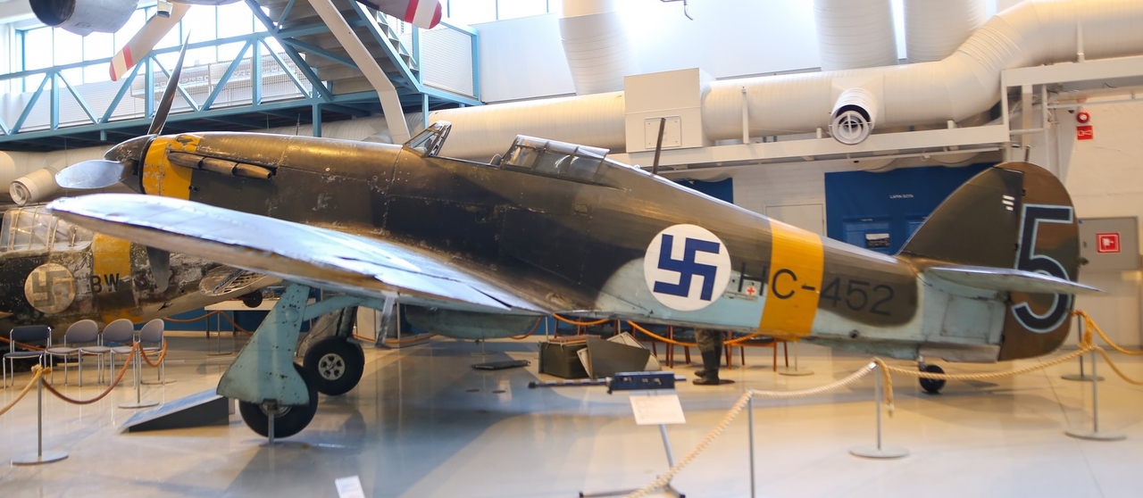

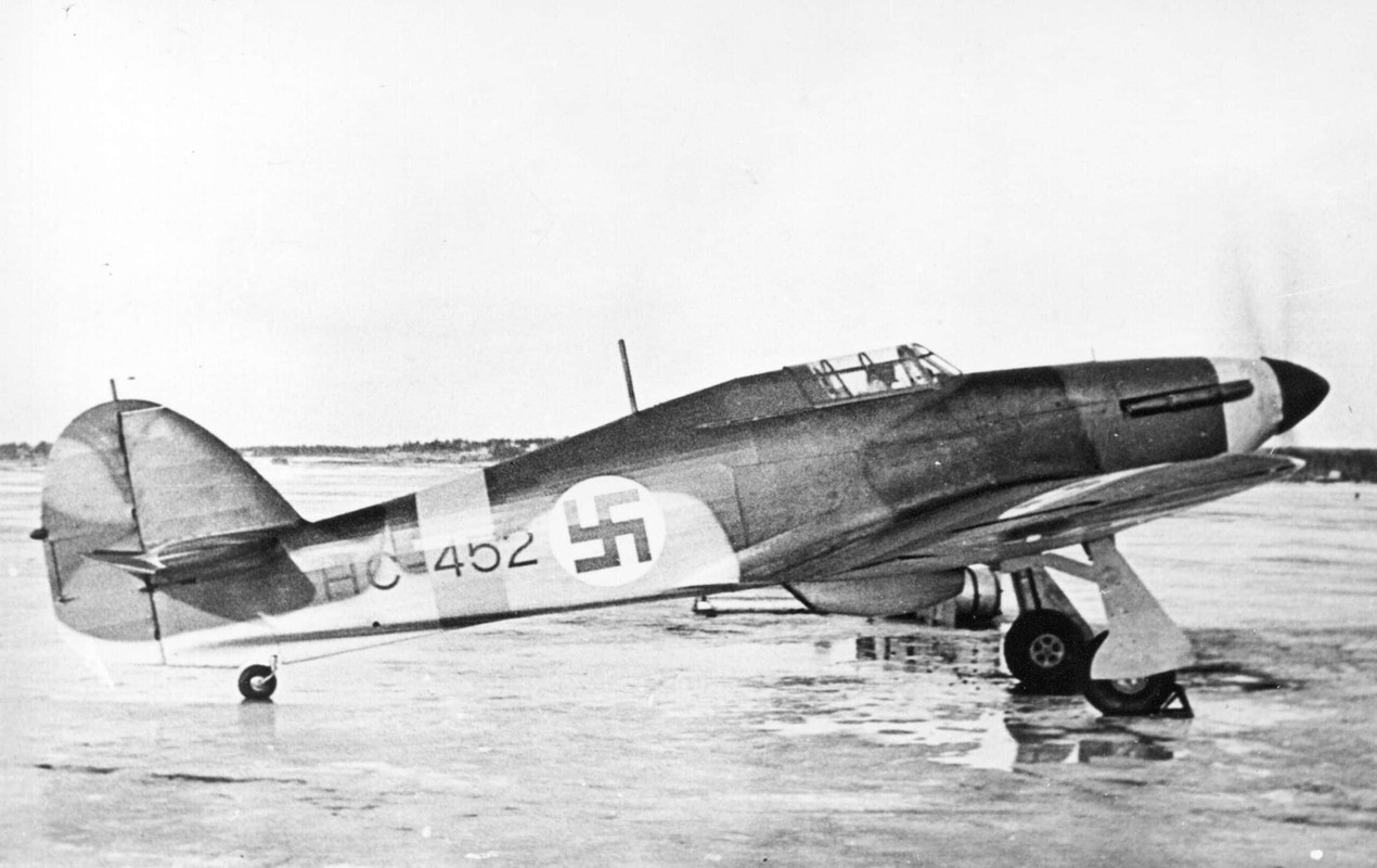

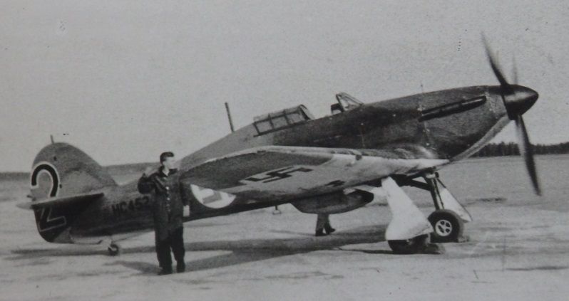

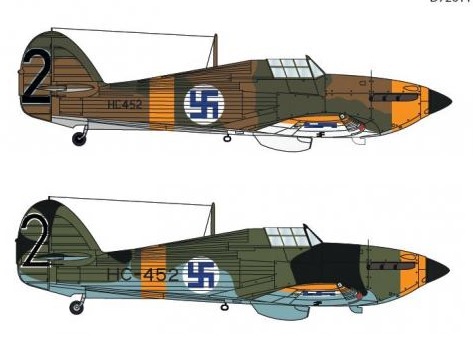

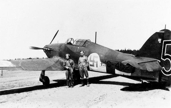

I've settled on the airframe I'm going to build, which carries serial number HC-452, "black 2". A metal-winged Hurri, HC-452 was one of a dozen purchased by Finland (some with metal wings, some with fabric) in February 1940, of which 10 made it as far as Finland. They weren't terribly successful, chalking up a total of 5½ kills between them (of which 2½ went to HC-452 with Lentolaivue 26, 30, 32) before they all fell out of service, as much for lack of replacement parts as combat. HC-452 was the regular mount of Pilot Officer Esko Ruotsila.
First up, praise be! The old girl is still with us, and in fine shape! Here she is at the Finnish Air Force Museum in Tikkakoski, now bearing the number "black 5" on a noticeably contrasting rudder, more on that in a minute:
There is an excellent high-definition walkaround here that will be enormously helpful from the point of view of accuracy (there are some bits that will need fettling off the wings and nose, for one thing.)
I will be using SBS's decal sheet as I don't fancy the Hasegawa originals. The Hase instructions show this airframe like this:
The callouts say that it can be painted either in the standard RAF dark green/dark earth over sky scheme, or in the Finnish olive green/black over blue camouflage the airframe was repainted in. There's a certain amount of hedging of bets here as with that style of the number two (square at the bottom left hand corner rather than pointy) and the small serial number it would have still been in RAF livery (which in any case didn't feature sky on this kite - see below) ; also the number two would have had a light blue border, not white, which isn't catered for by the Hase decal sheet. The kit's box art (and the other decal scheme) depicts HC-451 which I believe was a fabric-winged Hurri, therefore as I understand it not buildable from this kit.
I'm going to be using SBS's decal sheet, which presents HC-452 in two guises, of which I'll be going for the lower one:
Note the different style of the two number 2's, and the light blue outline on the upper one.

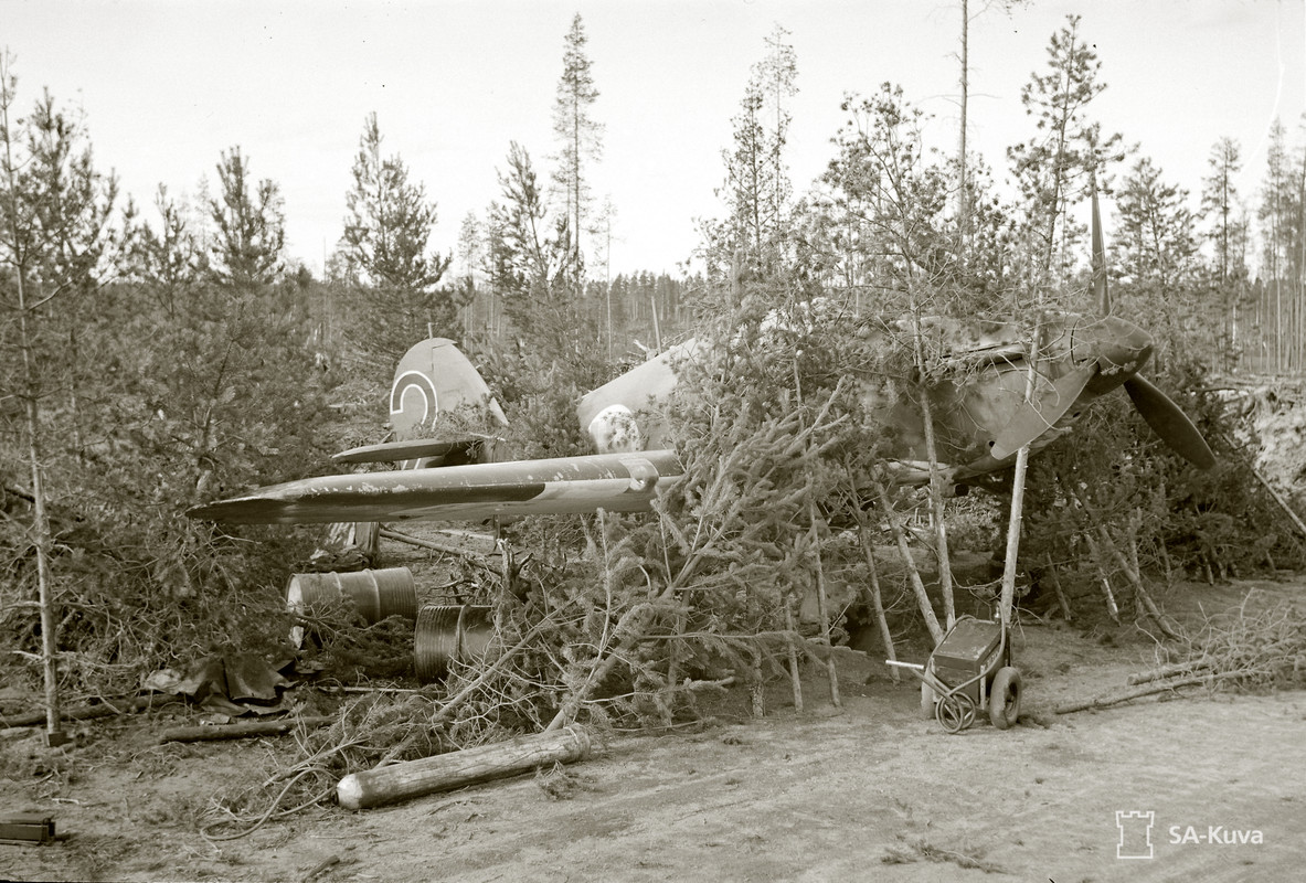

Here's a potted history of HC-452's paint jobs:
She was delivered in the standard RAF scheme of the time, dark green/dark earth over aluminium dope underside with the wings in one half black the other white. In Finland it was painted up with its number 2 and a small black serial number (initially HU452, later HC452), as well as at some point yellow underside wingtips and fuselage band (probably at some point after the application of the s/n's - see pic below of HU460, one of our girl's siblings).
This is HU452 also, I'd put money on this being when she arrived in Finland after being ferried from Britain - no Finnish national insignia (possibly redacted photo?) or yellow markings at all, and she looks pretty shiny and new. A picture of HU453 in similar format also exists.
The yellow nose appears to have come later still.
At some point she was repainted with the Finnish scheme of olive green/black over blue, and given a larger serial number, HC-452, now with the "-". There is a picture without the "2" which I feel was taken immediately after the repaint - she certainly looks very smart:
And here with the number 2 added in the new pointier style with white outline:
Unfortunately she had a mishap: (EDIT: I've just realised that this may be a camouflaged Hurricane, rather than a crashed one! :facepalm:)
At some point she was given a replacement rudder cannibalised from another airframe, HC-455, which retained its RAF colours and the light-blue border to its number 5:
And that's how we find her today! She made her last flight on 26th July 1943, having logged 208 flying hours, the most of any Hurricane in Finnish service.
Yellow was the Axis eastern front theatre marking, so after June 1941, which is what the Finns call the continuation war, after the 39/40 winter war.

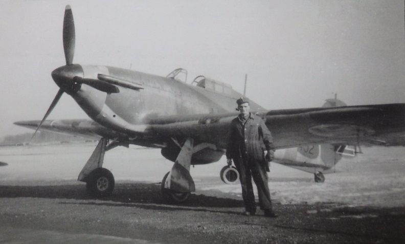

the Hakristi were covered for delivery.
the Finnish colours or warpaint = sotamaalaus  [sota = war,  maalaus = paint]
Done when overhauled at Tampere,  from the photo winter 41/42?
colours?
The black is black, Olive Green is similar to MAP Slate Grey, maybe a touch greener, the Light Blue is  Vaaleen sininen DN-vari,  which is RLM 65, the Finns got German paint for Do-17 and Ju-88

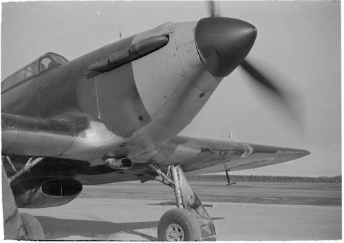

I did a bit of priming last night which certainly doesn't merit photography, but my mind is turning to what colours to paint the cockpit. With the actual aircraft still in existence (I'm still pinching myself) I'm blessed with a primary source. Apart from the video walkaround mentioned above (which doesn't get over the barrier rope I think) there is this splendid walkaround on these very pages, including some fantastic photos of the office, e.g.:
and

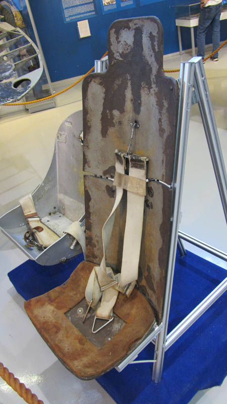

Of immediate interest is the pilot's seat, which doesn't look much like any other Hurricane pilot's seat I've seen, or anything like the one in the kit for that matter. Here's a pic of a seat I presume from another Finnish Hurricane, next to a standard Hurricane seat (? - I wonder where that one came from?)
The whole extended back appears to be armour plating. I think in the photos above there is also additional armour plating behind the pilot's head in HC-452? Being painted in standard interior green this was surely factory fitted, I wonder if all this was specified by the Finns, or by the Poles - this airframe was originally intended to be shipped to Poland in September 1939, but the German invasion put paid to that so off she went to Finland instead. Anyway, little bit of scratch building to keep me entertained.
There's also a great pic of the emergency hatch on the starboard side of the fuselage, clearly showing HC-452's original serial number, N2394:
