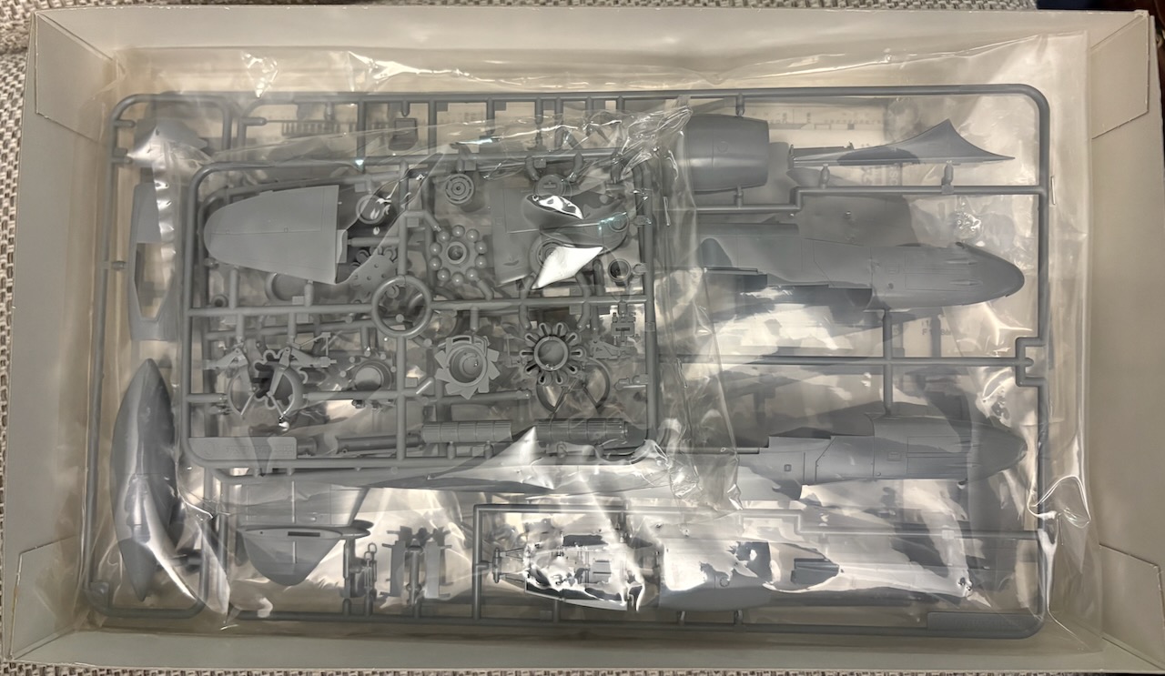

Jari Lehtonen Posted September 16 Posted September 16 (edited) Hi All, for my full build in this Group Build I'm offering a Tamiya release from 2002, the Gloster Meteor F.3 (61083). I'm planning on building it as EE239 from 616th Squadron RAF, stationed in Melsbroek, Belgium in early 1945. This is the box: I bought this from Ebay a year ago thinking that if the "Dawn of the Jet Age" GB gets through, I'll build this and probably a Me262; that plan fell through but this model fits in here as well. All the plastic is still in bags: I hope I can make a start on this tomorrow /Jari Edited October 7 by Jari Lehtonen Marked finished. 14

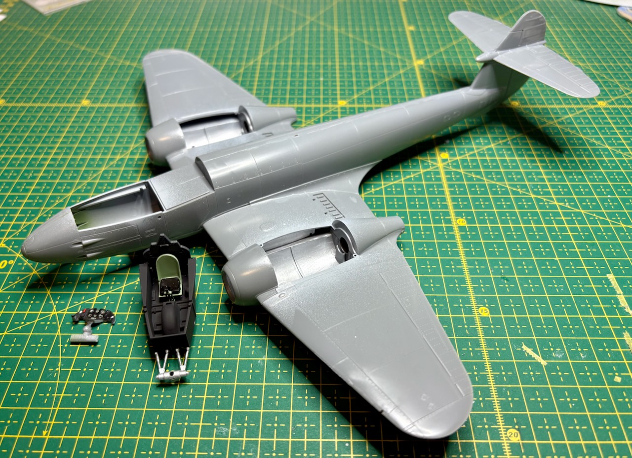

Jari Lehtonen Posted September 20 Author Posted September 20 Some progress during the week on the airframe and cockpit, and now I have a Meteor-shaped thing on the cutting mat: The cockpit needs some weathering, and I'm thinking of painting the seat leather brown, think that might look nicer and maybe (?) even be more correct. Tamiya instructions say it should be semi-gloss black. @Col., thanks for the comment on air brakes. I think I'll leave them in, like @Rod The Fixer and @Alex Gordon did on their builds, visible but closed. /Jari 11
Col. Posted September 20 Posted September 20 It all looks to have gone together well Jari. Nice progress. For the seat I think black or green are the most likely options and I've seen photos of the control column in green as well. Probably worth a search for images but taking care that it's a Mk.III you're viewing rather than the more common later marks. 1

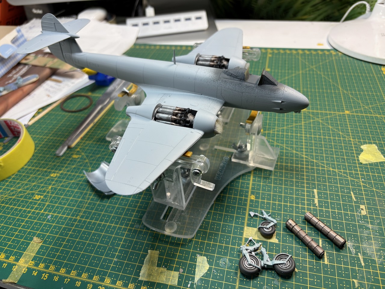

Jari Lehtonen Posted September 28 Author Posted September 28 A little over a week has passed, and I've been mostly fixing small assemblies, engines and landing gear. These are now ready and will be put aside while I paint the model. Primer has already been done, and the first white layer will probably happen today. I decided to leave the seat like it was, black, and just weathered the cockpit lightly, and gave it a matt coat. No pictures of that right now. The engines are have just been put in place, not glued in yet. /Jari 11 1

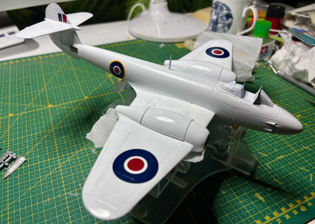

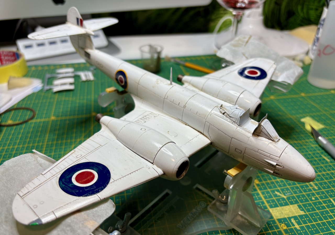

Jari Lehtonen Posted October 1 Author Posted October 1 (edited) Onwards: decals have been placed. Thankfully not that many, since they were quite brittle and tended to break. Looking pretty good in its white, I think. Building this model I've come to really like the way Meteor looks. Clean lines, not many sharp edges or bulges. Not as brutal looking as the Me232 Me262. /Jari Edited October 6 by Jari Lehtonen Corrected Me232 to Me262. 11
Col. Posted October 2 Posted October 2 You've done good work with those decals Jari. Did you use any particular technique on them? 1

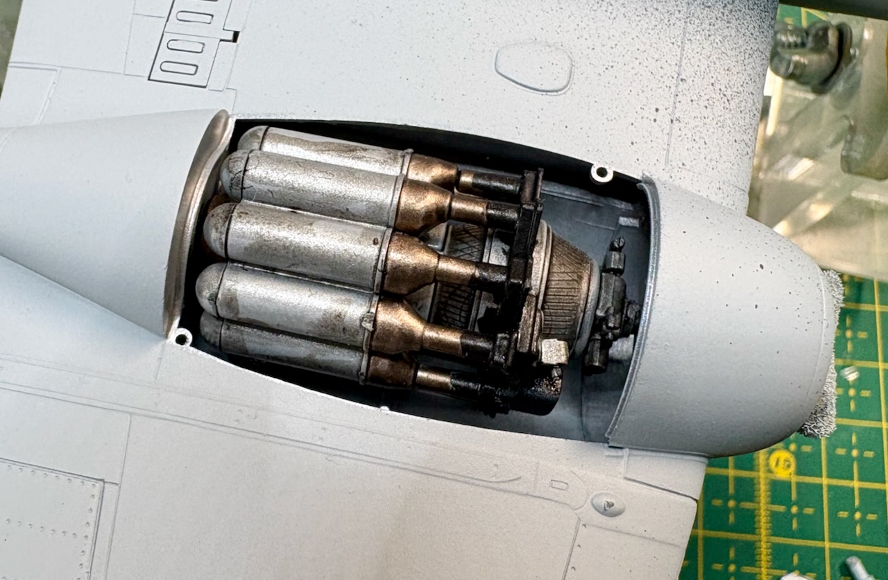

Jari Lehtonen Posted October 3 Author Posted October 3 On 02/10/2025 at 09:11, Col. said: Did you use any particular technique on them? Just very hot water (warmed with a tea candle) and some Tamiya Decal Adhesive. Oh, and the surface had been sprayed with Vallejo Gloss varnish beforehand. I read somewhere that Micro Sol and Micro Set don't really work on Tamiya decals so I went with Tamiya liquid. Today I had some time and gave the plane a wash with Flory Grime. What can I say, it's really dirty now: I may have to do some more cleanup tomorrow. I finally glued the engines and exhaust pipes in, too, and painted the wingtip lights. What is still missing is the pitot tube, landing gear and landing gear doors. I might be able to finish this during the weekend, depending on how much I want to still clean the grime off it... /Jari 10

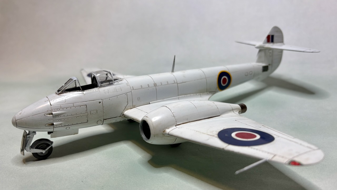

Jari Lehtonen Posted October 7 Author Posted October 7 Hi all, during the weekend I gave the Meteor a satin coat to get a nice finish, and today I fixed the landing gear and bay doors in place. The fit, as previously in this kit, was excellent and the landing gear attachment points well designed, things basically clicked in place. With that, I'm calling this done. The engine covers are not glued in, I still might decide to use the clear parts instead. Like @Alex Gordon mentioned, the supplied noseweight is not enough and this plane was a tail-sitter when first set on its wheels. I had to glue some lead pellets into front wheel bay to fix this but with the nose wheel being not retractable in this model it hardly matters. Much thanks to our hosts @Colin W, @Mjwomack and @Col., as well as to all who took an interest in the build! Final pictures will be in the gallery tomorrow latest. /Jari 8 2 3
