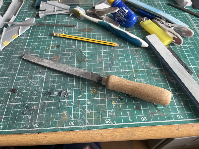

JamesP Posted August 17 Author Posted August 17 2 hours ago, marvinneko said: Another fan of metal files Indeed, I still use the set of needle files I bought in 1990, and only recently added a few additions when some English files came up for auction. The big #2 b*st*rd I've been using for the last few years and soon quells any unruly kit. 1 1
