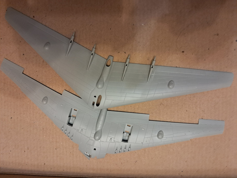

Dragon's surface quality is superb even though some gaps will need attention later on. Some photos have parts in a box so that all are accounted for (1/200 scale means tiny parts).
Engines are not vanilla issue - test fit went swimmingly and then promptly was supported by good amounts of extrathin and then CA where needed.

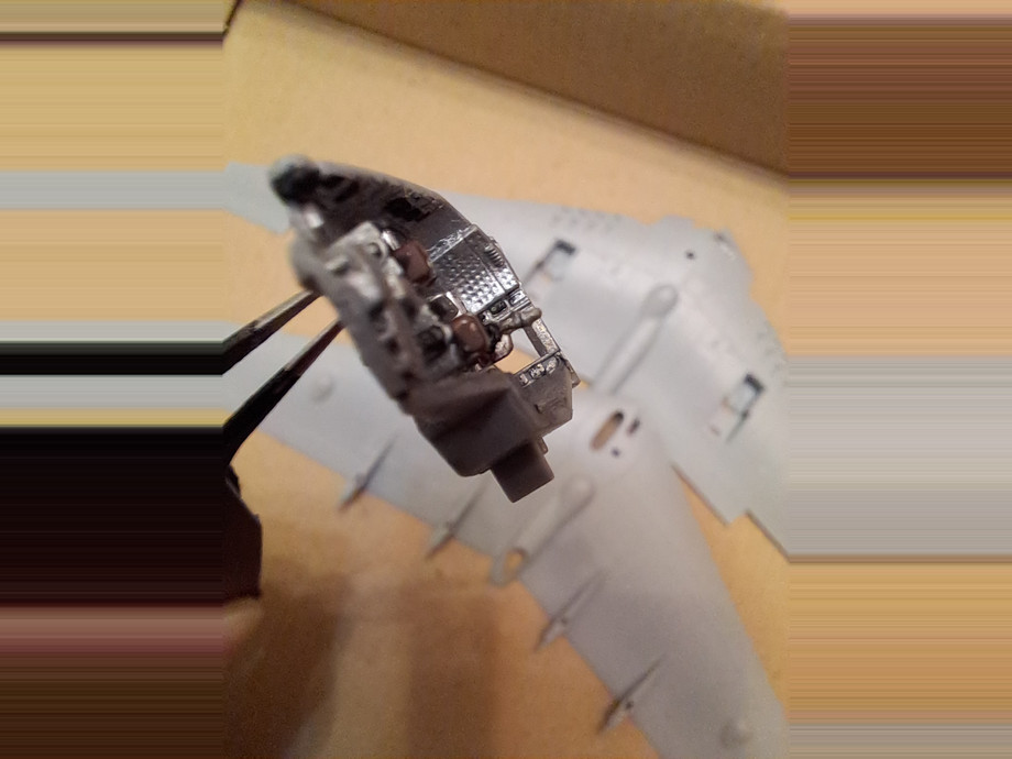

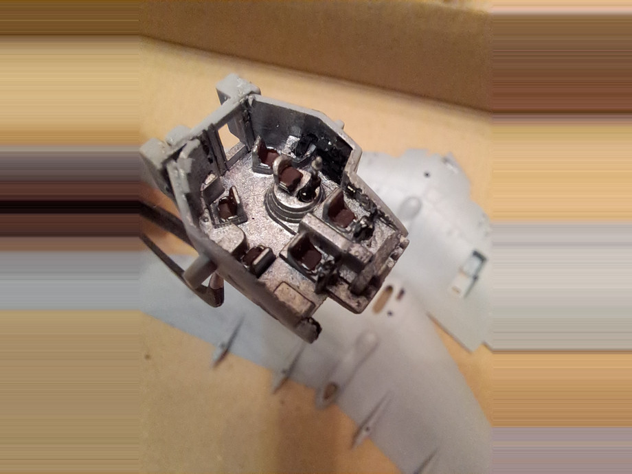

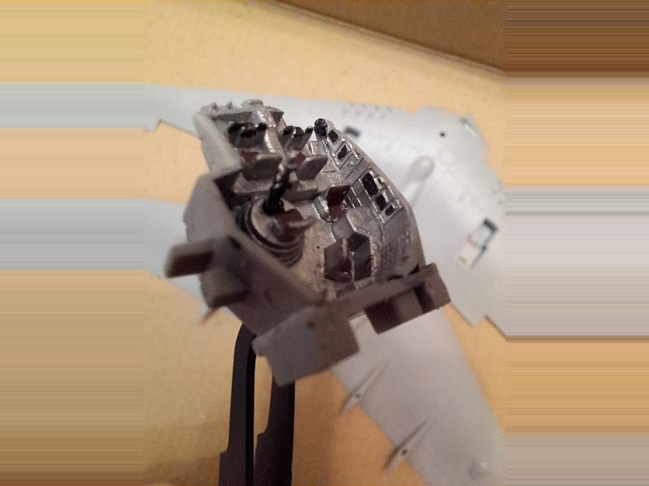

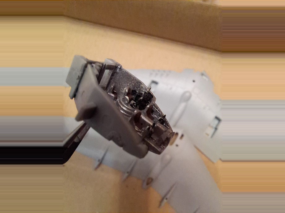

Control centre, parts most of which are not going to be seen at all. For size reference it's all held with tweezers.

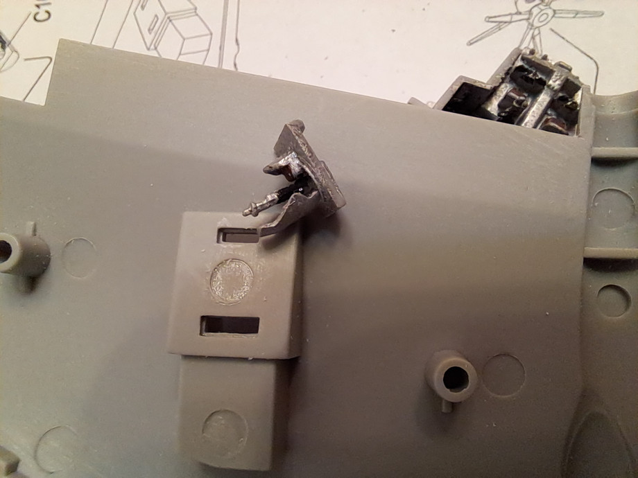

And this is rear crew compartment placed near where its place of residence is gonna be. Length - 8mm.

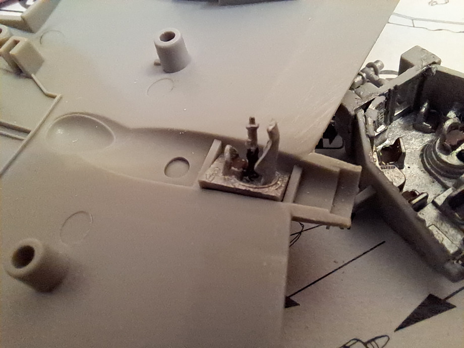

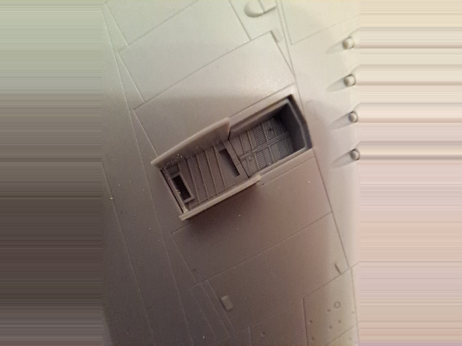

Landing gear compartment, tweaked its surface a bit so it'll fit easier.

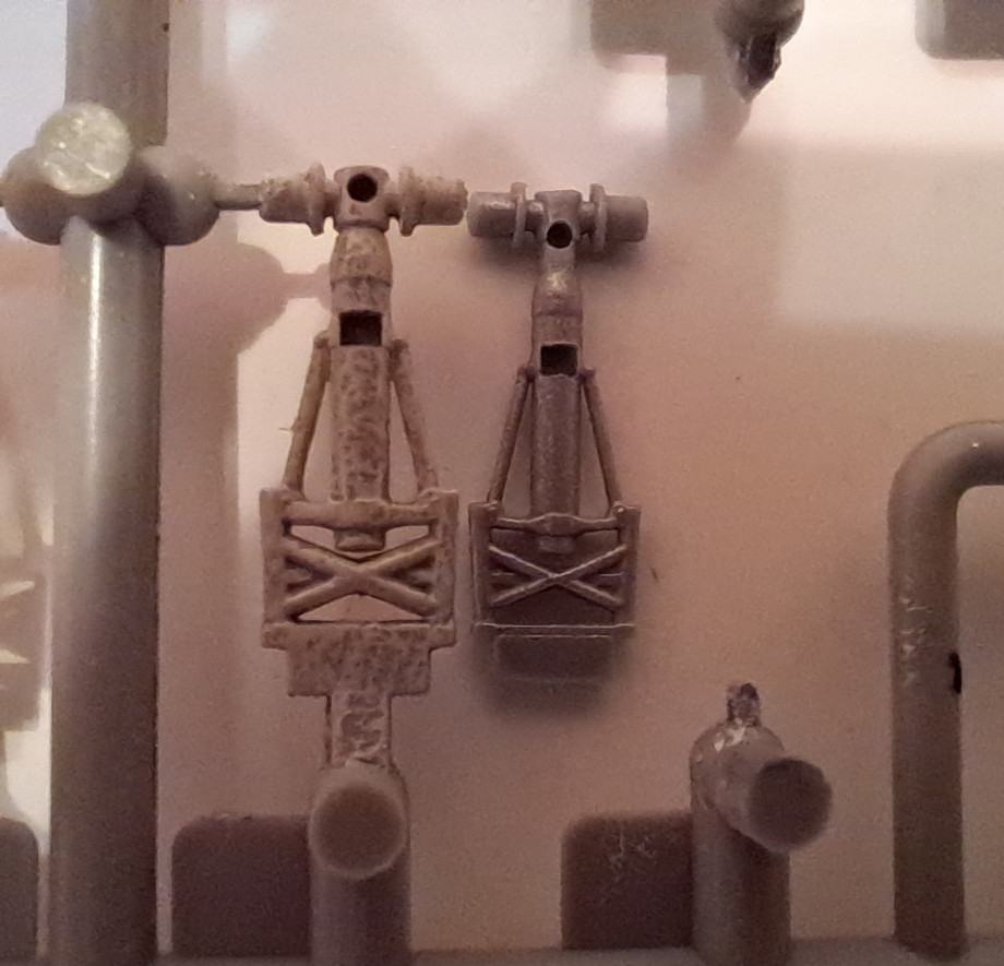

Continuing build and noticed two things: tiny B1 parts are not listed anywhere on instructions but they should go on the underside of the wings (4 holes per wing on leading edge) and landing gear parts are almost but not quite identical with no explanation of which is what so to speak. Parts C30 (on sprue) and C6 are supposedly interchangeable, with only two differences being that C6 is taller by 1mm and has different relative hole location (needed for other parts of an assembly). Assuming one is for XB and the other for YB? Which is for what version if this is critical at all?
(Macro photo + different paint)

I don't think they are for different versions. My best guess is that they are for a plane flying with gear extended (long version) and taxiing on the ground (short version, because of load on the gear).  Not sure if one would notice any difference.

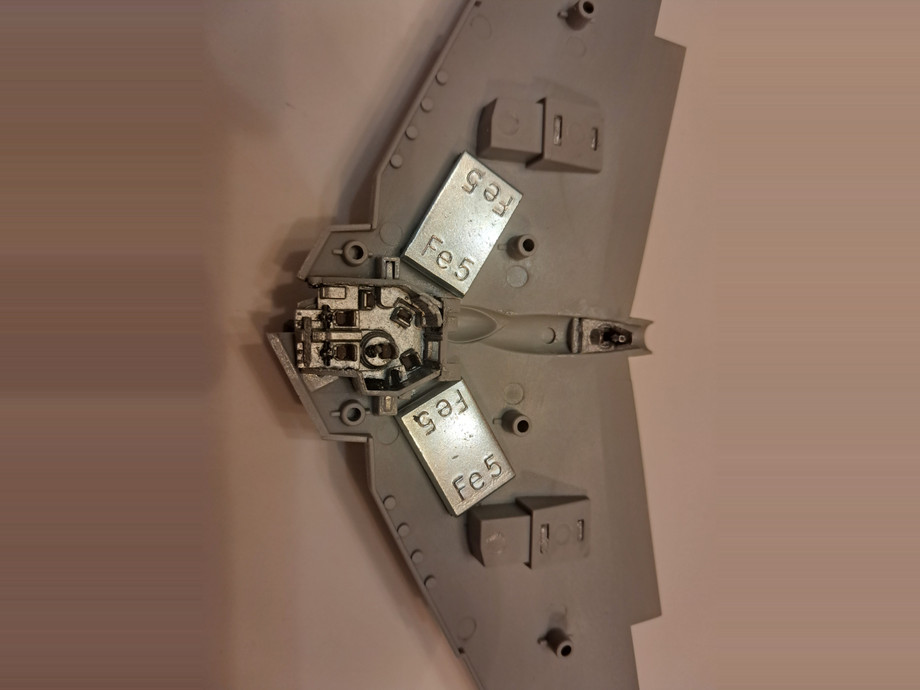

I have read in a German review of the kit that the model will need weight in the nose, but that this is not mentioned in the instructions. So be warned!😊

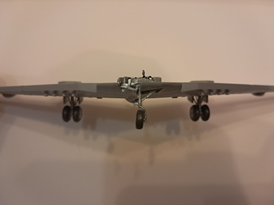

Indeed it does, otherwise despite it looking like a well-balanced model, it turns into fully qualified tailsitter.  Plopped two 5g weights for good measure.
Not like nose gear inspires confidence to be honest, but so far flimsiness is proportional to scale.

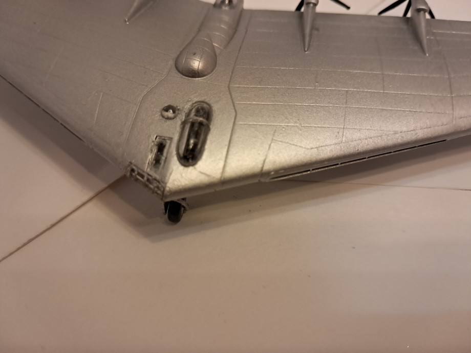

View of stuff in cockpit is predictably awful, so guess what the solution is? Doublesided tape. Whole thing is glued shut by the means of strategically applied pieces of tape.
Now the question is whether to apply decals? Honestly, I'd skip that or put on only insignia + serial/service number if anything at all. Partially this is because any sane instructions are to be found approximately nowhere, Dragon CyberHobby decal sheet may or may not match up the actual model and I just sort of like this baremetal "fresh out of factory but we skipped polishing" look.
  • Like 6
Looks cool! I've built that kit too and it just barely stays upright. Good choice to put all that weight in. Such a cool plane!

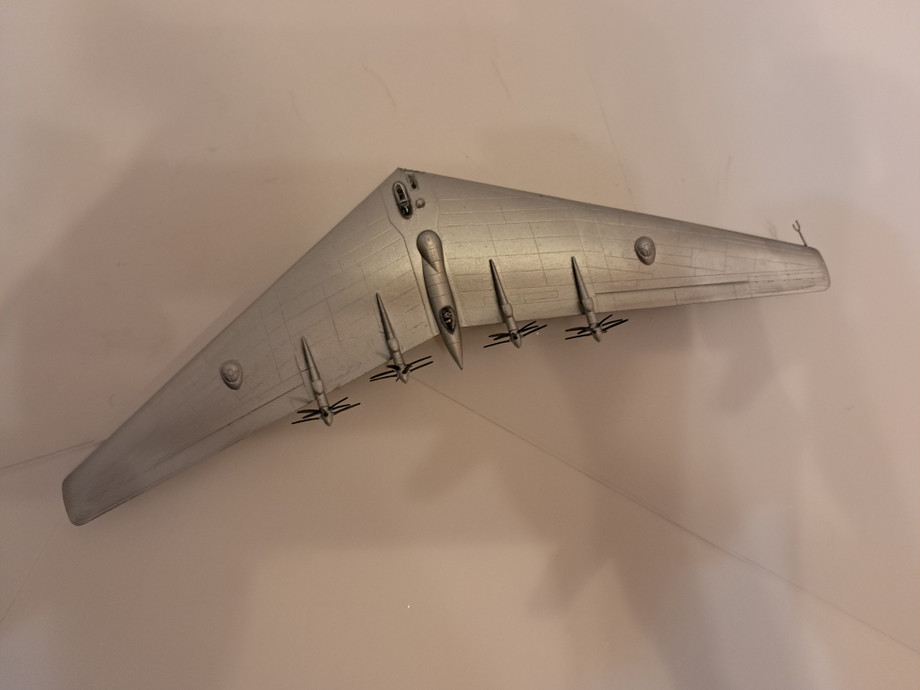

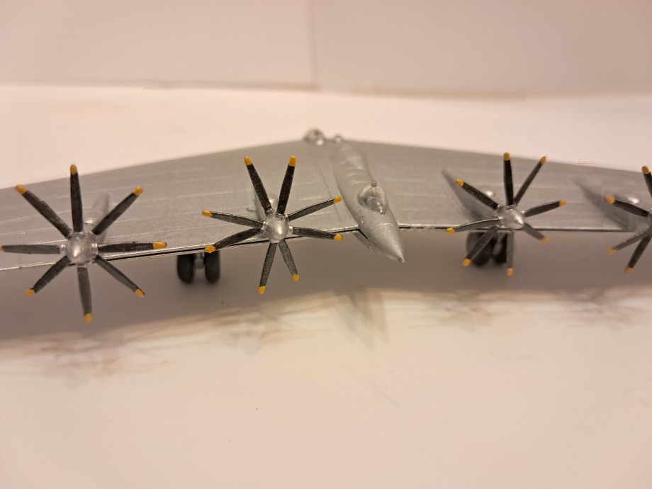

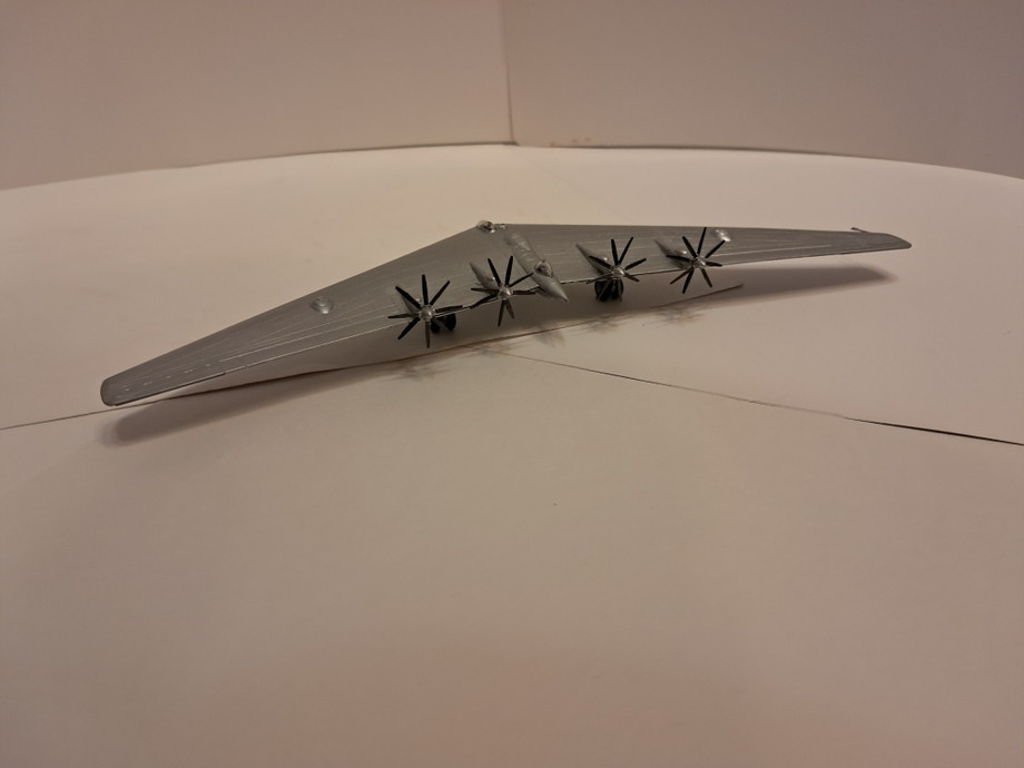

Posted (edited)

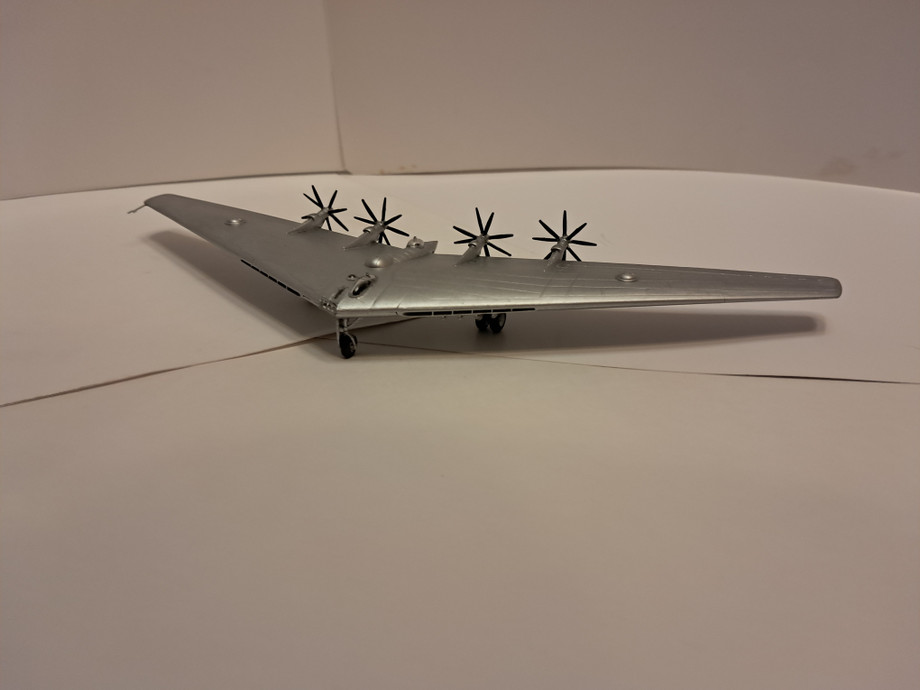

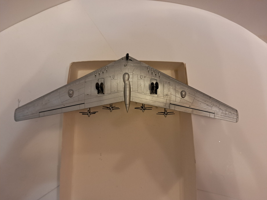

Done and done. Borrowed Italeri decaling instructions but applied only USA Airforce markings. Painted propeller blade tips yellow while at it.

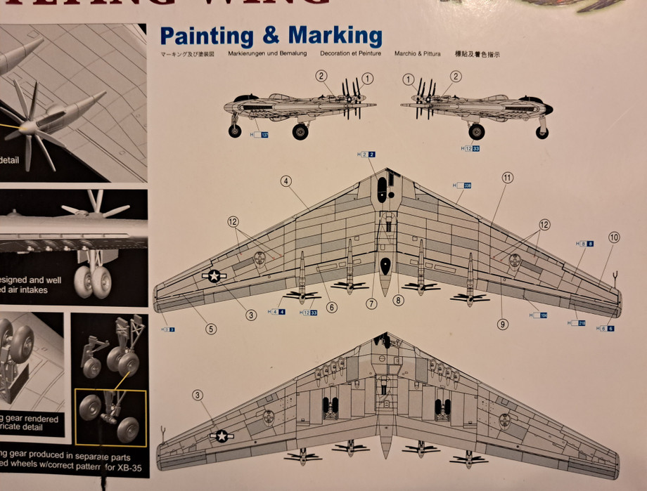

Update: you know where Dragon put coloring and marking instructions? On a box. The back side of it! Guess where I didn't look? That's right, the back of the box.
Applying them a bit later, need another setup for this decal size now.

Now it's done. Skipped serial number, gonna put wingtip "traffic lights" :D on it in a bit (they likely won't be visible -- two tiny dots of transparent green and red) but yeah, it's done for real this time.
