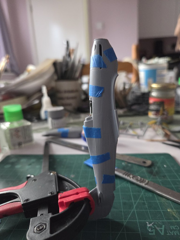

Beard Posted August 20 Author Posted August 20 12 hours ago, Wings unlevel said: The fuselage halves went together ok? They went together fairly well. I let the glue (Tamiya white label) act for a while then fiddled with the fit before applying the tape. We'll see how successful it was when I remove the tape later today or tomorrow. 1

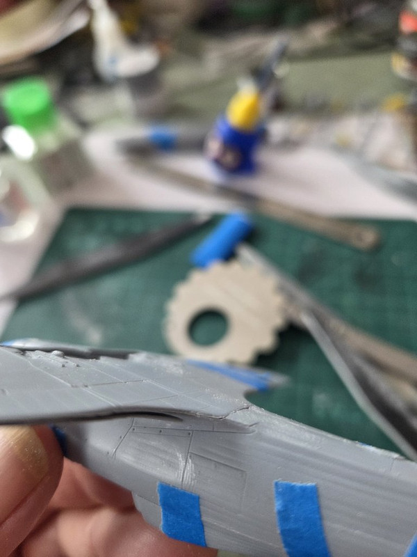

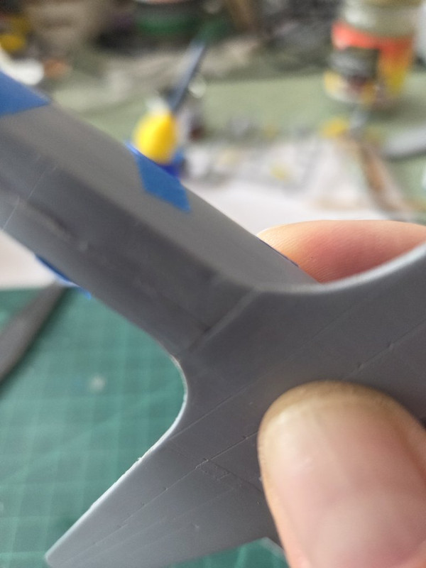

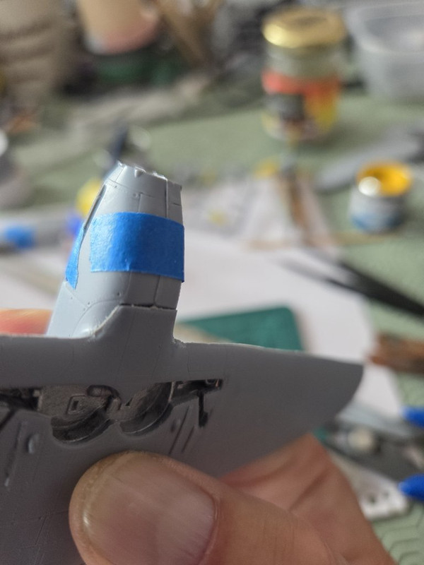

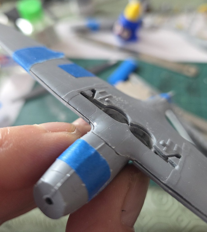

Beard Posted August 20 Author Posted August 20 (edited) While I wait for the glue on the fuselage halves to set, I've examined how the lower wing will fit. At the back: At the front: A little bit of sanding and scraping later... Nearly there. You'll notice the seam on the front lower cowling. I went for the best fit at the top. Thanks for looking. Edited August 20 by Beard to correct spelling 7

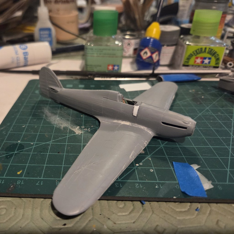

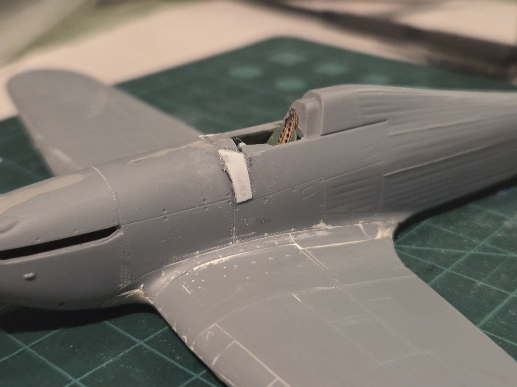

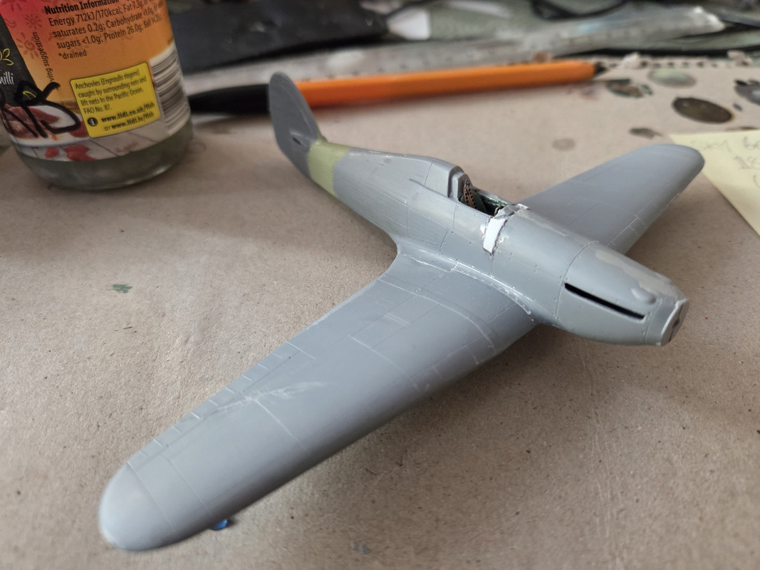

Beard Posted August 24 Author Posted August 24 On 20/08/2025 at 23:20, Wings unlevel said: That’s tidy up fine. Nothing too dire to fix. There was a fair amount of filling and sanding involved but it was nothing too dire. Here it is now... The white bits by the cockpit are my attempt to replicate the added armour. Thanks for looking. 8
Wings unlevel Posted August 24 Posted August 24 1 hour ago, Beard said: There was a fair amount of filling and sanding involved but it was nothing too dire. Here it is now... Very effectively done. Oddly, I don’t mind filling and sanding, it can be quite relaxing… 1 hour ago, Beard said: The white bits by the cockpit are my attempt to replicate the added armour. Neat. 1 1

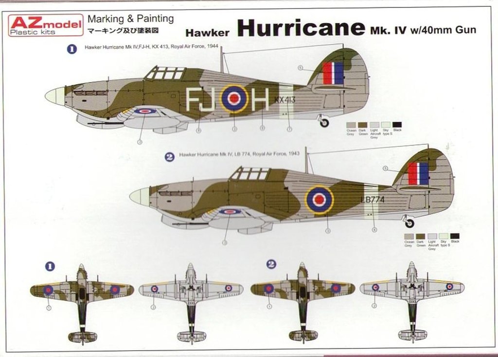

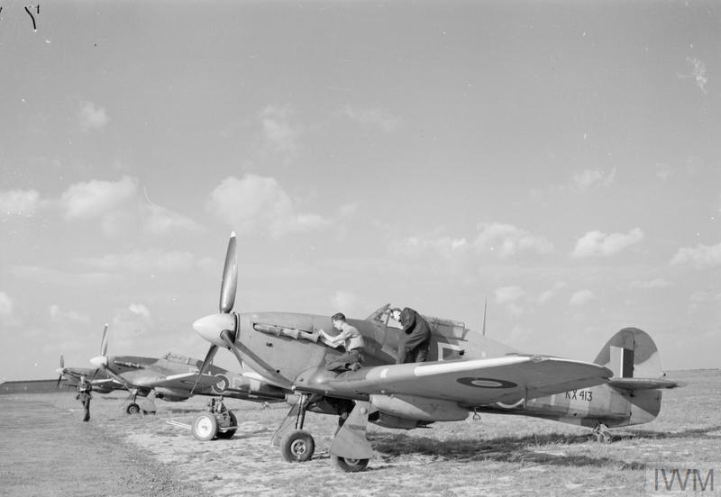

Beard Posted August 25 Author Posted August 25 It's time to think of the markings and I'm going for KX413 which, according to some, was a MkIID but this: http://www.airhistory.org.uk/Hurricane/p055.html has it as a MkIV. AZ have it with a tropical filter but this... (From here: https://www.iwm.org.uk/collections/item/object/205126962) shows no tropical filter. Anyway, all I need to do now is work out where the Vickers S guns go. 3
Wings unlevel Posted August 25 Posted August 25 2 hours ago, Beard said: shows no tropical filter Clearly! That’s a lovely reference shot, too. 1
Troy Smith Posted August 25 Posted August 25 3 hours ago, Beard said: all I need to do now is work out where the Vickers S guns go. HurricaneIIdwingpanels1-24th by losethekibble, on Flickr mg303HurricaneMkIID_zps4445b05c by losethekibble, on Flickr this shows the ammo drum in wing, Hurricane 6 sq leading edge stripe 1 by losethekibble, on Flickr Mk.IV KX829 hanging up In Birmingham you can see the hatches over the ammo drum recess, as well as the gun mounts and various other details Hawker Hurricane - P3395 Think Tank 036 by touluru, on Flickr there are a load more here https://www.flickr.com/photos/131561068@N08/albums/72157657887849931/with/24294439428 3 hours ago, Beard said: shows no tropical filter. shows no carb intake full stop. as mentioned in the manual 2024-02-03_01-01-08 by losethekibble, on Flickr 3 hours ago, Beard said: according to some, was a MkIID but this: http://www.airhistory.org.uk/Hurricane/p055.html has it as a MkIV. Correct. There were very few IID used operationally in the UK, and those that were flew with 184 Sq. Note FJ-G in the background has reversed upper colours other points, possibly yellow doped gun port patch, possibly Sky. Medium Sea Grey inside UC doors and gear legs, and AFAIK, the inside of the wheel wells too. HTH 5 1

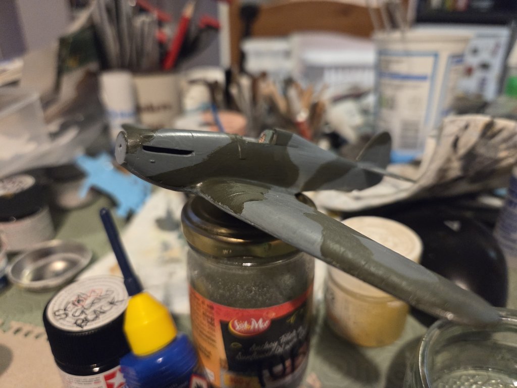

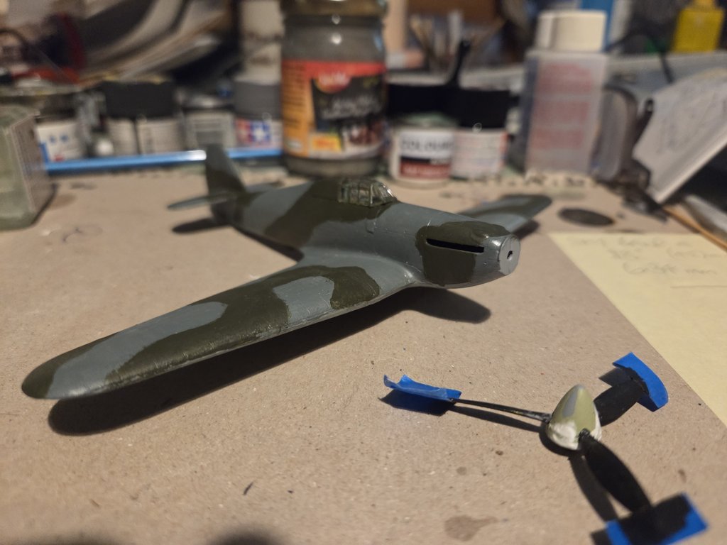

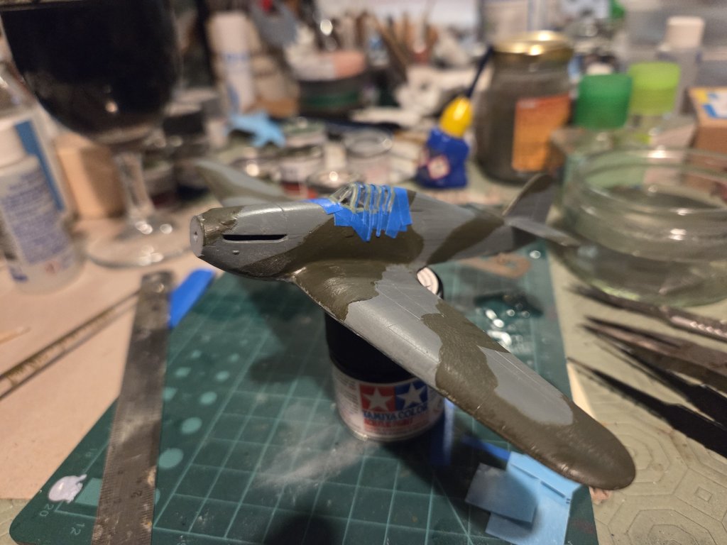

Beard Posted September 22 Author Posted September 22 Despite life getting in the way I've been slowly working on this one. Painted the camouflage, although it needs some touching-up (but dont we all)... Painted the canopy... Here's where she is, as of last night... Thanks for looking. 7
Wings unlevel Posted September 22 Posted September 22 1 hour ago, Beard said: Despite life getting in the way It has an unfortunate habit of doing that! But glad you e been making process, as it looks great under paint! 1 1

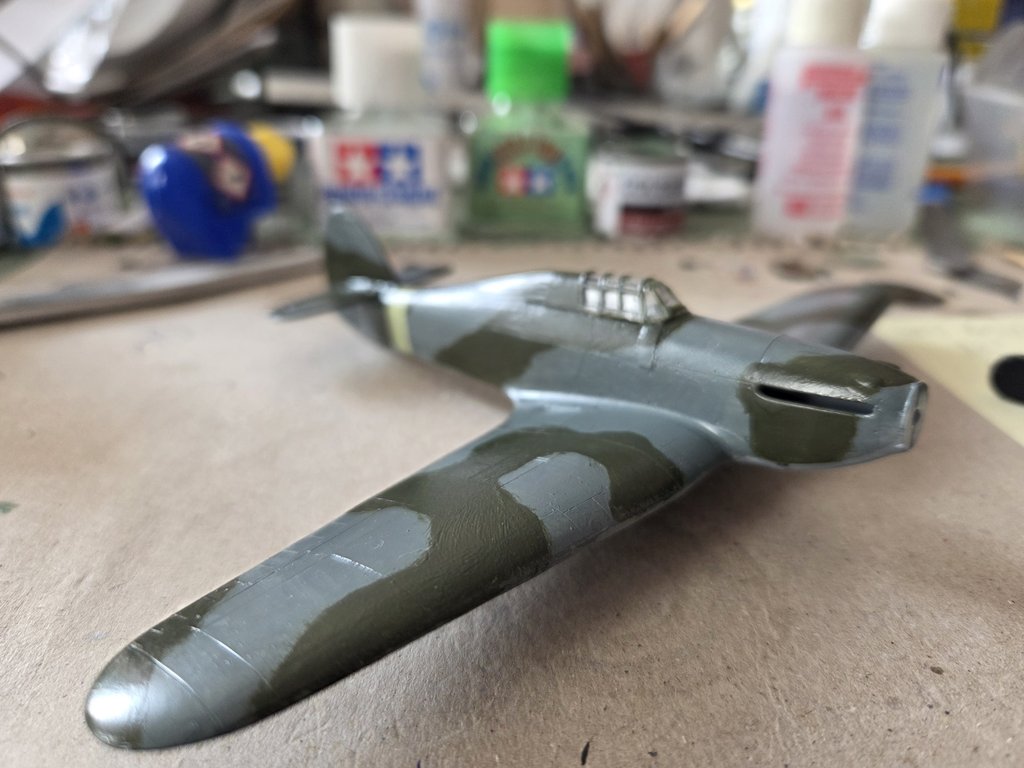

Beard Posted September 24 Author Posted September 24 Gloss coated and ready for the decals... I think I'll be using some spares for the codes... Thanks for looking. 8
Rabbit Leader Posted September 24 Posted September 24 Nice to see this one coming along quite well too @Beard. The decals will soon elevate it to ‘eye candy’ status! Cheers.. Dave 1
Beard Posted September 25 Author Posted September 25 9 hours ago, Wings unlevel said: Looks like a lovely gloss coat. Thanks but don't zoom in... it covers average (at best) painting. 7 hours ago, Rabbit Leader said: Nice to see this one coning along quite well too @Beard. The decals will soon elevate it to ‘eye candy’ status! Cheers.. Dave It's coming along, the guns need to be assembled and stuck on. 3

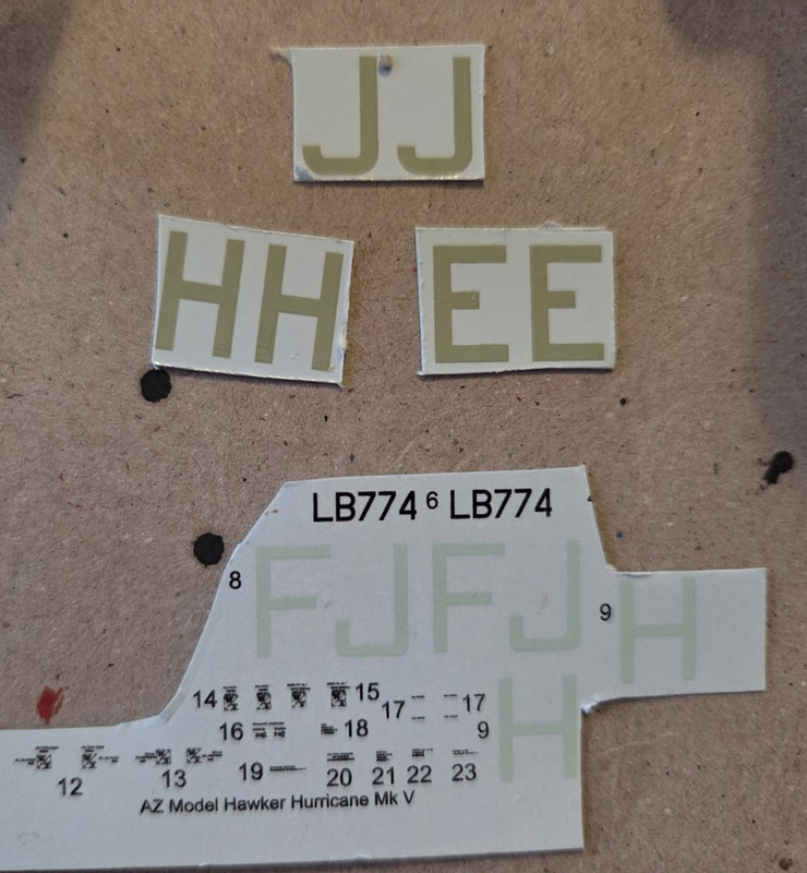

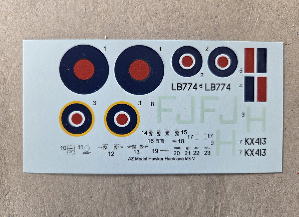

Beard Posted September 30 Author Posted September 30 I've run into a bit of a problem with the decals. I don't think the supplied codes are the what anyone would call 'Sky'. The problem I have is that the Sky codes I have are not the right shape, they're too thick. I'm off to have a trawl of the Internet and see if there's anything more suitable. Thanks for looking and opinions are welcome. 1 1
Troy Smith Posted September 30 Posted September 30 1 hour ago, Beard said: and opinions are welcome. Hmm. Sky, despite what many model paints and decals show, is a pale yellowy green. The kit ones look better than the AM ones, which look brownish.. The kit codes don't look too bad. Try painting a bit of plastic card with Colourcoats Sky, and then lay that over the decals. Bear in mind that the band and spinner were factory painted, and the letters were done at unit level, See https://www.britmodeller.com/forums/index.php?/topic/70201-tempest-ej693-medium-sea-grey-squadron-codes/ The band and codes are both Sky. I think in real life Sky needs very careful stirring to get all the pigment up from the bottom of the can... In short codes and and they don't need to match HTH 3 1
Beard Posted October 1 Author Posted October 1 Thanks @Troy Smith, that photo is very useful. I'll use the kit's codes (not that I could find any suitable aftermarket ones). 2

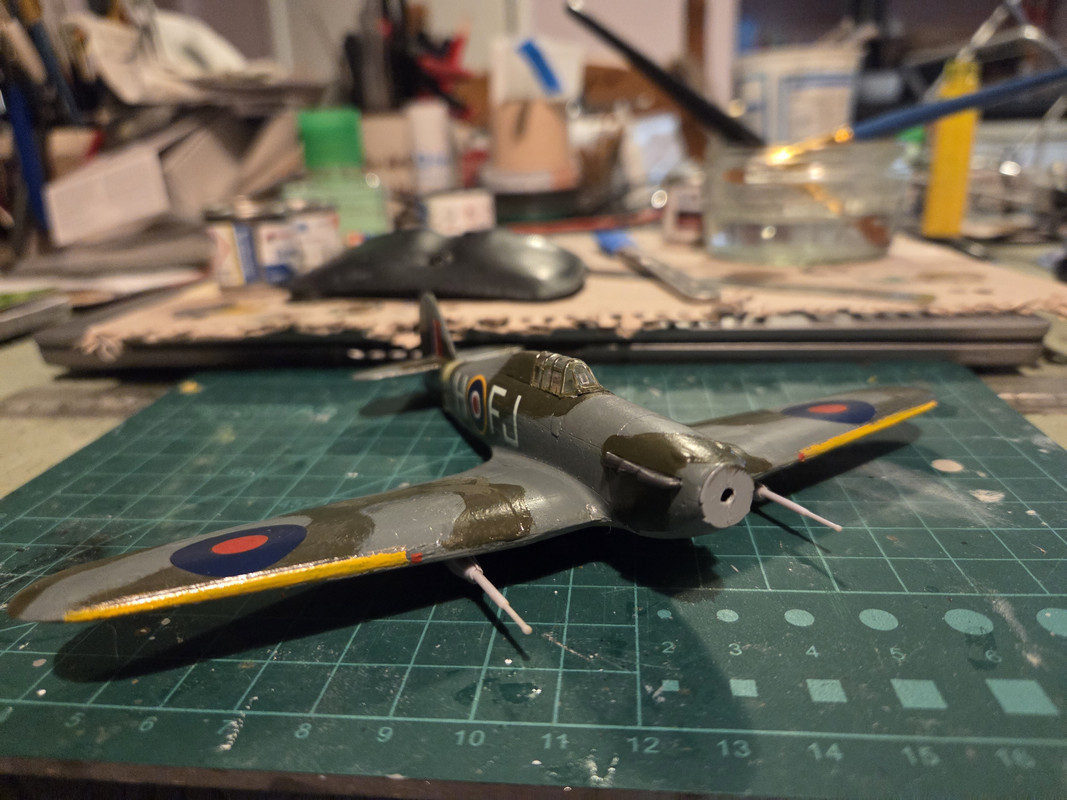

Beard Posted October 6 Author Posted October 6 Some progress, the decals are done and the big guns have been attached. Next step is to attach the undercarriage. Thanks for looking. 8
