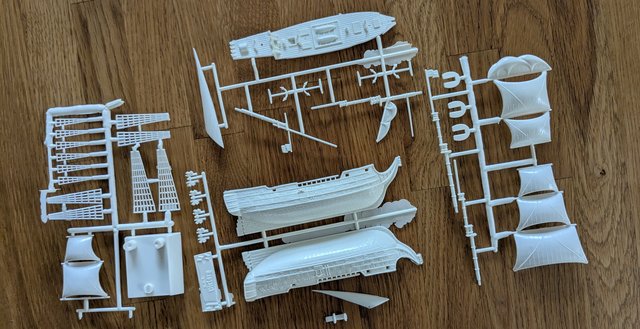

And instructions
Confident it's all there because the original polythene bag was.

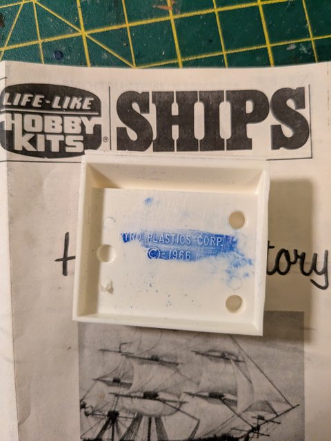

Nowadays, firms (in all sectors) seem in quite the hurry to delete the imprint of their predecessors, but Life Like were happy to acknowledge Pyro's part in this...
Or maybe they were disowning it from the 'Get-Go'! And yes, this does mean that I've glued the two parts of the display stand (and that's progress).

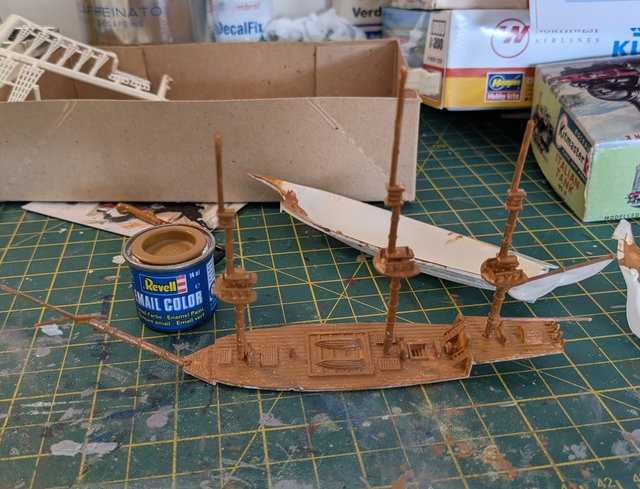

Two shades of teak brown used to try and give some texture and relief.

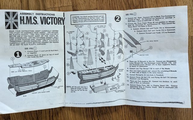

There aren't many parts to this kit so the instructions are optional, actually they're a hindrance because they'd have you cement the hull before inserting the deck, except that test runs have shown that the curvature of the hull is so severe that this isn't possible. So yet again, cue Frank- "I did it my way"
  • Like 6

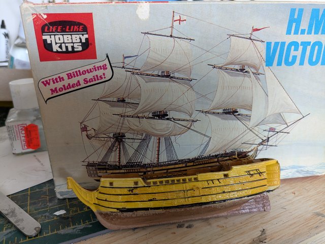

A dry fit in the dry dock
Main problem is the 'drunken sailor' angle of the bow-sprit- that's going to need a lot of attention.
The detail on the hull is very over-done, but that's the vintage of the kit and I'll not be toning it down.
  • Like 4

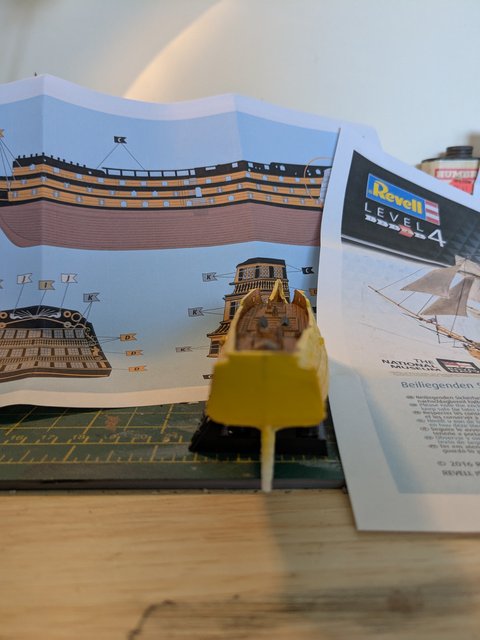

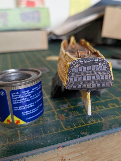

Having said that the detail on the hull sides was overdone, I work round to the stern and find... absolutely none just planking straight across! Good old Scalemates for the Revell paint guide from their instructions so I can see what's missing 😱, as for how to solve it😬
  • Like 4
Posted (edited)
MJ,
A trio of ideas…..
1.   Paint the stern a “glass” color- maybe off-white or light blue.   The print out that image of from the Revell sheet, and scale it to match the kit’s part size.  Then use it to cut some trapezoid shaped little masks from tape.  Put them in place and then airbrush the rest of the transom the hull color.  Use a pen or very fine brush to add some window frames.
2.  Paint the transom hull color, the cut little bits of lighter decal to apply represent the windows.  Do one row at a time, it will be easier to align them that way.
3.  Ignore the problem completely, and keep the model on the shelf in a way that the you can’t see the stern…
Edited by RC Boater Bill
“can’t see the stern”…
  • Thanks 1
Any mileage (nautical, of course), in just printing off the Revell image and gluing it on to the stern?  Maybe with some IT flexing of the image and touching up around the edges with black paint?
Memories of old Airfix IPs :).
Cheers
  • Thanks 1
  • Agree 1
@RC Boater Bill I am thinking along those lines. I often use light grey for cabin windows on small scale airliners so this is my probable approach.
option 3 is very tempting- this model will have a vey short 'shelf' life partly because we're meant to be moving house but also because I have no emotional attachment to it and it's just to make sure we had a maritime presence in this GB.
@CliffB Crumbs! Airifx black and white IPs, I'd forgotten all about those. Very innovative, or maybe I mean retro or old school. Seems appropriate for a Classics GB to have a modern twist on an old technique.
That gives me a plan B. I'll start trying the approach I'd been thinking of, now endorsed by Bill and have the IP method as backup- I could even sand the face smooth for better adhesion. Now to find the time to do it😱
  • Like 3
The more I played around, the more Plan B became attractive...
Effective and quite probably the most detailed part of the model!

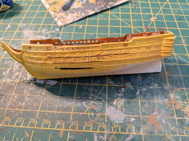

I hadn't thought of that, but I do have some rub-down black railway lining. Problem is I don't have enough and it's pretty degraded. What I'm going with is a Sharpie and no wine😱 (how we suffer for our hobbies), looks like this so far
The tricky bit is how to remove mistakes, scribing tool seems best without too much damage to the yellow base.
Alcohol (ipa for it, IPA for you!)

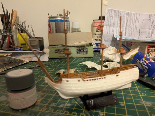

One side coming along nicely
I'll be doing the larger parts in anthracite- I know it should be matt, but the Sharpie has a slight sheen to it, so the anthracite will give a better match for this highly accurate😂 model. And I bet loads of them were full gloss back in the day..
  • Like 7
Good luck with the ‘black lining’! There are a few interesting articles on the colour schemes of the ships of that era - looks like there was an attempt by the Navy to standardise but adherence was patchy! Apparently, Nelson tried to introduce the yellow/black scheme so that if gun ports (on the yellow strips) were open then you got a chequer effect and your intention (to open fire?) was clear to anyone you were approaching. Anyway, we all recognise the Victory when we see it and feel privileged to receive maximum broadside! All the best, Mike.
  • Thanks 1
