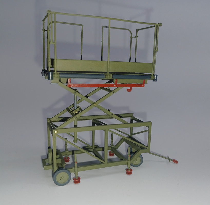

This is a Work In Progress and something I've been working on in the background for some time. The ubiquitous Safety Raiser, as they were commonly known. Found in hangars and servicing bays everywhere, especially where there were Wessex roaming in the wilds. Even when we were using them in the 80's they seemed antiquated.
I made one of these before, about 10 years ago back when I did my first Wessex build here on BM.
Yes, that's rolls of Kimwipe and a toolbag. There's even rolls of sacrificial tape and a pair of scissors.
Then, thanks to the goading of the BM unruly rabble, I even had to add some cans of MEK along with a 7UP & a Coke can. Those were the days.

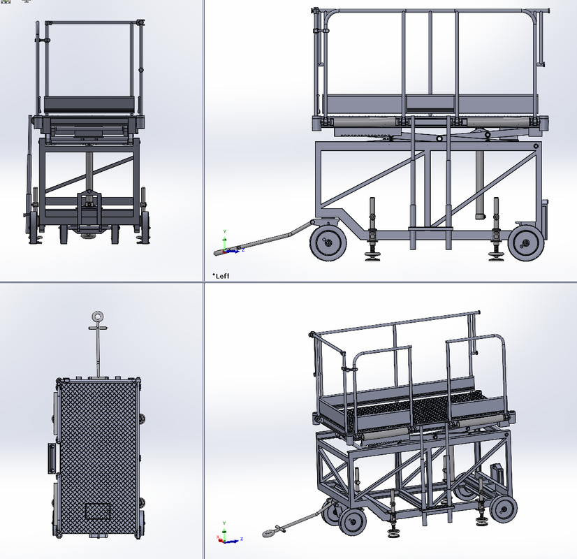

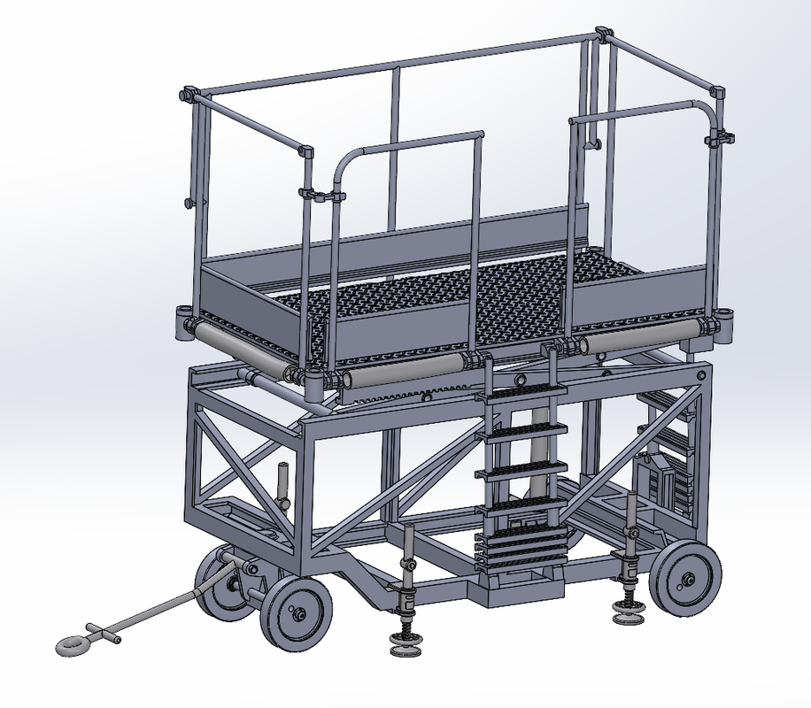

Since then, the advent of 3D printing has made things much easier so over the last year or so I began working on a solid model of the safety raiser. Which brings me to this...
It still has a long way to go before I'm finished. The biggest issue has (as always) been obtaining some decent photos of the beast. I think I have around 5 or 6 photos and have had to interpolate and extrapolate and just plain guess at some things based on those photos alone. It seems ground equipment was never really glamorous enough to photograph. More's the pity.
I've ran one test print the other day and so far it appears entirely doable - thankfully.
If all goes well, I plan to have the safety raiser adjustable for height, along with the ability to have the guard rails set in the "up" position, or just hanging free.
The design itself has been done in my usual 1/48, but there's no reason this cannot be scaled up to 1/32, and possibly even down to 1/72, though full adjustability at that scale may be tough.
I'm still working out a few issues and determining the best path forward. For example, I will probably have to supply the ladders in several height versions, depending upon whether the user wants the raiser extended or not.
There will more than likely around 40 to 50 parts in the assembly, so it's almost a little kit in itself. Customers will have to supply some small lengths of 0.8mm brass or styrene rod, but that's all (at least at the moment).
I do plan on adding some other ground equipment when I get time.
If you are interested, PM me and if there's enough interest I'll take this off the back burner and put some heat under it.

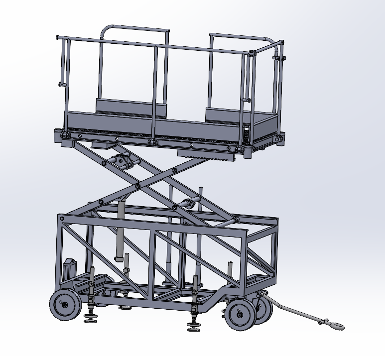

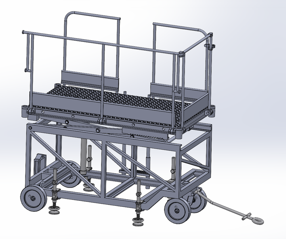

I got a bit more time on the model this morning and spotted a few additions. Adding those parts meant I had to reduce the width of the bottom frame by around 1.5mm - thank heavens for parametrics as it made the job relatively painless.
I also figured out the ladders. Since the height of the platform will be adjustable, I'll provide a bottom section with some steps fitted along with a bunch of additional steps. Ø0.8 rod can be used to extend the ladder to the required height and the steps can just be slid over the Ø0.8 rod. That was the easiest way I could come up with but I think it will work okay. End users will need to add the step strapping from lead foil or tape or similar.
I just need to run some test prints now and check that it all fits together. No doubt there will be some tweaks required, but hopefully not too many.

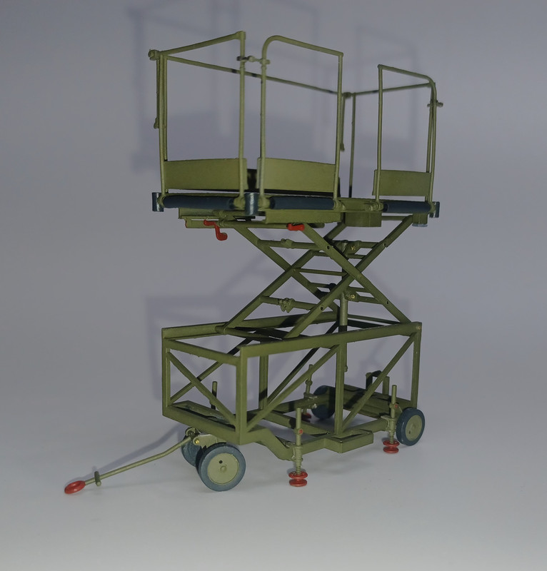

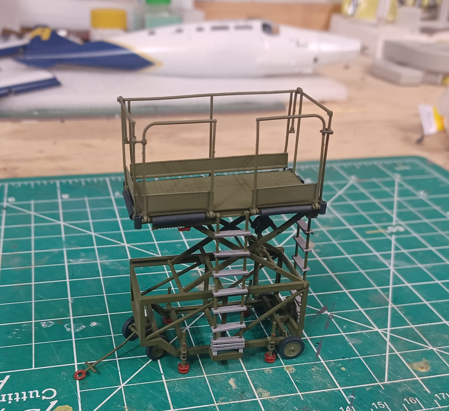

Just a couple of rather nasty photos to show progress on this so far. My phone refuses to take decent photos of this and these are the best I have so far. I will try and get better shots when I get more time.
I have spent about a day in total putting this together and that included painting.  There's still the ladders to add and then it should be finished. I had a rethink about the ladders and think I've now managed to get the easiest method for creating and adding the ladders. Those are currently printing so I should be able to finish this next week sometime.
Once the ladders are added I'll give this an overall flat coat to eliminate some of the shininess on the rubber bumpers, and maybe add some more detail painting.
I will also go back and make some additions/modifications based on my experience with the assembly.
Overall, I'm very pleased with the way this has turned out.  This model has been created in 1/48 so scaling up to 1/32 or larger scales will not be an issue. Scaling it down to 1/72 will present some major problems though I am going to look to see if I can redesign a 1/72 version which requires less actual assembly - when I get time.
There's no getting around it - this is a VERY delicate and fragile model to put together. Definitely not for the beginner.
