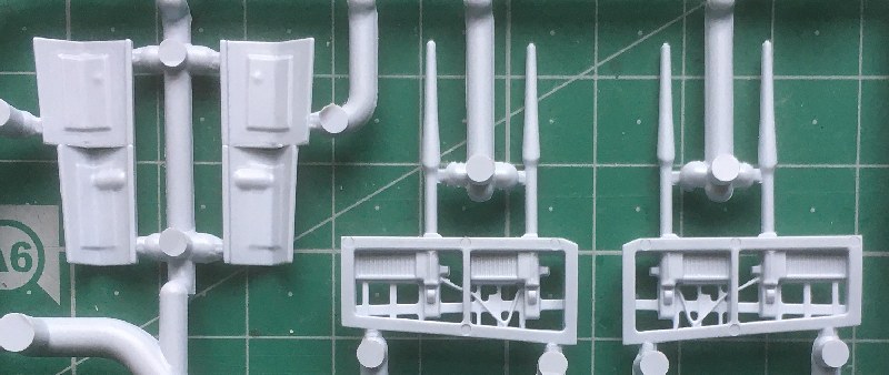

I recall reading about this kit and it's slightly unusual design with the wheel bays forming the lower parts of the cockpit and being an important structural part of the wings. I think its a good design but it means some thinking about the painting before joining parts together.
Img_9183s
(Yes, I know, nasty mold ejection marks).
