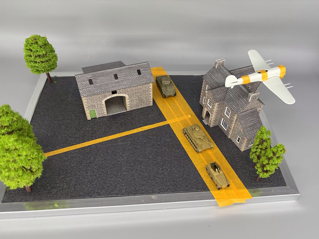

With the buildings constructed I turned my attention to a bit of town planning.
I like to use cheap photo frames to edge my dioramas not being a skilled woodworker. This one has an inside measurement of 8x11.5 inches. Into the frame I add some insulation board. This keeps the weight light and allows me to stick things in it.
I have called up some 1/144 vehicles from my radio controlled tank diorama to help with planning. A bit of bad news was looking in the box for the Typhoon and discovered there was no canopy nor tail planes. The good news is that I could mock it up here to see how it could work.
I plan on having to attacking planes, one having finished his attack run and the other about to commence. This will mean a plane at either side, one on the smoke from the chimney of the farmhouse with the other skimming the trees. I know this is too low but it should visually work.
The trees are some that I picked up cheaply with this project in mind. They will need some work to try and make them less toy like, but I do need one for the attacking plane.
Here are the two options, the only difference being the placement of the barn. The road/paths are in tape. The front “empty” section will be a hay field and the borders will be hedgerows.

2 hours ago, gwyndaffandy said:
I will think of it for my next small scale project - more on that later…
OOOH! Slippery slope approaching:popcorn:
And there was me thinking that you were really cracking on with this! I mean you are in any case.
From a practical point of view, you'd probably have the main entrance of the barn pointing onto the road for ease of access, unless you're going to be very exacting about prevailing wind and the rain and weather blowing in.
Loving the imagination and creativity.
PS PM replied to.
M
with the Typhoon not being a complete kit I have had to go in search of another one. It is coming with some other 1/144 planes, 2 of which are a 109 and a Hurricane. That is screaming BoB to me so assuming I get this one done I will try to do something with those 2
In my head I thought it made sense to have the opening onto the courtyard in version 1. But I do like the way it opens up on version 2. The thin track will be bordered by hedgerows so I can widen the start of that road to get into the farm proper

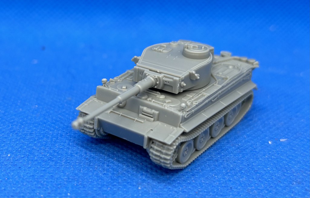

With the buildings complete my attention turned to the vehicle needed for the scene. I started with the Tiger 1. Although this is an early version with twin headlamps, rubber wheels and Feifel filters I am going to go full steam ahead with it.
the kit is made up of just 16 pieces plus 2 optional parts representing the spare track links.
the detail is very impressive, the hull top features details such as the wires on the bottom of the picture below that are for the headlamps.
The hull is built as a box with supports built in to maintain the square
The tracks are probably the weakest element of the kit. They are made up of 2 parts per side and the detail of the wheels, both front and back are very well done. The problem is with the links which don’t really replicate the look of Tiger tracks.
When it is all put together the effect is rather pleasing. The only thing I have done to enhance this is to drill out the end of the main gun.

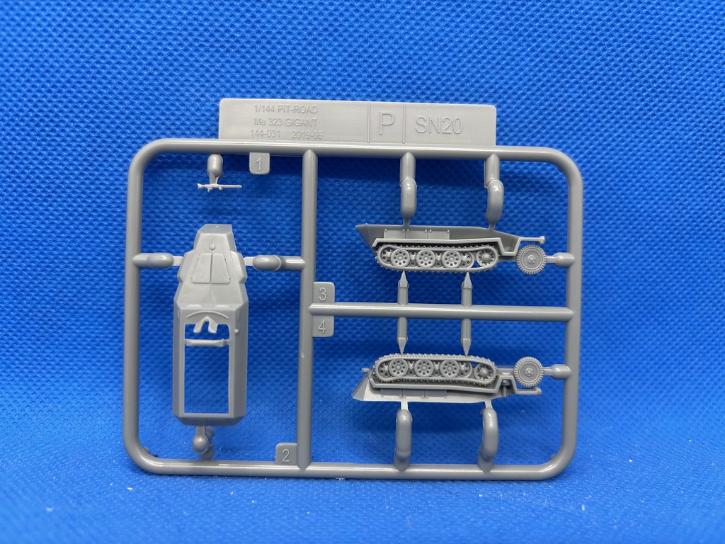

Next up is the Sd.kfz 7. This is a big half track that would typically be used as a gun tractor and is often seen towing the famous 88. With no gun available if I use it it will be as an escaping vehicle, used because it moves and can carry passengers.
Again, the detail on this is really good. Marked not for use is the part on the lower left below which is the load bed used when an anti-aircraft gun is mounted with the sides folded down. I have built a few of the 1/35 Tamiya version with the quad 2mm flak gun. There is no flak available for mounting which is a shame
Not many parts but nice to see the optional tilt included as well
With only 5 pieces there aren’t any in progress shots. Here is the completed version
The underneath detail is nice enough and the tracks are not bad on this one
And finally with the tilt placed, again, I am not sure whether to use this or not
