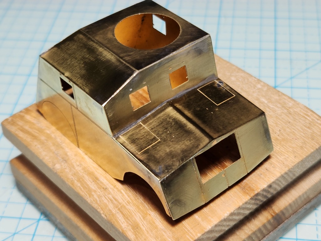

dnl42 Posted July 9 Posted July 9 FWIW, I've only ever used flux for mechanical soldering, like brass to brass in this Beaverette, which also used solid solder. For electronics wire-to-wire and through-hole components, I've only used rosin-core solder without other flux. If you do use flux, make sure it's for electronics. Plumbing flux or any acid is a huge NO for electronics! To be clear, I've never soldered surface-mount components, which uses a solder paste. I've built quite a number of electronic devices, from kits early on to my own designs for years now. I also prefer leaded solder--I've never been happy working with lead-free. As mentioned, make sure the tip temperature is correct for the solder, the tip is tinned, to-be-soldered areas are clean, and any wires are tinned. For wire-to-wire joints, twisting the wires is a good practice to make sure there's a mechanical bond in addition to the solder. Also, clamp the wires with a 3rd-hand to hold the wires still. For through-hole components, you can also bend the leads so the component is held in place for soldering. Once the solder has flowed, make sure nothing moves until the solder has cooled. Soldered joints should be bright and shiny. Grainy or dull soldered joints indicate a cold joint, which will fail electrically and/or mechanically. BTW, if you're going to do things with LEDs, a Velleman LED Buddy (amazon.co.uk, amazon.com) is a useful device--it also provides soldering practice! HTH -- dnl 1
