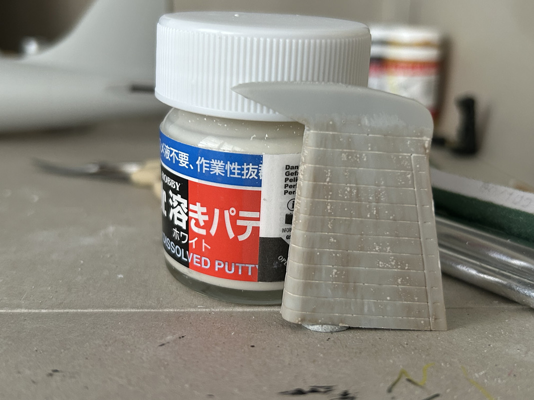

I’ve also been busy filling the trenches on the rudder. I’ll sand it down later when the filler dries.

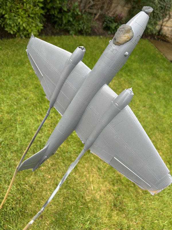

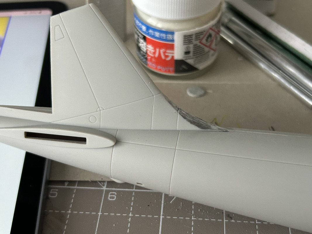

Next up, the fillet at the front of the tail fin. I used some reference photos from an old build on BM to file it down a bit.
Before, with area to be removed highlighted.
And after filing. Hopefully this is more accurate.
  • Like 8

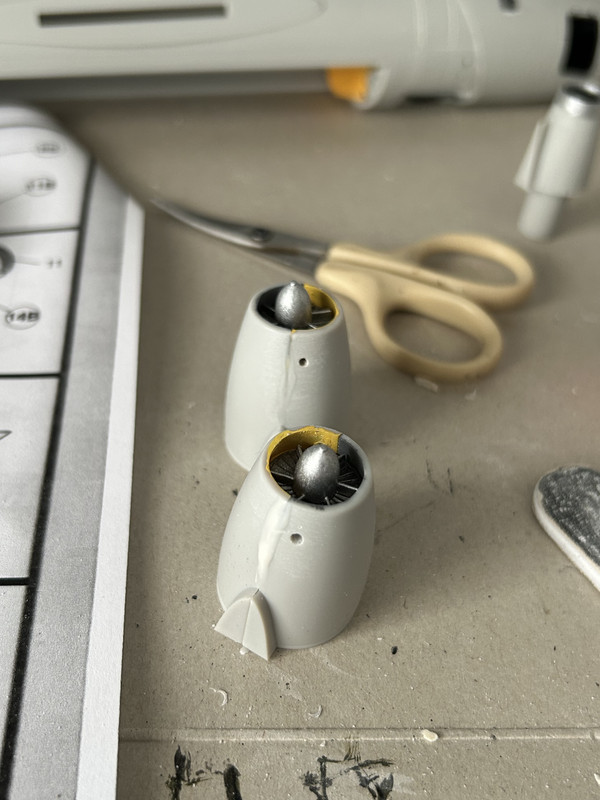

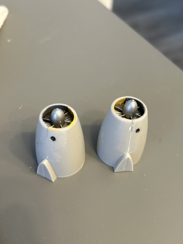

I heated up a bodger and melted through the nacelles to make the vents on each side.
  • Like 6
Nacelles sanded and tidied up. This old kit has very thick joins between sprues and parts, so quite a bit of sanding is needed on most of them.

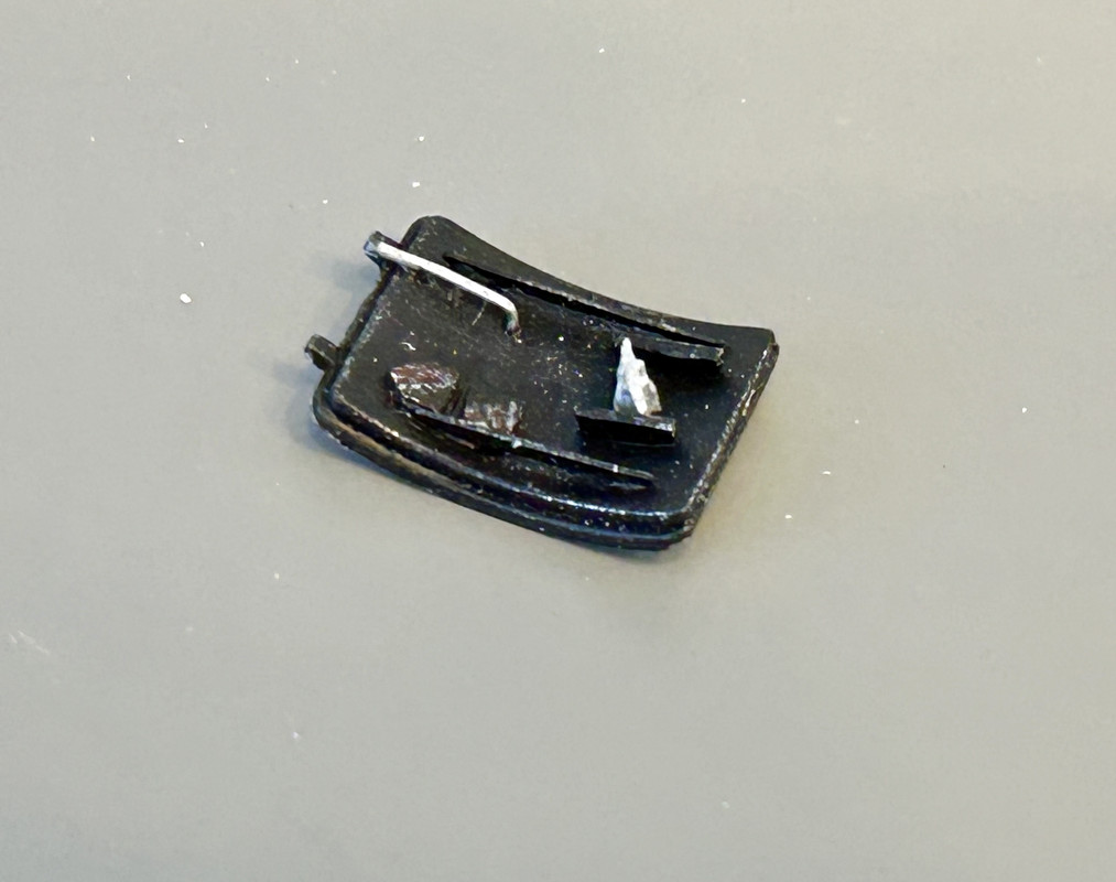

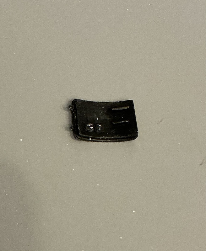

Crew door done.
  • Like 7
  • Love 1

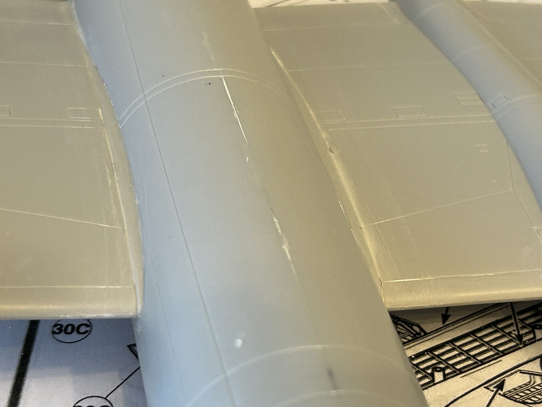

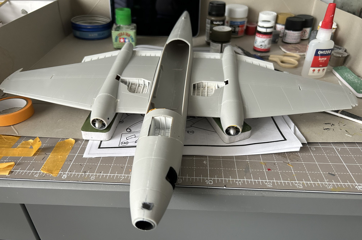

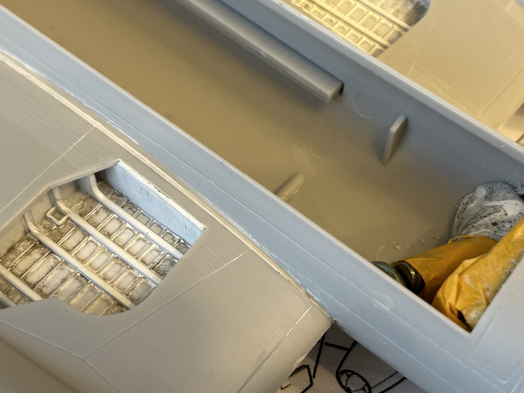

The heavy wings need superglue to fix to the fuselage. They’ll also need a lot of filler once firmly set. I think it’s a bit easier fitting them before the bomb doors so I can glue the underside join a bit more once the upper surface join is firm.
  • Like 10
  • Agree 1

The gap under one of the wing joins was so wide I used two strips of plastic card as well as liquid putty to fill it up.
Top side joins not quite as bad but still needed filling along the entire length on both sides.

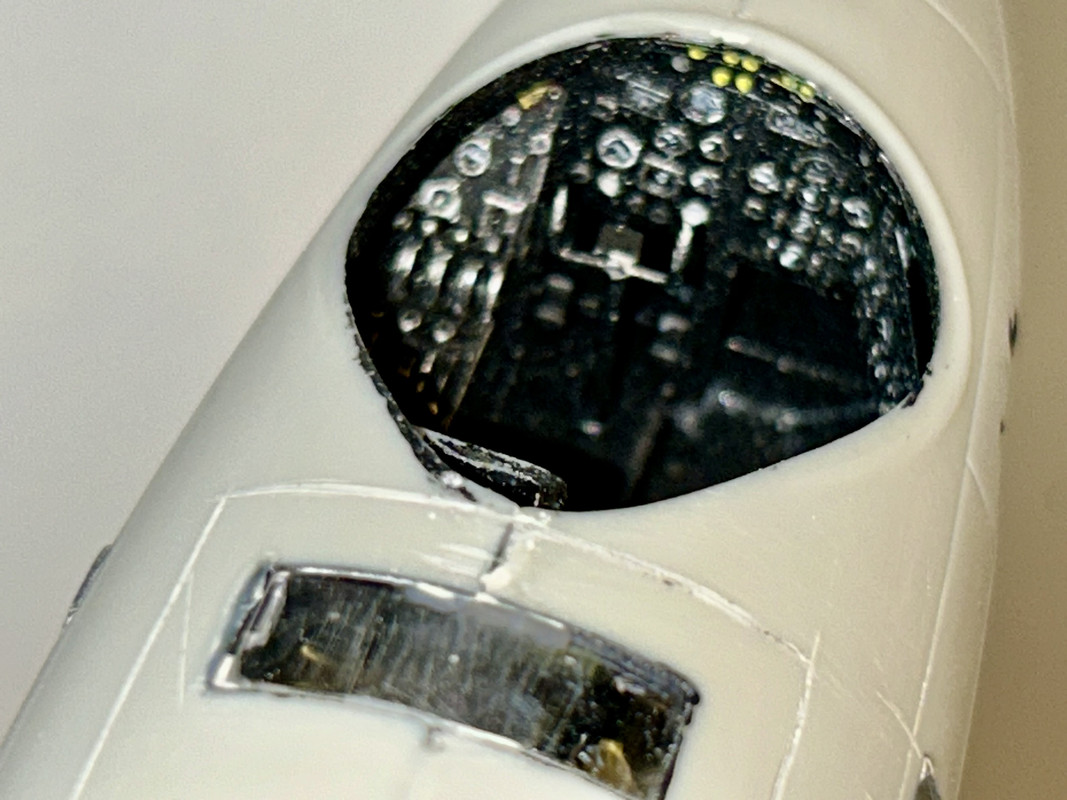

I added a few extra instruments along the front of the cockpit.

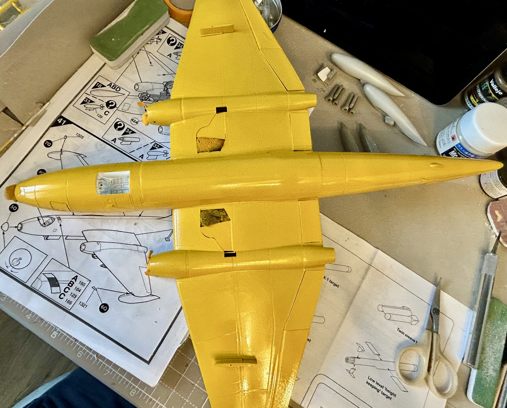

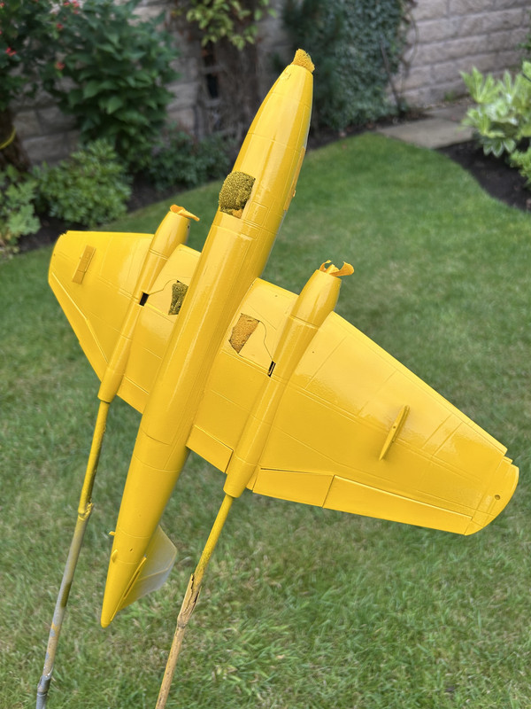

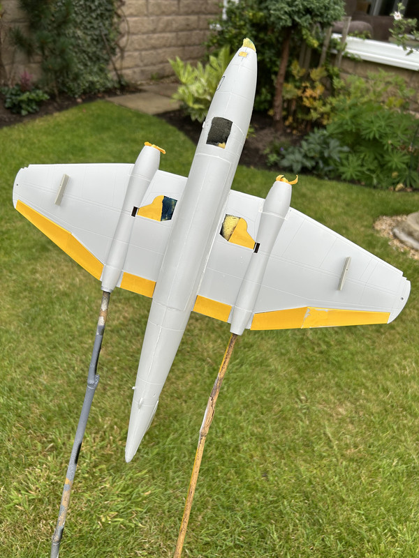

The yellow spays on with no trouble at all. Hopefully it’ll dry smoothly, otherwise it’ll need a second coat.

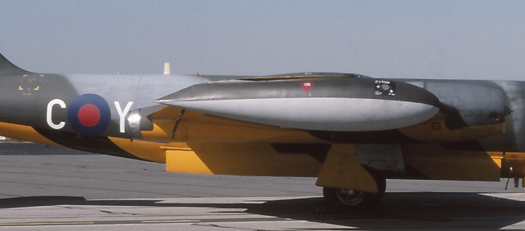

I’m assuming the wingtip fuel tanks were changed between airframes, so it would be possible for this aircraft to carry tanks with light aircraft grey undersides to them. I’ll check a few reference images and see if that’s realistic.
  • Like 7
Second coat of yellow, particularly under the rear fuselage. Looking smoother now.
  • Like 7

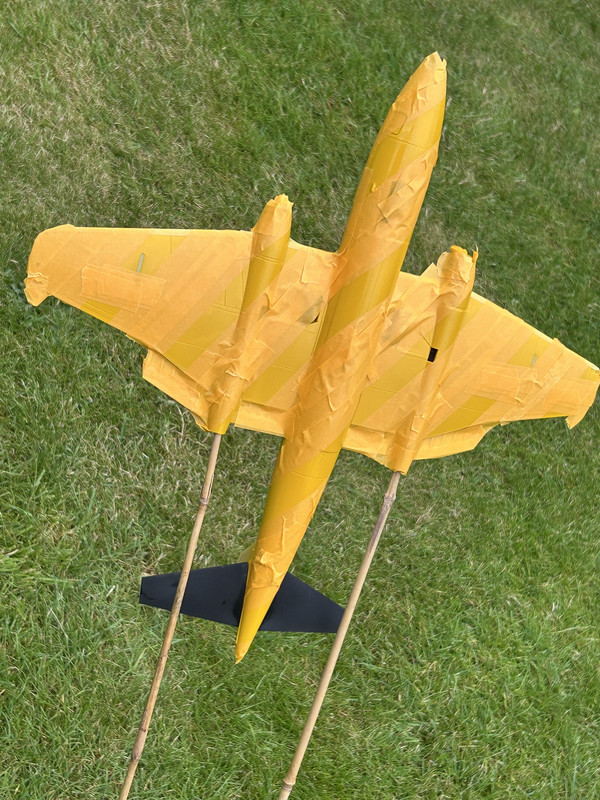

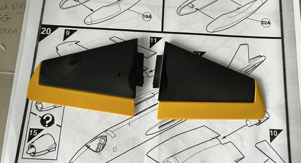

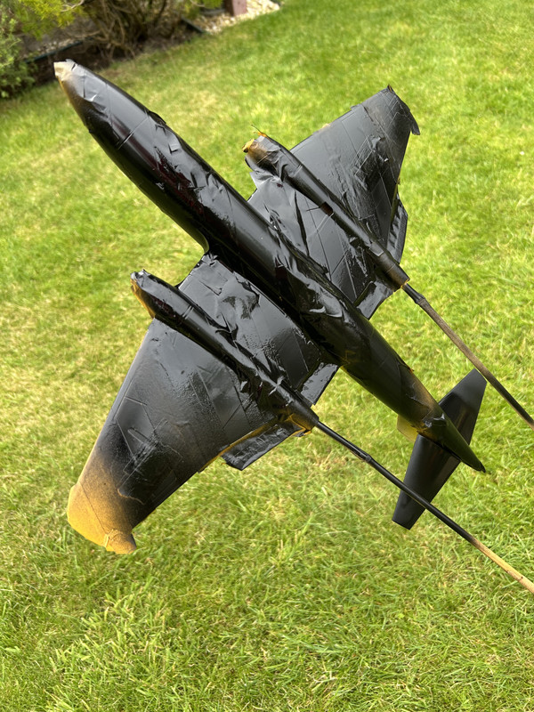

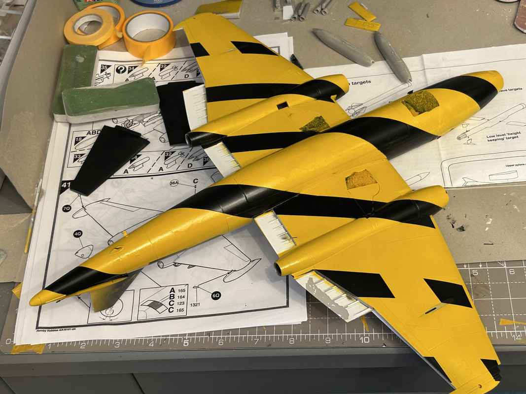

Masked up ready for the black stripes. The width of the black stripes across the wings is 12mm on the model. As they curve around the fuselage though they are wider, it can be clearly seen on photos. Hopefully that won’t look too weird when I remove the masking tape.
The black and yellow are such contrasting colours that I’m fearing a fair bit of paint touch ups later, it’s hard to see if the masking tape left any gaps.

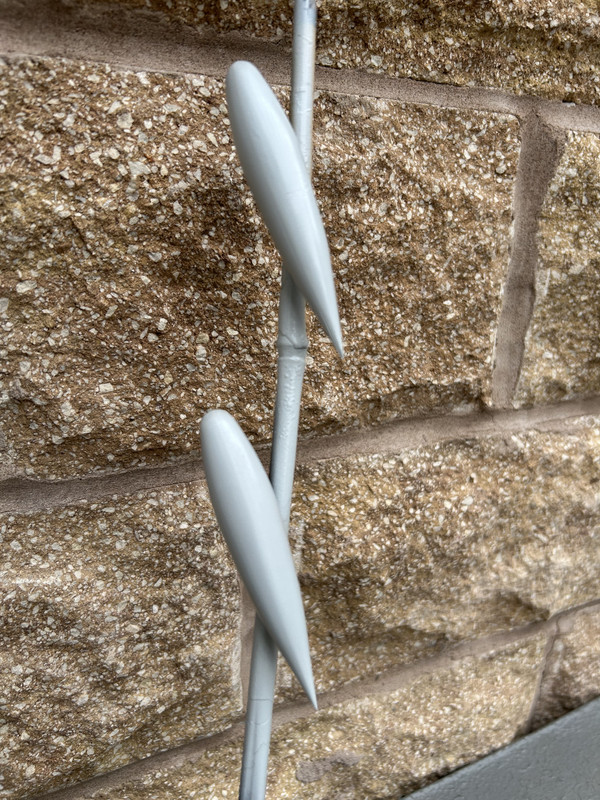

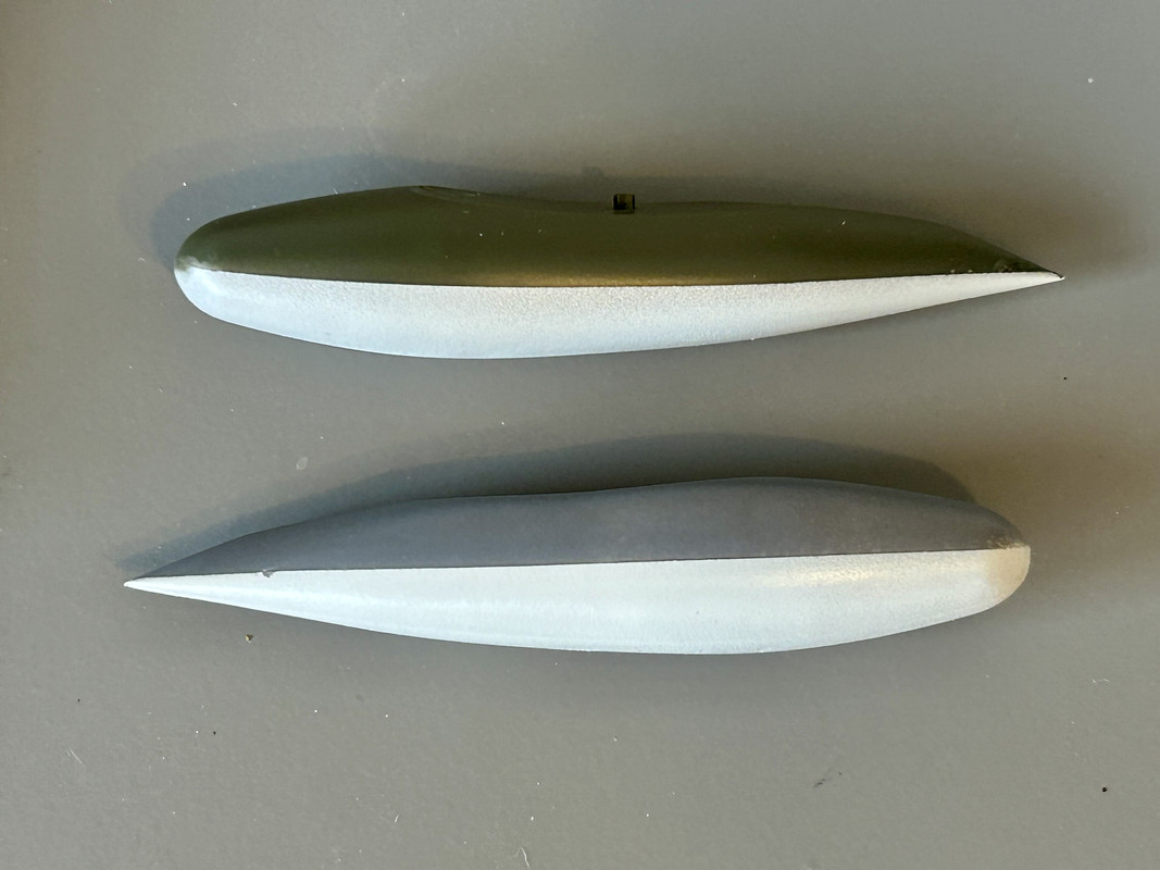

I decided to spray the undersides of the tip tanks in light aircraft grey. I’ve seen quite a few examples like this. The top part of the tanks will be DSG and dark green.
  • Like 6

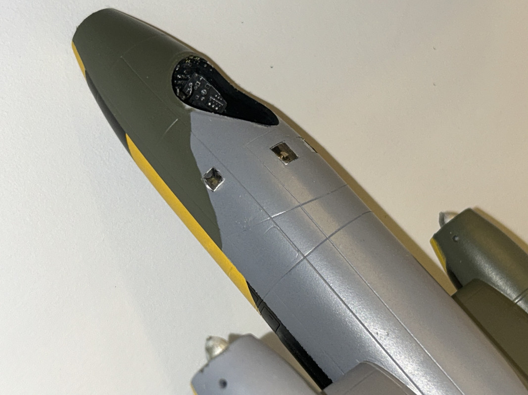

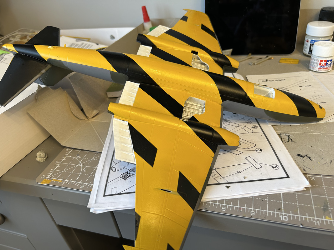

The big reveal! That could have been a lot worse, I’m actually really pleased with how it turned out. Not much touching up needed at all. The only real issue was the masking tape pulling up some of the interior white, but that’s an easy fix.
  • Like 8

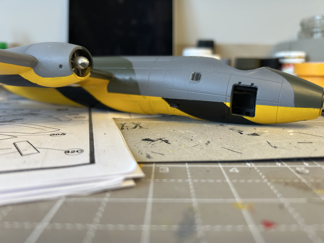

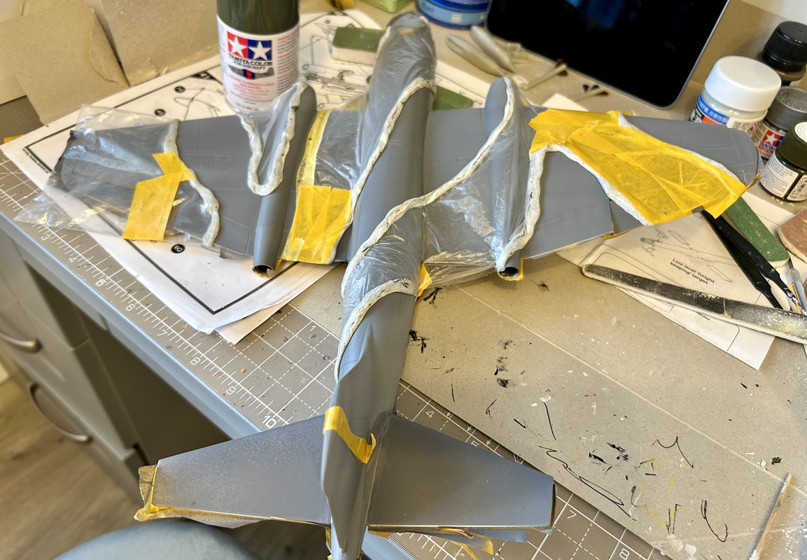

Undersides masked and dark sea grey sprayed.
  • Like 5
Striping is looking great, yellow is not an easy colour to spray. Well done!

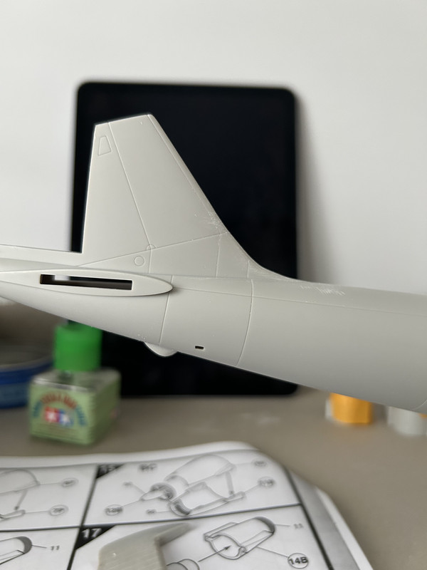

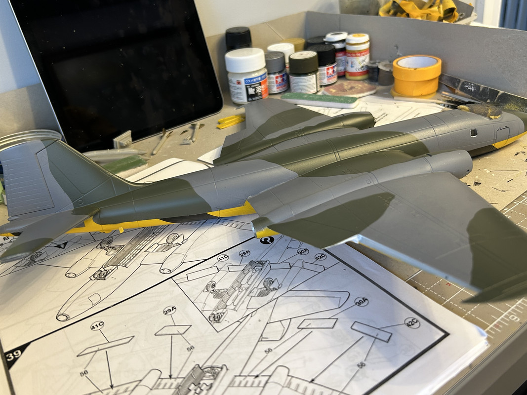

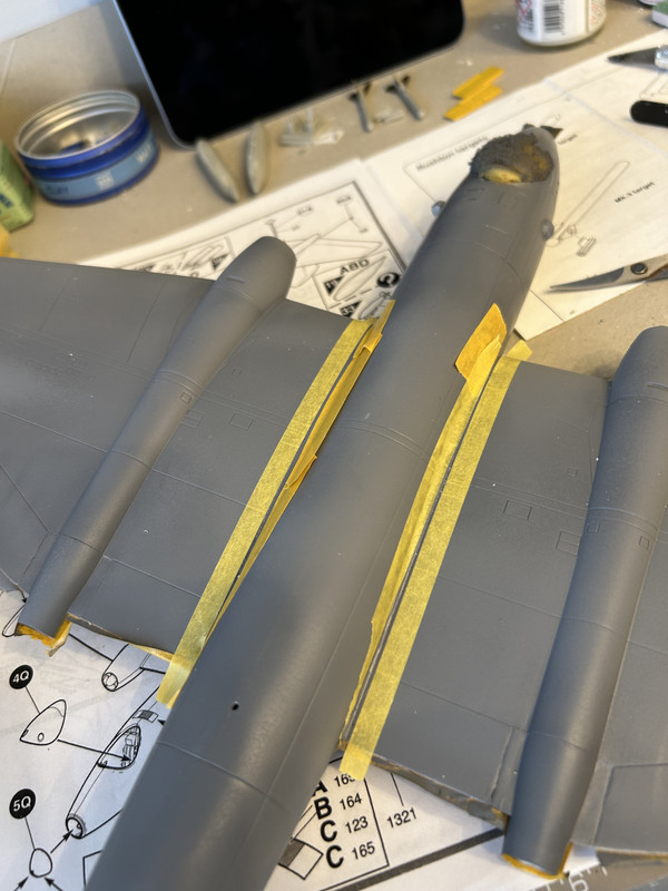

I thought now was the right time to glue on the tailplanes so I could administer filler before further spraying. They’ll need another coat of grey to cover up the filled join lines. The rest of the airframe is masked up ready for green spray.
  • Like 4
Fuel tanks sprayed, just a few minor touch ups needed plus the tiny light on the front. These are the kit tanks rather than the Alley Cat ones. Those were probably ever so slightly better but not enough to make it worth the effort of having to clean up massive seams of resin.

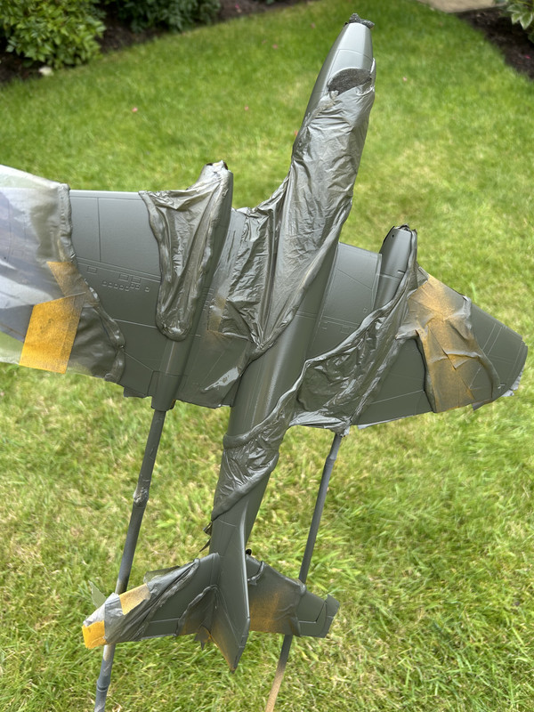

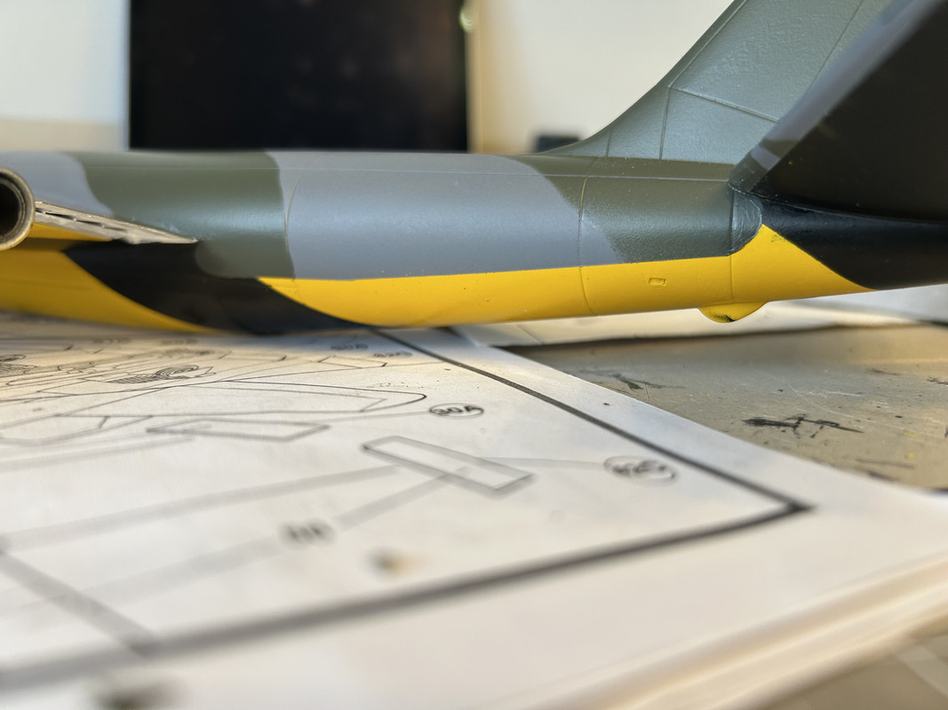

The last major spraying done with the green. It’ll all be tidying up and detailing after this. Hopefully not too much of the former, the more one has to respect a mask little areas the worse it all starts to look.

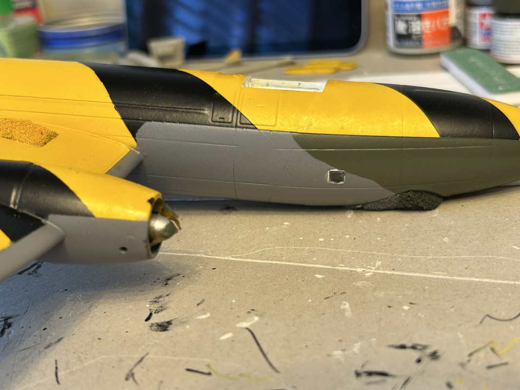

Always one of the best parts to these is the unmasking. Luckily it had worked in the most part, with just a few small areas of touching up needed. These Canberras looked pretty scruffy and weathered generally anyway, so I’m not overly concerned if there are patches of slightly scuffed paint or a different shade, the overall effect seems ok.
I’ve tidied up around the windows now and the curved camouflage demarcation at the wing roots. I’ll let it dry thoroughly over night now then tomorrow I can start the weathering.
  • Like 7
