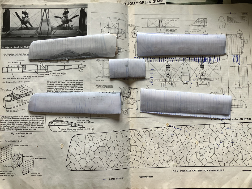

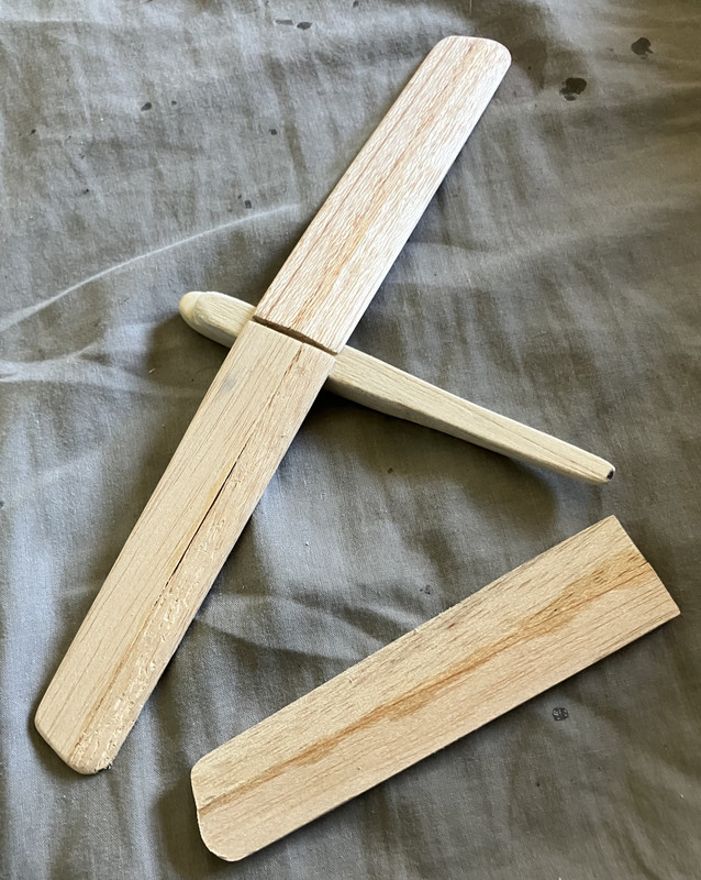

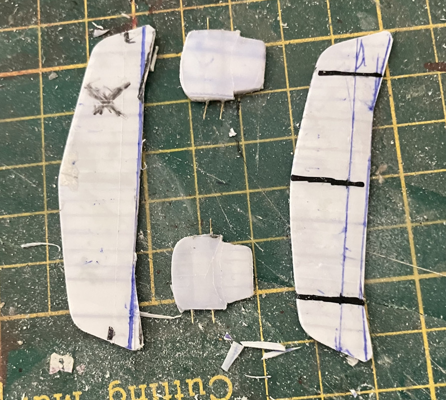

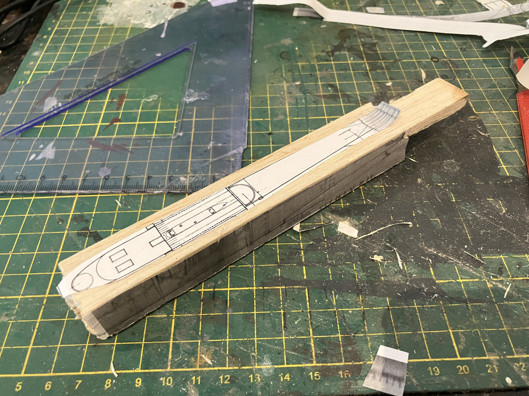

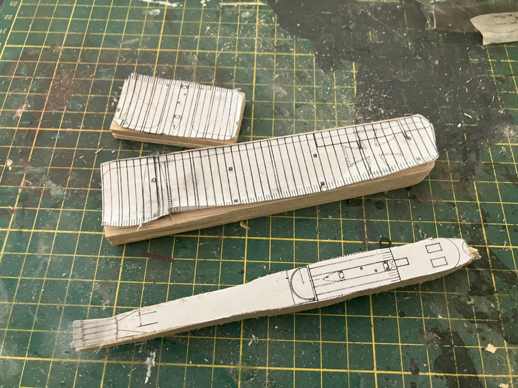

Marklo Posted August 19 Author Posted August 19 Broke out my copy of scale models photocopied the plans snd ready for some woodwork. Wing blanks and fuselage cut. I’m going to use lined .25mm styrene over bss as USA cores for the wings d AC bc vac form the fuselage from the buck. Between this and my Foxmoth I’ve spent the day old school modelling and have thoroughly enjoyed it ! 6

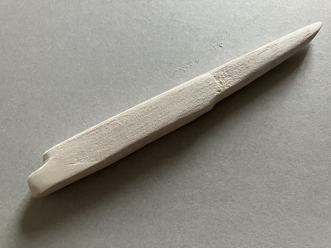

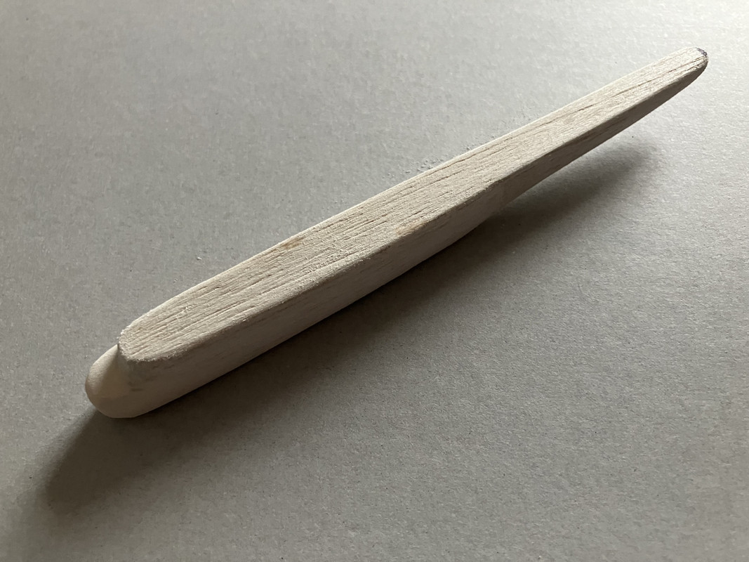

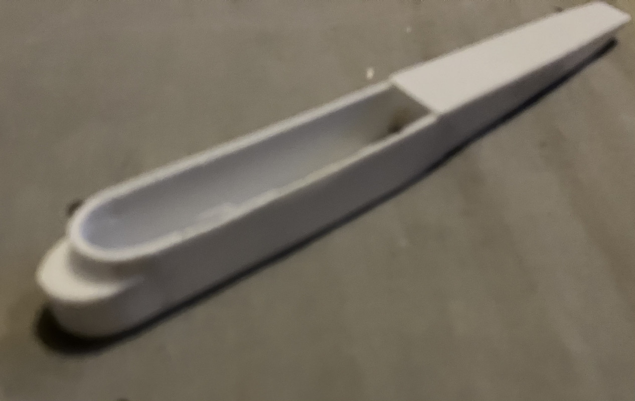

Marklo Posted September 6 Author Posted September 6 Started the n the fuselage. This will all make sense in a few more photos 😀 6

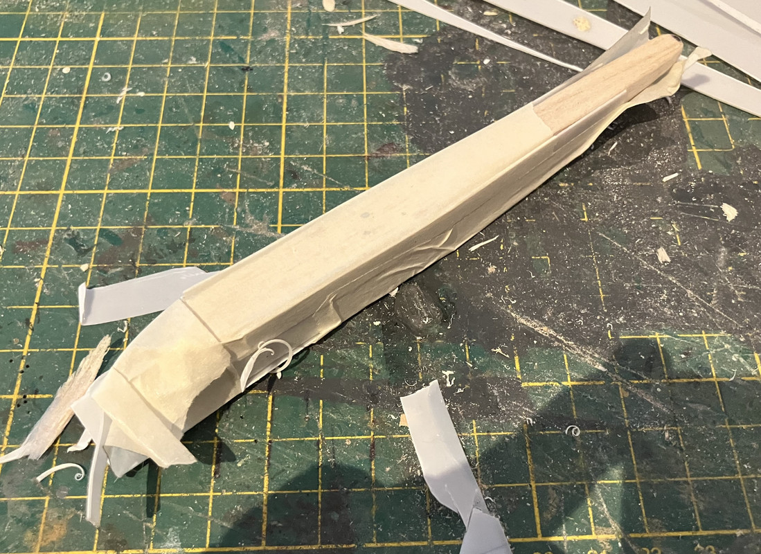

Marklo Posted September 7 Author Posted September 7 Tape removed and quite a bit of fiddling and fettling and we gave something not entirely unlike a fuselage. Going to let the glue set properly then round the corners and cut out any windows or doors next. 5

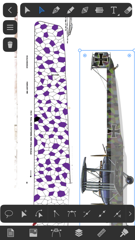

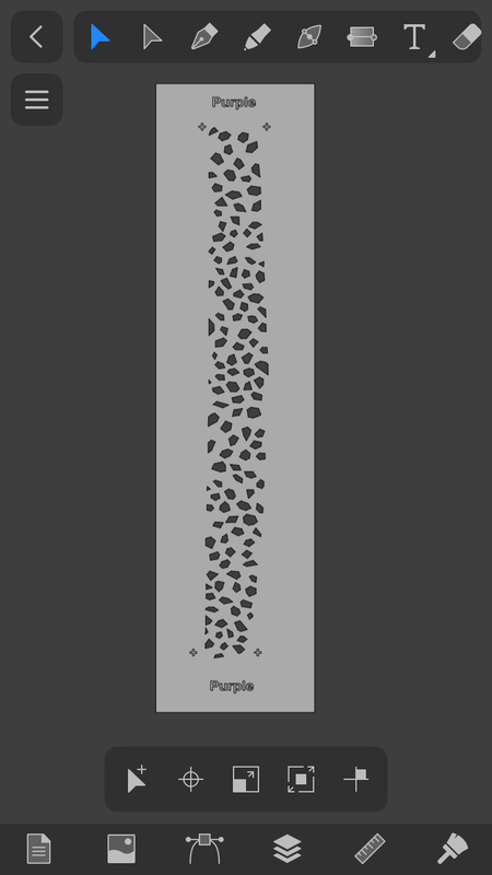

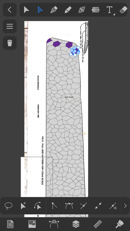

Marklo Posted September 24 Author Posted September 24 So the trickiest part of this build I’ll be the lozenge camouflage. No at least it’s not the printed fabric version but a large random pattern in the same colours but achieving the end result is definitely going to stretch the limits of my painting skills. Scale model supplied a template for the pattern I’m going to use the same one for all four wing surfaces although I may mirror image the pattern for upper and lower wings. So the next step is to use the template to draw up three make for the lozenges ( base colour and three others) then scale them and print them out with my new (well second hand but new to me) silhouette cameo 3… Actually need to check if the pattern is four or five colours. 3
Marklo Posted September 24 Author Posted September 24 Checked my scale models and I shall follow on from Ray Rimmelksvbuild and go with five colours so it’ll be base colour plus four.

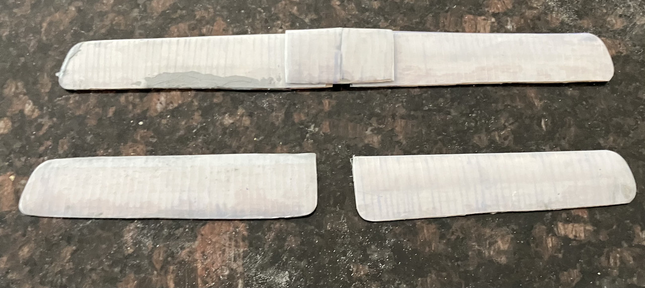

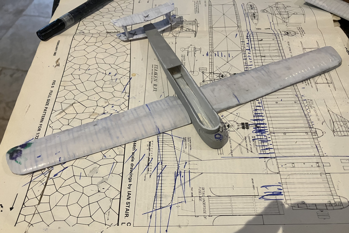

Marklo Posted September 29 Author Posted September 29 A bit more work on the wings. Need to get the trailing edges thin then trim the two upper wing panels to fit the centre section. 2
Marklo Posted September 29 Author Posted September 29 Final trim in the wings but those trailing badges are way too thick. I need to split the rear of the wings trying outcome of the balsa then re glue them. I also need to set the diehedral on the lower wings. 3

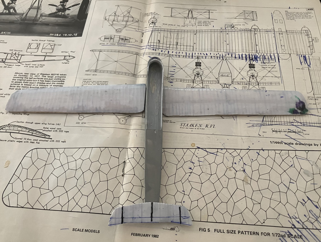

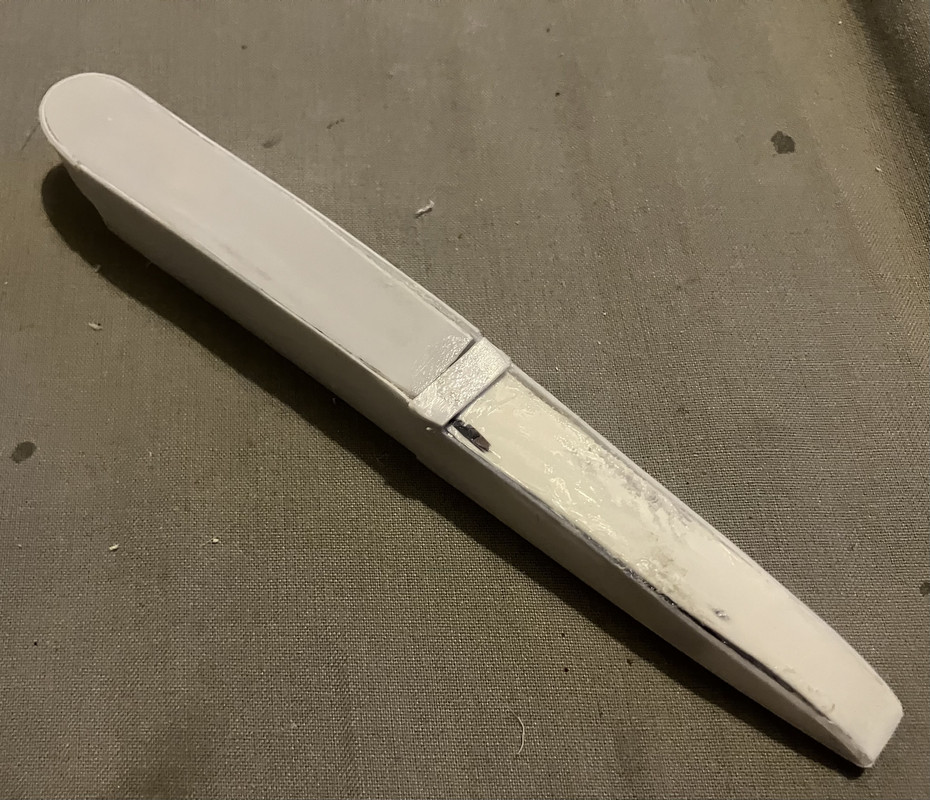

Marklo Posted September 30 Author Posted September 30 Tail attached and partially assembled. Need to drill for the rigging and struts. I also need to score and bend the wing panels, got some brass rod through the fuselage and wings and drill out the fuselage windows next. 5

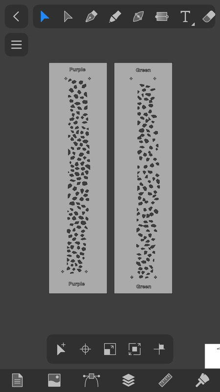

Marklo Posted October 1 Author Posted October 1 Not 100% atm so not getting to the bench. However I’m pressing on with the masks, this is the first one. I’ll reverse it for the lower wing and use them for the undersides too. Only three more to go plus the tail planes kuscthr fuselage… 4

Marklo Posted October 3 Author Posted October 3 Two down two to go tedious but getting there. Once I’ve done all four I’ll make a mirror image set then split them for the lower wings then make a duplicate set for the undersides. Then a set for the fuselage and the tailplanes. 32 masks in total, sounds worse than it is ( I think) as most of the masks will be transforms of the basic set of four. 3 1
