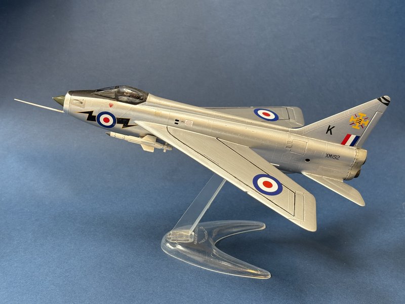

AdrianMF Posted June 10 Posted June 10 This is the old (1962?) Airfix Lightning, built largely OOB: I didn't make many changes: * cockpit and seat detail from card and scraps * plunge moulded canopy * rolled and crinkled paper jet pipes * used Firestreaks from Sword T.4/5 kit * tailplanes trimmed back by 3mm * decals mix of kit's own, Sword T.4/5 and Xtradecal It was painted with brushed Revell acrylic silver and the wing walk lines were Humbrol acrylic black applied with a spring bow pen and ruler. Varnished with Johnsons multi-surface polish. While clearly it isn't remotely state of the art, it's a well-fitting kit and an enjoyable build. The build thread is here if you are interested. Thanks for looking, Adrian 58 10
Rob K. Posted June 10 Posted June 10 That picture No 6 of your build looks really nice. Good looking Lightning. Rgds, Rob 1 1
bigbadbadge Posted June 10 Posted June 10 That is a gorgeous looking Lightning Adrian , great work. Chris 1
ColinChipmunkfan Posted June 11 Posted June 11 Great work Adrian. Perfectly good-looking model. I remember building this in the 60's, not as well as you have done it. Colin 1
Work In Progress Posted June 11 Posted June 11 (edited) I'm not a Lightning expert but for what it's worth I think this kit still looks good. Yours especially. I will look into the tailplane question for when I build mine, I didn't realise it was over-size. New canopy looks terrific. Is there a close-up on the tailpipes? I'm interested in what you've done there. I haven;t looked at the build thread yet but will go over for a look EDIT: Yes, seen them on the build thread now. Would never have thought of that! Edited June 11 by Work In Progress 1
AdrianMF Posted June 11 Author Posted June 11 Thanks @Rob K., @Alpha Delta 210, @bigbadbadge, @Longhorn, @ColinChipmunkfan, @Ray S, @Fred piket, @tomkil. The Lightning has such a distinctive shape and for me the old Airfix kit captures it pretty well. @Work In Progress The tailplanes as provided stick out too far behind the fuselage so something is going on! My canopy had a bubble in the windscreen; I would have used it if it hadn't because it was pretty clear and distortion free for the limited amount of glazing that is left after painting the frames. The tailpipes were fun to do and are a big improvement over what the kit provides, but the Sword tailpipes show how it should be done. In a strange way it's a good thing this kit was modified into the F.3, because if you do get one you will know it was moulded when the moulds were new and Airfix used a harder plastic, so everything is crisp and well-fitting. I have an Airfix Mirage (also an early 1960s mould) in a modern red box re-release, and it's an ill-fitting mess, moulded in soft blue-grey plastic. Not sure that will ever make it to the display shelf! Regards, Adrian 2
AliGauld Posted June 12 Posted June 12 Beautiful Lightning Adrian. Another absolute cracker from you. Cheers, Alistair 1
bianfuxia Posted June 16 Posted June 16 Great work and this old kit really stands up, I reckon. I recently finished mine after a long time on the shelf of doom and I was pleasantly surprised with how decent it looks. You've done a great job with yours - well done! 1

AdrianMF Posted June 18 Author Posted June 18 Very nice, even though it's after its rework as an F.3. I just have to have a pointy fin with my Lightnings! Regards, Adrian 1
noelh Posted Wednesday at 11:22 AM Posted Wednesday at 11:22 AM Excellent build, nostalgia overload. I first bought that kit in a little shop in the village we were visiting as part of a school trip around 1972/73. Remember when every shop had a kit or two for sale? Don't remember anything else about the trip although it was something to do with a canal. 🤔 Built it quickly of course. The Lightning was cool and I harboured dreams of flying jet fighters one day. Thanks for the memories! 1
Adler Leon Posted Wednesday at 11:31 AM Posted Wednesday at 11:31 AM Subject and kit kinda work to evoke the period, used to watch them taking off when a kid. Nice work all round. L 1
woody37 Posted Wednesday at 03:01 PM Posted Wednesday at 03:01 PM Lovely build Adrian and there's something timeless and nostalgic about being displayed on the old plastic base! 1
tempestfan Posted 16 hours ago Posted 16 hours ago On 6/10/2025 at 9:26 PM, AdrianMF said: This is the old (1962?) Airfix Lightning, built largely OOB: Lovely - and on a first issue "A" stand 🙂 IMHO the new canopy for the Snap'n'glue issue (and then used for the 3) is much better, if only it hadn't those tongues at the bottom. By building her inflight you circumvented one potential problem of the kit - it has the P.1B style wheels, that I have not yet seen on operational 1A's (yet - I'm working my way through the Scott book, and there's at least one pic of the 2 prototype with the early wheels). On 6/11/2025 at 10:58 AM, Work In Progress said: I will look into the tailplane question for when I build mine, I didn't realise it was over-size. New canopy looks terrific. According to the DaCo drawings, the tailplane is a bit oversize in chord - I think it can be shortened at the T/E without affecting the mounting point/relative position on the fuselage. Apart from that, the outline is pretty much spot on (guess what is high on my to do list if I ever build a model again...). 1 1
