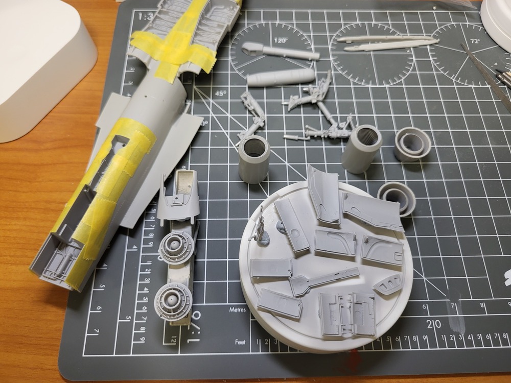

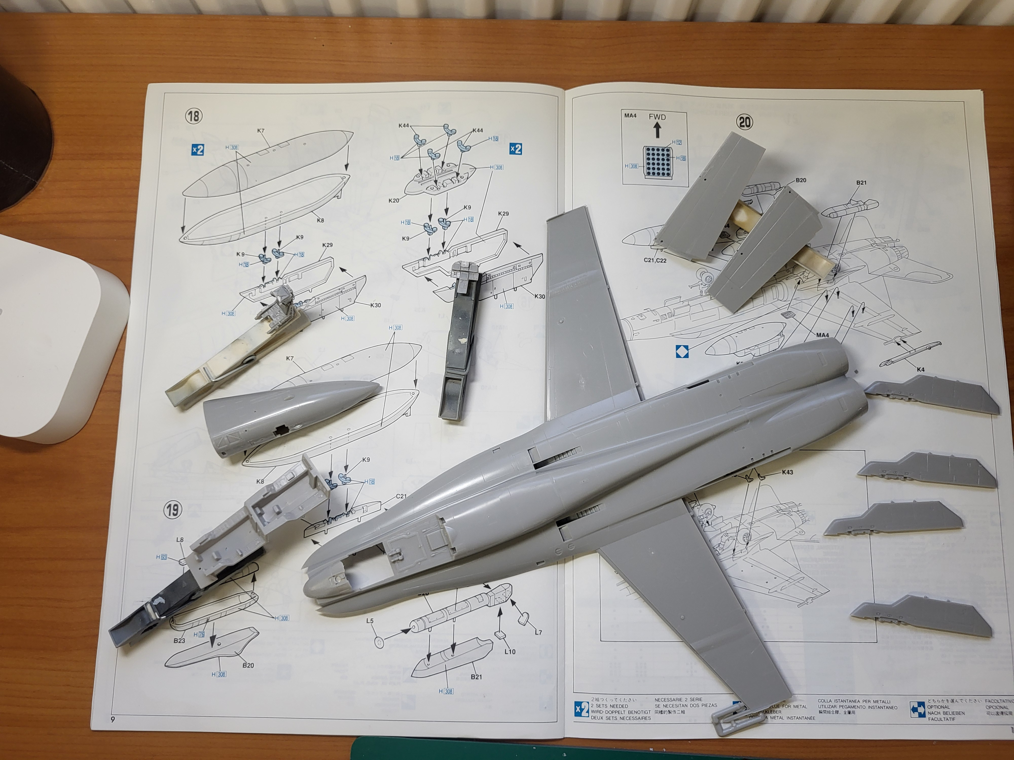

A pleasant few hours spent cutting, trimming, sanding and glueing pieces together.
Pretty decent fit, though dry fitting is definitely recommended. I ended up cutting off the underwing locating pins as they were not allowing an alignment of panel lines.
Probably some light sanding over some of the seams and Mr Cement 'tidelines' before a coat of primer to see how things look.

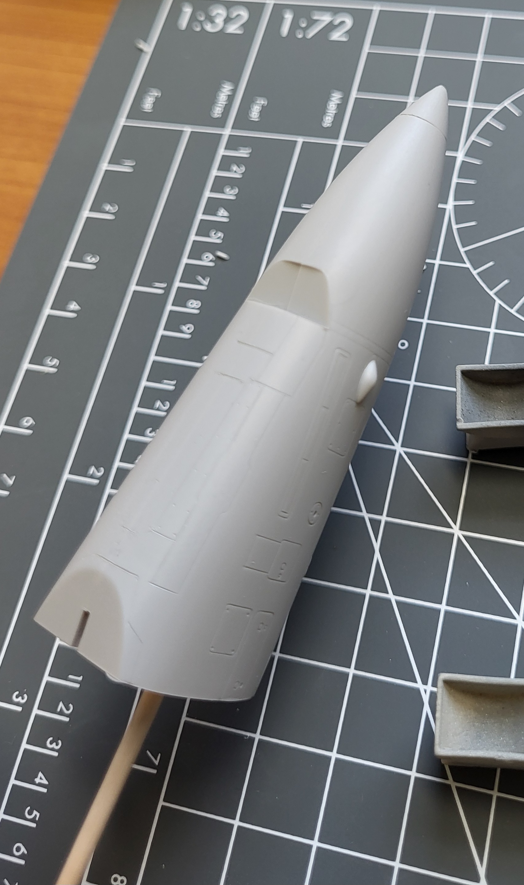

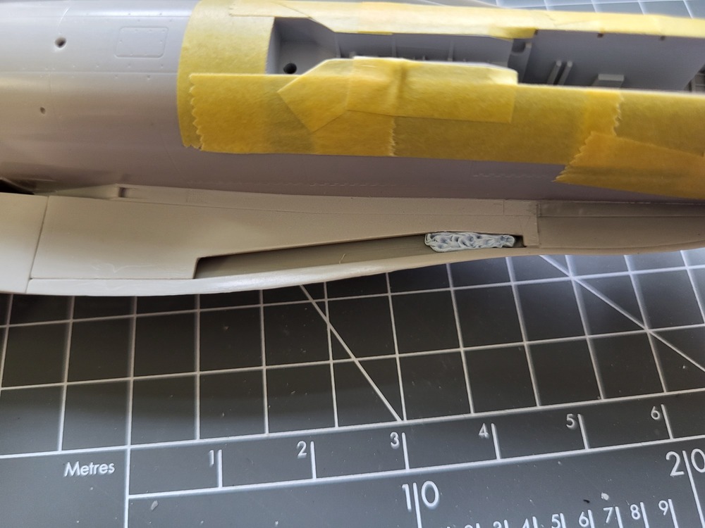

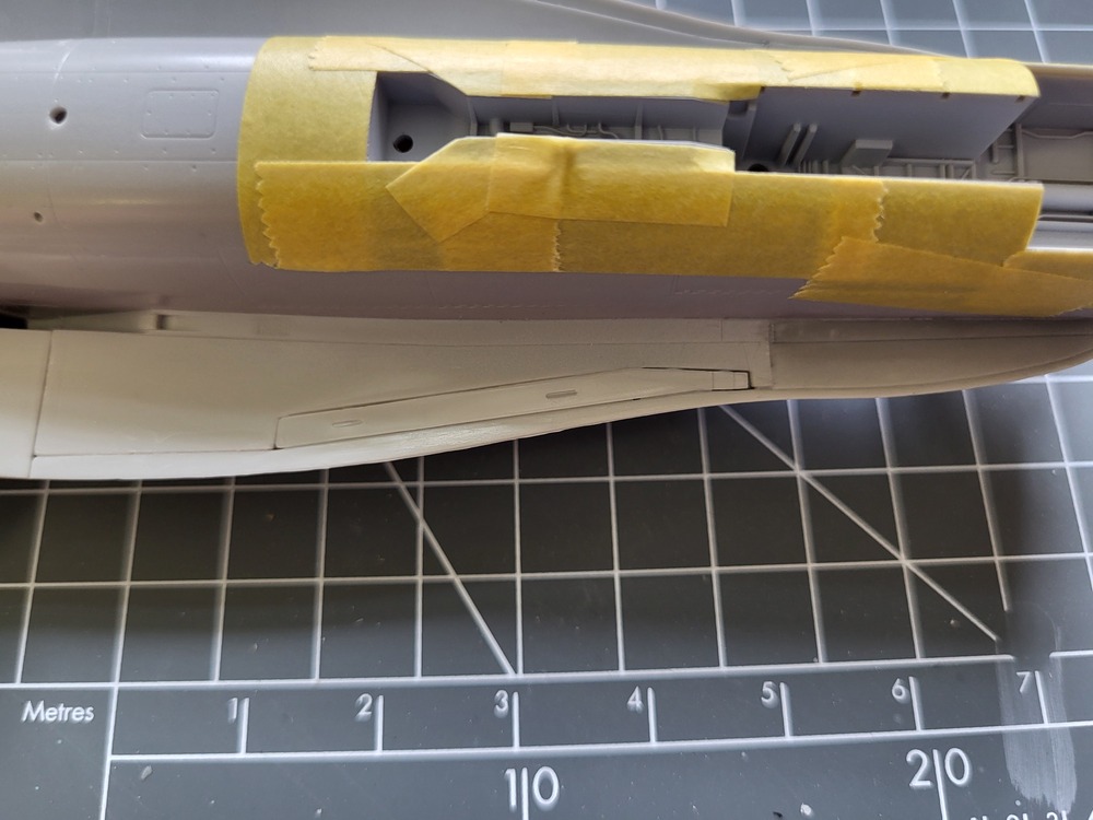

This evening I have been sanding seams and rescribing panel lines.
Who remembers the Radu Brinzan scriber?!
Don't forget (as I did) to open the pylon holes BEFORE you glue the lower wing halves to the top ones...
Rescribed the nose panels. The join line is still showing, but is not stepped, just a ghost line.

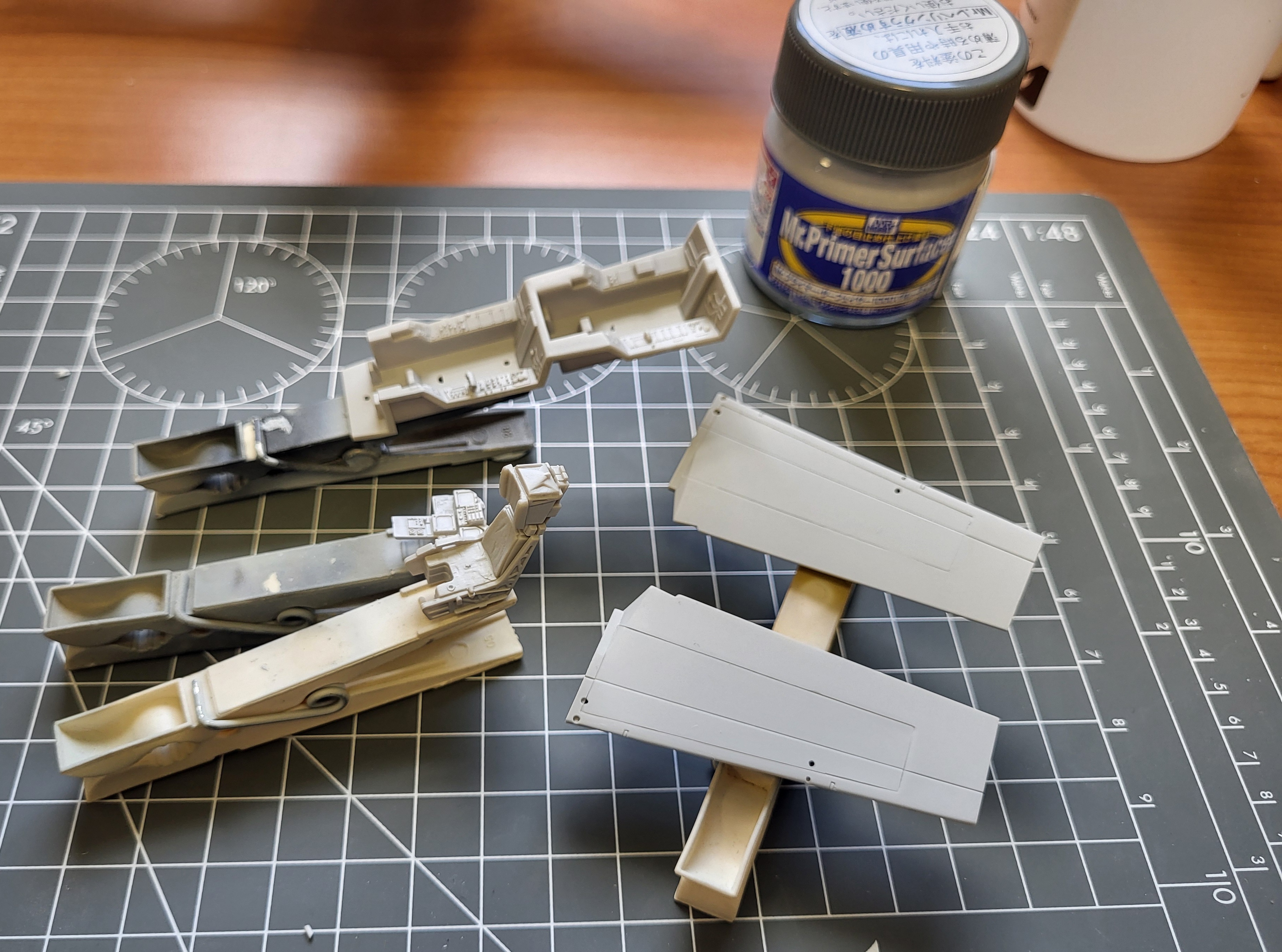

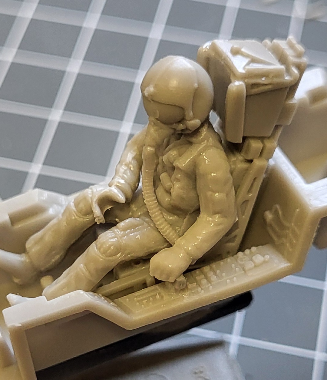

I've decided,  being a USMC aircraft, that I'm going to put the pilot in it. It's not often you have the opportunity to do a M81 Woodland camo helmet cover!
The pilot has been constructed on a Blutack'd in seat, so I could make sure his arms were attached in the right orientation. Some more cleanup required on his visor and around his arms (mazing what a macro view reveals 🥴)
Applied Mr Primer Surfacer 1000 to the assembled bits to check for surface correction where needed. Great stuff this primer and thinner combo, sprays very nicely and dries really quickly.

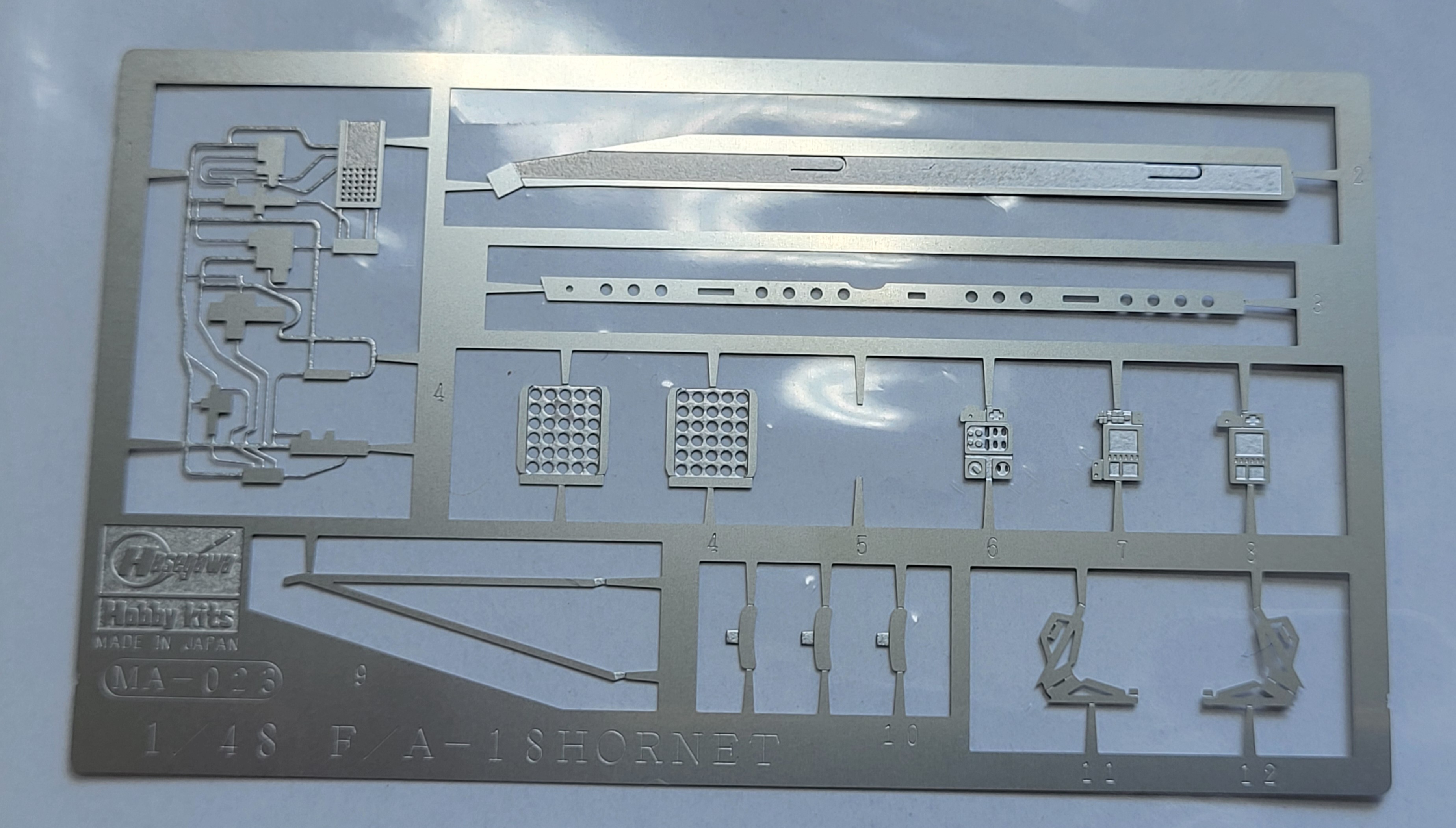

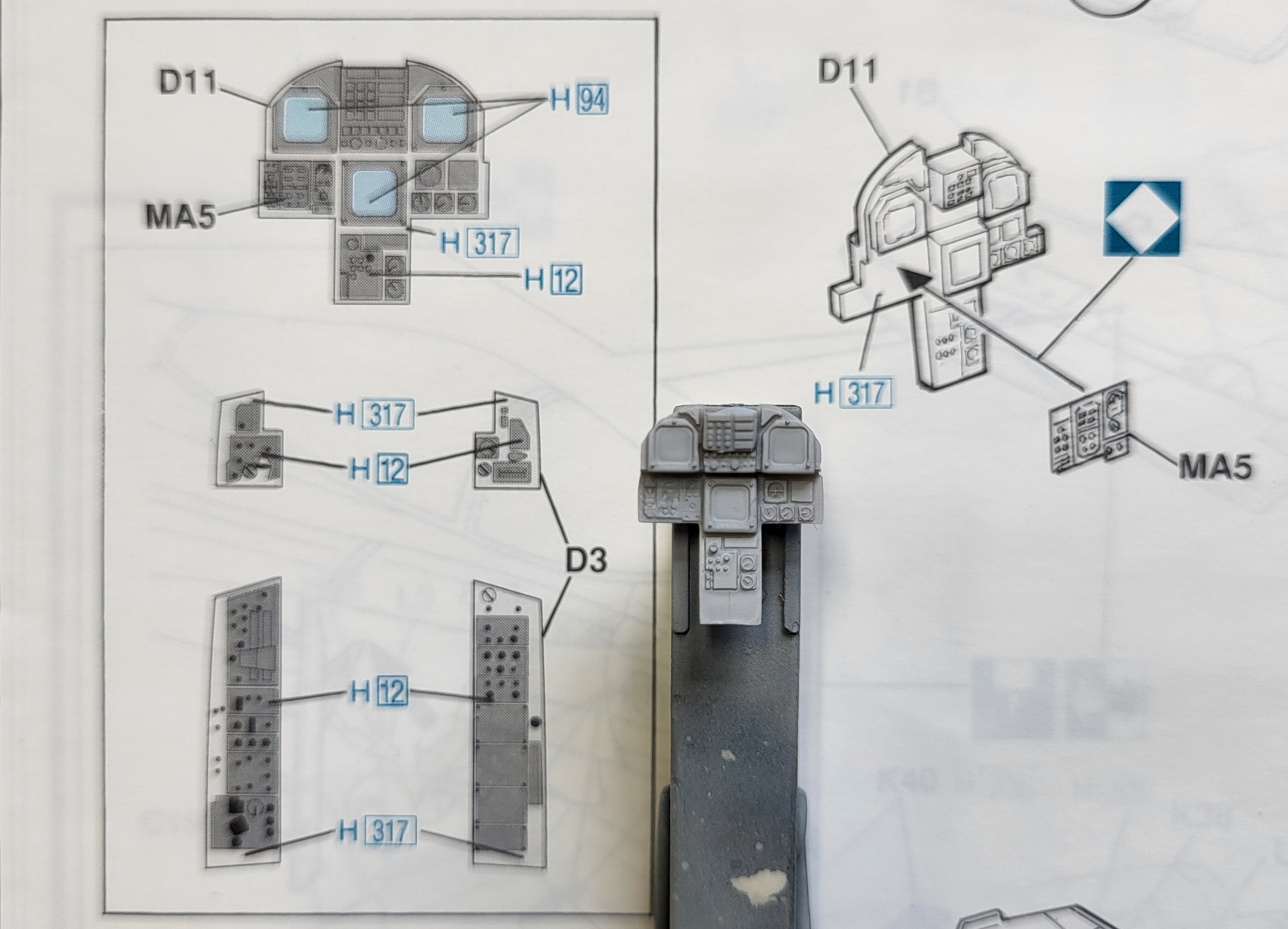

For @coneheadff - the kit provides etch for the lower left instrument panel, with different parts for either A or C variant. I've used part MA5 for this A variant, MA6 is for the C variant.
  • Like 5

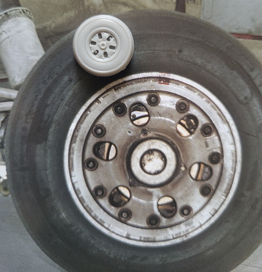

I'm actually pretty impressed with the kit wheels, which include the two internal 'nubs' seen at 2 and 8 o'clock inside the cutouts.

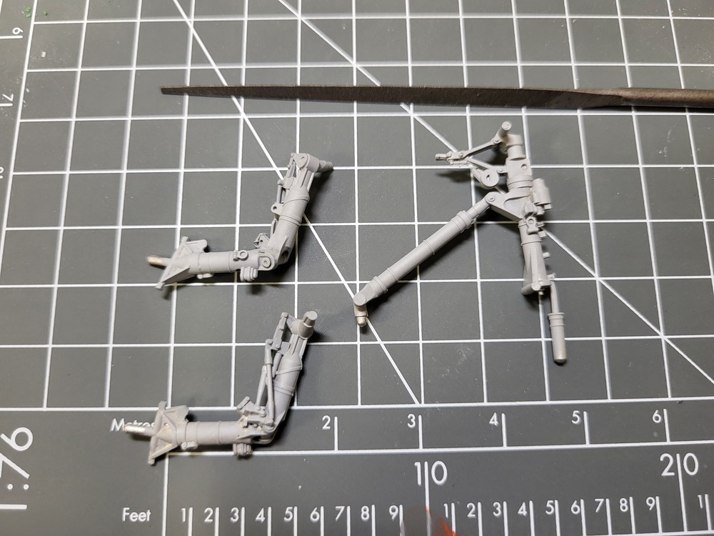

Finally managed to get a bit more done this evening. The metal landing gear struts are really nice, but you do have to use some needle files to remove the casting lines on them. Seemed to go OK and look pretty decent now they are primed.
I had also prepped a few other bits for priming, so took the opportunity to prime them as well. Still one or two annoying ejector sink holes remain, so I'll get the Mr Surfacer 500 on them.

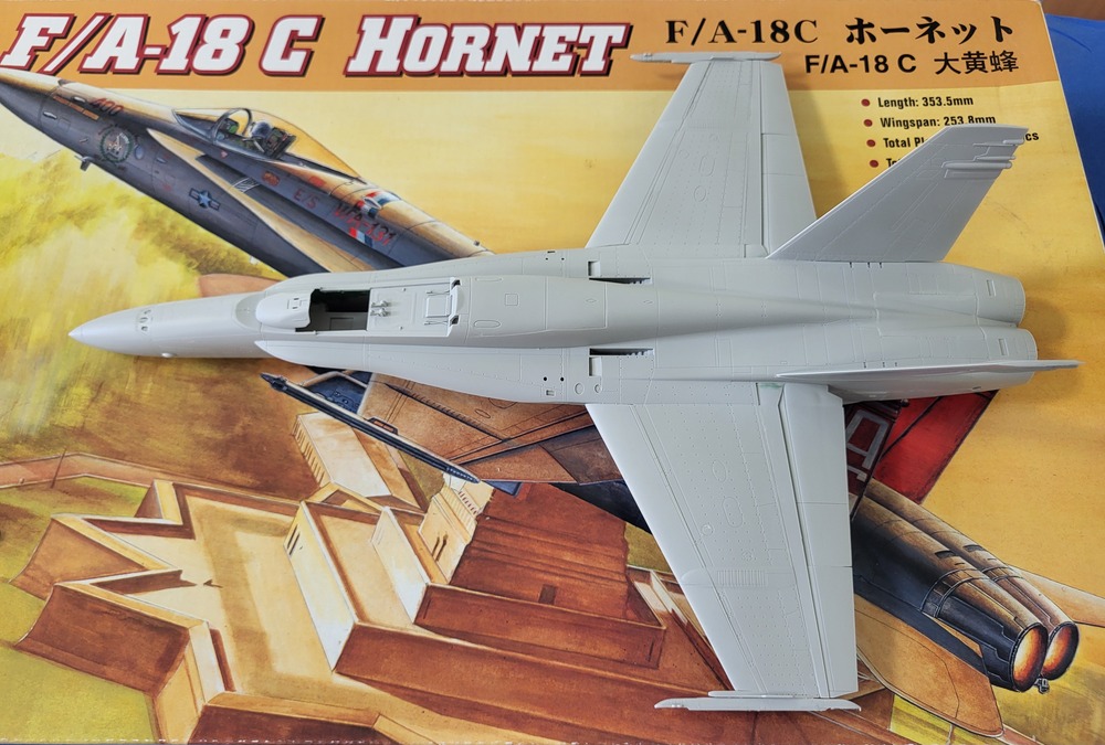

In the background, I have been building up the Hobby Boss F/A-18C with the idea of using it as a practice piece - the layout and construction is VERY similar to the Hasegawa Hornets.
The quality and detail is miles behind the Hasegawa, but it has been useful and will also become a paint mule.
If you think the Hasegawa has issues with ejector pin marks in the undercarriage doors, Hobby Boss has potholes!

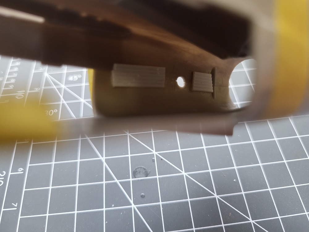

I'm also building this canopy closed, so I'm going to have the ladder stowed. Not the greatest fit, a bit gappy, and I put some Blu-Tack in the forward portion to support the ladder and have it level with the forward LERX slab.
Now it's on to the rear fuselage and gear bay sides, which is involving a lot of test fitting, sanding, test fit, sand etc. Highly complex moulding shapes which have a myriad of mating surfaces to get 'just right' to avoid a lot of filling and sanding later.
