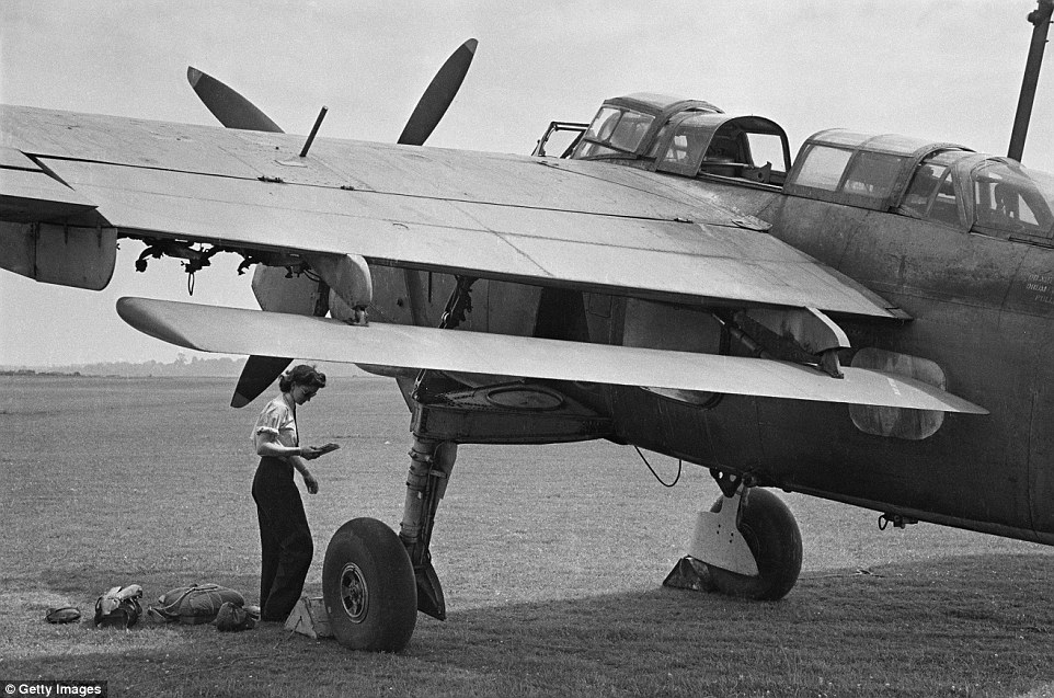

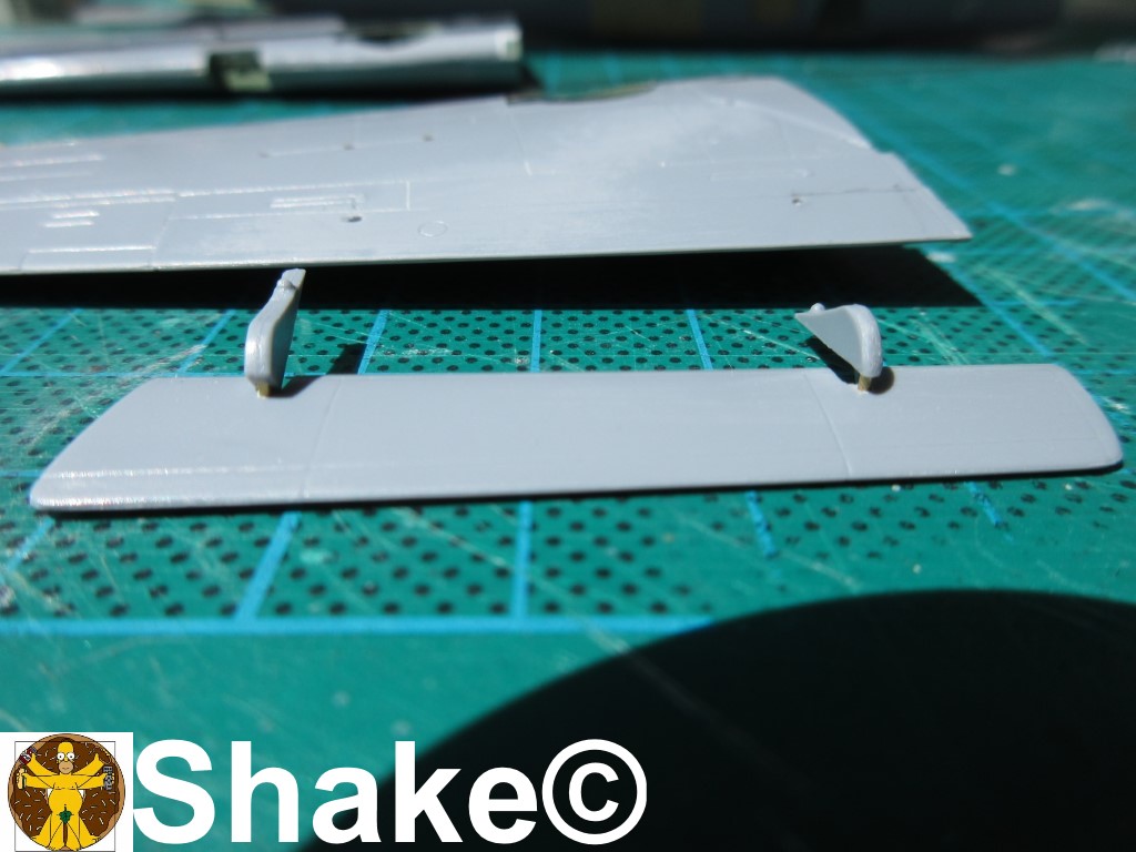

I hope I don't spoil your day, but it looks as if you assembled the flaps the wrong way around. You have them resting on the pylons, but they should be hanging underneath. I am sorry I didn't notice this earlier 😞.
This photo, I think I shameless  copied it from @The Baron's Barracuda build, shows the way they are situated.
2-B46656-F00000578-3194754-Take-off-Maur
An this is how I tackled it. As already mentioned several times, the instructions are very vague.
Sjaak
Sorry Sjaak, missed this one.
I think those flaps are extended? They'd cause a lot of drag if that's their 'up' position, but I'll look for more references.
  • Like 2
Well that's a blow, I think you might be right… all the profile / scheme images show the flaps against the wing but all the photographs show them with a gap between the wing and the top of the flaps.
I'll have a look tomorrow.
You are not the only one who is confused by both Special Hobby and Fairey. At first I didn't understand the construction as well, as forerunner of the Firefly I expected a somewhat similar construction. Instead the flaps are hinged on the pylons and can only move down, and maybe they can move upwards, it looks as if there is enough room, but I can see no reason why they should be able to.
Hope this helps you on your way. I am also curious if someone can explain the workings of the Barracuda flaps.
Sjaak
  • Like 2
  • Thanks 1
  • Love 1
They do not fit flush with the wing.  That is their normal position because they are not only flaps but dive brakes.  Comment has been made the having the neutral position between the dive brakes and the flaps for pulling out is less than an ideal design feature.  On the later Firefly they do fit flush with the wing when retracted.

I think that someone in Fairy’s design office ( possibly named Youngman ) was tasked with designing the most complex flap system possible, along with the most complex wing fold system possible. Looks like he succeeded.

I did a bit of research and found this on Wikipedia:
Fairey-Youngman flap
Drops down (becoming a Junkers Flap) before sliding aft and then rotating up or down. Fairey was one of the few exponents of this design, which was used on the Fairey Firefly and Fairey Barracuda. When in the extended position, it could be angled up (to a negative angle of incidence) so that the aircraft could be dived vertically without needing excessive trim changes.
I realise my error now but TET this morning had no effect - see below - so I'll have to live with it :(
"Drops down"? Maybe they could be 'stored up'? Ho hum.

Do you thing that the young lady in the above picture is looking up the tyre pressures on her mobile?  😜
  • Haha 4
35 minutes ago, Biggles87 said:
I keep forgetting to mention.
Facetiming her boyfriend I reckon!
Trying to complete the day's Wordle or figuring out how those flaps work?  :hmmm:

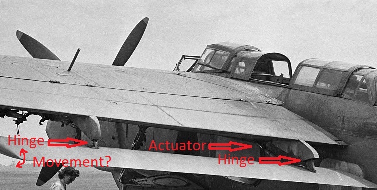

I don't know if this helps.  A little bit of googling...
Youngman Flaps deployed as flaps to assist lift.  Hinged down at the training edge up to 20 deg (?)
Deployed as dive breaks.  Trailing edge hinged up, up to 30 deg (?)
