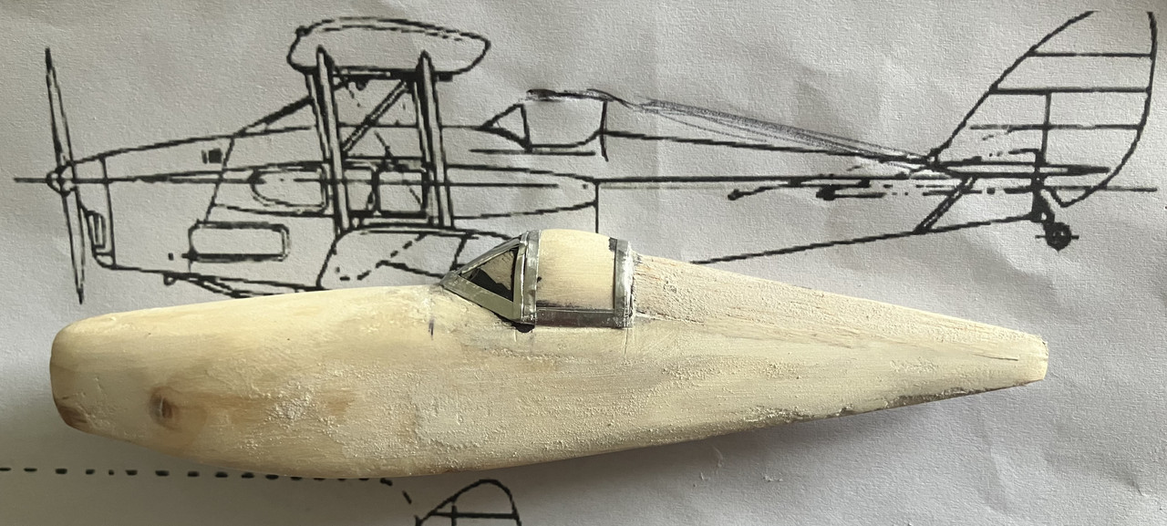

Marklo Posted June 9 Author Posted June 9 The fuselage buck completed, or so I thought until I realised my plans differed from my intended build. The observant among you may notice the biro additions to the pins for an enclosed cockpit. So a bit more woodworking required. Spine added, I’ll let the glue dry then shape it. I’m hoping I’ll be able to mold the canopy integral to the upper deck. I think I need to talk to my cat about her stress levels… 5 1
Magpie22 Posted June 9 Posted June 9 No model room should be without a cat! Watching this one with interest as I am engaged in the same project. In my case I am building the fuselage using plasticard. If you don't want to do the enclosed cockpit, you might consider this one with open cockpit. A41-4, ambulance of RAAF. Peter M 4 1
Marklo Posted June 9 Author Posted June 9 11 hours ago, Magpie22 said: If you don't want to do the enclosed cockpit I’ve already altered the buck so I’m semi committed. I’m going to make the lower fuselage from plastic card too and I may use the nose from the kit. I’ll make a mold of the fuselage and see how much of the sides mold properly. So I may mold just the upper decking or the full side. 2
Marklo Posted June 9 Author Posted June 9 Just about there. The pen marks are a tough guide to where the canopy should sit. I’ll add foil frame lines so hopefully I’ll get the canopy complete with the fuselage when I go molding. 5
Marklo Posted June 10 Author Posted June 10 And some framing added with tape which hopefully will mold well. BTW @Magpie22 pm me if you’d like a molding of the upper deck. But It’ll probably be a week or two before I get around to molding. 4

Marklo Posted June 10 Author Posted June 10 5 hours ago, Corsairfoxfouruncle said: It always amazes me that someone can just shape a block of wood into a fuselage My scroll saw is what makes it all possible €99 in LIDL about five years ago second only to my DSPIAE circle cutter for best model making tool. Everything I do I’ve learned from reading @Bandsaw Steve s many build threads. 2
