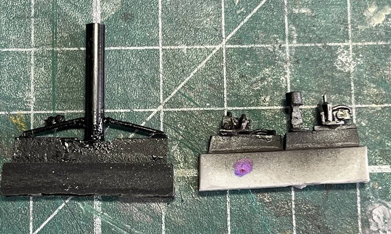

Ok time to play guess the parts. Maybe @Colin @ Freightdog Models can shed some light.
The two thin rods in black resin one appears to have some dials on. I think the thick part in the middle is a pouring stub. Finally, the doohickey marked by the blue dot. Looks hydraulic-y.

In the grand tradition of posting questions on a public forum the answers become suddenly apparent shortly afterwards. The thin parts are braces for the rotor mast. The other thingamy sits atop the engine on near the front.
