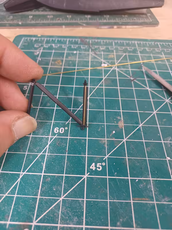

Great minds think alike Colin.  I had already printed a set with the slot last night to try out the concept. I used a 0.9mm wide slot with a piece of Ø0.80mm brass rod inserted. I can throw some filler over that and smooth it over and no-one will be any the wiser.
20250609-100808.avif

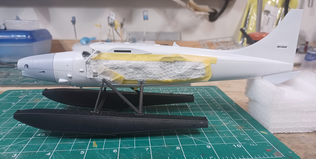

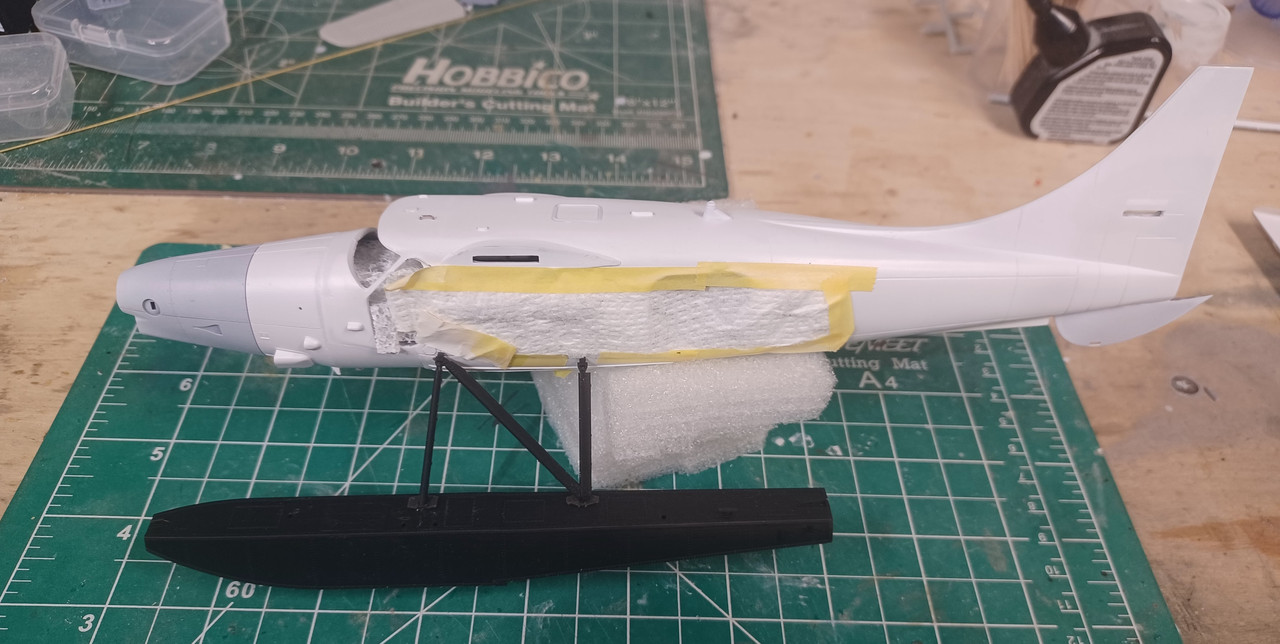

In other news, yesterday I removed 7mm from the overall height of the struts and it's looking a lot better overall.
20250609-102648.avif

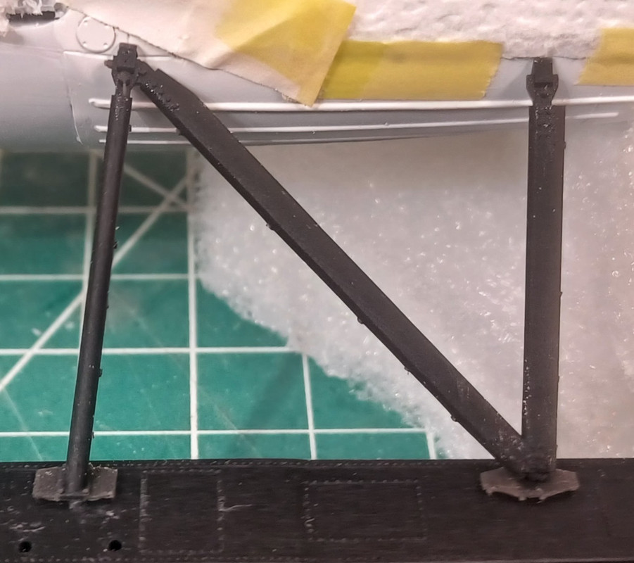

Once the cross braces are glued in place it adds quite a bit of stiffness. I printed the cross braces vertically and that allowed me to have a Ø0.85mm hole all the way through. A couple of pieces of brass rod are inserted into the cross braces to add some strength
Once the rigging is added - and there's lots of it! - I reckon it will be fine.
20250609-103203.avif
I know it's hard to see in these shots but I've added pulleys and brackets on the cross braces in anticipation of the rigging to come. I've also added some pulleys and greeblies to the floats so they're undergoing another print run as I type. Eventually I'll get there... I think I've caught everything now.
20250609-103211.avif
Even just a dry fit shows that things seem to be aligning well. No doubt I can mess that up when it comes to adding :D rigging.
20250609-103331.avif
However, there is still a bit of work to be done.  Removing that 7mm made it sit much better but I think I'm still too high at the rear.
My best guess is that it is sitting somewhere between 2mm and 3mm too high, so I'm running another batch of strut prints with 2mm removed, 2.5mm removed and 3mm removed.  If all goes well, one of those sets will be the magic number.

If you put something under the backs of the floats to level them out (as they would look with an engine pulling the nose of the plane down) you'll get a stance you can compare to a pnoto. I messed around with my Norseman a bit like that.
  • Like 2

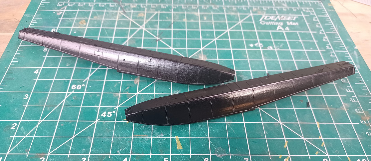

The floats got a coat of gloss black in anticipation of being aluminized. They look very rough here but I've done some testing with my spare floats and they turn out okay. That faceting that you can see on the sides was unintended but once painted up it gives the impression of tin-canning so I'm quite happy to leave them as is.
You may not notice in the above shot, but I have removed the nose from the float and also removed a portion of the back face - this allows me to print the floats (essentially a tube shape) without getting any excess resin trapped inside. The nose cone and the rudder can be attached when the time comes.

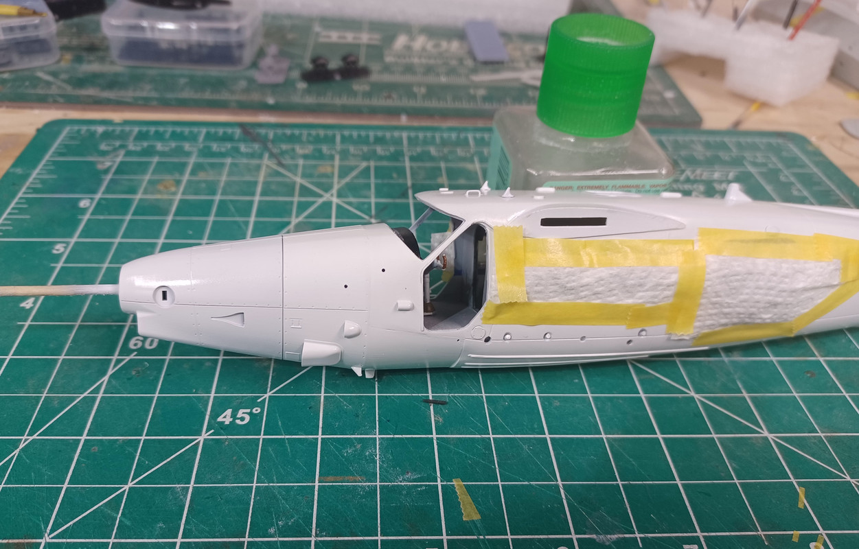

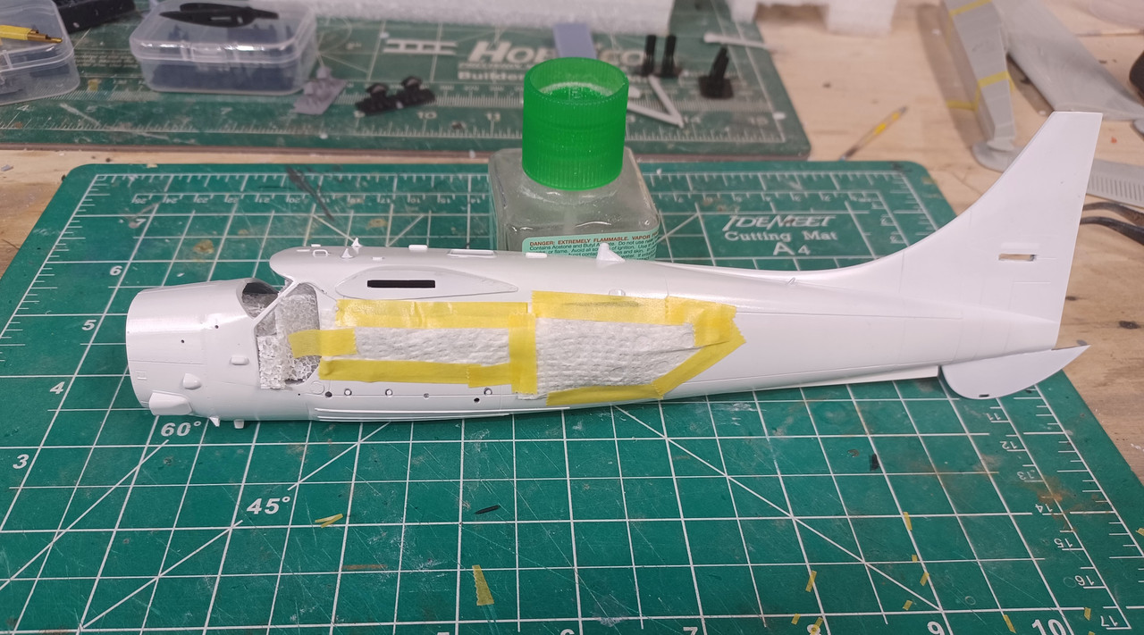

After all that, the fuselage was given a last coat of white and then clear glossed. That seam is still there (obviously) but hardly noticeable now.

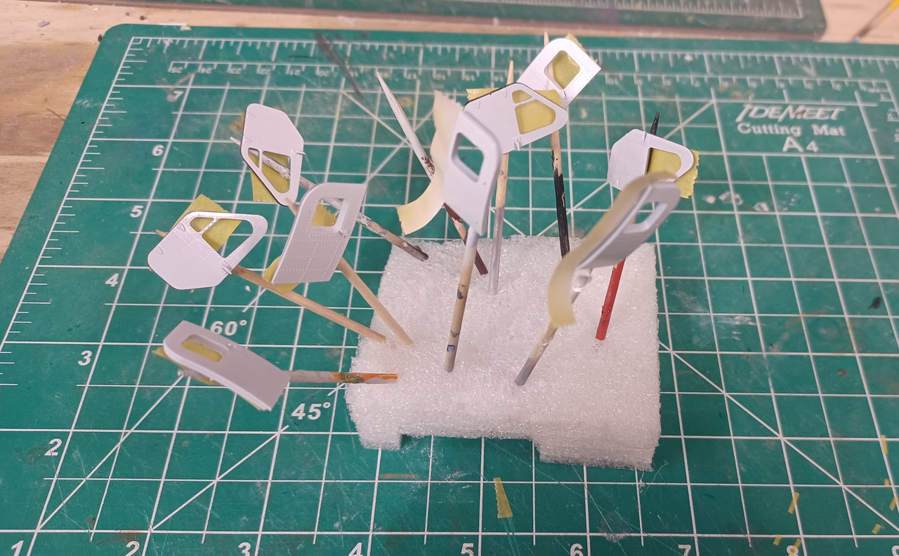

A selection of doors also got gloss coated. I had to do these separately as the doors will be one of the last things to go on to finish this build, and I won't be able to do any glossing after that since doors will be open, windows will be visible etc.

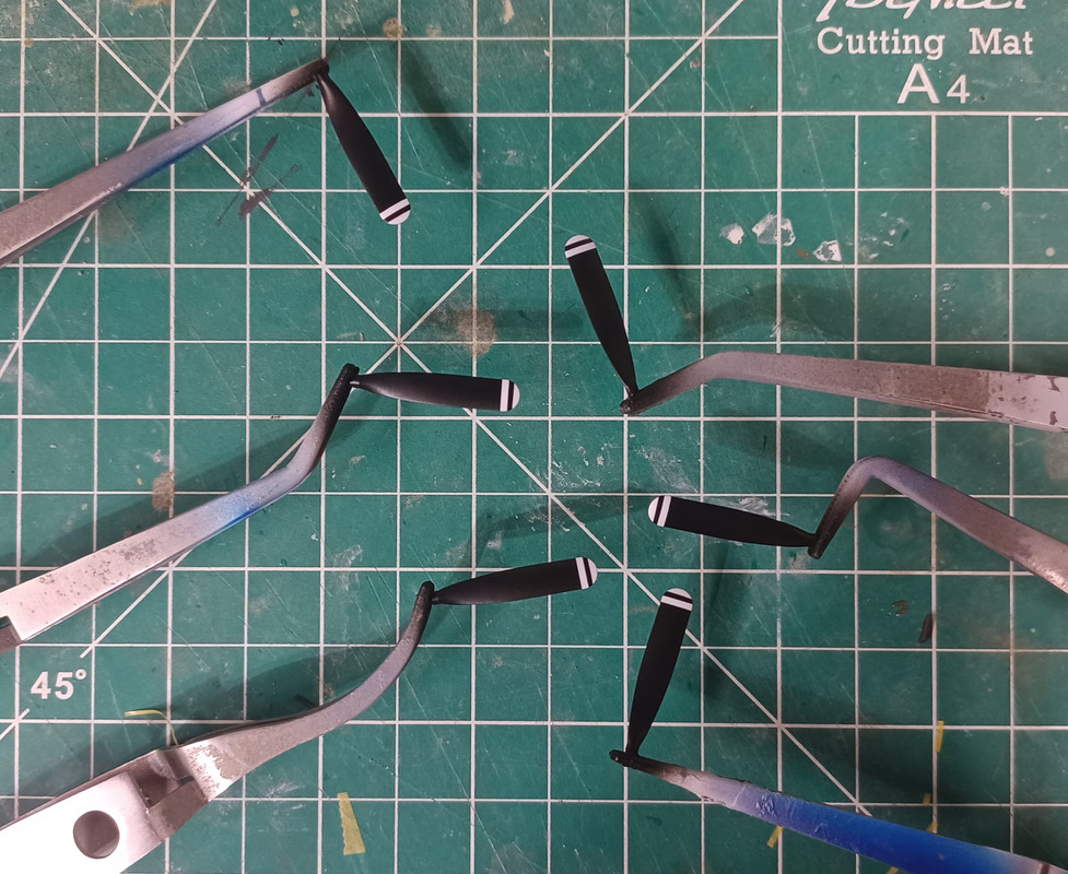

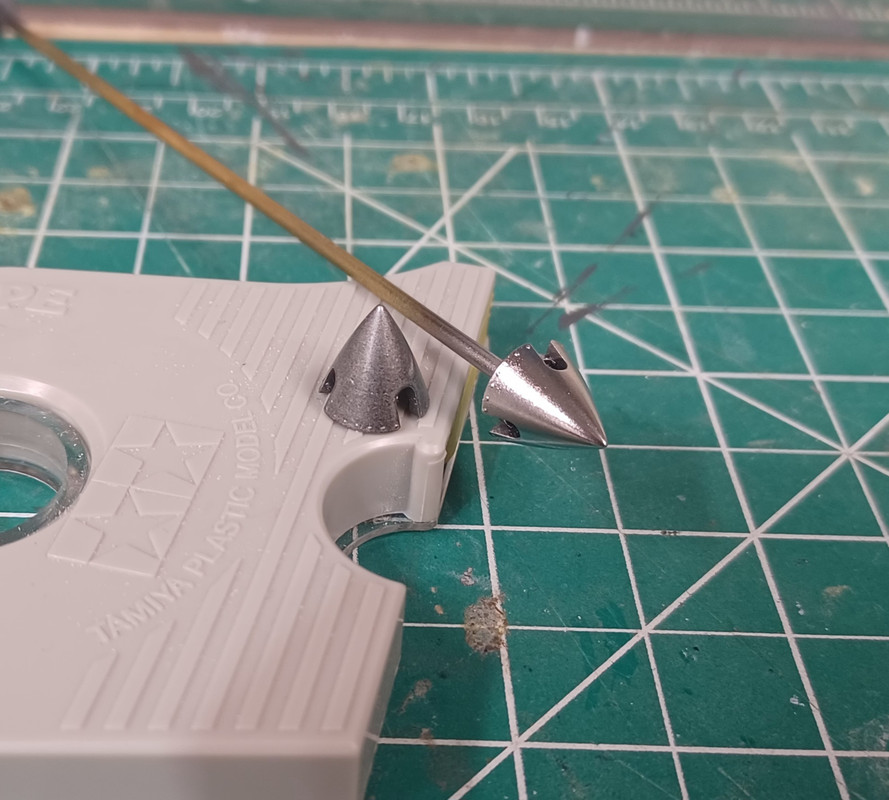

I gave the spinners a coat of cheapo pen chrome. The one on the left has been clear glossed and looks terrible in comparison to the one on the right. If I remember correctly, I think the last things I chromed were left for days to cure then I only handled them with nitrile gloves on and the finish stayed intact - I think that will be the plan going forward.
The fuselage had been left overnight to let the clear gloss harden up and with that job done it was finally time to fit the cockpit furnishings, not that you can see much once they're in.
