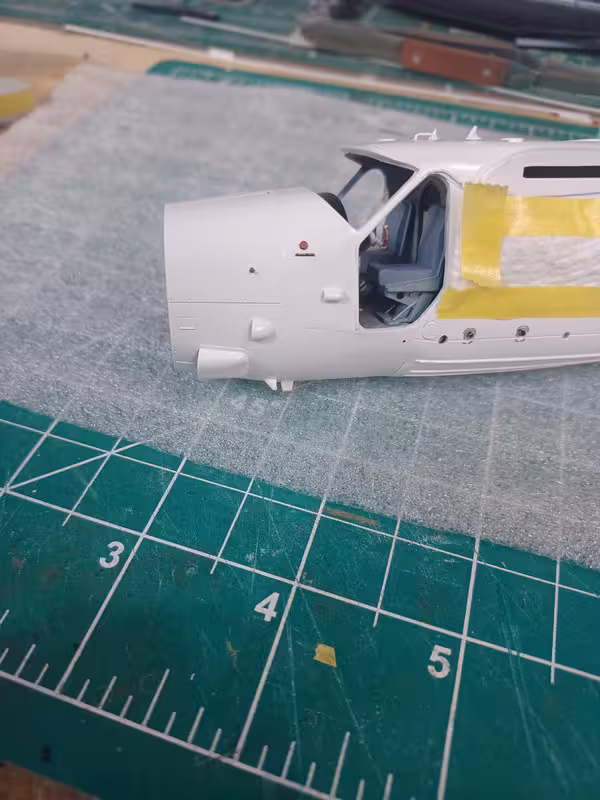

Starting off with something easy today to ease myself in. (The mojo is waning lightly).
I added some small vent/pipe thingy sticking out the side of the nose, along with a red cap for filling up something inside. Scrabbling about in my deal stash I found a completely illegible decal that looked like appropriate labeling so it was duly stuck down.

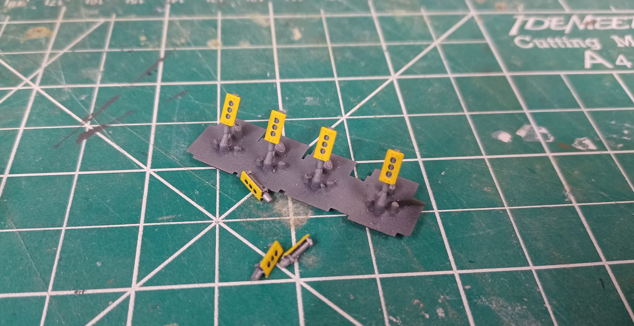

Still avoiding all the scary work to be done ahead of me, I printed up and painted some steps for the front strut.

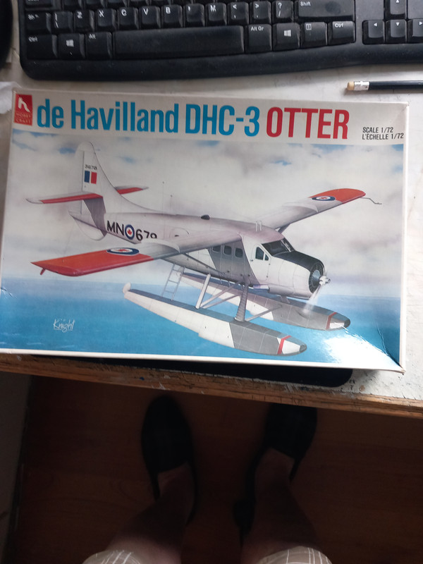

Oh dear, what made me do this?
Anyone?

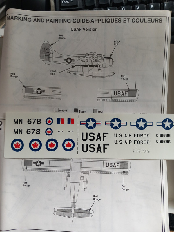

It is really a Hobby Craft Otter and I intend, at a later date acos I'm busy, to emulate my hero with a sweet turbo Otter..
But huge drawbacks await
I was hoping they might have drawn different sketches to mould from.
They didn't.
Decals, utterly horrid
The red is misaligned by a mile, luckily I do not want to build a turbo Otter so the decals won't matter but what will is the wing to fuselage join, set too far forward just like the 1/48th one Hendie is working on.

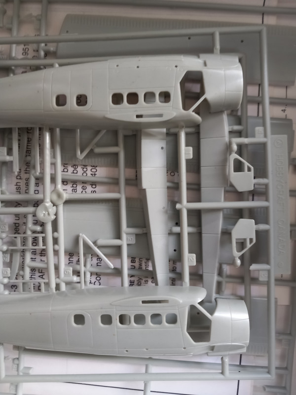

QW established that the wing is set way too far forward of the sloping panel line, work to do there and as I haven't started I may be able to sort it before any work got done unlike Alan having to go ahead with the window adaptations.

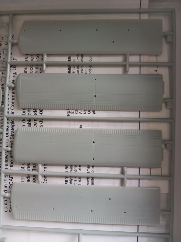

A thing that does fill me with dread the ribs on all the control surfaces, they're all innies when they really must be outies...
The leading edges might be easier to droop in 1/72 scale though

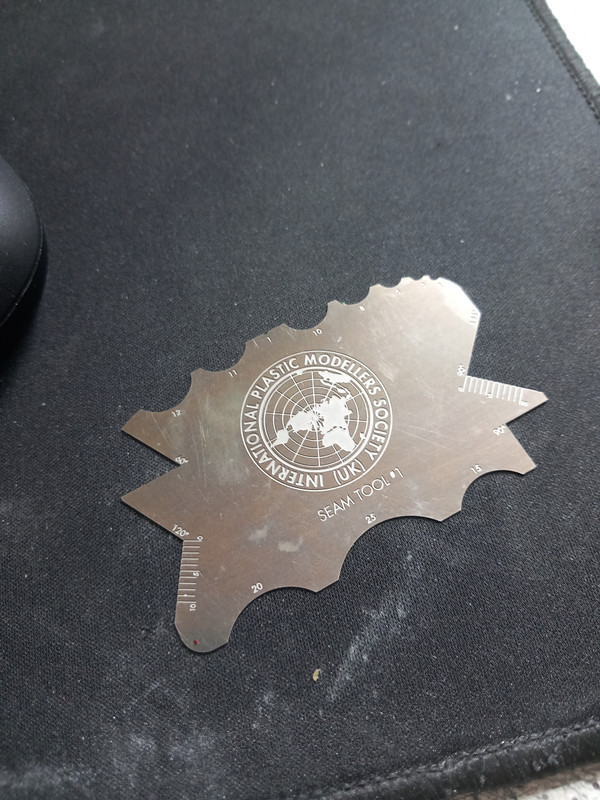

Perhaps even this might help.
I might need help with sketches though if you felt inclined at a later date

On 18/06/2025 at 20:03, hendie said:
…along with a red cap for filling up something inside. Scrabbling about in my deal stash I found a completely illegible decal that looked like appropriate labeling so it was duly stuck down.
In my head the illegible decal says 'Something'. Glad to help :D
As far as I can tell, Bill, the flaps and ailerons have innies while the rudder and elevators have outies.

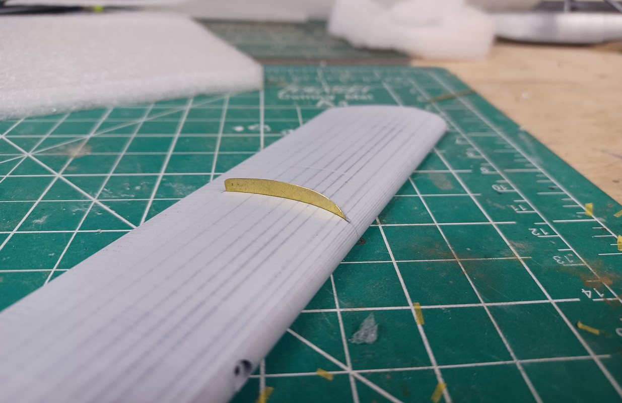

More elephants - this time the wing fences. It will come as no surprise that the kit parts are pretty atrocious and not worth bothering about. Brass seemed the order of the day here so out came the 0.005" sheets.
5 Thou' seemed very flimsy so I ordered some 0.010" sheet and when it arrived I decided it was too chunky. Hey ho.  Back to the 5 thou' then.
The process began with scribing a 0.2mm wide slot in the wing. That was pretty hairy to begin with but once I had the first few passes it became a lot easier. My very inexpensive Chinese scriber was the tool of choice - I'd be lost without that tool.
Once the slot was deep enough, I made up a rough template and it was a process if fit, file, fit file ad nauseum until I got somewhere near the shape I was looking for.
I used the rough template to shape another two pieces of brass sheet. Then it was time to stick 'em in.
Superglue was the only real choice here - I used a piece of thin wire to weep some superglue into the slot then before it went off on me, forced the wing fence into the slot.
20250623-144209.avif
There's still some final shaping to be done but the pieces were getting too small to handle and I kept bending one or the other. I figured it was easier to glue them in position then do the final shaping in situ.
