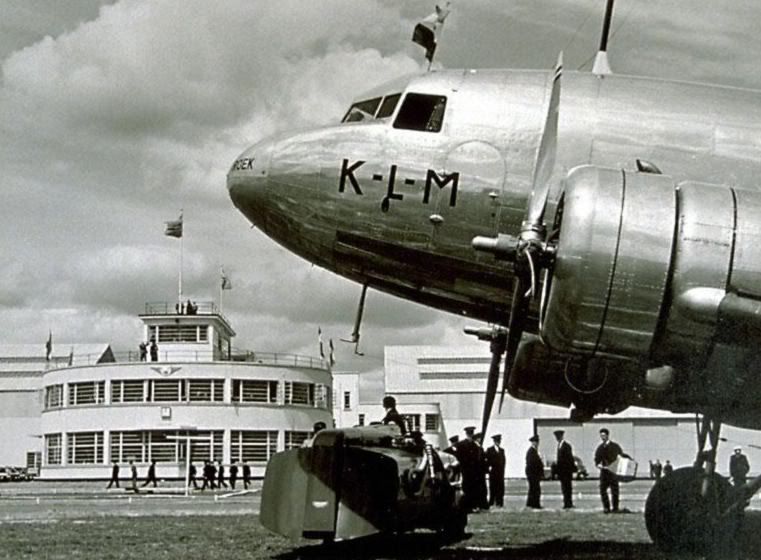

dnl42 Posted April 16 Posted April 16 On 4/8/2025 at 10:02 AM, John said: This is my target: John Is that a DC-2? 1
Archer_VC10 Posted April 16 Posted April 16 (edited) No, a DC-3, I'm pretty sure it's PH-ASR named 'Roek'. See also the photo on this page (one third down): https://www.thisdayinaviation.com/tag/dc-3-194/ Wanted to add: The C.R. Smith museum in Dallas, TX, has a nice early model DC-3 on display. This one: Edited April 16 by Archer_VC10 Added photo of C.R. Smith museum's example. 1 1
John Posted April 16 Author Posted April 16 It is PH-ASR. Photographed at Grangemouth on July 1st 1939. John
Archer_VC10 Posted April 16 Posted April 16 In those days, KLM aircraft were named after bird species with the first letter of the species corresponding to the last letter of the registration. A helpful feature if you're trying to identify an aircraft from an old photo. 1
