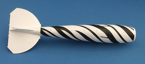

Fiddly as it might be. I'd be tempted to get the Tamiya masking tape out and paint it. I did it a few years ago on a Wingnut Wings 1/32 Albatros, admittedly easier to do in the larger scale for my ageing eyes!
The key to it was realising what this scheme looks like on the underside, it is not a set of black bands that wrap constantly around the fuselage. I spent ages winding strips of tape around to work out what was going on.  I concluded that the only way it could work was like this:
John
John,  that looks terrific!   I am a fan of painting markings where I can, even in 1/72.   I have actually toyed with the idea painting it, but the above photo makes the job look harder, not easier!   An annoying complication is the fact that the Eduard kit has the lower wing and fuselage bottom as one piece…and the engine needs to go in before closing up the fuselage.
I suppose I could just tape the fuselage together without the wing and engine, mask and paint, then take it apart enough to get the engine in, and finally fill in the missing bottom bit after adding the lower wing….
