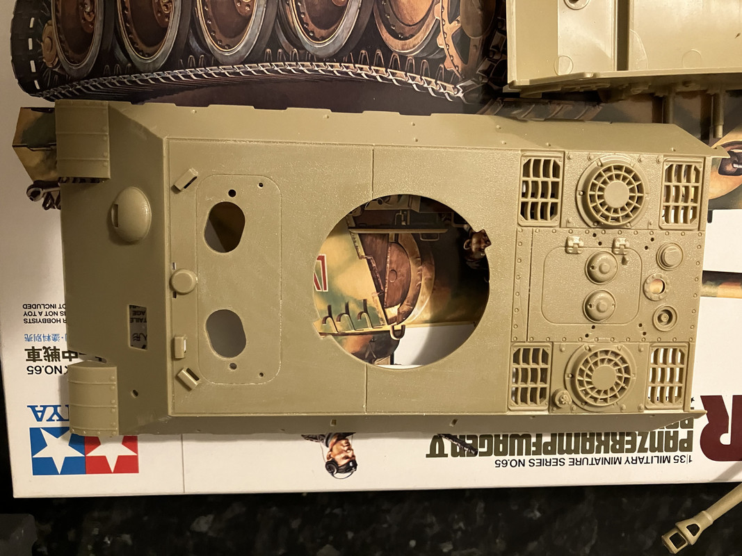

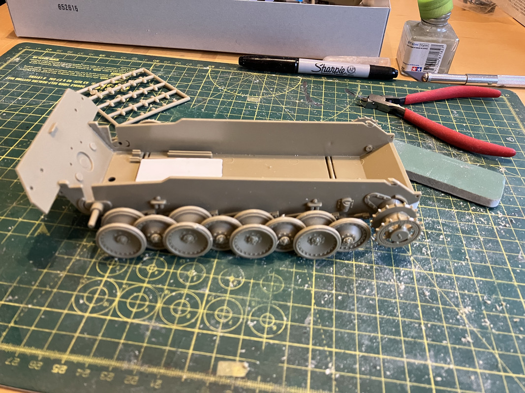

 Basic assembly of the main structures took about an hour or so as their are very few parts (which is right up my street):

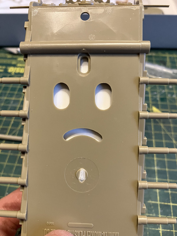

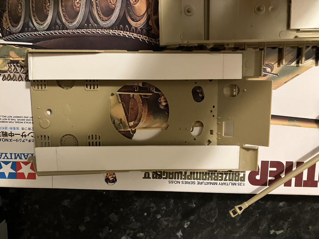

Beneath the plastic evergreen sheet is the old panther sad face. I’ve just blanked it out as not too fussed on removing completely as won’t be seen. I’ve added a couple tiny bits of styrene sheet to square off the bit at the front glacis which is shaped wrongly on the kit.

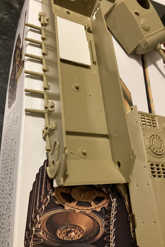

  IMG-2671.jpgThere are no sponsons on the kit so I’ve made a start on making them up with styrene to fill the gap. This needs more work though and I might build up some boxes to go under the engine grills to blank them off.
   IMG-2672.jpgOn the top theirs few seams which I’ve scribed in as the top plate was made of three sections (one of the seams I’ll fill in as it was too far forwards on the kit). I’ll also redo the welds at a later stage.

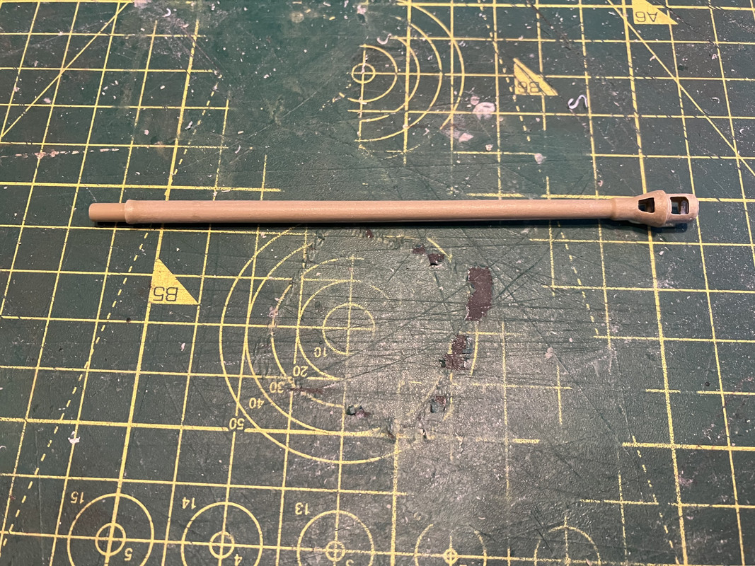

I tried my best to scrub up the barrel:
IMG-2677.jpgBut it’s a bit rough still. I might be using a bit of foilage along it anyway so might not have a lot showing anyway.
  I thought I’d show the panther sad face and torsion bar bluges I was talking about in the first post:

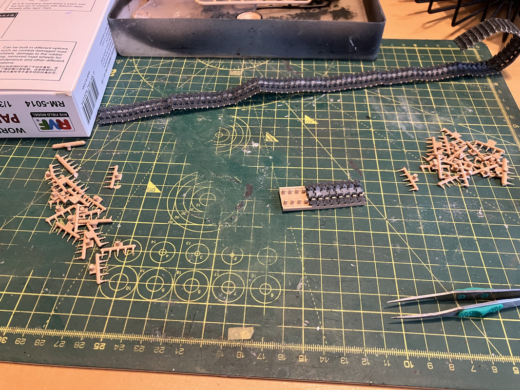

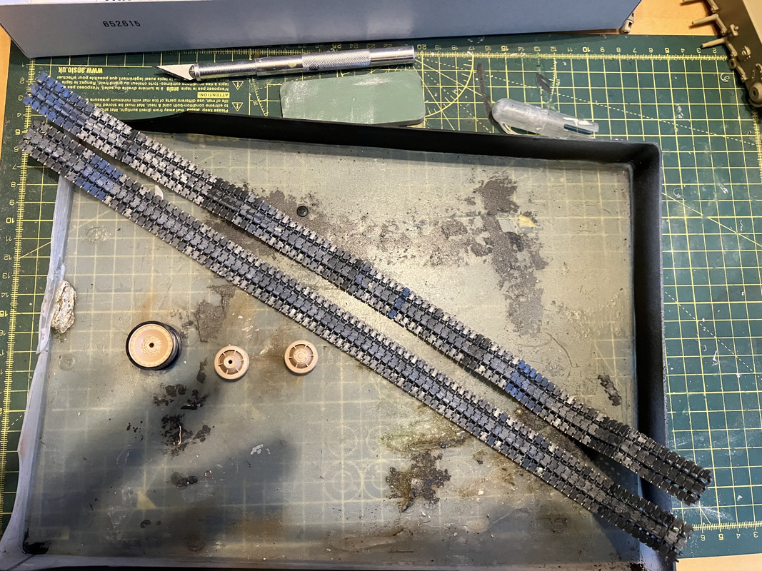

The rfm tracks are ok. They give you a decent jig and a few spare links. No spare pins though! The pins are tiny and delicate and prone to breakage… if you’re heavy handed like me. The holes in them doesn’t go through the whole link but about 2mm through and one pin each side.
IMG-2674.jpgI don’t mind making up tracks it’s mundane but nescary. Think I’ll have to try using styrene rod to fix the pins I broke or lost. Took about two hours per length, roughly.

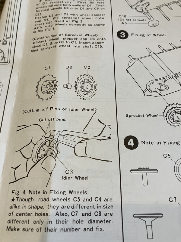

IMG-2679.jpgThey provide two rear idlers which is handy as the idlers on the kit aren’t much cop, the instructions point you to remove the teeth from them before installing:

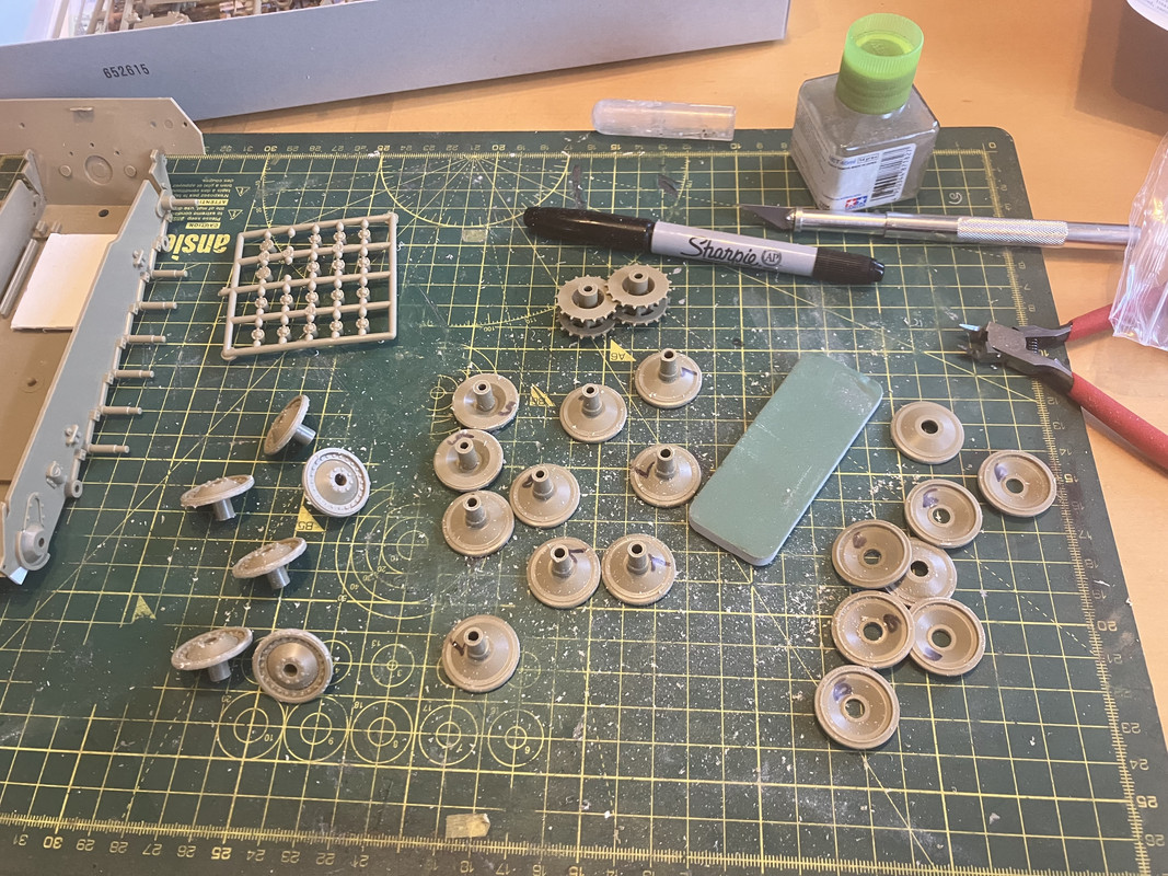

IMG-2680.jpgI’ve cleaned up the rest of the wheels, with a lot of sanding to remove a big bit of flash or a moulding seam which creates a bit of a step at the top of each one:
I’m going to try that thing which most others are able to do where the wheels are all glued together as a set. It’s easy I’m sure but I haven’t been able do it so far. As the wheels are interlocking I’d like to remove and paint separately as a set and then put back on once the lower hull is done:

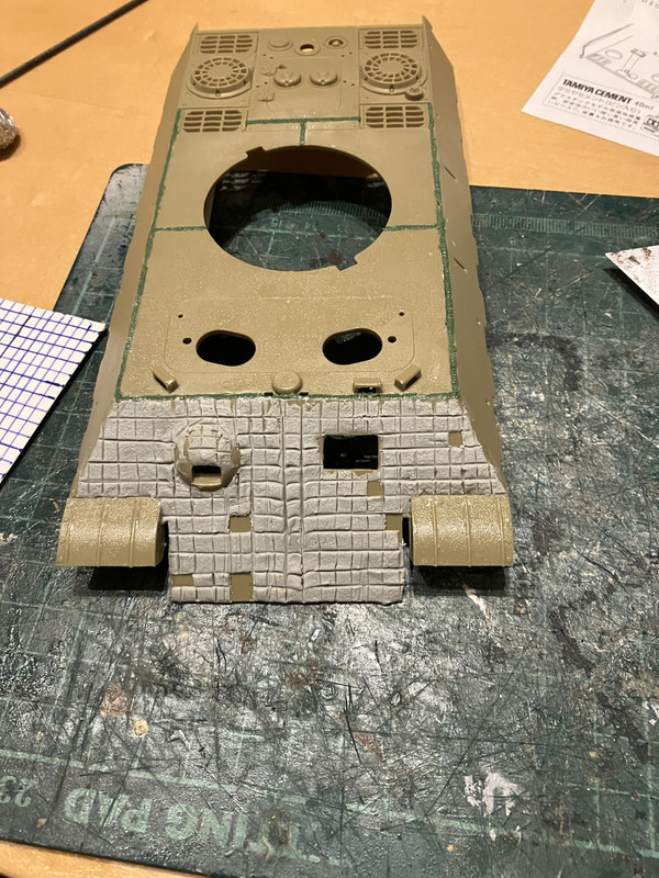

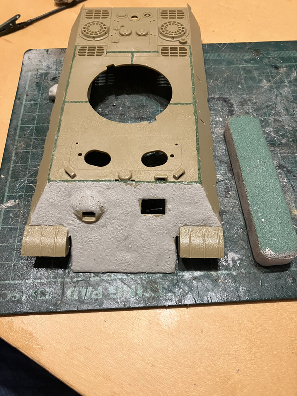

Posted (edited)

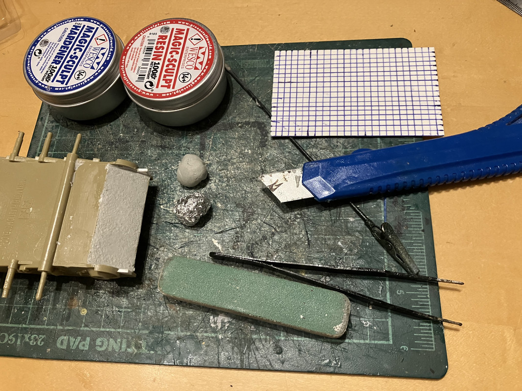

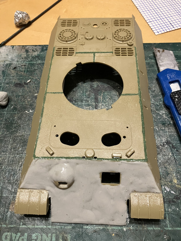

So on with the dreaded zim.

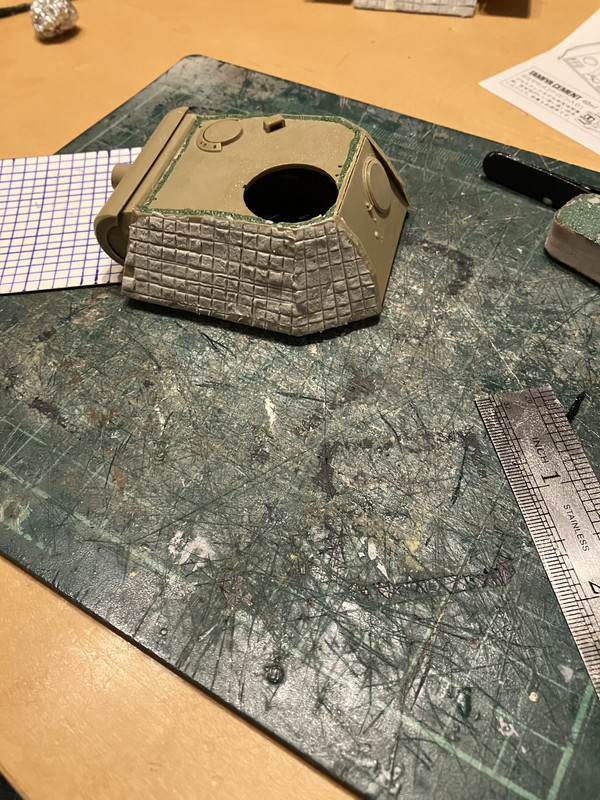

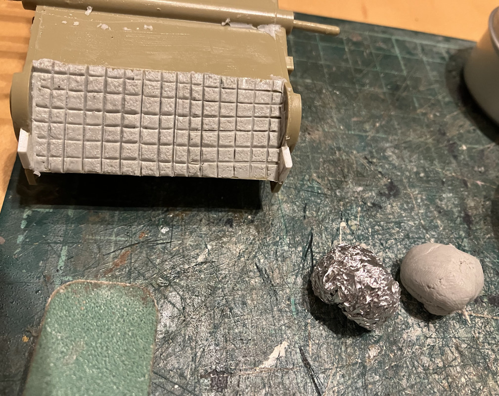

 My tools of choice: the putty as you can see is magic sculpt. I love this stuff, it’s quite tacky, reasonably long working time (about 90 mins but I was t counting.), smooth and easy mix.
   I used the rolled up tin foil ball and sanding pad to ingrain a rough concrete like texture. The metal croc clip I used as a roller and Stanley blade as a smoother.
  The card board tile I used as a template. I looked a ref photo and counted the tiles in a section and then measured that section on the model and divided the tile square by this: measured to 3.3 mm by 3.3mm. I lined up the card tile and used a short ruler (from a cracker!) to impress the tiles.
   Finally I’m pretty happy with this. Definitely think the magic sculpt and easier pattern helped.
    I could only work on one section at a time as not to press my fingers in to a drying side.
IMG-2708.jpgThen I did the upper hull The The below are the steps I took on the front glacis: I pressed/smeared the putty on and used Vaseline for the tools, to stop them sticking and to make it even-ish:
IMG-2703.jpgThis is pretty thin or as thin as I’d like it before it begins to tear or lift.
  As you can see I also did the weld seams from green stuff:
Then I used my sanding pad to make the texture:
IMG-2705.jpgI think this looks rough like zimmerit.
  I stuffed up the pattern on this section as you can see the tiles in the center are mis shaped and unequal so I’ll try hack it off from where I went wrong and try correct it. But again that’s the beauty of the square tile pattern. It’s easier to start from where you left it.
IMG-2706.jpgI picked a few tiles out as if they were damaged.

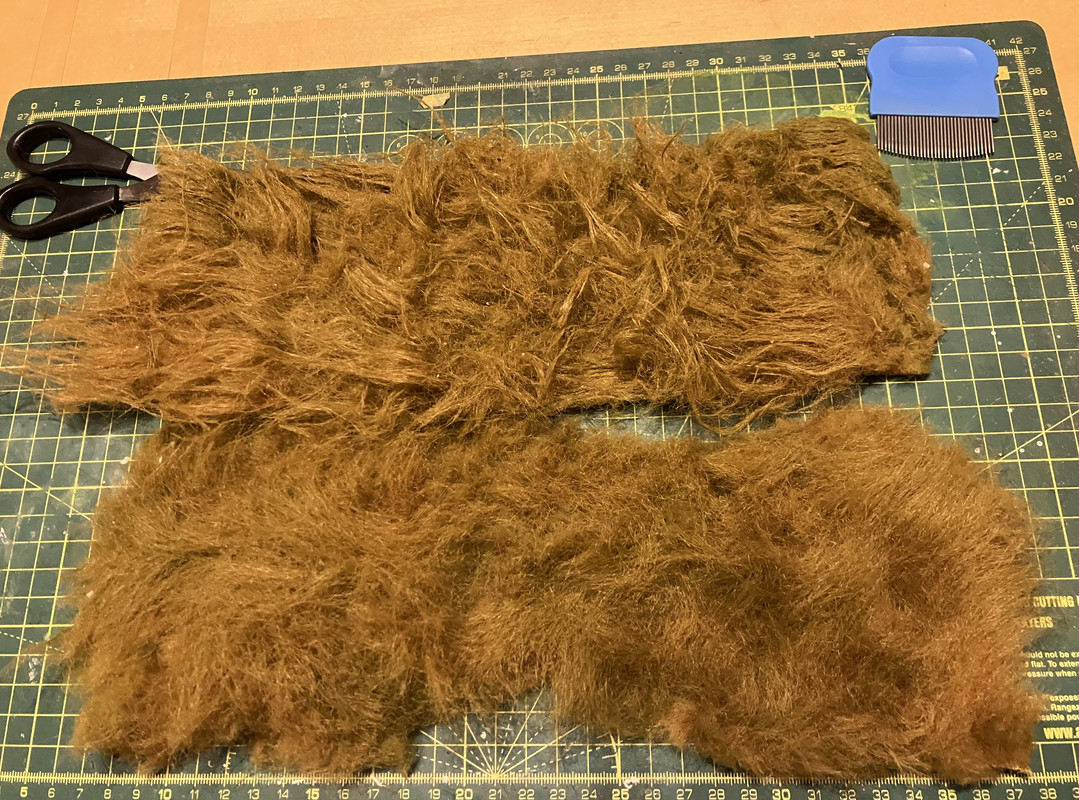

   With this moving along I started on the base. Well the grass for the base. I want to try something different:
   A A4 size sample of chestnut coloured fake fur. I’ve seen this look quite effective once painted so I’m going to use the Vallejo colours golden olive and olive green to colour it. But first it needs a trim:
IMG-2710.jpgUsing the scissors I cut random clumps out of this, as it’s to represent wild meadow grass. I’ve used the pictured steel comb to try get out the loose fibres and ragged parts. The top section is uncut and the bottom section is cut and combed.
   I’ll try add the paint at a later time and see how it turns out.

Zim's looking very authentic Paul. The only problem is the bit you've already pointed out, so all good. I don't know how you stumble on these ideas but the fake fur is a touch of genius. :thumbsup:
  • Thanks 1
I think I’m always coming up with weird stuff! Sometimes they hit the mark and some times they don’t but I’d still rather give it a go.
    I’ll find out tonight how hard this stuff is to remove once set! Might be a total mare.

Posted (edited)
1 hour ago, Muchmirth said:
I stuffed up the pattern on this section as you can see the tiles in the center are misshaped and unequal
Zimmerit was applied by hand in sections and was never straight and even across the whole tank, so I'd say you made it accurately misshaped :P

Lovely work on the zimmeritt .... it looks 'right'. 👍
Thanks Mig.
  Funnily enough the second picture (one above this)  I was looking at for a guide. But now I'm just curious to see how well adhered the epoxy is.

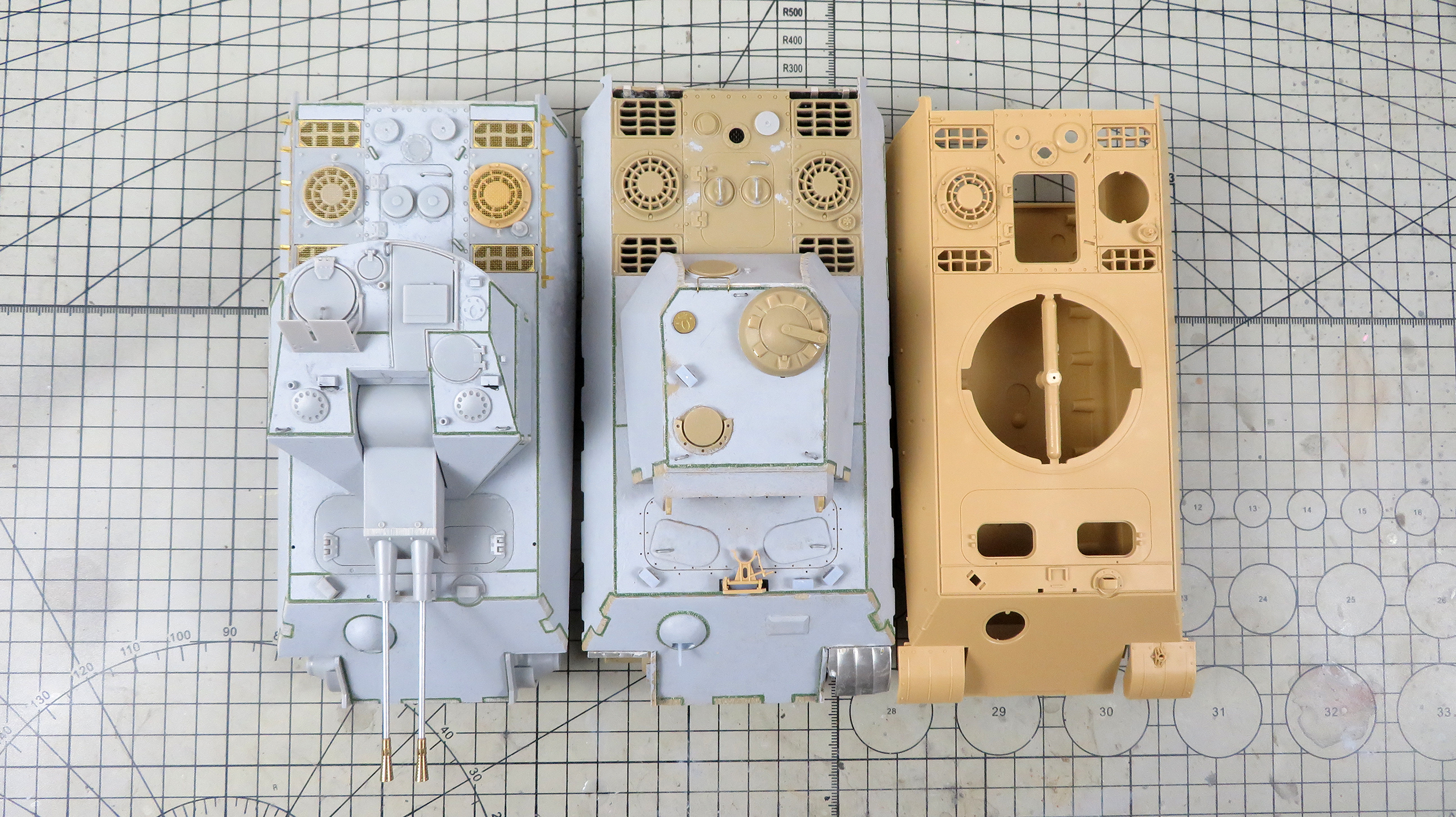

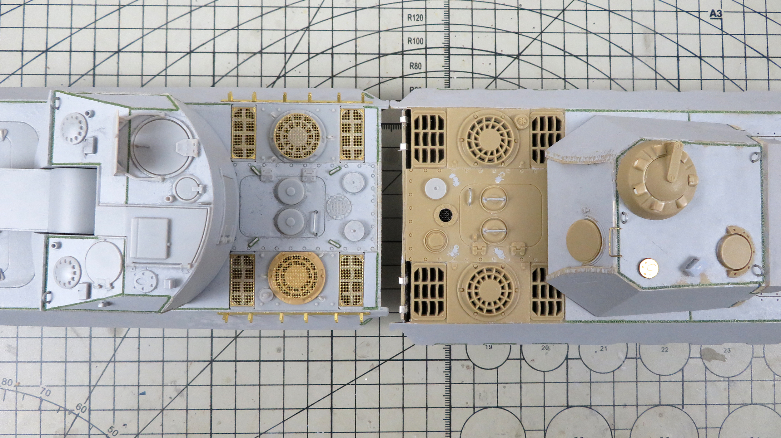

Yes this kit is a bit over sized and probably closer to 1/32 then 1/35, here is my one next to a Dragon and Tamiya Ausf.G.
  • Like 5
  • Thanks 1
