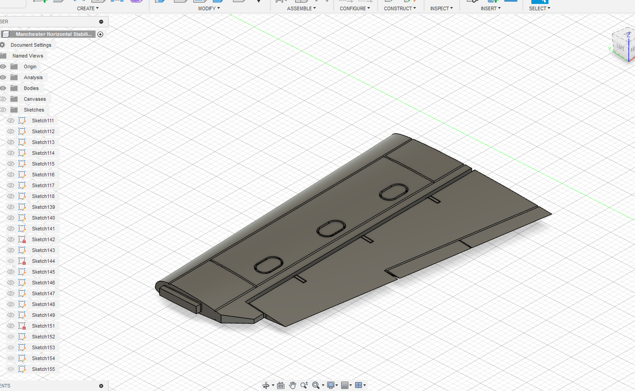

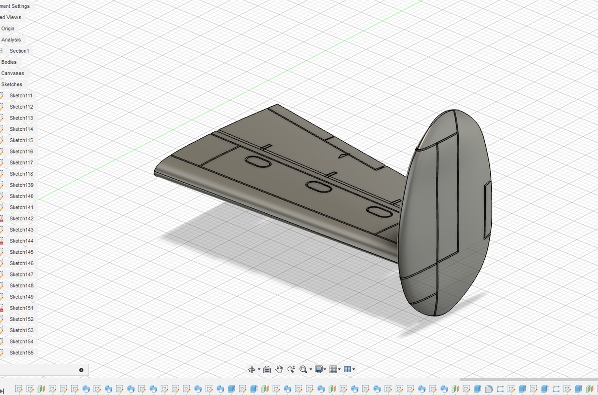

Dunny Posted November 29, 2024 Author Posted November 29, 2024 (edited) Hi All, I've been on a bit of a roll today. Here's the port horizontal stabiliser: Here's the port empennage assembled: Looks like a bought one! That will give an overall span of 28', rather than the 33' of later Mancs and all Lancs. I have still yet to figure out the junction with the fuselage - I'll replicate the kit engineering, but will test the fit between this & the vertical element before doing so. I'm a bit weary of panel lines for the moment, so I might start to have a crack at the dorsal turret, Thanks for looking, Roger Edited November 29, 2024 by Dunny empennage image 12

bigbadbadge Posted November 29, 2024 Posted November 29, 2024 Tail plane looks good Roger, more great work fella Chris 1

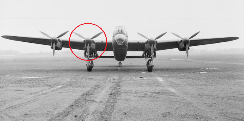

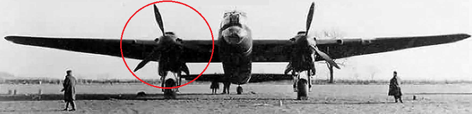

Dunny Posted November 29, 2024 Author Posted November 29, 2024 4 hours ago, Dunny said: Rob, Thanks for that - I may just use the kit propellers in that case, although it does not account for the 3mm difference in diameter from kit to schematic (which could, of course, be wrong). Appreciate the input, Cheers, Roger The information provide by @Rob G piqued my curiosity, as it would make more sense for the Vulture to be driving a larger propeller than the considerably less powerful Merlin. I therefore did some most unscientific reckoning using some suitable photos. Here's the Vulture propeller diameter: And the equivalent photo of a Lanc: From the pilot's notes I know that the undercarriage track for both aircraft is identical at 23'9", and therefore that the spacing of the nacelles is identical on both aircraft. Even allowing for parallax error (and my hamfisted attempts at annotation), I would say that the Manchester propeller tip sits considerably closer to the fuselage than the Lanc's. The plot thickens... 4
Dunny Posted November 29, 2024 Author Posted November 29, 2024 1 hour ago, Rabbit Leader said: Looking Good! 51 minutes ago, bigbadbadge said: Tail plane looks good Roger, more great work fella Chris Thanks Gents - I'm studiously avoiding work on the mainplanes... 1
Rob G Posted November 29, 2024 Posted November 29, 2024 The photo of the Manchester isn't quite perpendicular, the Lancaster is close. Have a look at the relative positions of the ends of the Manchester tailplanes in relation to the undercarriage legs - our left side seems to end at the inner leg, while our right definitely continues across behind the other inner leg, it touches the tyre. The Lancaster photo has both tailplanes running across to the outer gear doors. May I suggest repeating the circle with the port propeller, to see how it compares with the stb? In the end, you'll get no grief from me either way, I was just adding the information that I had found. All that said, a bit more looking, before I posted the above led me to the following forum chat that may be worth a deeper dive. It points to Manchester props being larger, as you surmise, as well as having an absolute shedload of prop minutiae. Sigh. https://www.key.aero/forum/historic-aviation/146954-de-havilland-decoder-part-one?page=0 If only 'they' had kept proper records. 1 1

elger Posted November 30, 2024 Posted November 30, 2024 I set aside some Stirling propellers in case I would ever do a 1/72 Manchester conversion because I remember reading somewhere (don't remember where) that these would be suitable. Did the Vulture's propellers spin in the opposite direction of a Merlin like the Bristol Hercules? 1
Dunny Posted November 30, 2024 Author Posted November 30, 2024 19 minutes ago, elger said: I set aside some Stirling propellers in case I would ever do a 1/72 Manchester conversion because I remember reading somewhere (don't remember where) that these would be suitable. Did the Vulture's propellers spin in the opposite direction of a Merlin like the Bristol Hercules? Elger, Just looking that the above photos of the Lanc vs. Manc it looks like they may spin in the opposite direction - well noted, Cheers, Roger 1
Graham Boak Posted November 30, 2024 Posted November 30, 2024 The Merlin was the last major British engine to turn in the "wrong" direction. The RAE introduced a ruling to ensure that. Early enough for the Griffon to comply and apparently the Vulture too (see above). Handed engines required different gearboxes to reverse the rotation before reaching the prop. 2

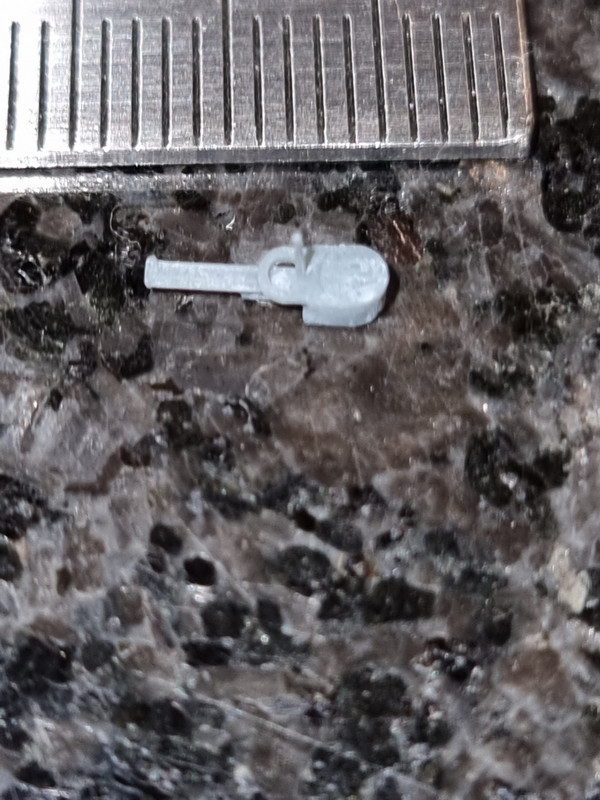

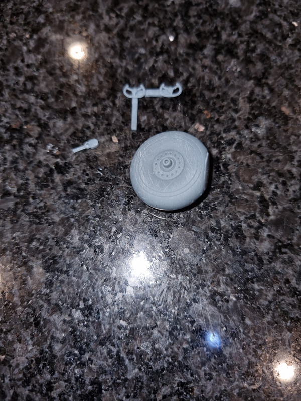

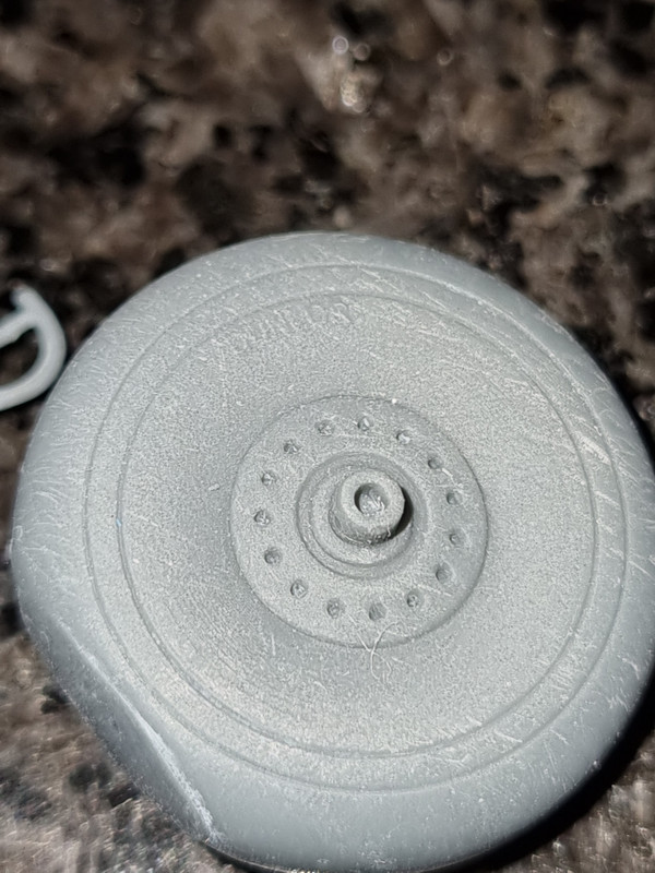

Dunny Posted December 1, 2024 Author Posted December 1, 2024 Hi All, Well the results of the test print are quite pleasing. Here's one of the main wheels: Macro photography is not kind but the 'Dunlor' is just visible! 😍 Pretty impressive given that it's only 0.1mm tall! Talking of small things, here's the Mk.IX bombsight: Yes, dear reader, those are mm marks on the ruler. Here's a final shot showing the wheel, bombsight and control column: Not looking too bad, although I think I need to get a softer brush for cleaning parts... Thanks for looking, Roger 12 1
Dunny Posted December 1, 2024 Author Posted December 1, 2024 1 hour ago, TheyJammedKenny! said: Wow! Those look superb! Thank you TJK!
bigbadbadge Posted December 1, 2024 Posted December 1, 2024 Agreed, they do look fantastic Roger, great work fella. Chris 1
