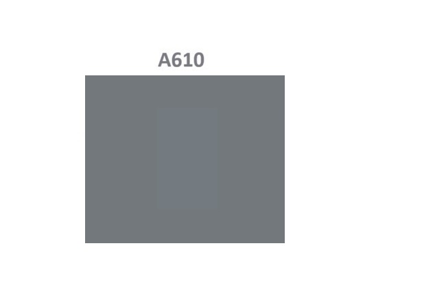

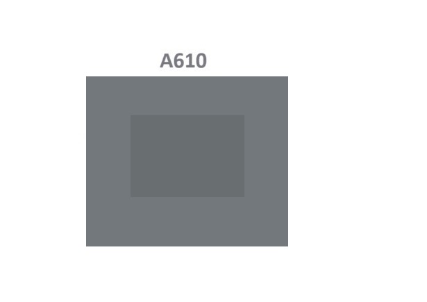

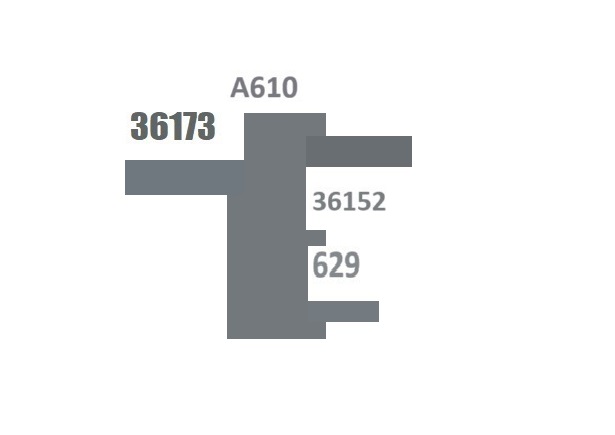

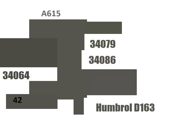

PhantomBigStu Posted January 5 Posted January 5 (edited) Here are my infographics, as said revell aqua 42 and humbrol 163 are really good for the green, as long as its not too green a 34079 is still ok. Grey is still problematic (great for me as I'm planning a mirage iii using it), now its daylight I'm not convinced by the chip looking at the real thing it looks darker on the real thing, also looks bluer but thats standard for lot of greys, they look bluer on real planes and models vs the raw chips Edited January 5 by PhantomBigStu 2 1

Paul Lucas Posted January 7 Posted January 7 On 05/01/2025 at 11:01, PhantomBigStu said: Here are my infographics, as said revell aqua 42 and humbrol 163 are really good for the green, as long as its not too green a 34079 is still ok. Grey is still problematic (great for me as I'm planning a mirage iii using it), now its daylight I'm not convinced by the chip looking at the real thing it looks darker on the real thing, also looks bluer but thats standard for lot of greys, they look bluer on real planes and models vs the raw chips So if I understand this correctly, you're happy with Humbrol 163 to represent A 615, but can't decide how to represent A 610 that you think looks something like FS 36173 / BS 381C No.629 Dark Camouflage Grey? If this is correct, may I suggest that you look at Humbrol No.156?
PhantomBigStu Posted January 7 Posted January 7 3 minutes ago, Paul Lucas said: So if I understand this correctly, you're happy with Humbrol 163 to represent A 615, but can't decide how to represent A 610 that you think looks something like FS 36173 / BS 381C No.629 Dark Camouflage Grey? If this is correct, may I suggest that you look at Humbrol No.156? I'm not 100% conviced the chip for A610 is correct given just how blue the grey looks on the real thing though admiteldy if its not a610 there is no other grey in the AFNOR range it could be, I forgot to add paints to the chip before, humbrol 156 is actually slightly darker than the chip

PhantomBigStu Posted January 7 Posted January 7 Interesting and surprisingly given vallejo employ a colour blind baboon their take on FS36173 is actually really close to A610, I have AK's fs36173 on order so hopefully that is suitable as well
RidgeRunner Posted January 7 Author Posted January 7 2 hours ago, PhantomBigStu said: Interesting and surprisingly given vallejo employ a colour blind baboon their take on FS36173 is actually really close to A610, I have AK's fs36173 on order so hopefully that is suitable as well Agreed 1

PhantomBigStu Posted January 10 Posted January 10 On 1/7/2025 at 7:43 PM, PhantomBigStu said: Interesting and surprisingly given vallejo employ a colour blind baboon their take on FS36173 is actually really close to A610, I have AK's fs36173 on order so hopefully that is suitable as well Its arrived, I don't have the ability to objectivity measure it but by eye I like what I've received and will be using it in the heller GB 1
