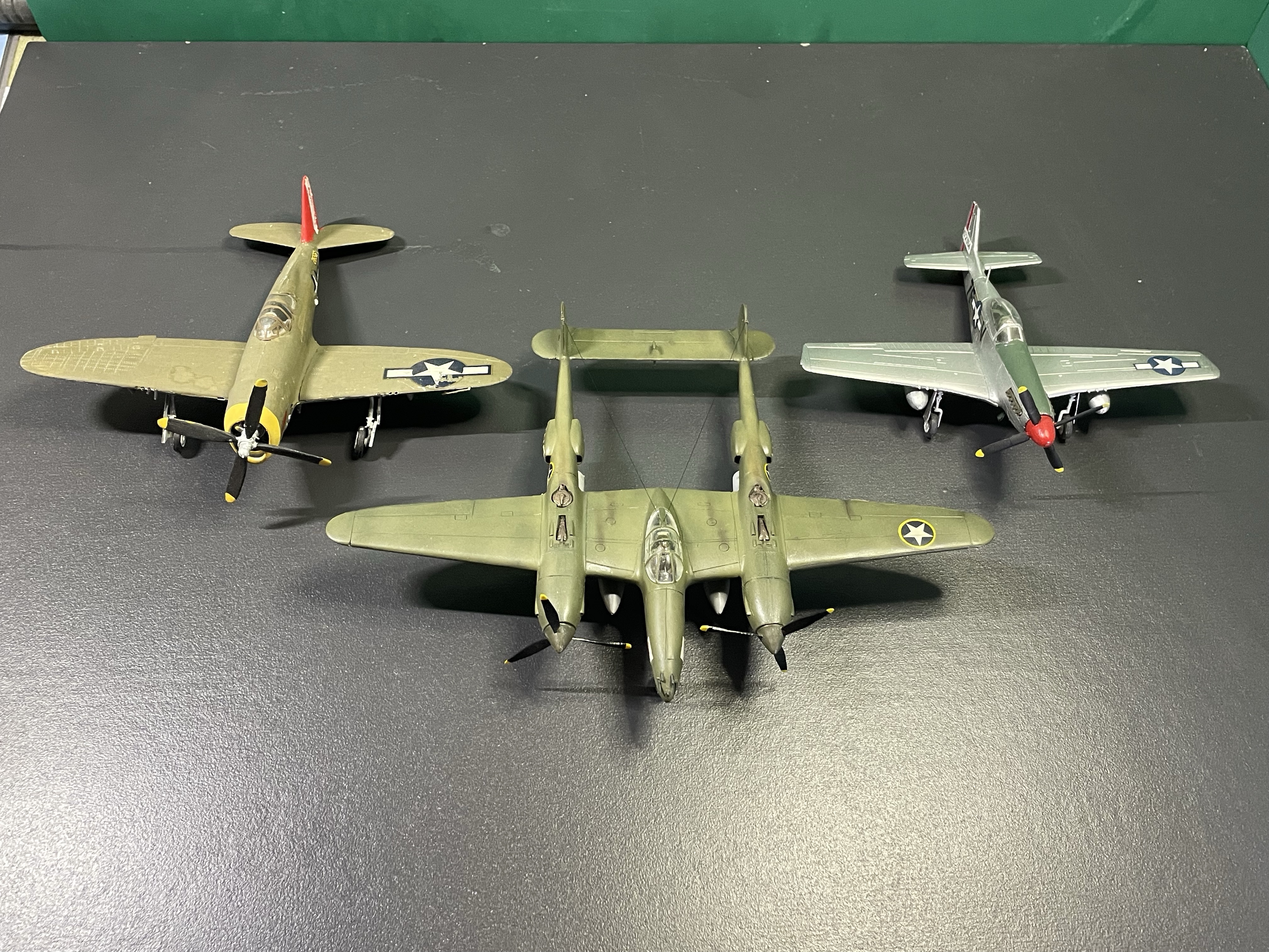

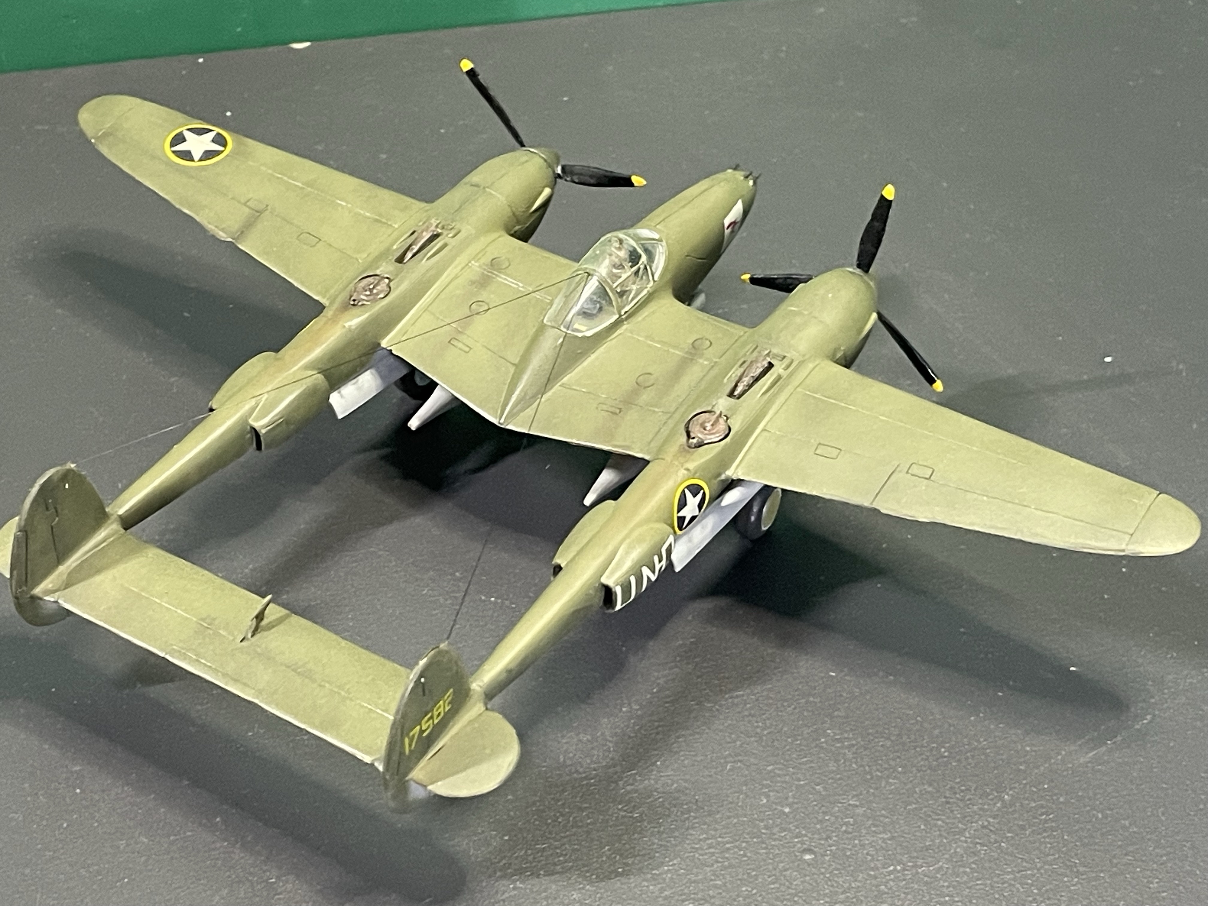

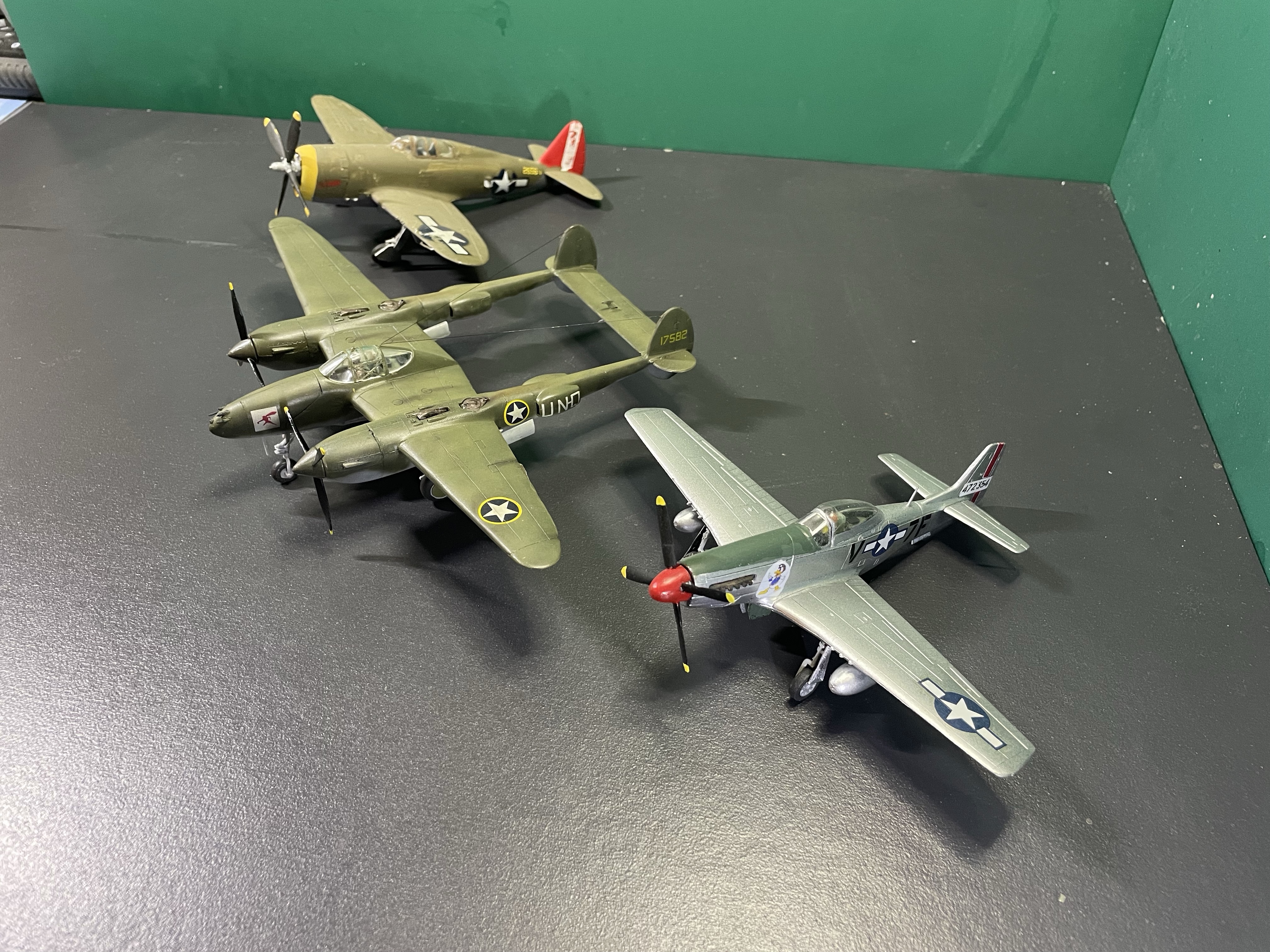

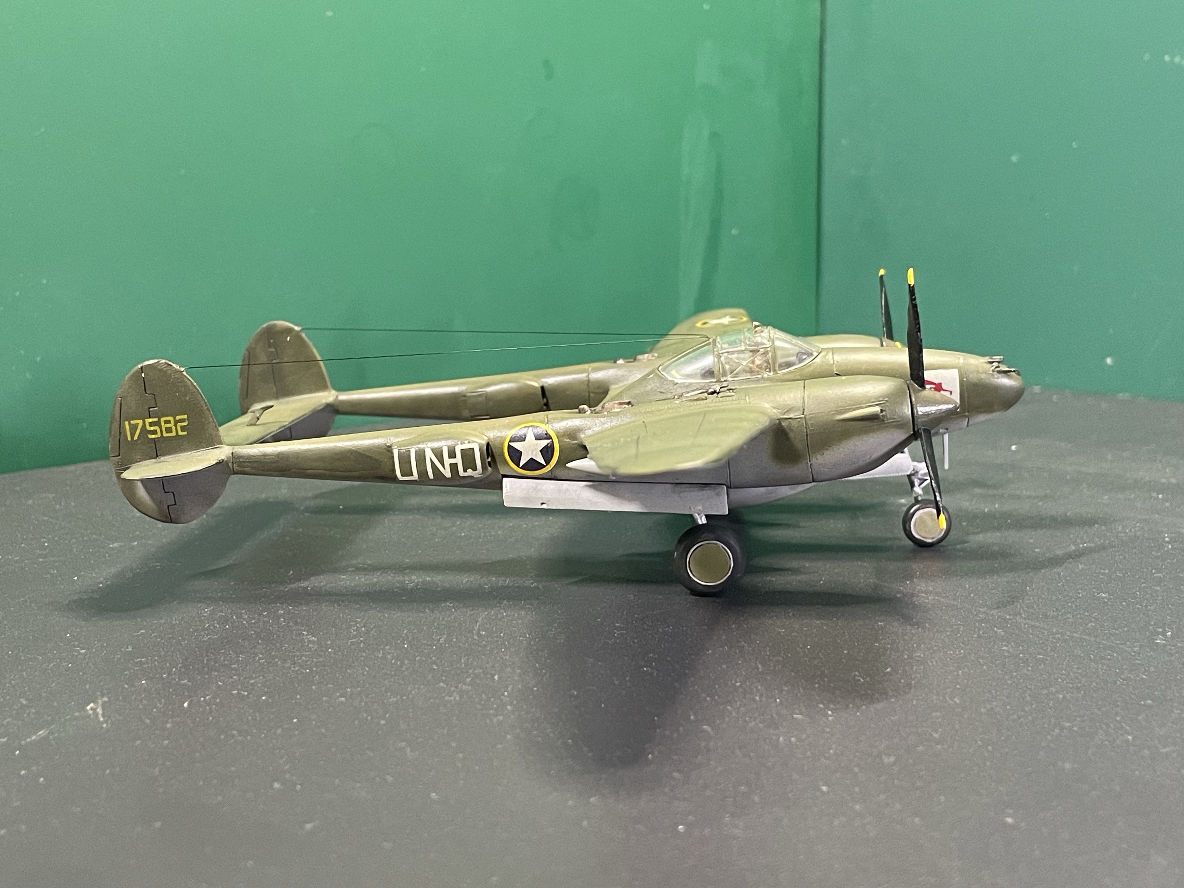

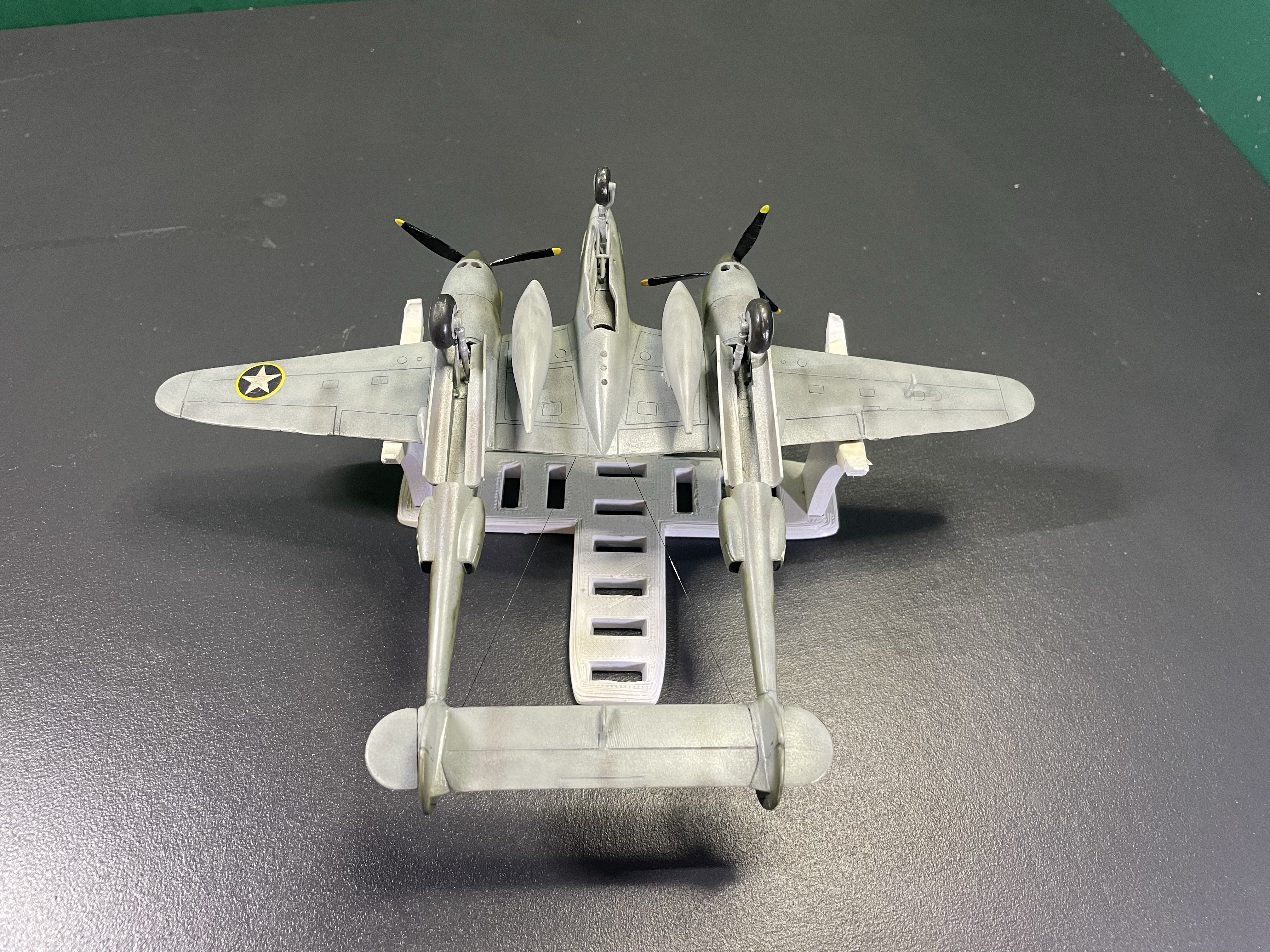

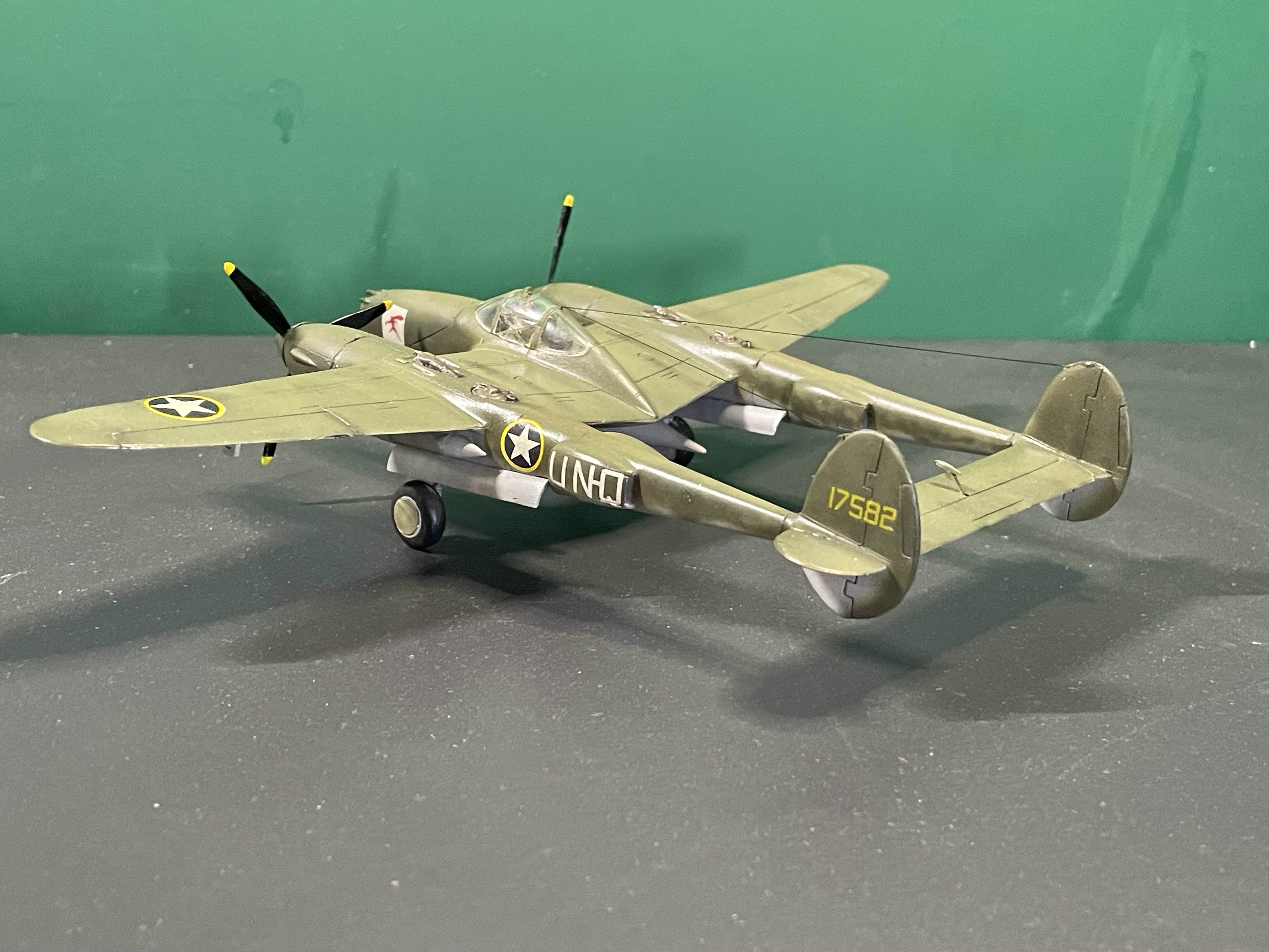

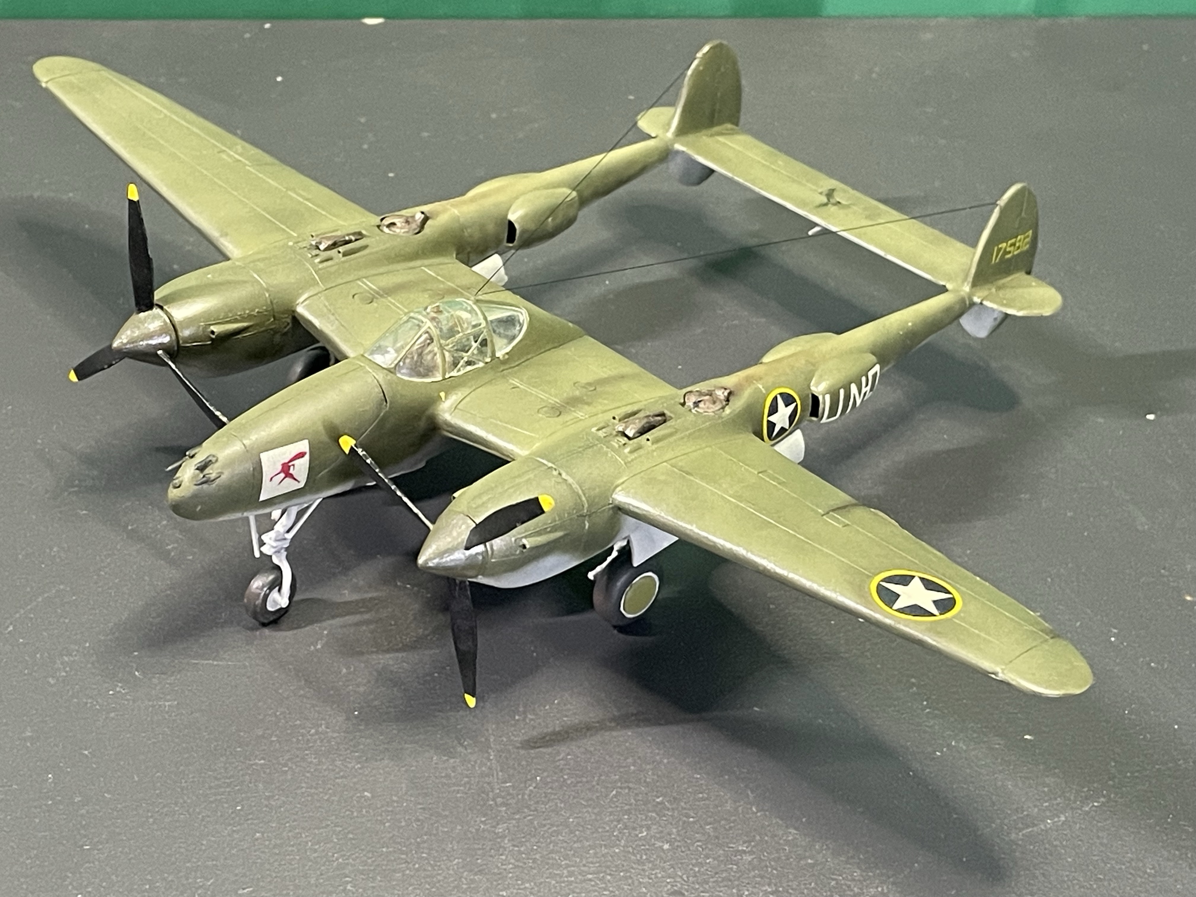

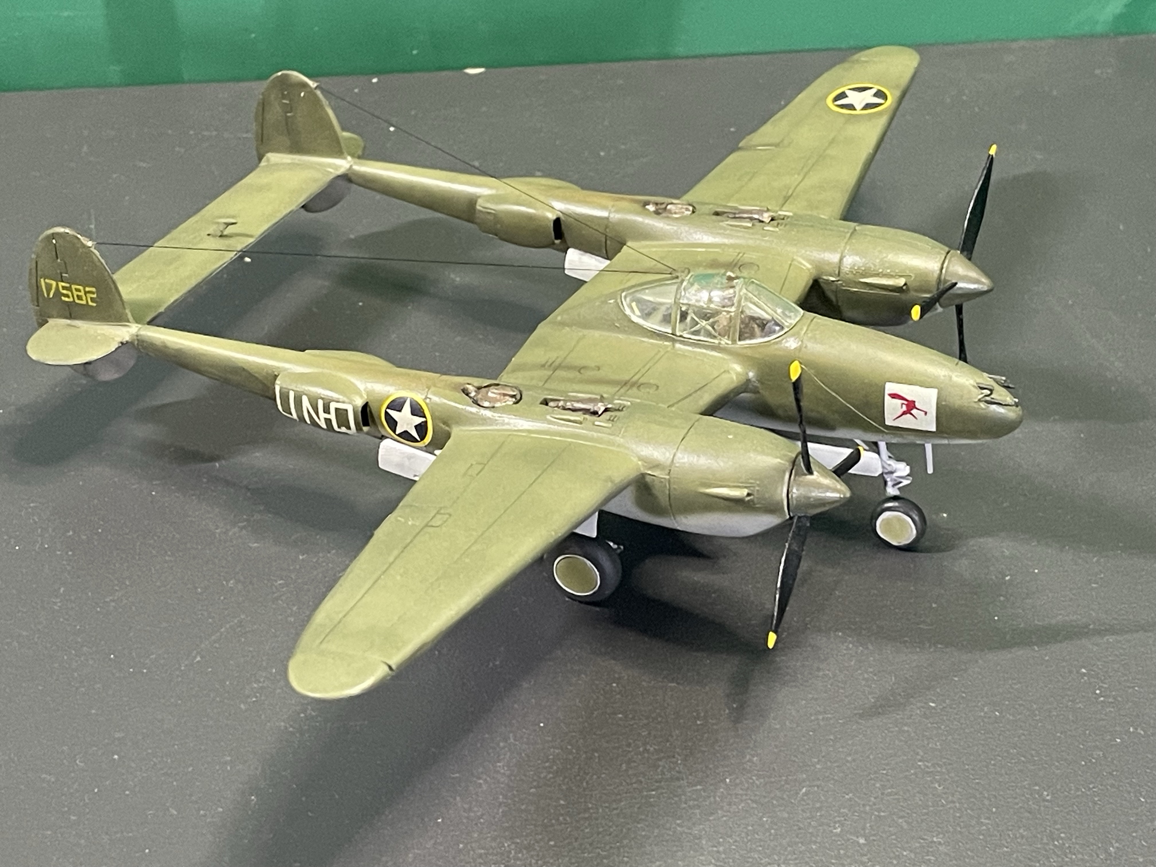

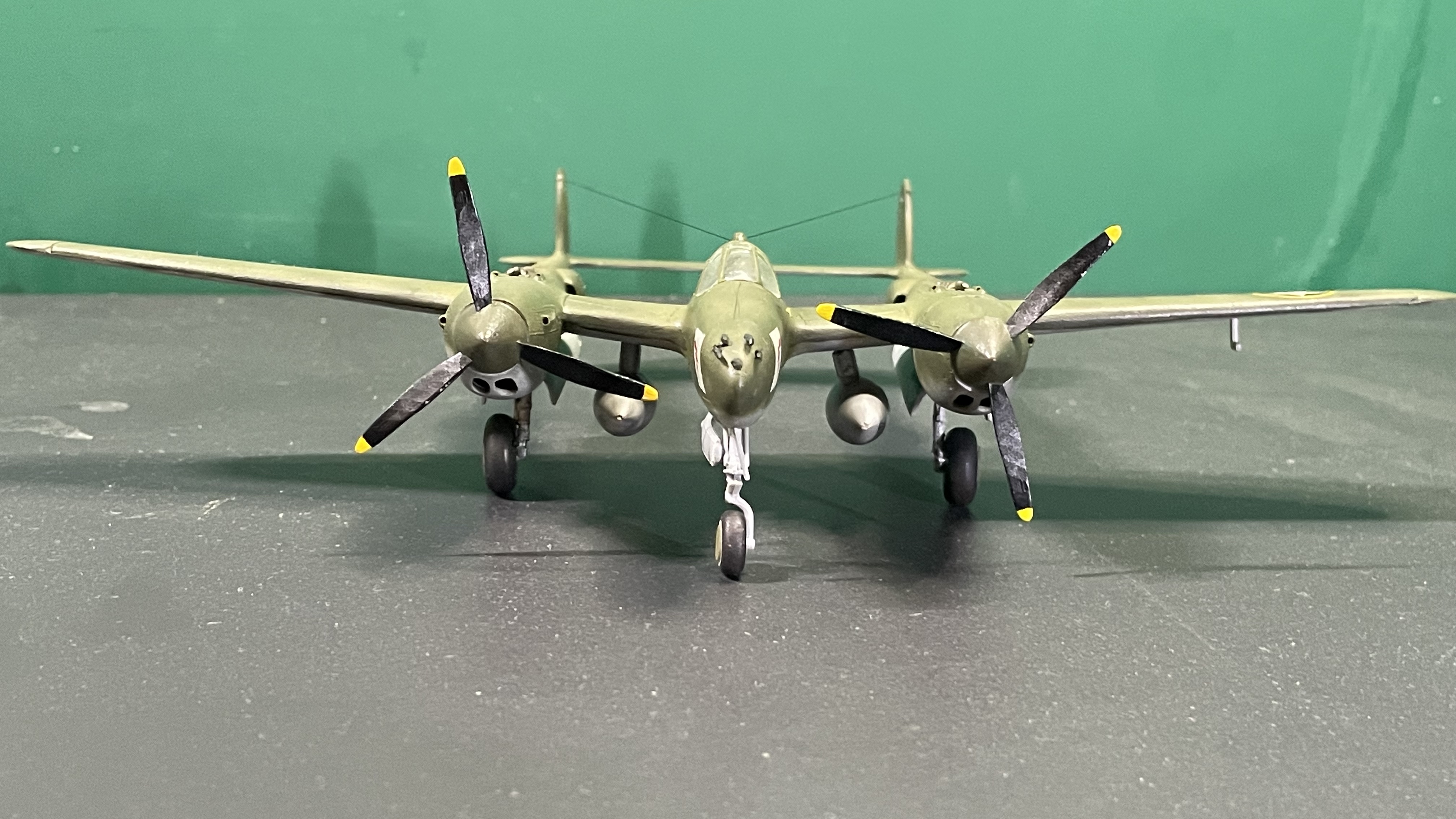

Brigbeale Posted October 21, 2024 Posted October 21, 2024 (edited) I had this previously built but half painted P-38 in the stash since I bought it about 4 or 5 years ago. It was largely intact but missing the canopy and propeller blades, but fairly well built wheels up. A coat of brown paint had been ‘applied’ to the interior and pilot while the upper and side exterior surfaces had a coat of green paint ‘applied. Luckily for me, Ian @sunray had built one of these and replaced the canopy with a vac-formed one. I asked if I could obtain the original canopy from him/her and I was sent the canopy. Fast forward a few years, and it was time to restore this little gem. The WIP is here I dismantled it fairly easily as it had been built using poly cement which was helpful in the disassembly of the P-38. Once it was mostly dismantled (I could not get the pilot out), I gave it a Dettol bath to remove the paint. With the parts free from paint and cleaned up, re-assembly began by painting the interior and pilot and rebuilding the centre fuselage. I 3d printed a pair of propellers from a free design I found on Cults3D. They had the spinners and mounting shaft already in the design so it was just a case of opening the original holes to receive them. To stop it tail sitting, lead weights were added to each boom ahead of the wheels, but more was still needed in the centre fuselage section. The design of the kit made this a lot easier and eventually I got the P-38 to sit level. The canopy masking was a chore especially on the triangular side windows but persistence paid off. The undersides were painted ted grey and the upper painted green, but I wasn’t happy with the shade to I repainted the upper side with mr Color Olive Drab (1). This was a better colour. The decals were bought used from EBay and they turned out to be Hasegawa items. There were a couple of issues though. First, was the fact the nose art decals - there should have been two, 1 for each side, but I was missing the starboard side. @Pete in Lincs suggested a comical workaround. I decided to take a photo of the original which I had and then reprint them onto decal paper mirroring the original image. I couldn’t copy the intricate shape though so I just left them squared off. They don’t look bad at all. Matt varnish was applied and once it had dried, I added the finishing touches. And with a Matchbox P-51D Mustang and a to-be-restored Airfix P-47D Thunderbolt. Edited October 28, 2024 by Brigbeale 32 1 3
Pete in Lincs Posted October 21, 2024 Posted October 21, 2024 A nice result, Brian. More fun than building a shake'n'bake kit! 1 2
bigbadbadge Posted October 21, 2024 Posted October 21, 2024 Looks absolutely stunning Brian, what a cracking Lightning . Great work love it. Chris 1
Mattlow Posted October 22, 2024 Posted October 22, 2024 I enjoy watching you resurrecting these lost plastic souls. It must be very satisfying.. Matt 1

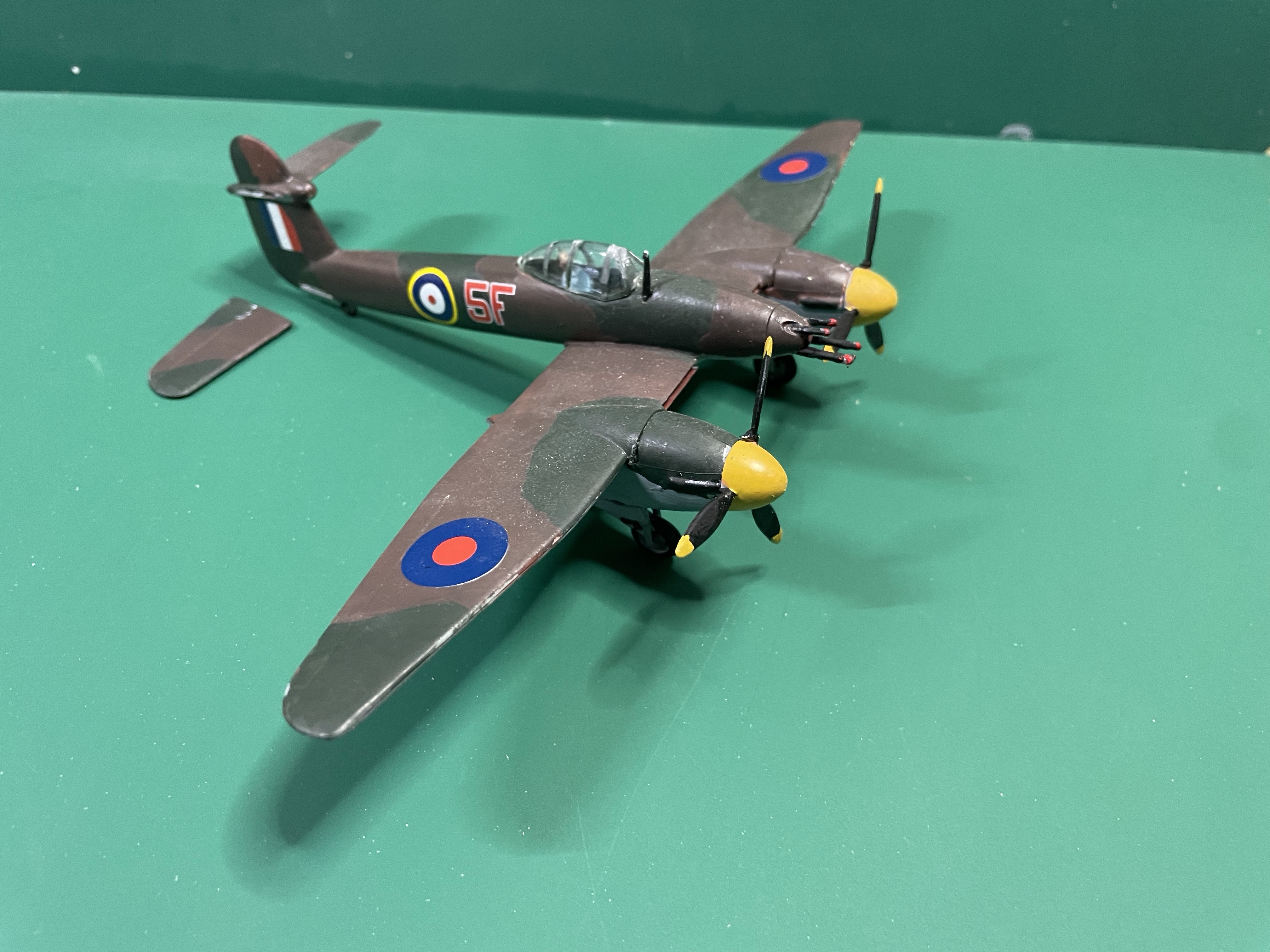

sunray Posted October 27, 2024 Posted October 27, 2024 Hi Brian. Sunray or Ian here. Cracking job and I'm glad to see you put the canopy to good use. Some of the old Airfix kits are little gems if you are willing to put a little effort in. Another good kit to look out for is the Airfix 1/72 Whirlwind Fighter. 1

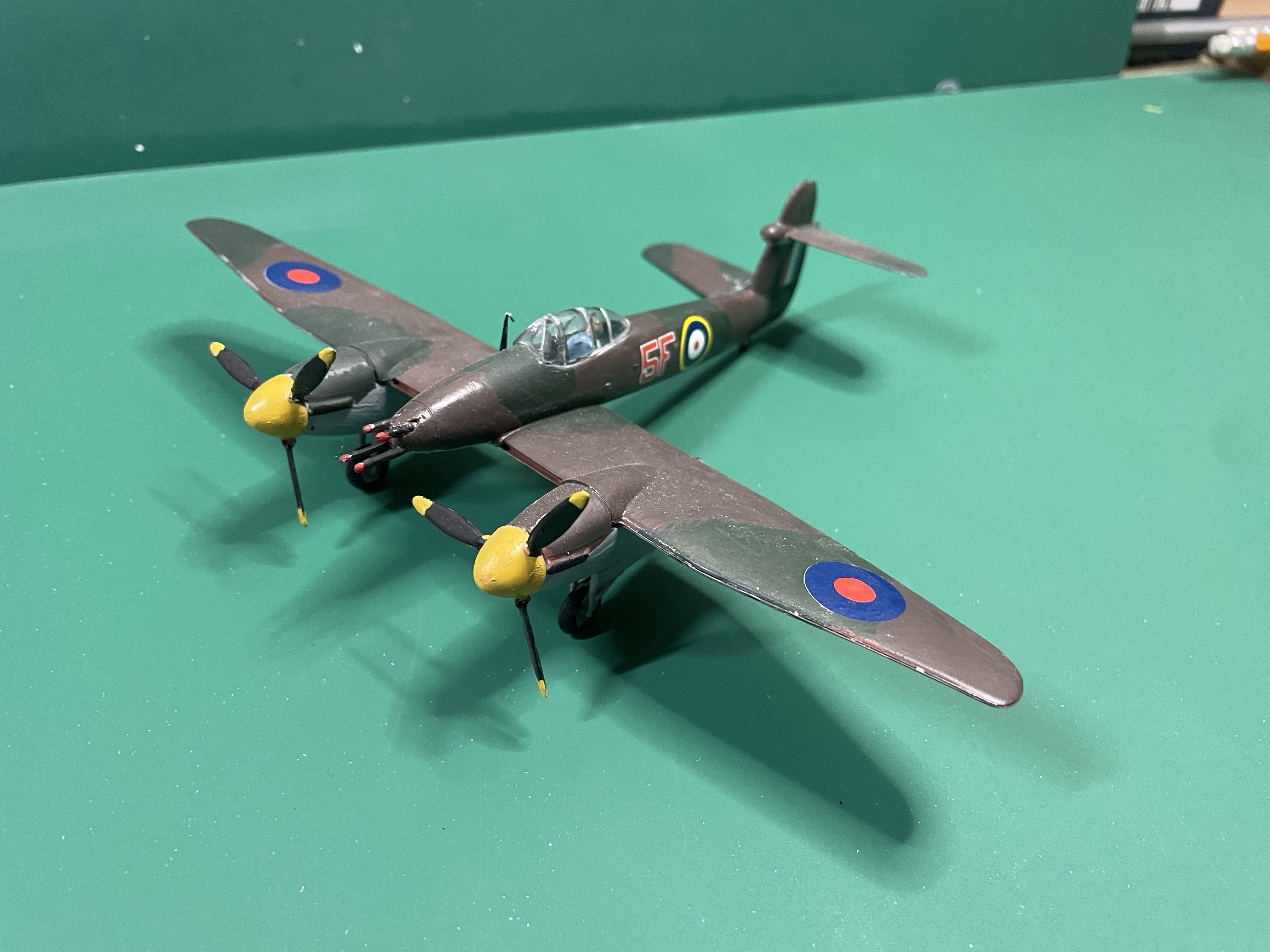

bigbadbadge Posted October 28, 2024 Posted October 28, 2024 Ooooooo nice, what a cracking aircraft looking forward to this one Brian, just started the 32nd Special Hobby kit myself. Chris 1
Brigbeale Posted October 28, 2024 Author Posted October 28, 2024 Thanks Chris, I was reading Christer’s Special Hobby build and noticed you had one in the stash
Galligraphics Posted October 28, 2024 Posted October 28, 2024 (edited) 5 hours ago, Brigbeale said: Whirlwind Brian - that’s the older original model; it’ll need a little more work than the 70’s version to make it reasonably accurate…. Depends of course on how much you want to do to it, but the fuselage is too long, the undercarriage is rudimentary at best, the wheels are no better than buttons (there are some very good resin replacements made by Barracuda Studios), the undercarriage doors are completely the wrong shape, the wings have no representation of the fuel tanks or flap extenders… PM me when you get around to this and I’ll ping you a copy of my references/plans etc. Nige Edited October 28, 2024 by Galligraphics 1
Brigbeale Posted October 28, 2024 Author Posted October 28, 2024 1 hour ago, Galligraphics said: Brian - that’s the older original model; it’ll need a little more work than the 70’s version to make it reasonably accurate…. Depends of course on how much you want to do to it, but the fuselage is too long, the undercarriage is rudimentary at best, the wheels are no better than buttons (there are some very good resin replacements made by Barracuda Studios), the undercarriage doors are completely the wrong shape, the wings have no representation of the fuel tanks or flap extenders… PM me when you get around to this and I’ll ping you a copy of my references/plans etc. Nige Thanks Nige, will do.
sunray Posted October 29, 2024 Posted October 29, 2024 No problem Brain. The Whirlwind is a nice kit and I had my first go at cutting panel lines, using vacuum formed canopies and making my own stands out of oak flooring. Keep up the good work mate. 1 1
neilspen Posted October 29, 2024 Posted October 29, 2024 The Lightning has turned out very well, considering the history. It is nice to see the real vintage kits being re- finished. 1
