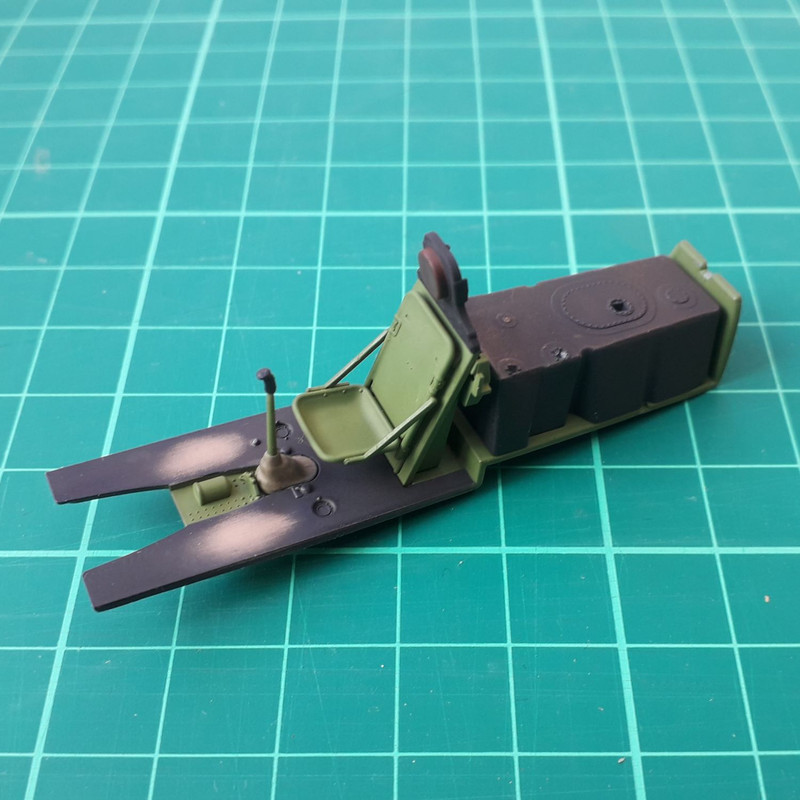

Made a start on some detail painting in the pit.
Plywood floor, Tamiya deck tan for the base and then one of the Mig Ammo oilbrushers in brown applied in wood grain effect, this was sealed in with Tamiya clear orange.
It will get some chipping fluid and a rubber black top coat. No other weathering has happened yet, hopefully tonight.
More painting up of the various internal parts has been going on, tail wheel bay etc.
Some pix from last nights session - Enjoy.
That's a lot of effort just to have a small patch of the floor scuffed, I was wondering if with the short life of these aircraft, the floor really did get that scuffed that the plywood was visible? :hmmm:
  • Like 3
All looks great to me, Dan, the cockpit detail painting is excellent and I like the wood grain effect: I do get Bob's point regarding the floor covering, but I should think it would wear quite quickly under combat conditions with the pilot's flying boots kicking at the rudder pedals while manoeuvring. I tried a similar wood grain effect on my stalled effort - Tamiya Deck Tan as a base with woody-coloured watercolour pencils to give a grain effect. I think it looked okay:
It could have done with a bit more "grain", really! :D
