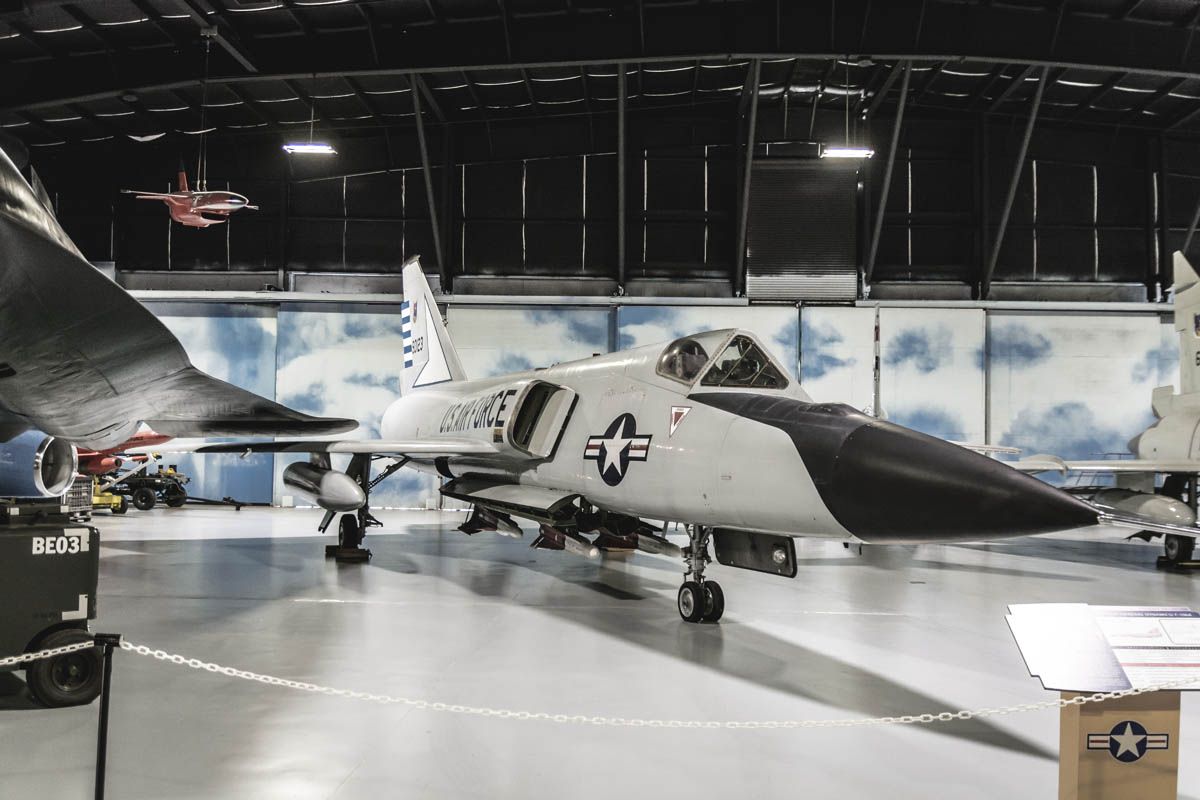

I've always loved century series jets. Thuds are my my favorite...
...Right after the Delta Dart!
Note: My dad didn't go to 'Nam, he worked the F-106 for the 48th FIS at Langley VA when that fracas was going on.
The Robins Air Museum has the bird he was assigned to on display...
Edited by UberDaveToo
  • Like 2
Oh cool I love the Century series also and huge fan of the 106 . Small world my dad was also with the 48th FIS F-15C 87-89 before he ritired after 24 years as crew chief on fighter jets 😀
