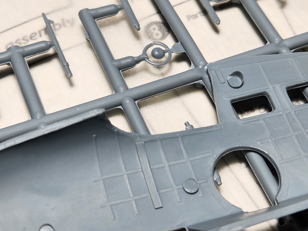

dnl42 Posted January 2, 2024 Posted January 2, 2024 1 hour ago, Tim R-T-C said: Are you talking about breaking parts off during building or later on? Agree, that's the critical question! As written above, alternate build sequences and "controlled breakagereconfiguration" are both important techniques. This goes for molded-on parts, such as arials along the top/bottom of a fuselage centerline. If left in place, they will be broken off, so I prefer to remove the part and replace during final assembly. I'll even avoid sturder parts, like struts and the like, as I have "special skills.". Once the model is in the cabinet, I keep my paws off the model unless absolutely necessary. Post-completion repairs can be a nightmare; sometimes the prudent thing is to clean up the break and live with it. For removing parts from runners, the safest way in my experience is a razor saw, like a JLC Razor Saw or other. I've been able to remore the most fragile parts with this. A clipper, even a very sharp example like this is could bend the part, possibly to failure. With care, you can saw off the part without any trace of the gate remaining--that is, ready to fit. Of course, you could yet find some parts broken during packing or banging aounrd in the box. Like this RDF antenna (upper-center). This is a limited-run kit, so poor molding could also be to blame. Note the heavy gates on this part are even more indicative of using a saw to remove the part after I've glued it back together.
