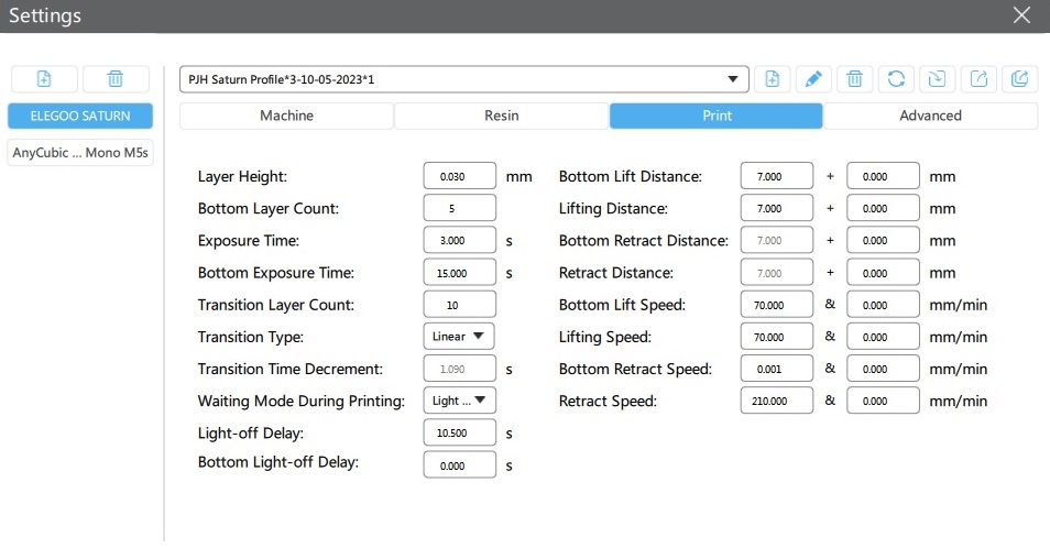

I have a Saturn and I have failed prints i run a tank clean for 60 seconds then lift out the sheet of cured resin with the plastic spatula and start again it cold also be your settings.
finding out about the Light-off-Delay made the most difference to my prints.
These are mine.
I used to use Elegoo resin but could not get on with it I now use Anycubic resin it holds a better print and it's a much better service direct from them worth a try.
There water wash resin is very good.
Hope this helps?
Elegoo resin received yesterday! If only Elegoo.AE also had the film I'd be good to go!
Thanks for the info on light-off-delay, that could well be the cause of the "fluffy" edges. I'll try that and see if it makes any difference to the blurred and shiny top surfaces. It looks as though the resin above the print is being cured slightly.
Ian

The film was received and I fitted it a couple of weeks back. Printing resumed with the same issues as before, but I got a couple of useable gearboxes and went with those (the uppers won't be visible anyway). I've emailed Siraya Tech on the issue and am awaiting their reply.
