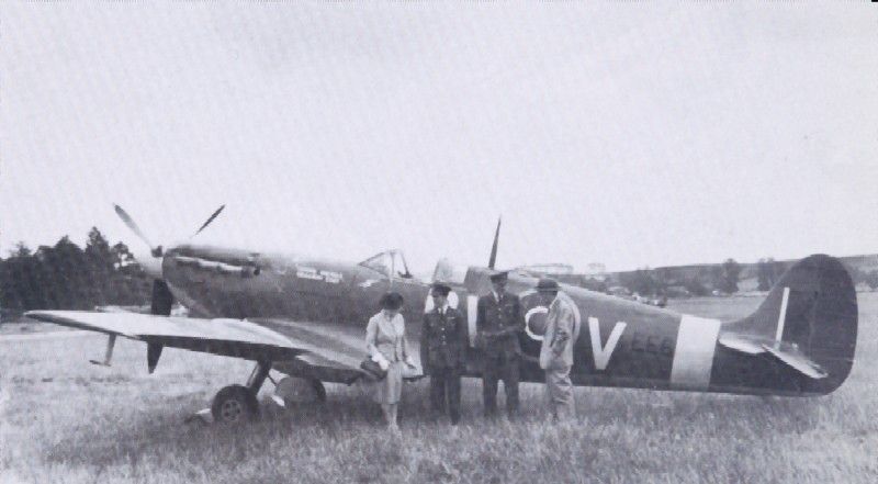

Paul Lucas Posted November 27, 2023 Posted November 27, 2023 And yet the second illustration has the post 1942 National marking III on the fuselage and the pre 1942 fin marking that I suggested might have been the case on Spitfires delivered by Op Salient. Or is that just a coincidence? 1
Ed Russell Posted November 27, 2023 Posted November 27, 2023 10 hours ago, Archelaos said: why completely undocumented plane appear in so many decal sets It starts with " someone" who recounts his story of what he flew 40 years beforehand, or what he thought he saw or what his cousin told him he thought he saw. Some friend or relative of that person knows some else who works in the model industry. Then the story is passed on by a manufacturer to a profile or decal artist in form of a phone call or maybe even a written note. The artist is only being paid a few pounds per profile so there is no incentive for him to check anything. So it gets into print and is used as a (usually unacknowleged) source by generations of amiable plagiarists thereafter. Here's another one to add to Troy's collection above. https://www.britmodeller.com/forums/index.php?/topic/234972519-hurricane-mki-p2992-of-527-radar-calibration-sqn-red/ PS - I see the pictures in the above link have been Botophucketed - for those unfamiliar with that Hurricane, there is a picture here https://www.britmodeller.com/forums/index.php?/topic/234977606-hurricane-mki-p2992-of-527-radar-calibration-sqn/
MACALAIN Posted December 7, 2023 Posted December 7, 2023 I have post 2 days before my point of veuw of a Salient Spitfire. Alain
MACALAIN Posted December 7, 2023 Posted December 7, 2023 On 27/11/2023 at 09:01, Paul Lucas said: And yet the second illustration has the post 1942 National marking III on the fuselage and the pre 1942 fin marking that I suggested might have been the case on Spitfires delivered by Op Salient. Or is that just a coincidence? I have post 2 days before my point of vieuw of a "Salient" Spitfire. Following your idea. Alain
MACALAIN Posted December 7, 2023 Posted December 7, 2023 On 27/11/2023 at 09:01, Paul Lucas said: And yet the second illustration has the post 1942 National marking III on the fuselage and the pre 1942 fin marking that I suggested might have been the case on Spitfires delivered by Op Salient. Or is that just a coincidence? 1
