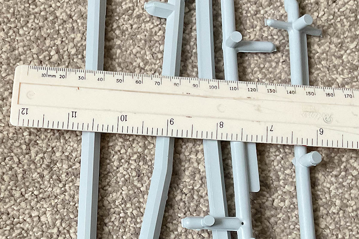

I remember getting the spars in the wings a bit tricky - as you know they are rather large and need some serious support.

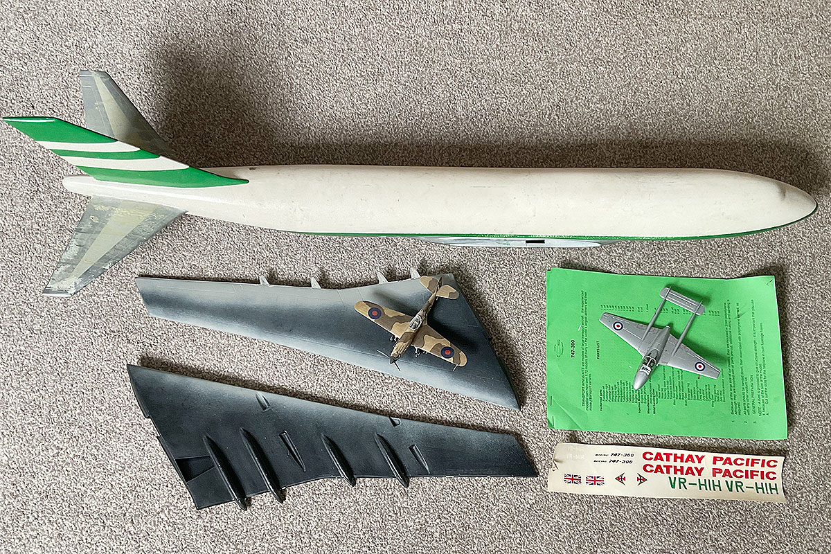

Yep, it's a vac form and the first one I ever tackled. I didn't do a bad job, but some areas are screaming to be improved - more on that over the coming months...! As for displaying it, I have no idea where it will go once it's finished - I'm running out of space and it's huge!
I made a start on this today, giving it a very hard stare to see what was needed. There are many tasks ahead which will be tackled in no particular order - I just want to get this model moving towards completion again. During my research on the aircraft depicted by the decals, I learnt that VR-HIH was actually a 747-200 despite the decals having '747-300' printed on them - the first job was editing the title of this thread!
The paint on the model is old and not particularly accurate - the demarcation line starts well at the front but bows up like a banana towards the tailplane:
As you can see, the tail cone has split open so will need repairing (and an APU exhaust adding). The tailplane is also covered in the remnants of decades old masking tape residue and will need stripping back...
I need to establish some datums on the model, in order to get the demarcation lines corrected when I finally get to the painting stage. I decided that the window line would work well and I could scribe the doorframes into the fuselage at the correct points as permanent markers for later reference. Don't be distracted by the BA livery below, I simply used this as I had a copy scanned from 1/144 decals - I just doubled the dimensions and printed it onto decal paper. Some fudging will be required, as these are from a 747-400 but I'm hoping the main deck layout will be broadly similar:
Another two sheets of A4 paper - this model is big! I also have some 1/200 decals on the paper for another project - they look tiny by comparison!

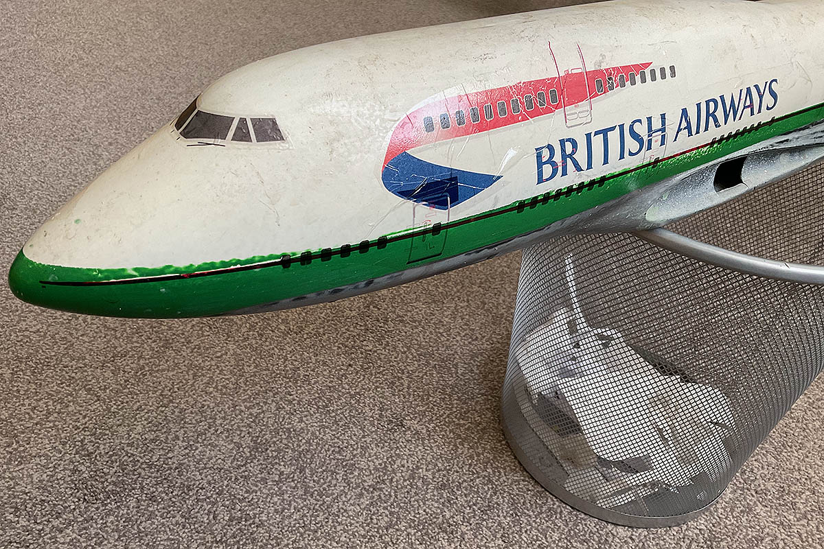

Time to get some decals applied! These are purely for guidance purposes and are completely sacrificial - they will all be removed before too long!

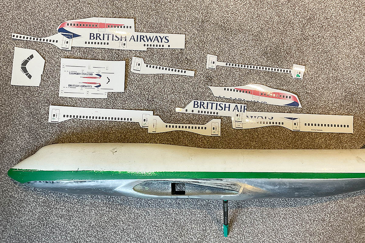

The decal sheets were sealed and then the window sections were cut out ready for application (note my 1/200 decals too, used to help me orientate the various sections):

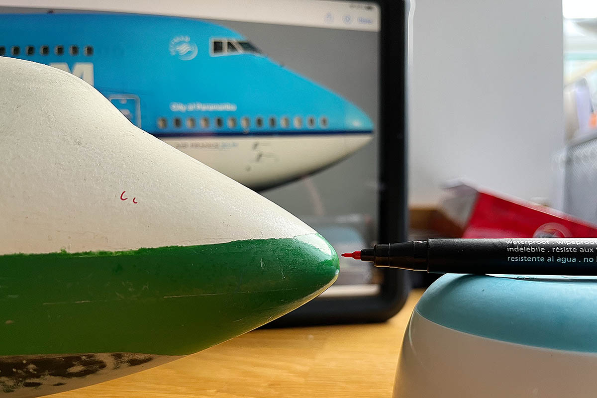

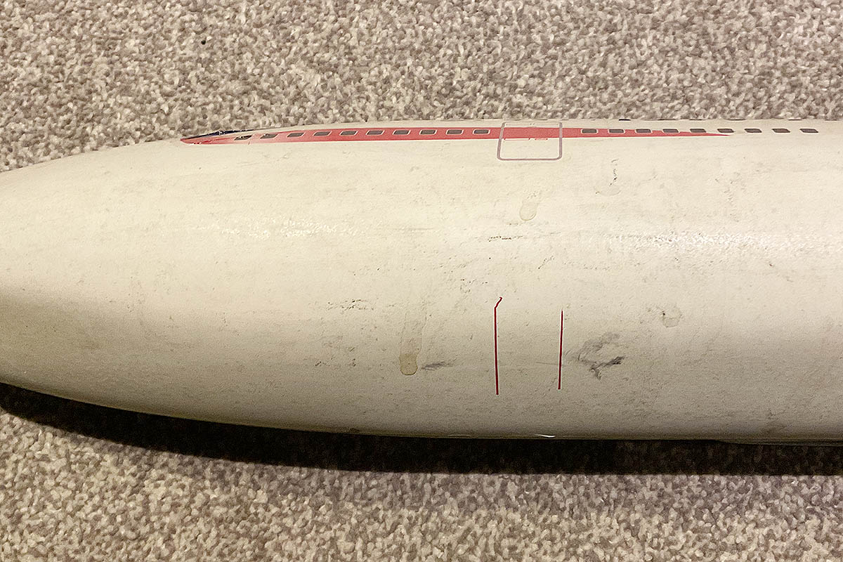

A great photo to illustrate my problem - where exactly should the windows be placed? Time for some references...
I found an image on Wikipedia showing the nose of the 747 and used this to determine where the windows were relative to the nose cone (slightly above the line extending back from the tip of the nose, in case you were wondering). I then found a suitable sized container and laid a marker pen on top of this, before drawing a line at the correct height all around the fuselage:
Once the line was drawn the decals were applied with the windows placed directly over this reference:
I'm particular interested in getting the cabin doors positioned correctly, so I can scribe their outlines into the fuselage and have a durable set of reference markers for later use. It didn't take long to complete one side:

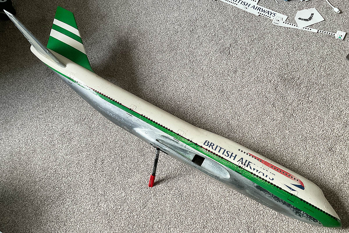

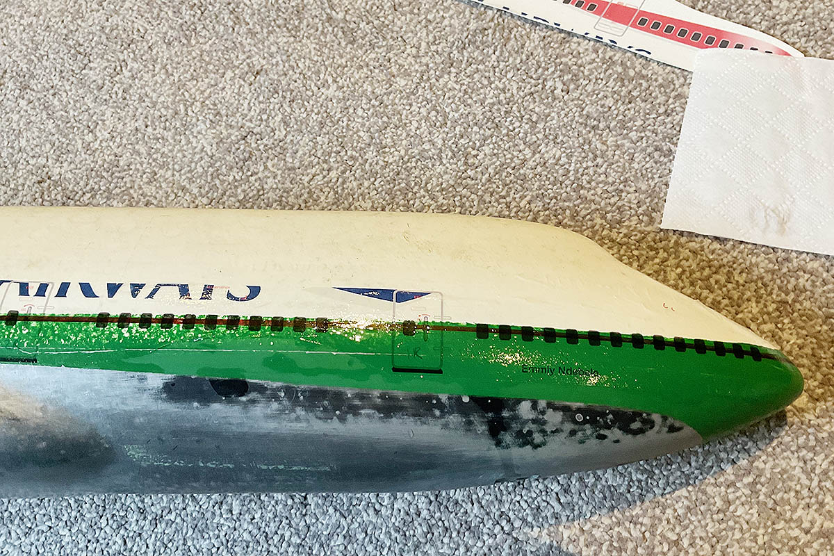

A Cathay Pacific/British Airways hybrid at the moment! Considering the green band was eye-balled many years ago, I don't think I did a bad job...😉
I'd like to think that if Tom hadn't mentioned it yesterday, I would have realised today that I was dealing with a -300 model!
I will leave these to dry then apply the decals on the other side of the fuselage.

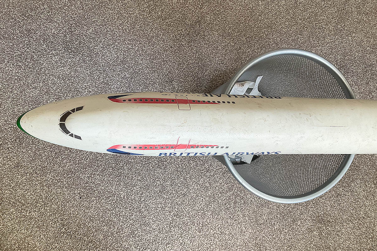

Time to get the decals on the left hand side - I was waiting for the right hand side to dry before doing any more work, in case something slipped...
First I used a pen to mark the location of the upper deck door, to aid positioning:
Then applied the decals in this area, using this line and my previously drawn horizontal window line to help with alignment:
I added the windscreen decal too - there was no real need to do this, as they will all be coming off again but I wanted to see how it looked! The decals are not applied very neatly, but are good enough for my current purposes, which is simply locating the doors accurately.
The view from above - it all looks symmetrical:
My waste bin makes a great model holder! 😁

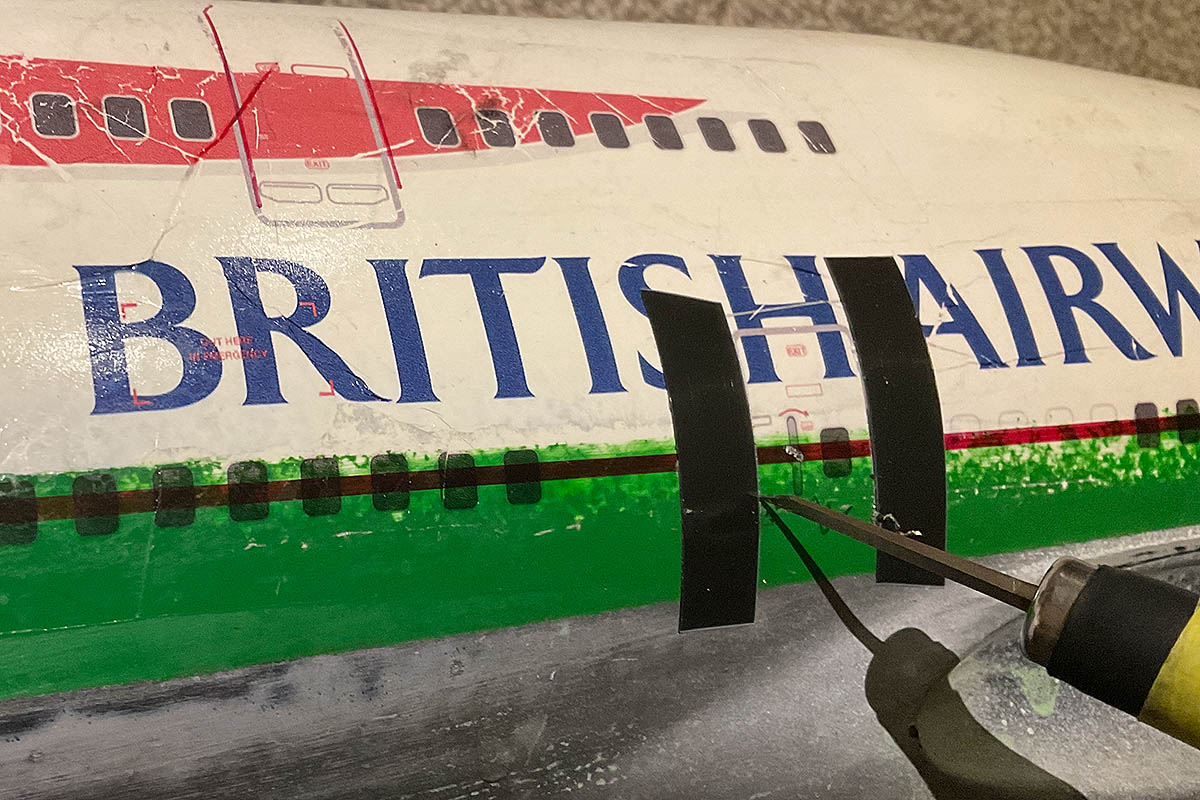

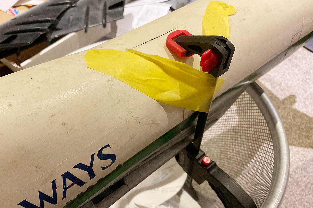

Dymo tape was used to mark the edges of the doors and some gentle scribing occured:
The centre of the door handles was also marked, to get the vertical alignment recorded onto the plastic.

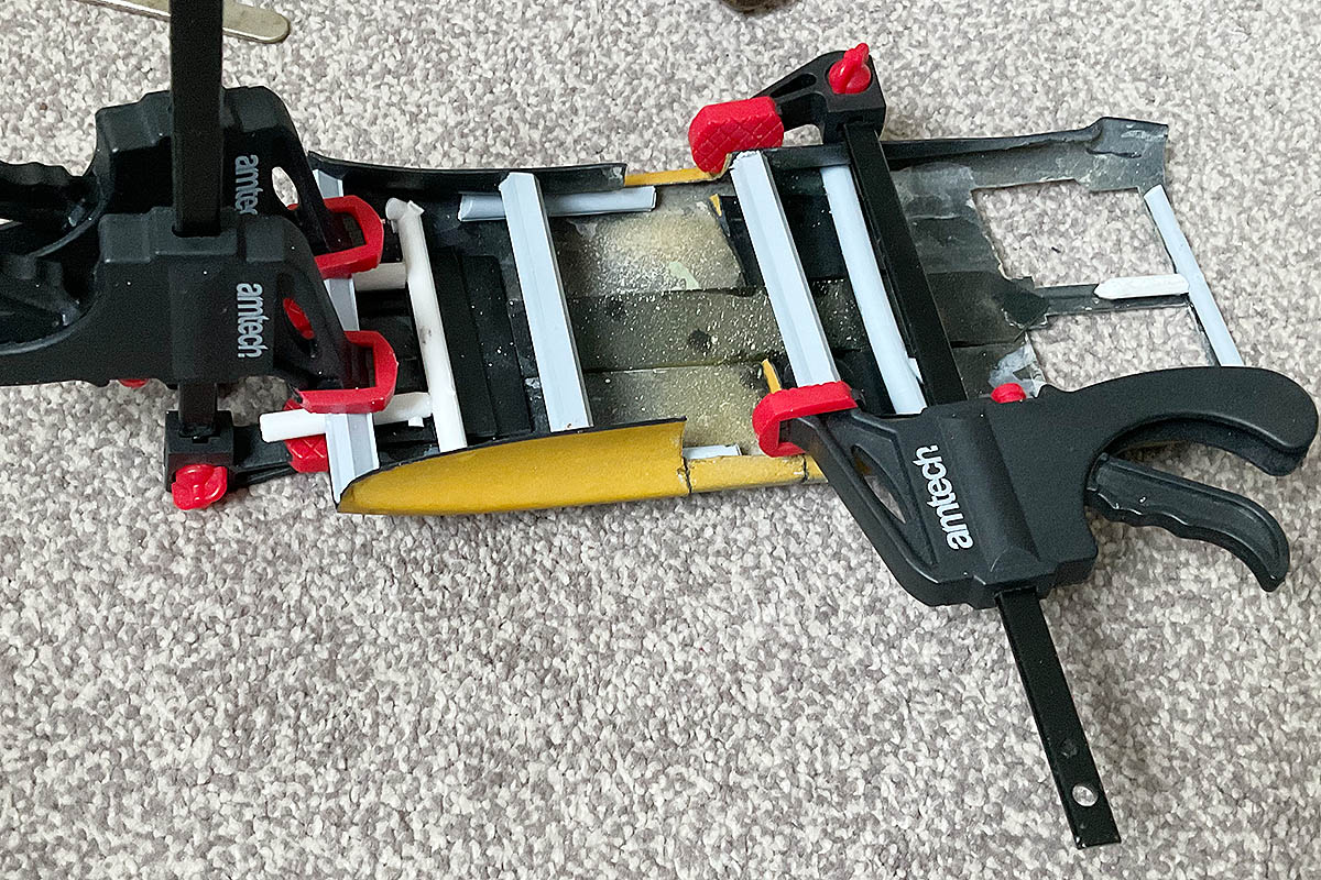

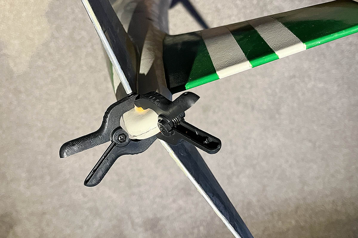

Next I repaired some damage on the fuselage. The tail cone had a split:
As did the top of the fuselage:
Plenty of glue was added and will be left overnight to harden.

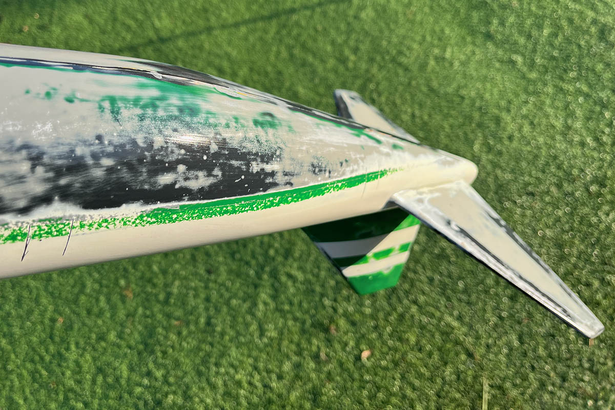

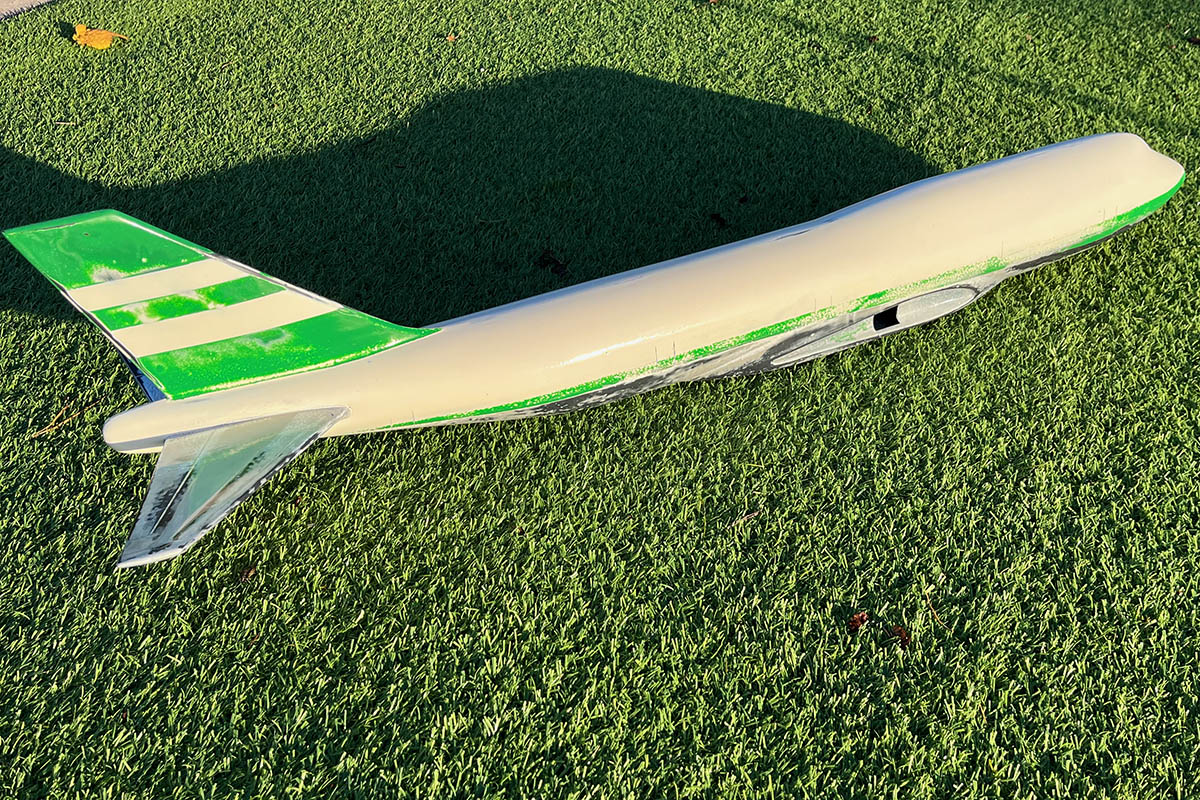

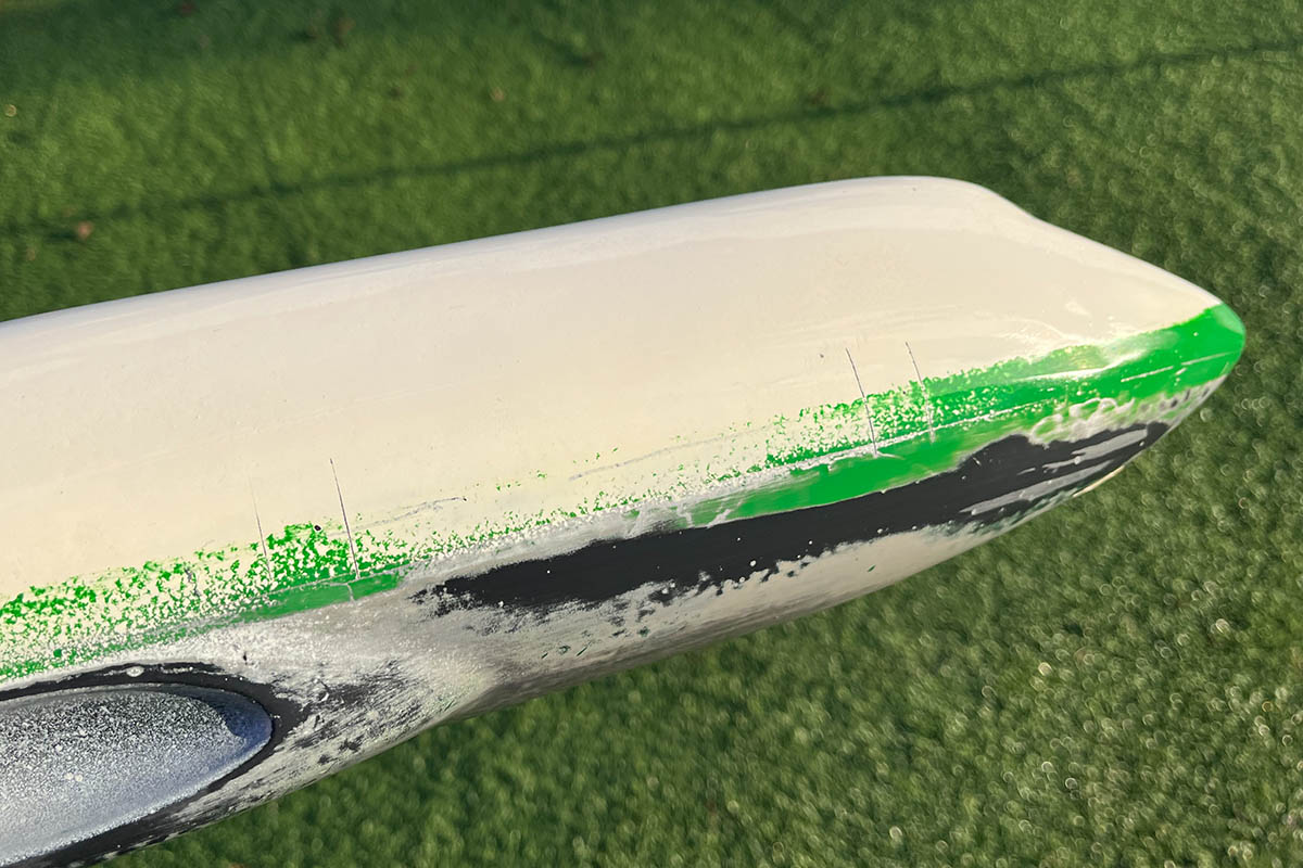

I spent a productive hour in the garden this afternoon with a bucket of warm water and a sheet of 240 grit paper.
My mission was to remove dirt, decals and uneven paint!
Here are the results:
Note the scored lines showing the edges of the doors!
Back to bare, black plastic!
Looking very shiny and clean again!
I'm leaving this to dry overnight in the airing cupboard (!) and if the weather is suitable tomorrow I'll coat it with primer and see how it looks.👍

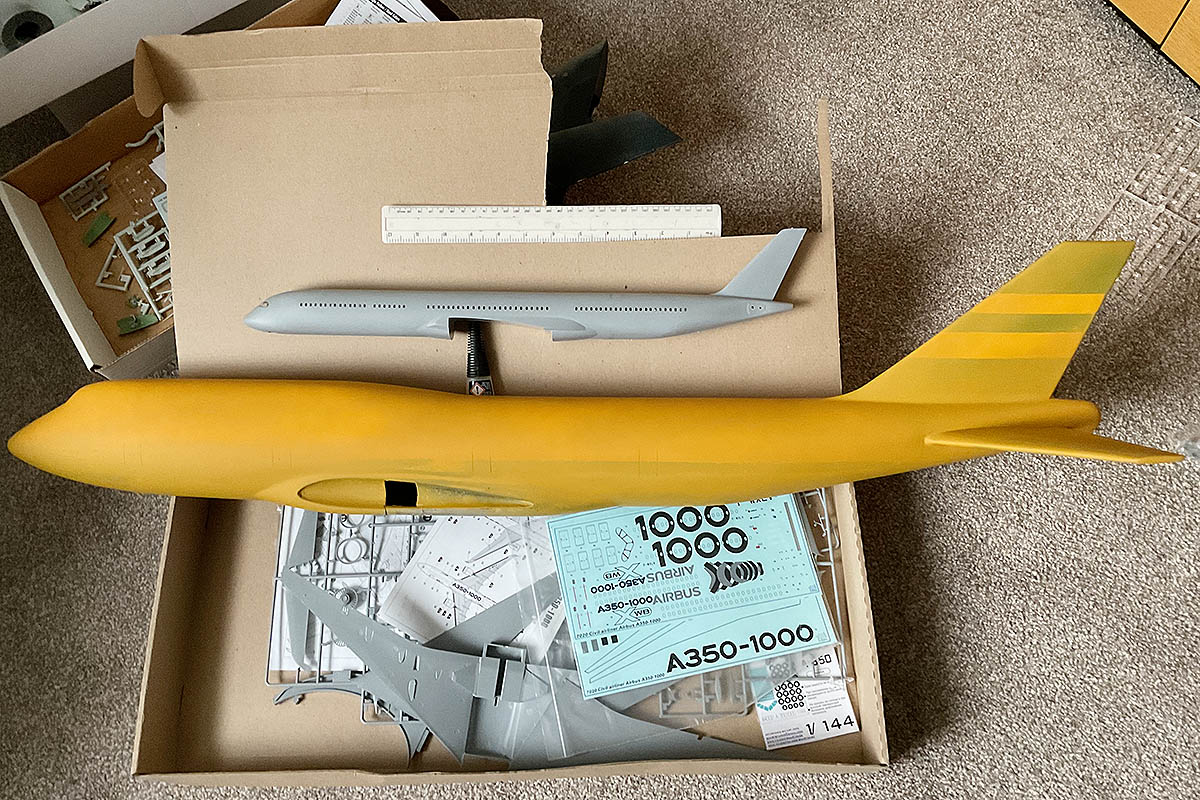

I did - here’s a picture:
Note the size, compared to a 1/144 A350 and a 12” ruler!

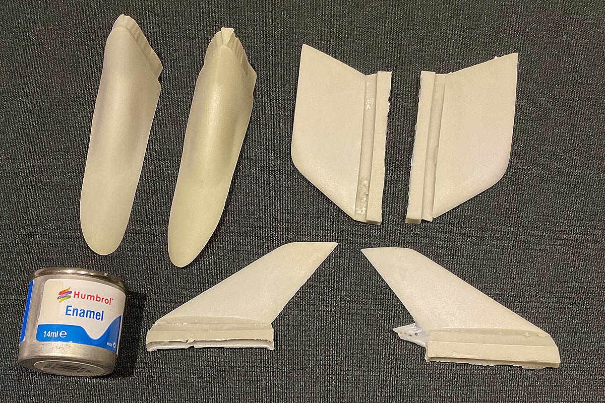

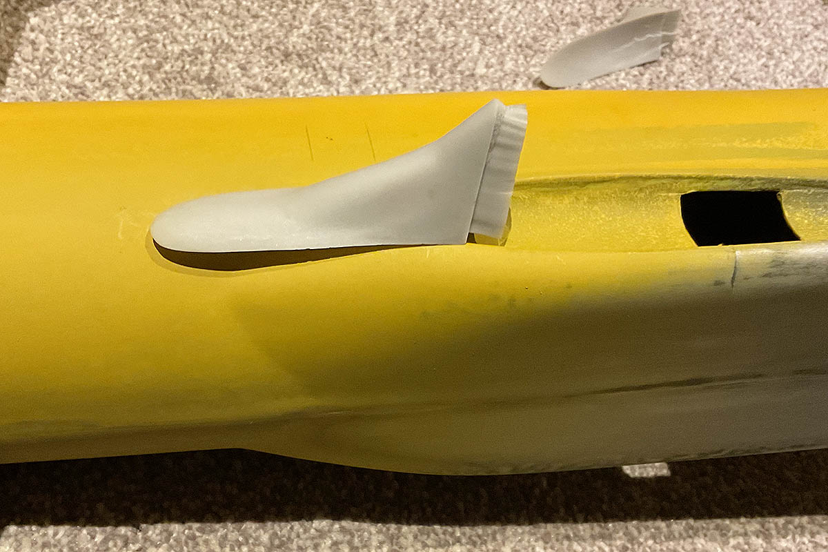

I haven't done anything to this one for a week, as I was waiting for a package to arrive:
Six pieces of resin - two wing root extensions, two wing tip extensions and two winglets. Plus a tin of paint for a size comparison:
Now I have these, I think my next step will be butchering the fuselage to make the wings detachable - it's just too large otherwise! My plan is to join the wings together and blend them into the fuselage belly, but to have this entire section separate from the lower fuselage. I think it should work...!

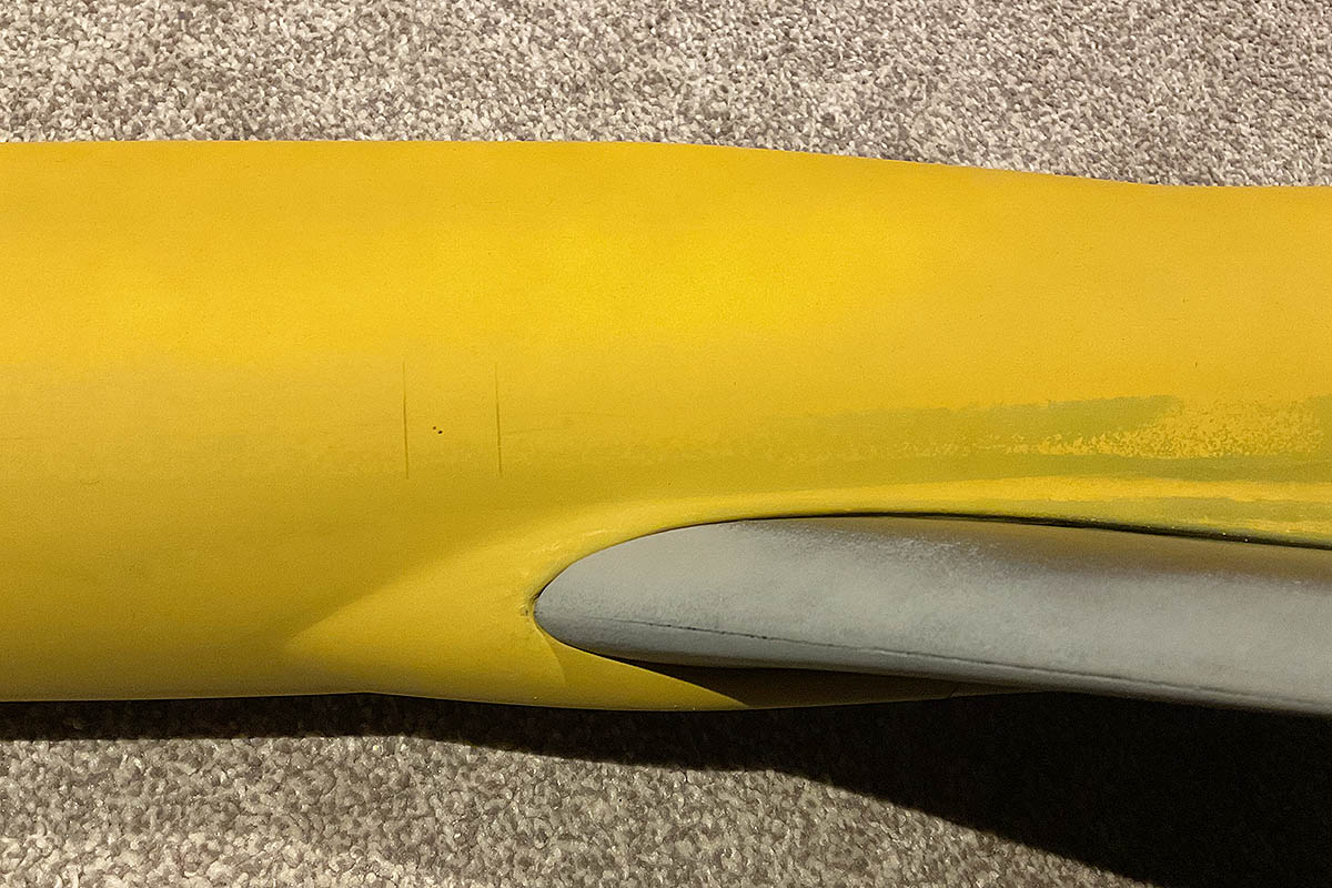

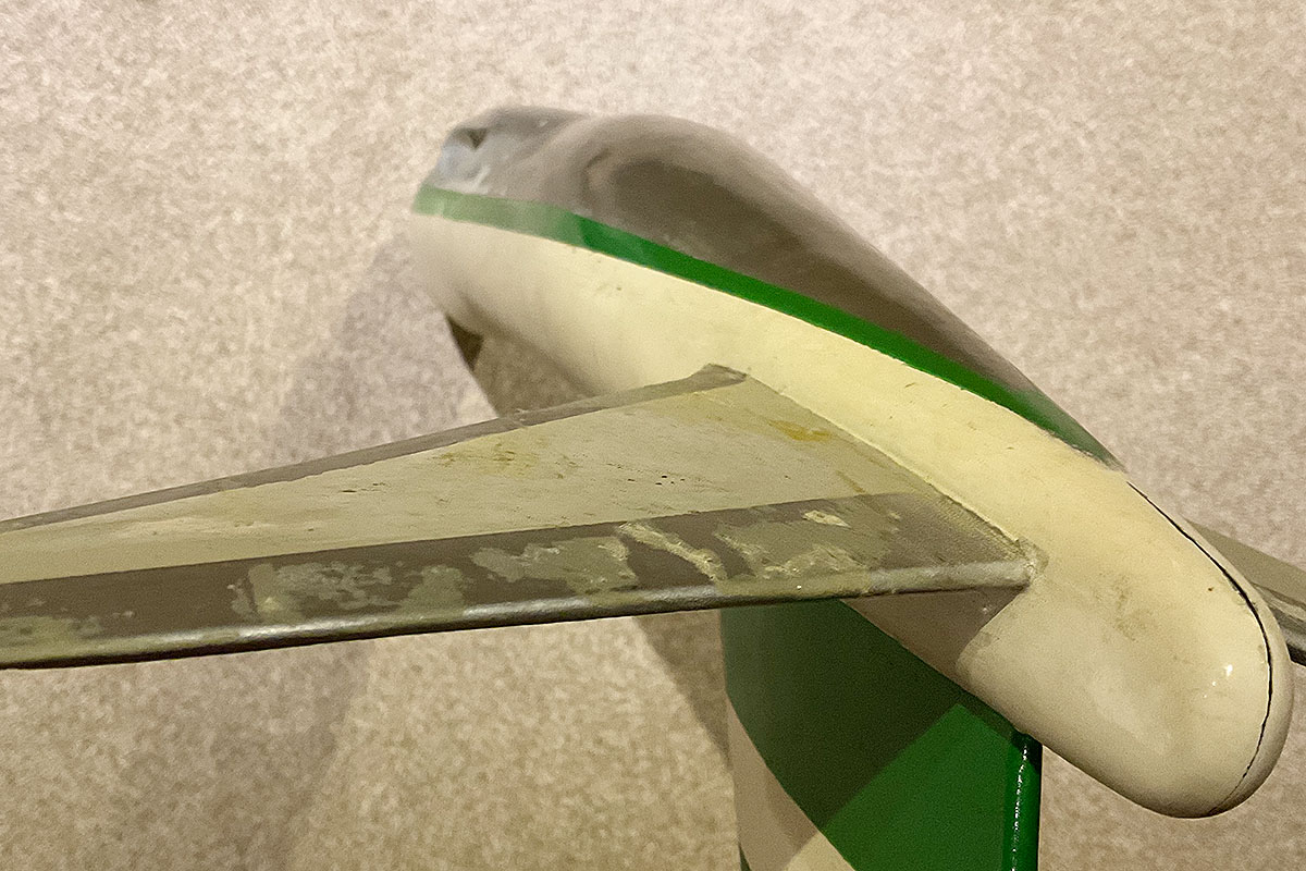

I haven't done much at all for over a month, due to lack of time. However, last night I found a spare hour and looked at this one again. My first consideration was how to incorporate  the resin additions to convert the model into a 747-400. Here's a look at the wing root extension on the left hand side, in approximately the correct position - I have not fitted these into the wings sections yet:
It doesn't seem to fit against the fuselage very well!
Here's the wing in the correct position for a comparison - the extension fits into the leading edge:
I'm really not convinced I can make this work! It might have to remain as a -300 model (with yet another change to the thread title!)

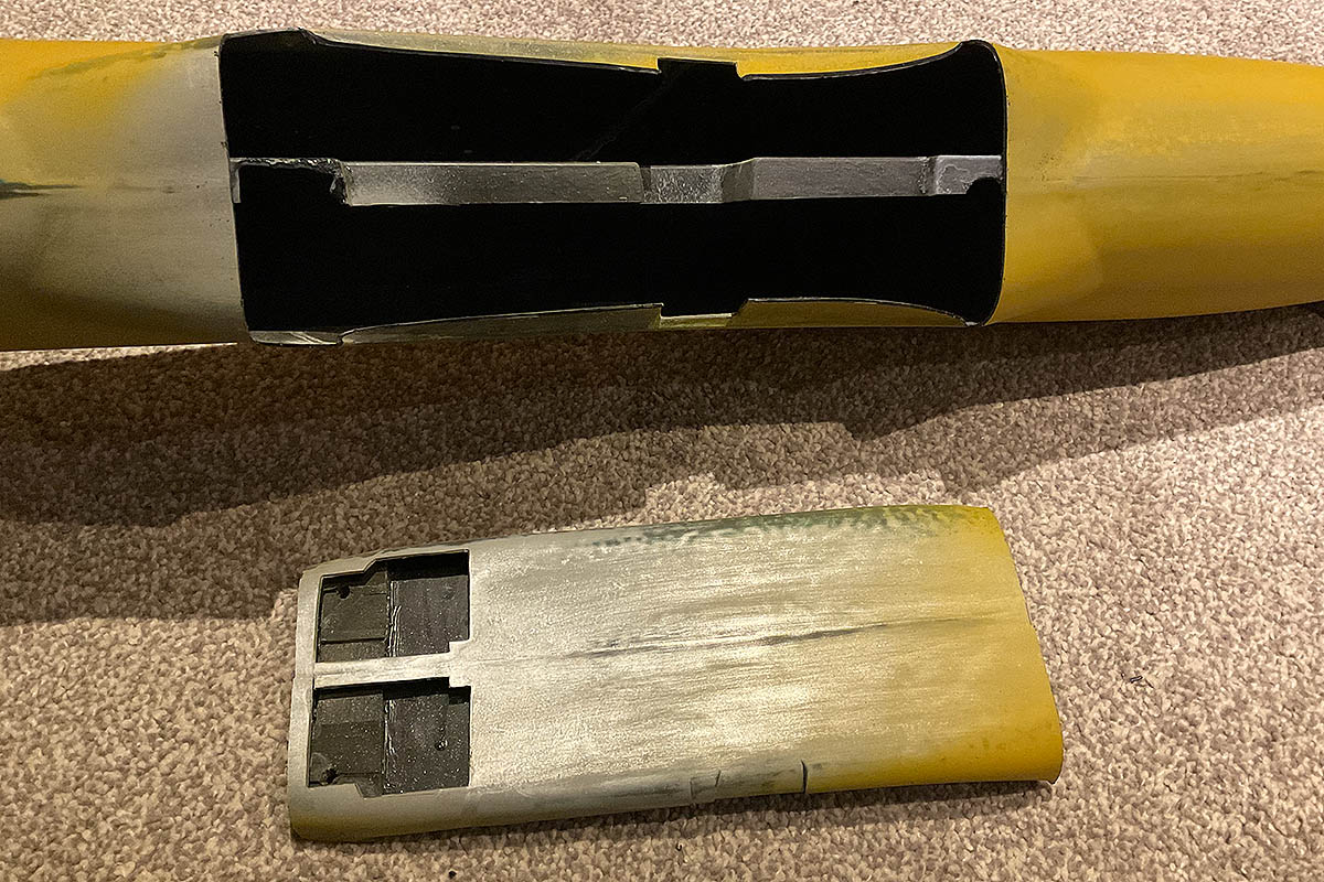

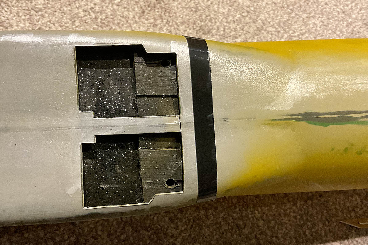

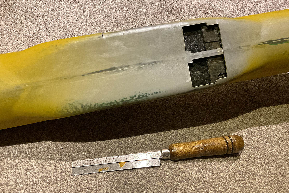

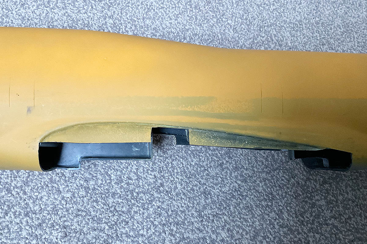

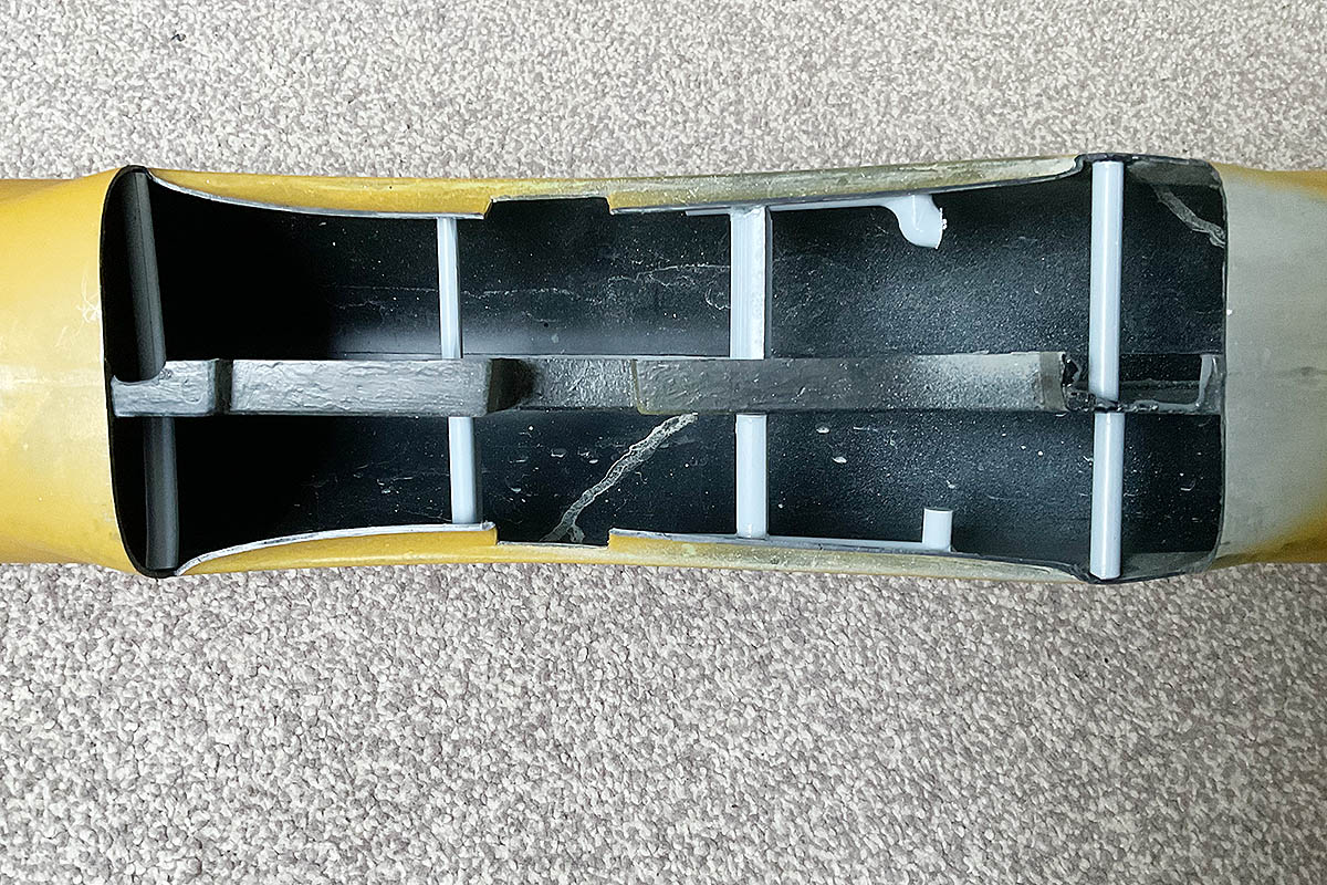

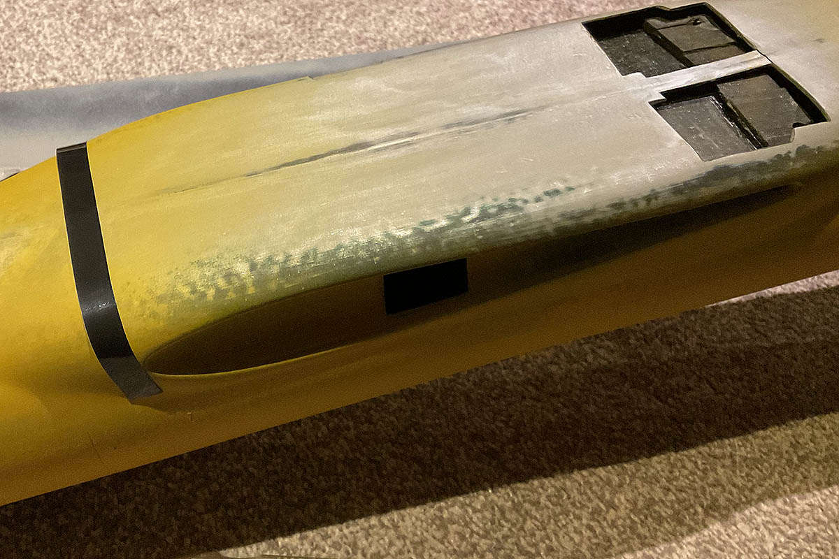

My next task was to remove the belly pan to make the wings detachable. Here's the initial state of play:
I then marked out with dymo tape where the cuts needed to go:
Before bravely grabbing my razor saw and setting to work - no going back after this stage! This section put up a fight, as there is a keel inside the model for strength and support but it was eventually persuaded to come away:
The concave bowed area is where the wing root fixes into place, it is not distorted despite its appearance. Both the fuselage interior and removed belly section will be beefed up considerably to prevent any flexing, then I will look at how best to attach the wings.👍

Time for a quick update. On my last one, I mentioned that I needed to beef up the structure around the (now) detachable wings. I have some thick scrap sprue in my spares box, which was leftover from my 1/24 Harrier GR3 build:
These were cut to an appropriate length and glued into the fuselage. The central keel can be seen clearly:
The removed belly panel was also strengthened:
All was looking good until I tried to offer the panel into the recess - the original keel now gets in the way:
A bit of surgery will soon remove the excess plastic and it should fit into place again.
